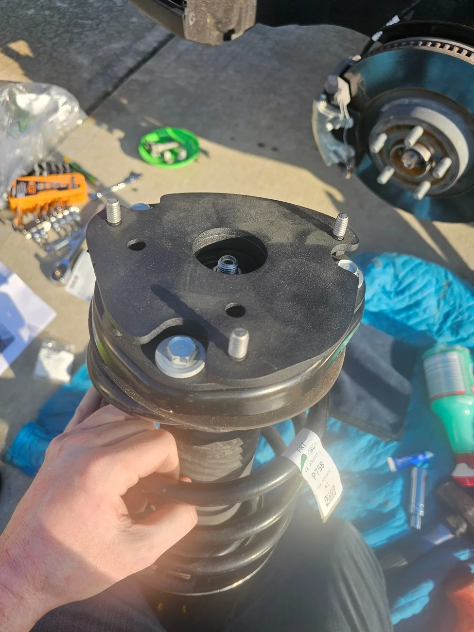

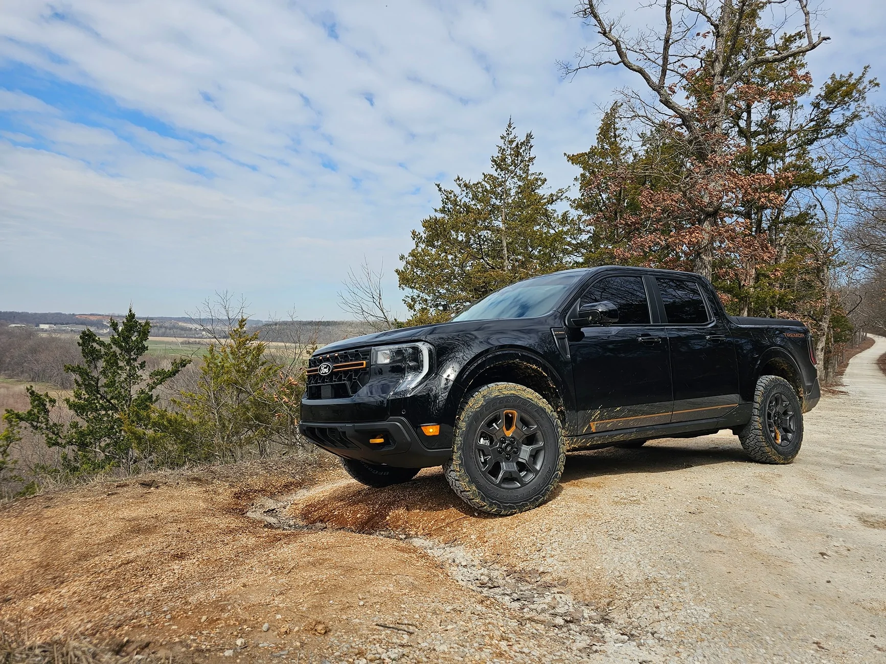

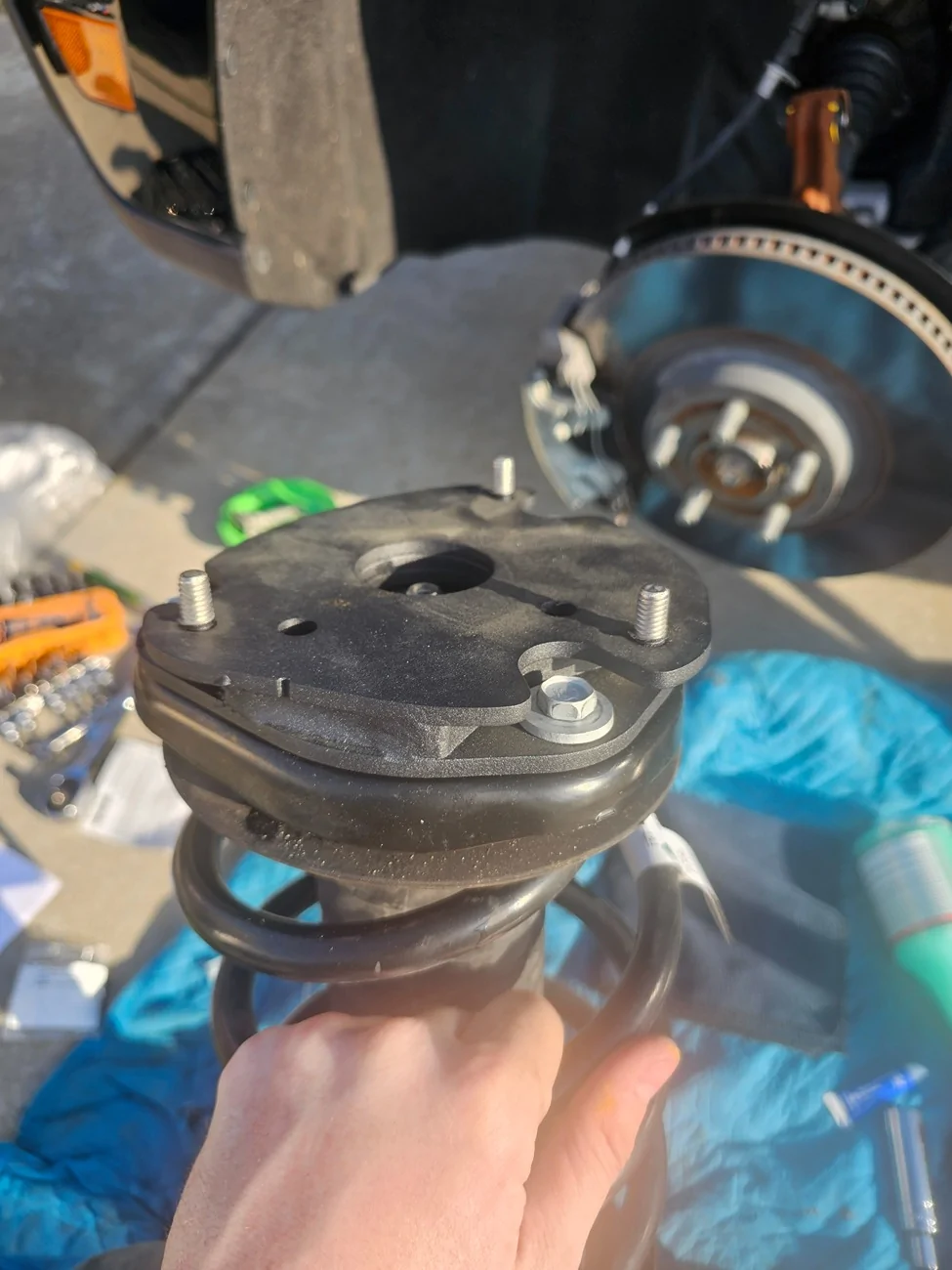

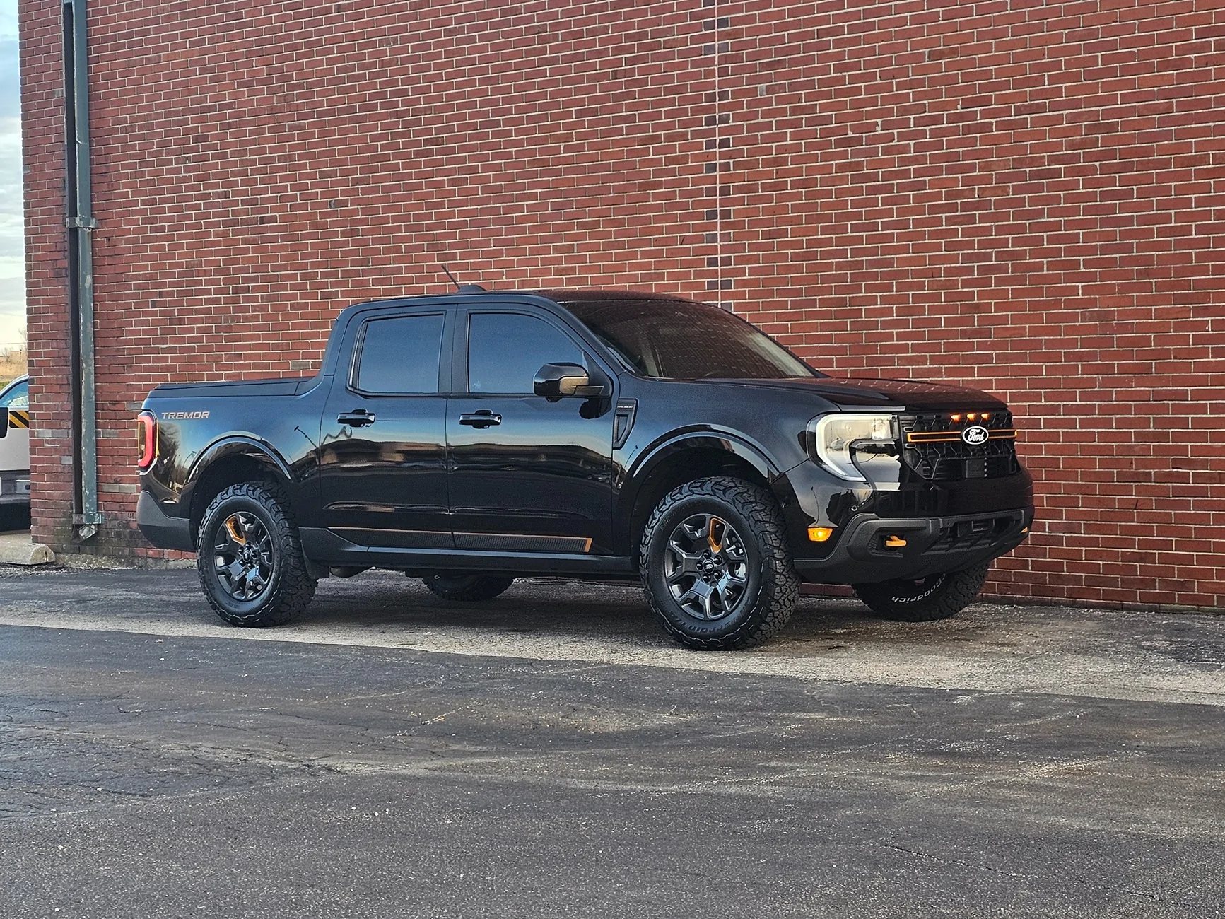

The tremor is 1" taller its in the spring height. Not a plate . The aftermarket levels are plates . I have a zone level on mine it's like 3/4 spacer.. also went up a couple tire sizes to a bfg ko3 245 70 17. I would get ever so silght rub under a load and more then 3/4 lock @ the pinch weld . And It definitely the bfg tire I know guys with nitto g3 , fallen at4 and toyo that dont rub at all. Or not enough to actually show

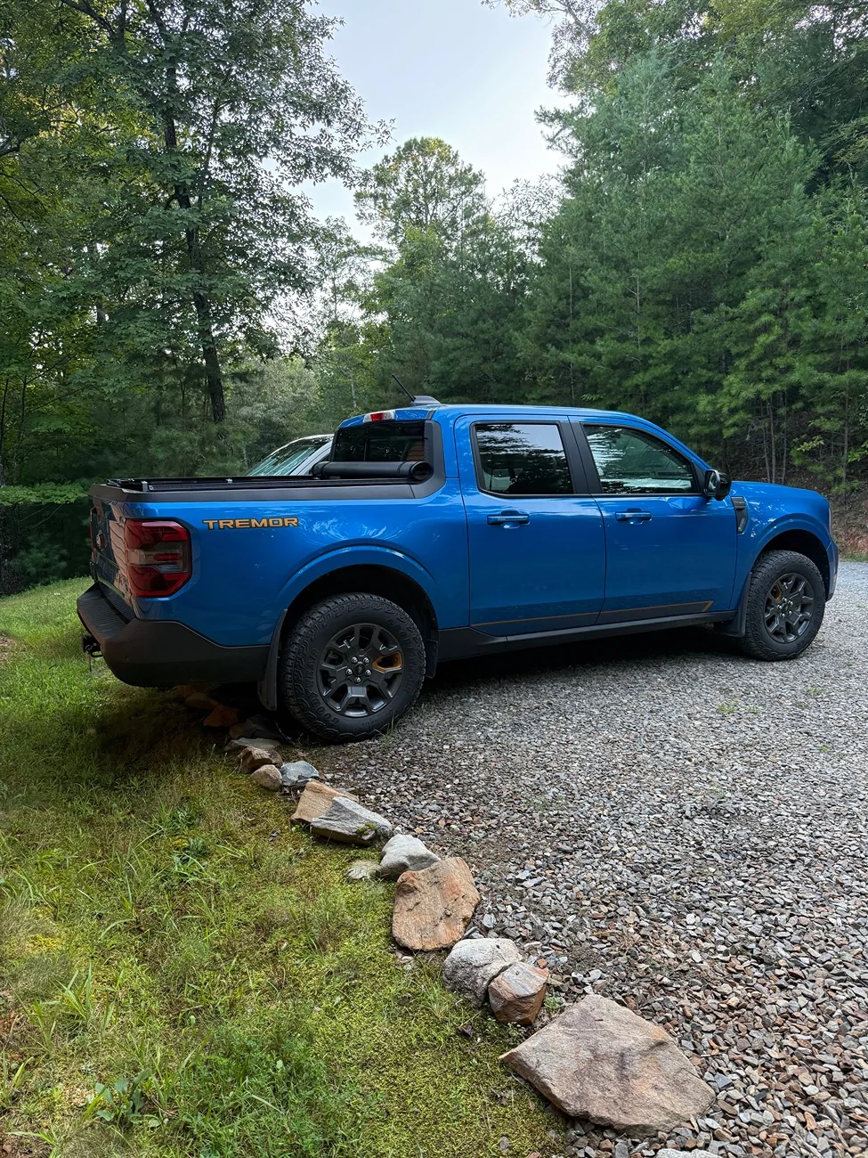

I’d not want to level my 26 Tremor.

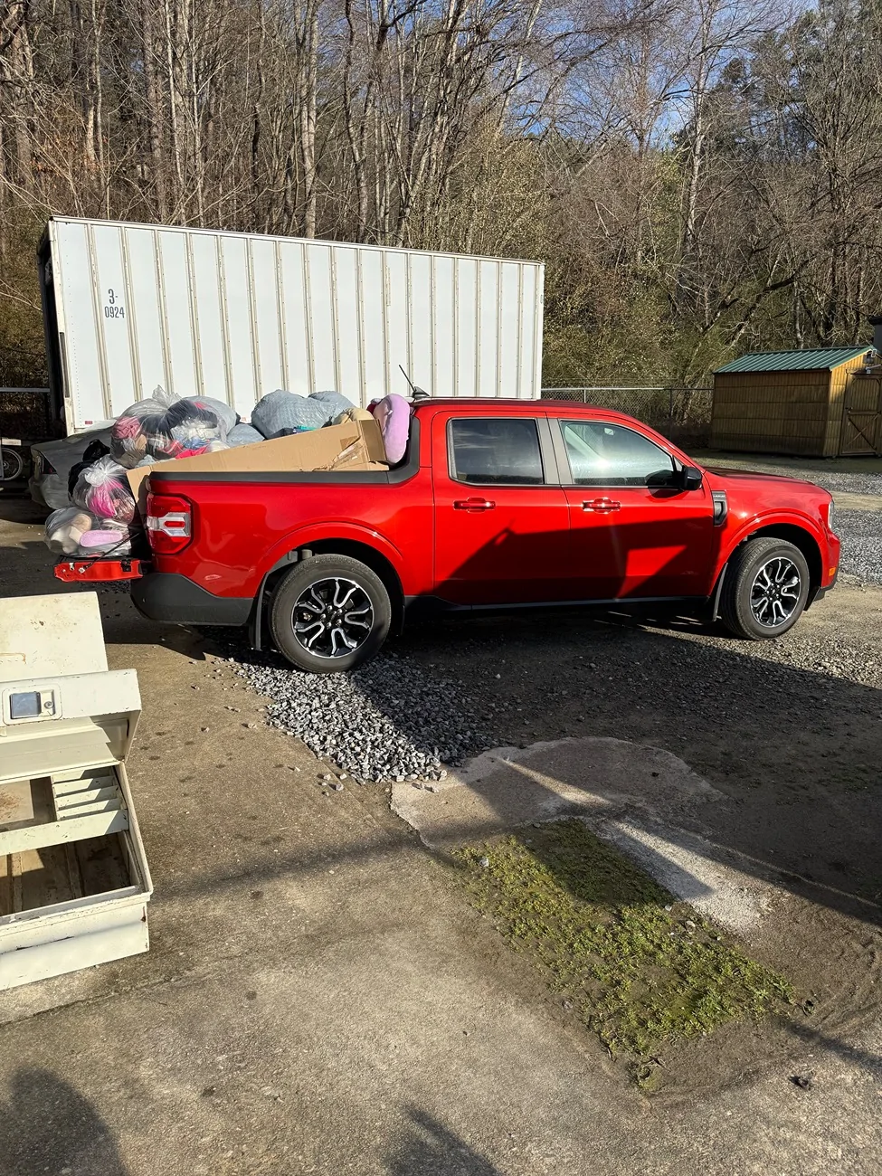

I do haul stuff heavy enough to ‘level’ mine.
If I leveled it I’d have rear end sag/Droop when I had stuff in the bed.
I think the stock, ‘Rake’ looks great.
My 2024 Lariat :
