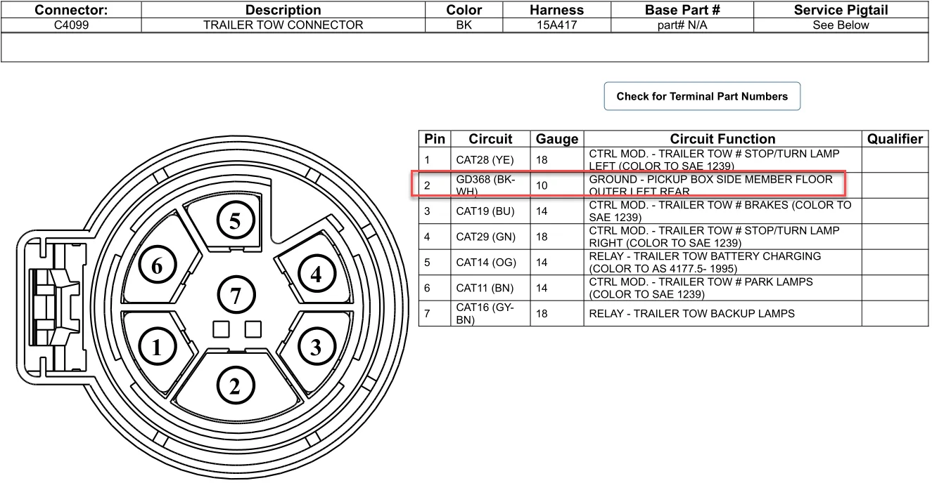

The harness for the 7+4 Pollak does have two 14 Awg at the Molex 2x6 connector for ground that are spliced inside the harness to 10 Awg at the C4099 connector:

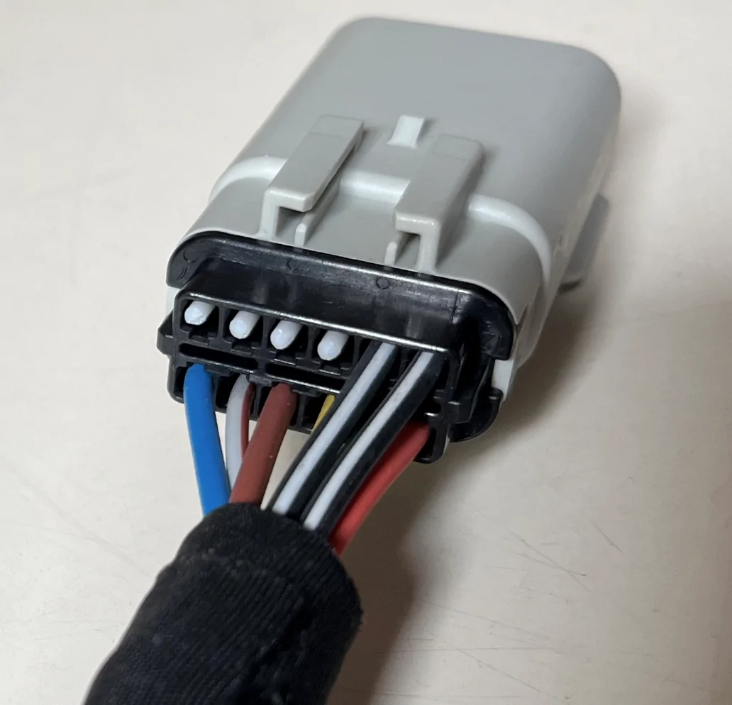

Molex 2x6 Male to C4099 7+4:

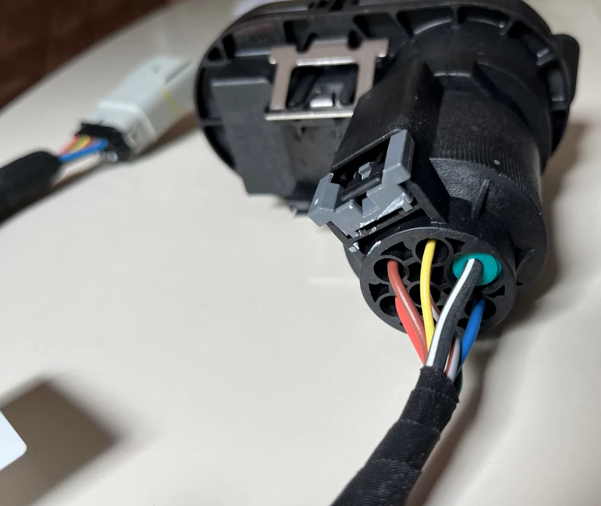

C4099 7 Pin to 7+4 Pollak:

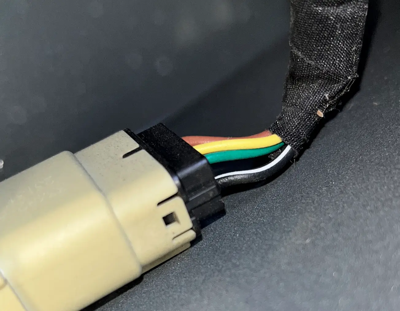

The C439 2x6 Molex male connector to 2K 4 Pin Flat has one 14 Awg for ground.
