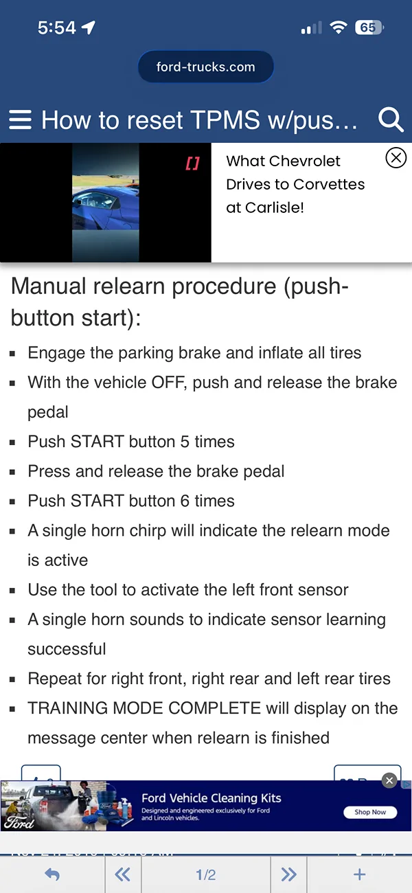

OK. Did not have my foot on the brake. You press the brake once. Then you start the sequence of turning it on and turning it off. The you press the brake once and the truck should enter learn mode.
I will try again, but it really didn't work. The truck never went into the learn mode.
I've done the sequence before successfully with this truck. WIsh there was something more straightforward for resetting. I did three vehicles today. The only unsuccessful relearn was with the Maverick (Buick Encore and Toyota Prius were the other two vehicles)
The frustrating part is that when you ask the net for help, AI produces garbage that does not apply to a push start Ford Maverick. Some of the worst answers are boiler plate on dealer websites.
I swear I did this 100 times but doing it exactly as this guy does it worked for me on my 22 Mav. I don't know if I was going too fast but doing it at this speed worked

For push button start, this method worked for my 25 hybrid AWD, just did it after swapping the steelies I had put on for winter
