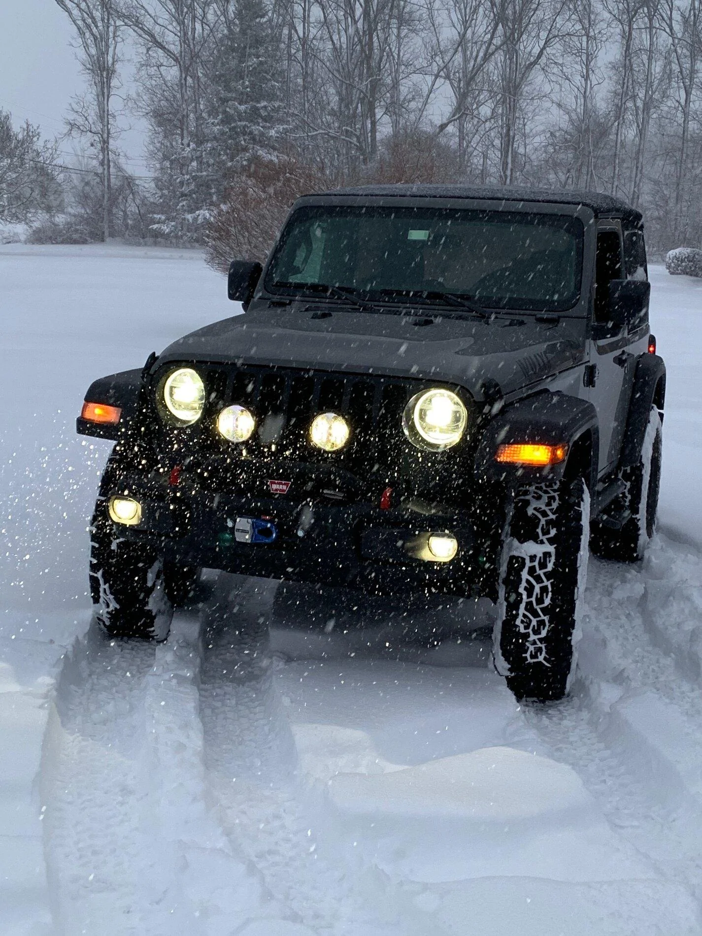

Oh they're awesome in the snow. I wasn't even in 4x during a storm in Buffalo in my Wrangler and it just pulled right thru heavy wet stuff and fluffy snow on the highway getting there.
This is at my house last winter.

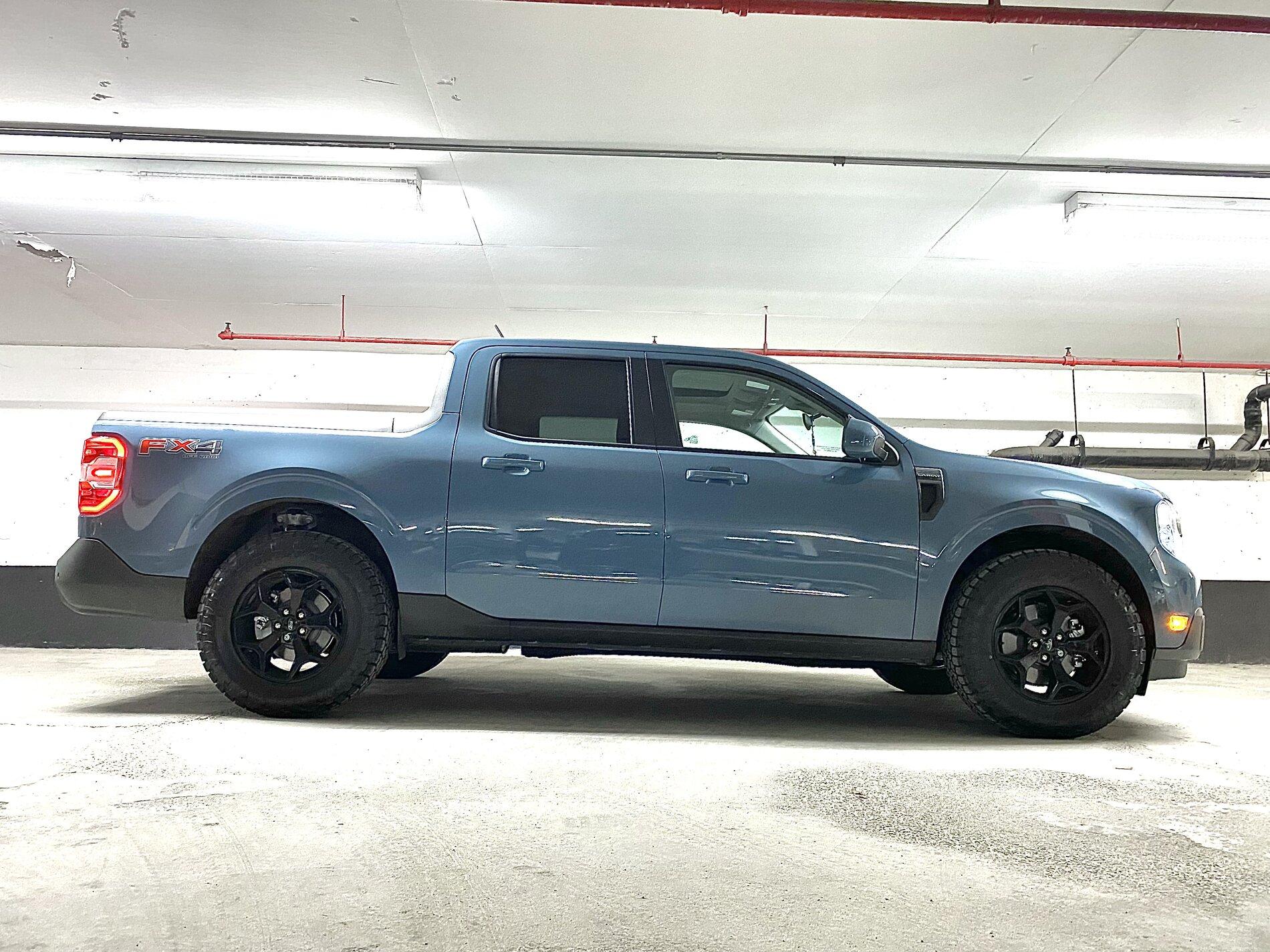

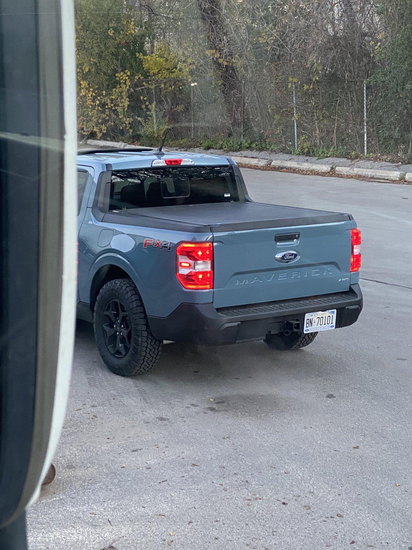

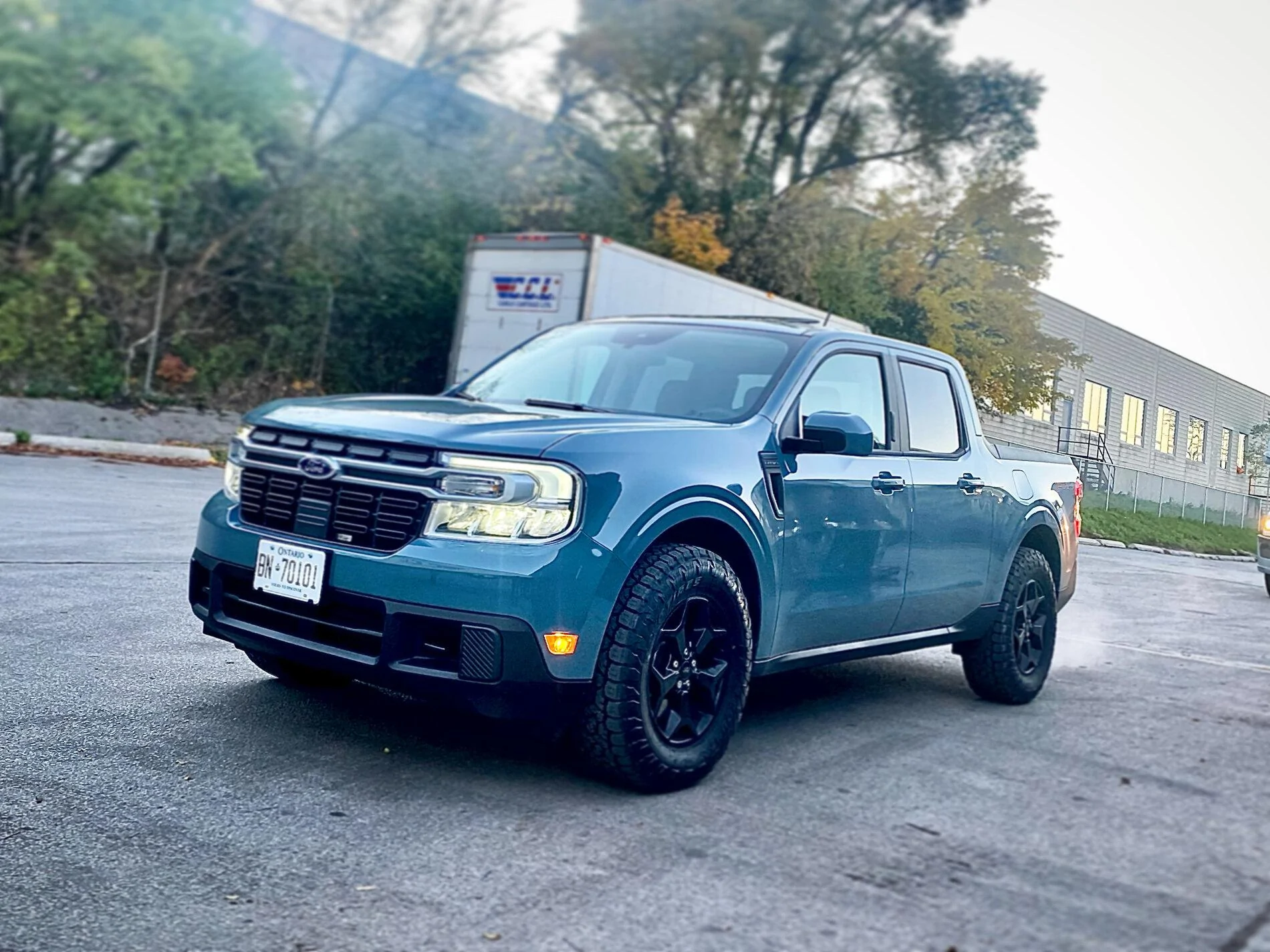

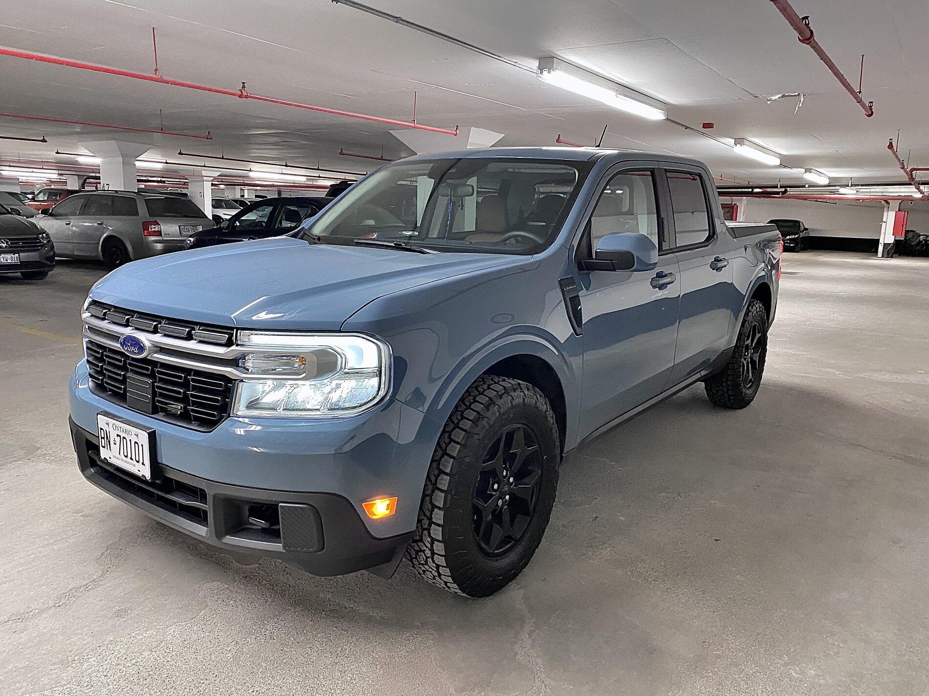

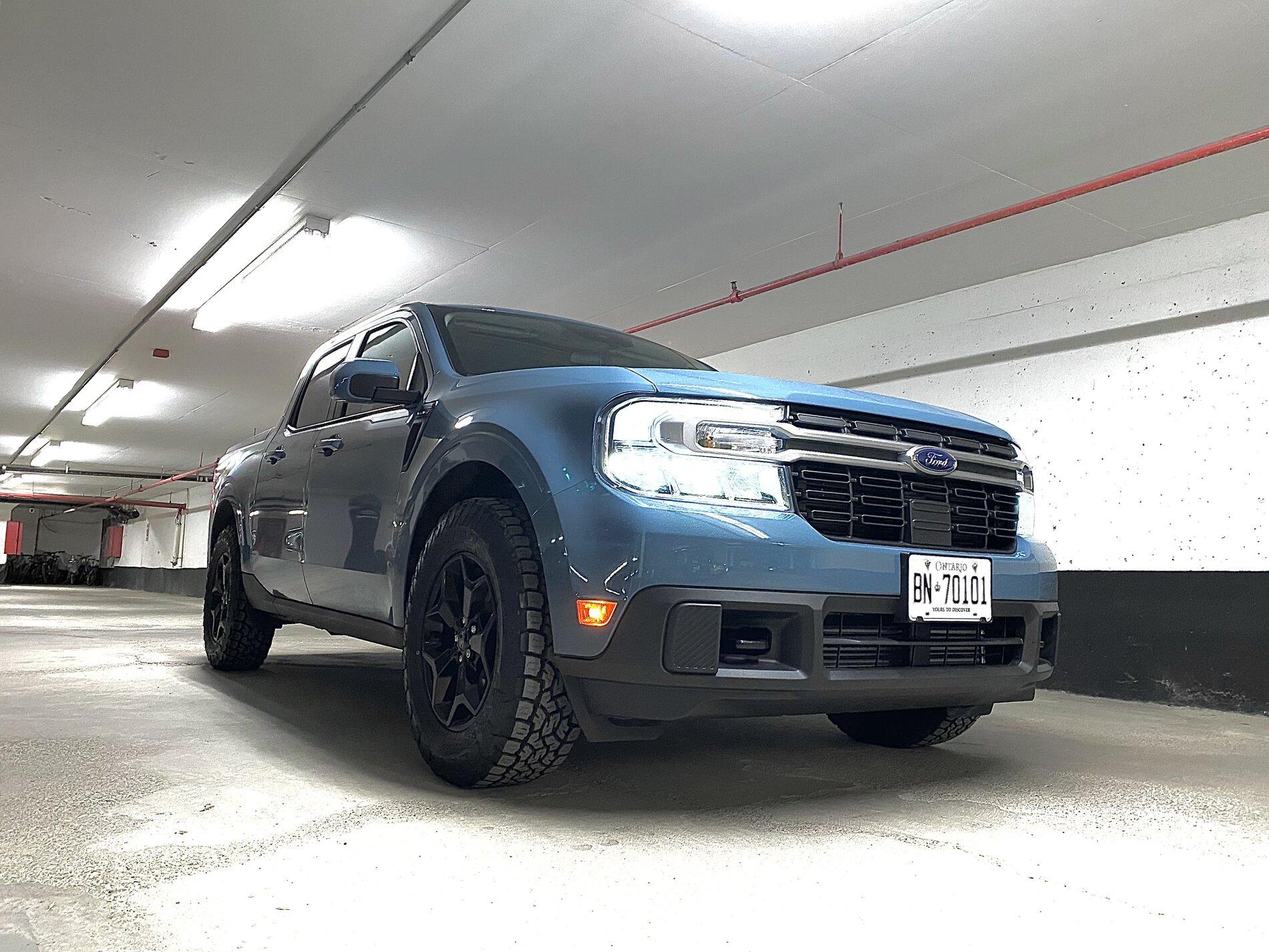

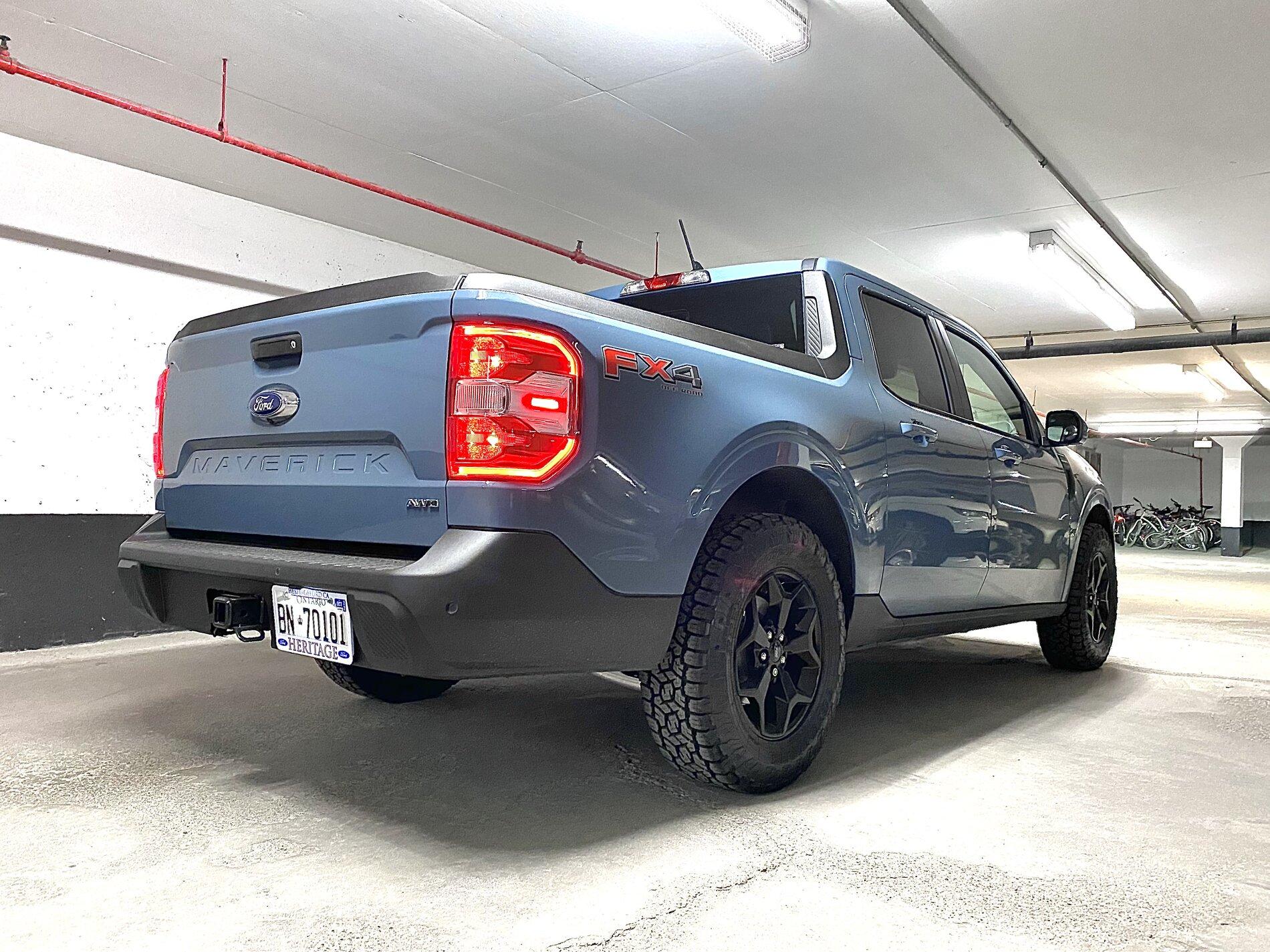

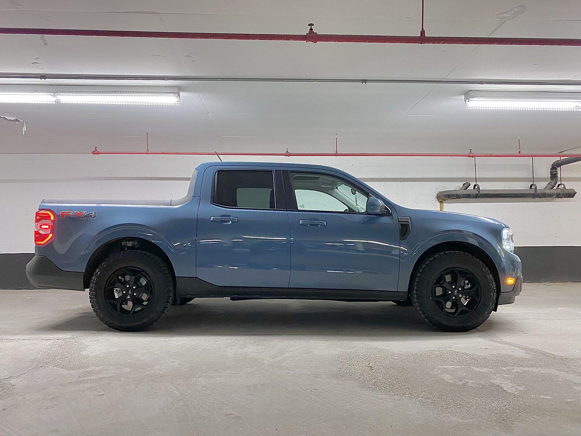

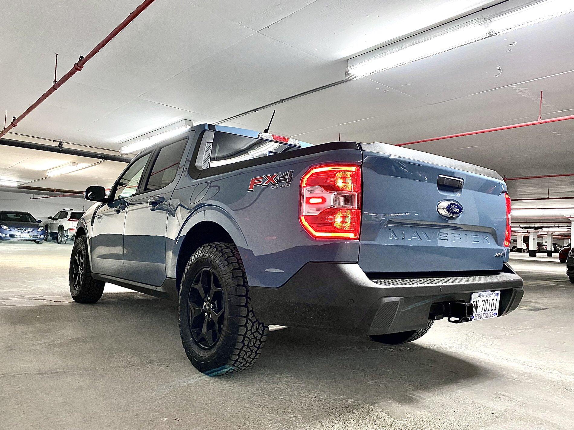

Just got my Toyo Open Country AT3’s 245/70/17 Factory wheels Lariat FX4

This truck has earned my respect. It’s useful and economical as a daily. I really do like it

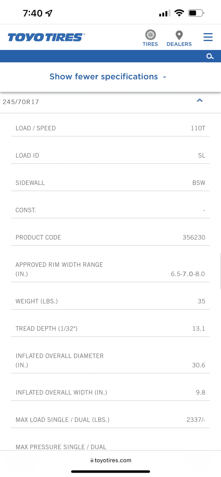

Vehicle looks great what are you getting for mpg and what is the height and width of the tires?

Thanks. Right now it’s 22mpg in the city, about 25 on the highway. The height of the tires I think it’s about 31 inch and width is 245. The tire setup is 245/70/17

The factory tires were Firestone Destination II. I wanted larger tires is why I went with the Toyos

After few weeks having the tires put on, the truck is doing 20/city and 22/Highway

I am surprised that those aren't rubbing based on how much they fill up the wheel well. I test fitted 245/70R17 Falken Wildpeak A/T3W and they weren't even close. They were rubbing the wheel wells a lot . It also did not fit in the spare tire area. I went down to 245/65R17 and the fit nicely. I would be curious to know how these fit with no rubbing and a similar tire isn't even close in the same size. It does appear the Falken's have a more aggressive shoulder block and side grabbers which may be the difference.

That’s crazy! I wouldn’t even buy this size if it’s rubbing either. I didn’t do anything to the fender well whatsoever. No lift or leveling kit either, just stock suspension. That’s nuts man!
