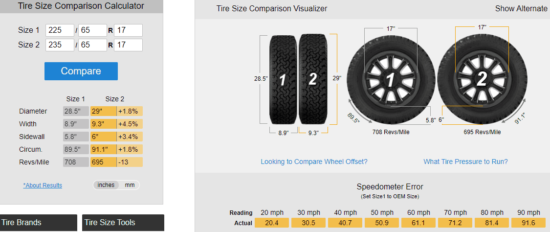

Well, Toyo has both the 225 and 235 for the Open Country AT3. I've pretty much decided to ditch the Pirelli ATRs immediately and have about decided on the TOC AT3 so I'm wondering if the 225 will be plenty good as well. Maybe go up to 235, but really weighing the pros/cons of staying with the stock sizing. Seen some great pics of some 245's but they stick out just a little much for my liking (maybe the FX4 Wheel Offset?). Seems 225 may be the right place to stay for now....maybe 235 when those get replaced.
Seems not worth recalibrating between the two if you do change but definitely would make the "full" size spare difference a bit more (215/60R17).

Get five 235’s, it will fit as your spare. Lots of tire shops will buy back new “take off” tires, that can help recoup some of your expense. Discount Tire gave me $400 for the Pirelli’s.

226/65 will be a fair bit smaller than the 225/70s you'd get if you didn't opt for the Falkens. The 235/65/17s are smaller than the base tire size, and going to a 225/65 from a 225/70 is a bit more than a 3% drop in diameter. You'd rack up miles 3% faster without a calibration, just FYI.
I'm in the same boat with wanting to swap tires as soon as I take delivery, too.
Ive got the toyo 235s ordered for when mine gets here next month
