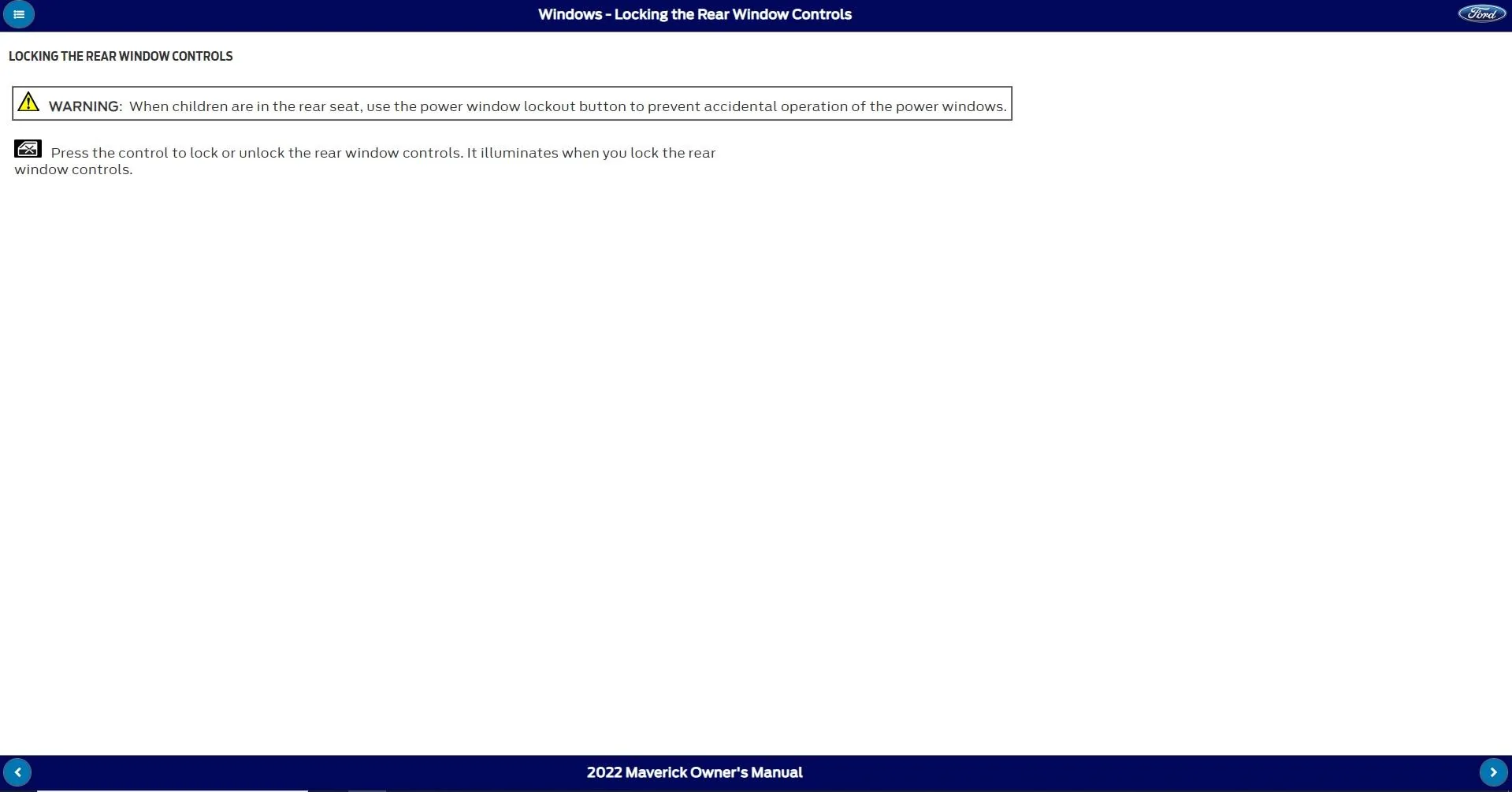

The window lock Only locks the rear windows, at least on my Lariat Lux Hybrid.
I would have thought it would at least also lock the front passenger window, but it does not.
I just tested it again to make sure before posting this. Front passenger can still roll down their window with the lock on, so can the driver.
Whoever worked on your truck needs to fix not being able to operate all windows from the driver side.

The window lock button locks out the window switches on the two rear passenger doors. At all times, lock on or off, the driver door switches can control all 4 windows. What the lock does is prevent your rear passengers from opening/closing their windows. So to test it, you’d need to turn it on and go to the rear doors.
As you note that all 4 windows open and close properly, but the driver door only controls 2/4, it does appear that the driver windows switch wasn’t properly reinstalled.
