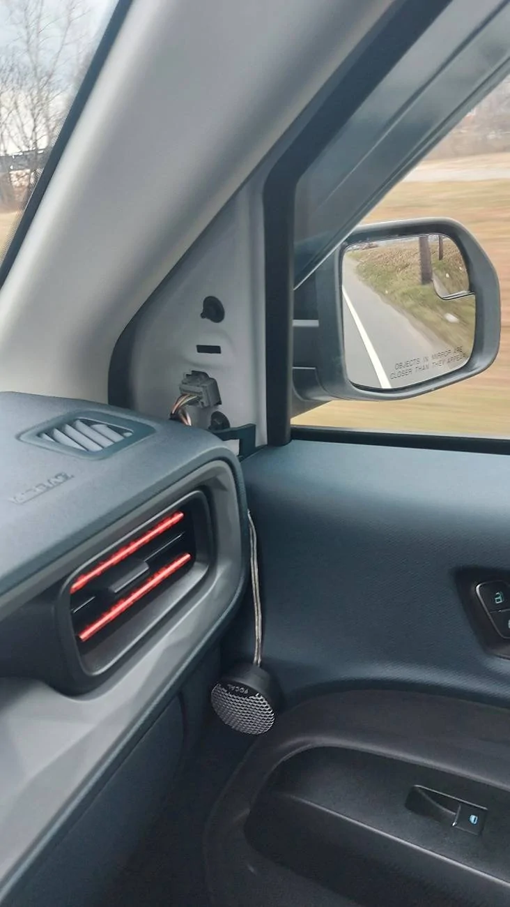

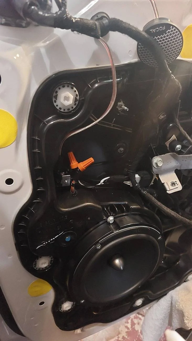

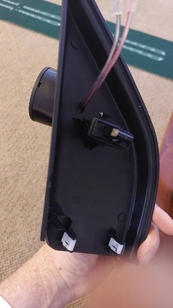

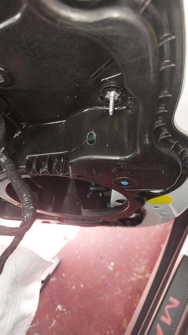

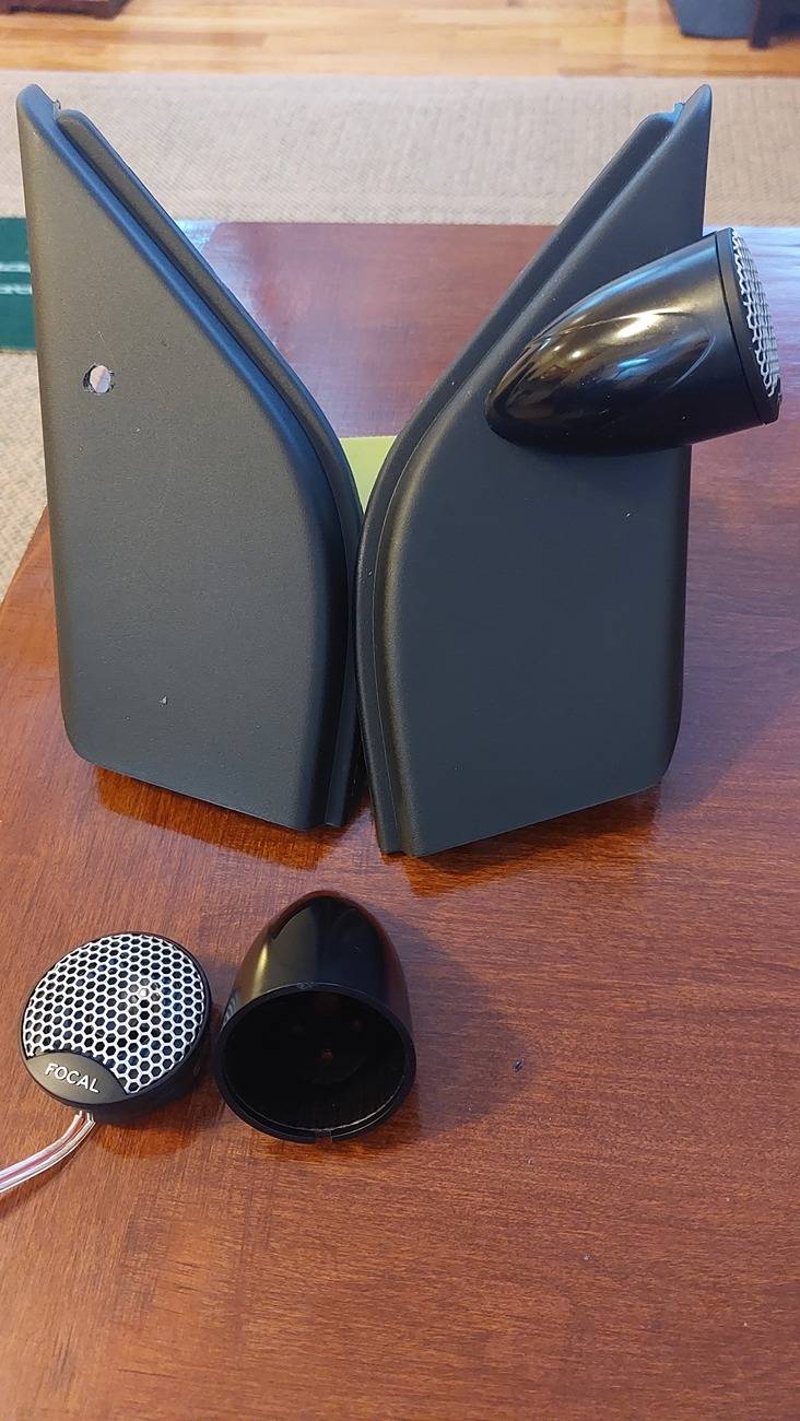

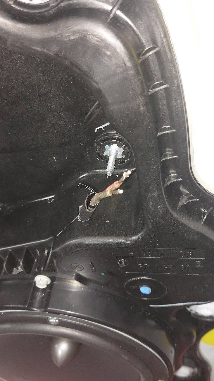

I put in Focal ISU-165 component see pics
I drilled hole top of door speaker casement to run door speaker wire up out of casement and did in-line crossover packed into empty pocket in door see door #8 and wired tweeter up behind mirror. , I had Crutchfield "Metra 72-5602 Speaker Wiring Harness" which plugged right into for plug and i just wired up speakers to it
