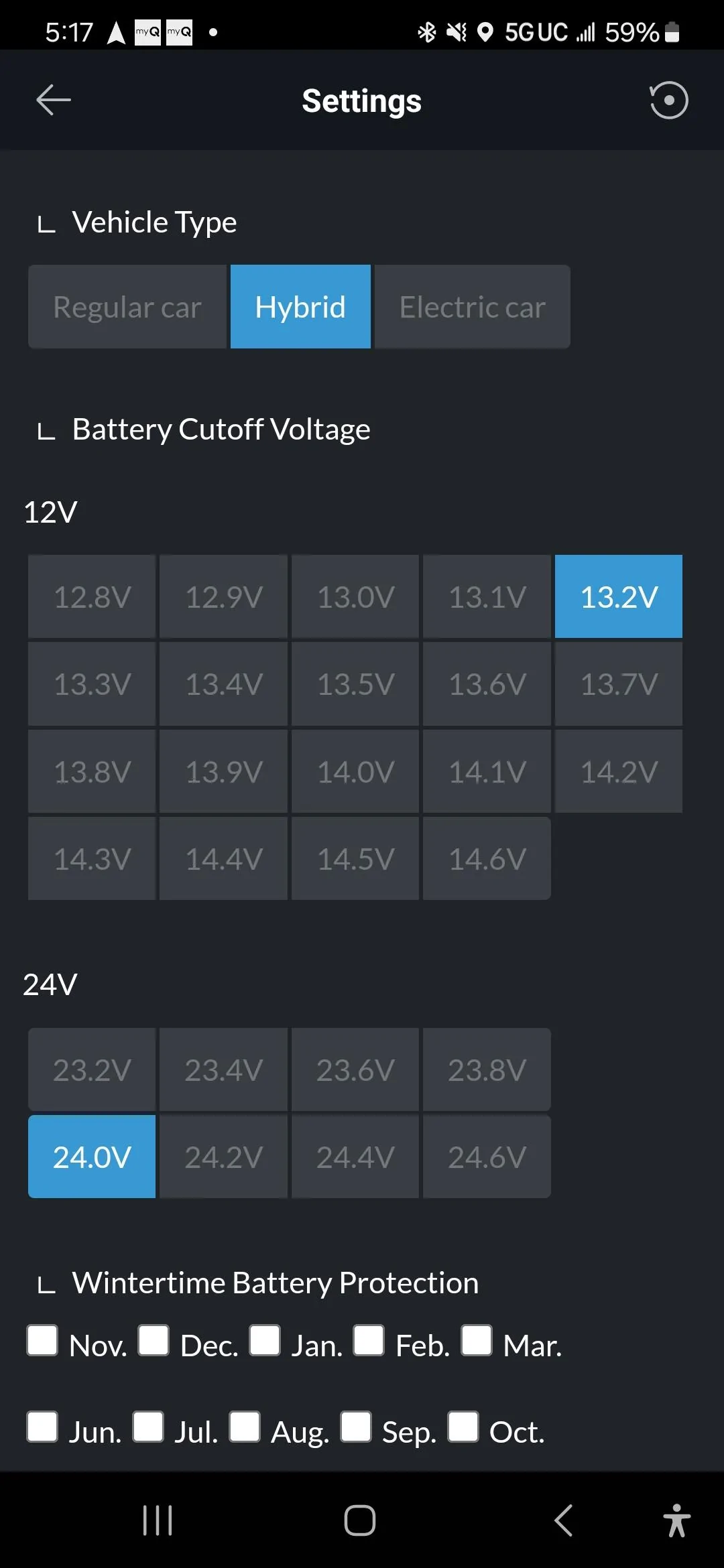

Recently installed the Thinkware Q200 hardwired to the passenger fuse box using a fuse tap to #3 (red) for ignition power and #20 (yellow) for constant power; the ground was tied to the frame. Everything has been working fine but I wanted to see if I could get any insight into the camera settings for battery cut-off (hybrid).
The in-app defaults to 13.2V when selecting the Hybrid; it was 12.1 for Regular Car. I would think 12.1V would be the setting but does it matter on the vehicle type?
Wondering anyone can recommend a correct setting?
