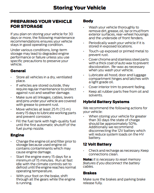

I will have to park my Hybrid Maverick for about 2 months this summer. I need to know what would be best for the battery maintenance. Should I disconnect the batteries completely, should I put a trickle charger on both batteries?
GPSMan
Jul 28, 2022
4,325
5,340
Many
Start it, let it run in park to charge the HV battery. Shut it off.
Disconnect the 12v. (Black / negative.)
Done.
At 2 or 3 years of age; put a battery maintainer on the disconnected 12v.
At 2 years or younger it can probably sit for 2 months.
