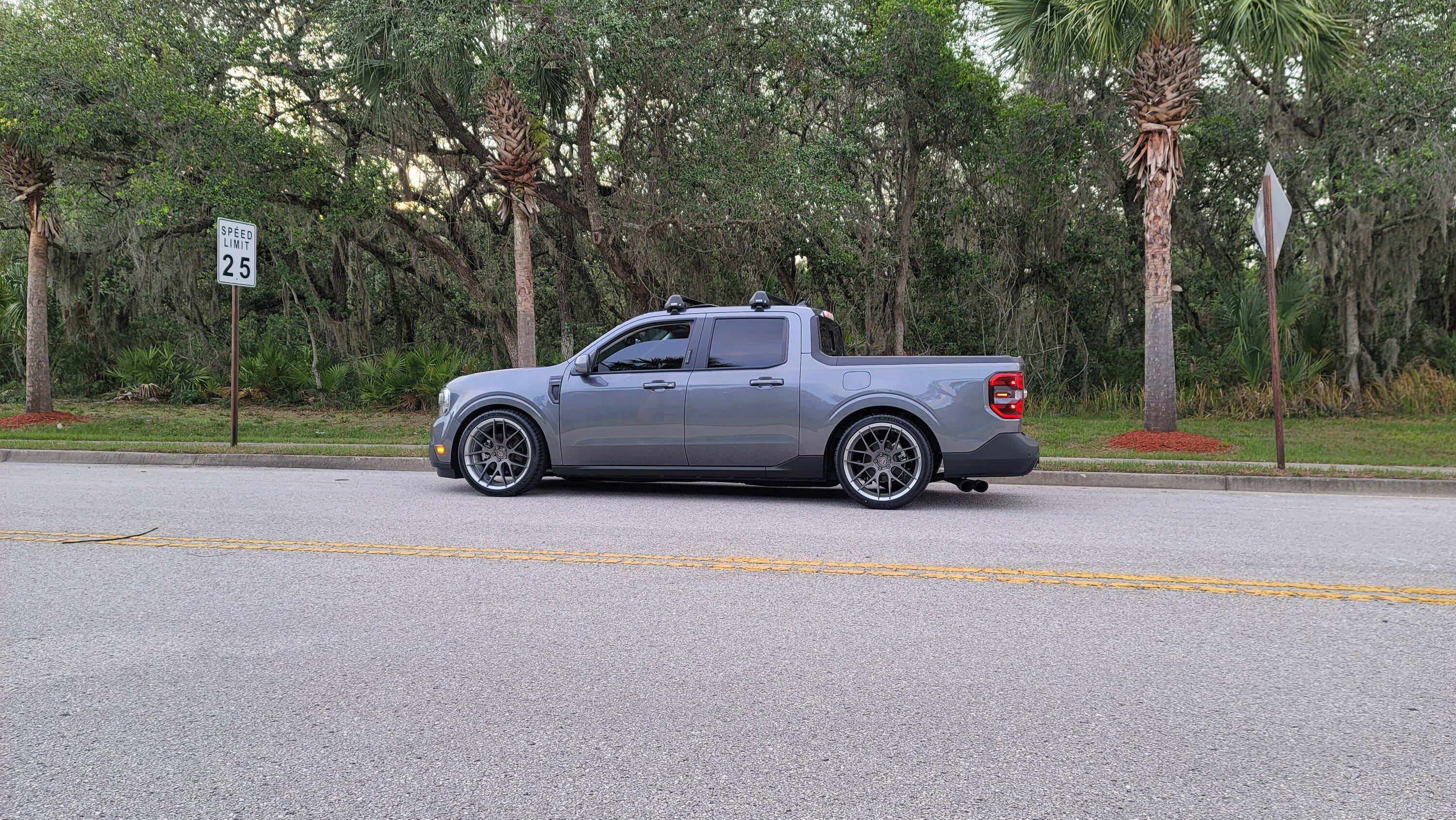

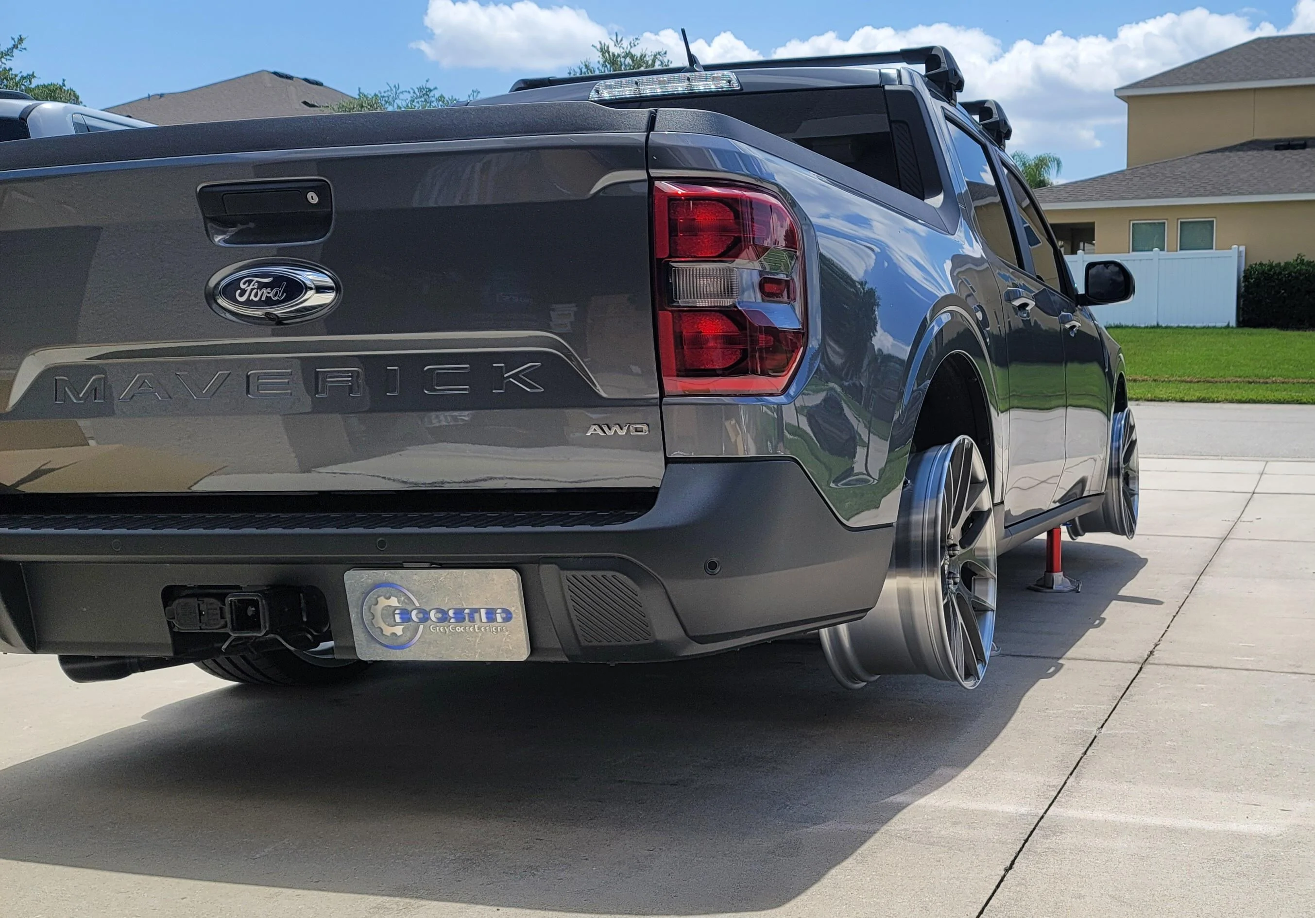

Measuring for tires for my new BC Forged wheel set up.

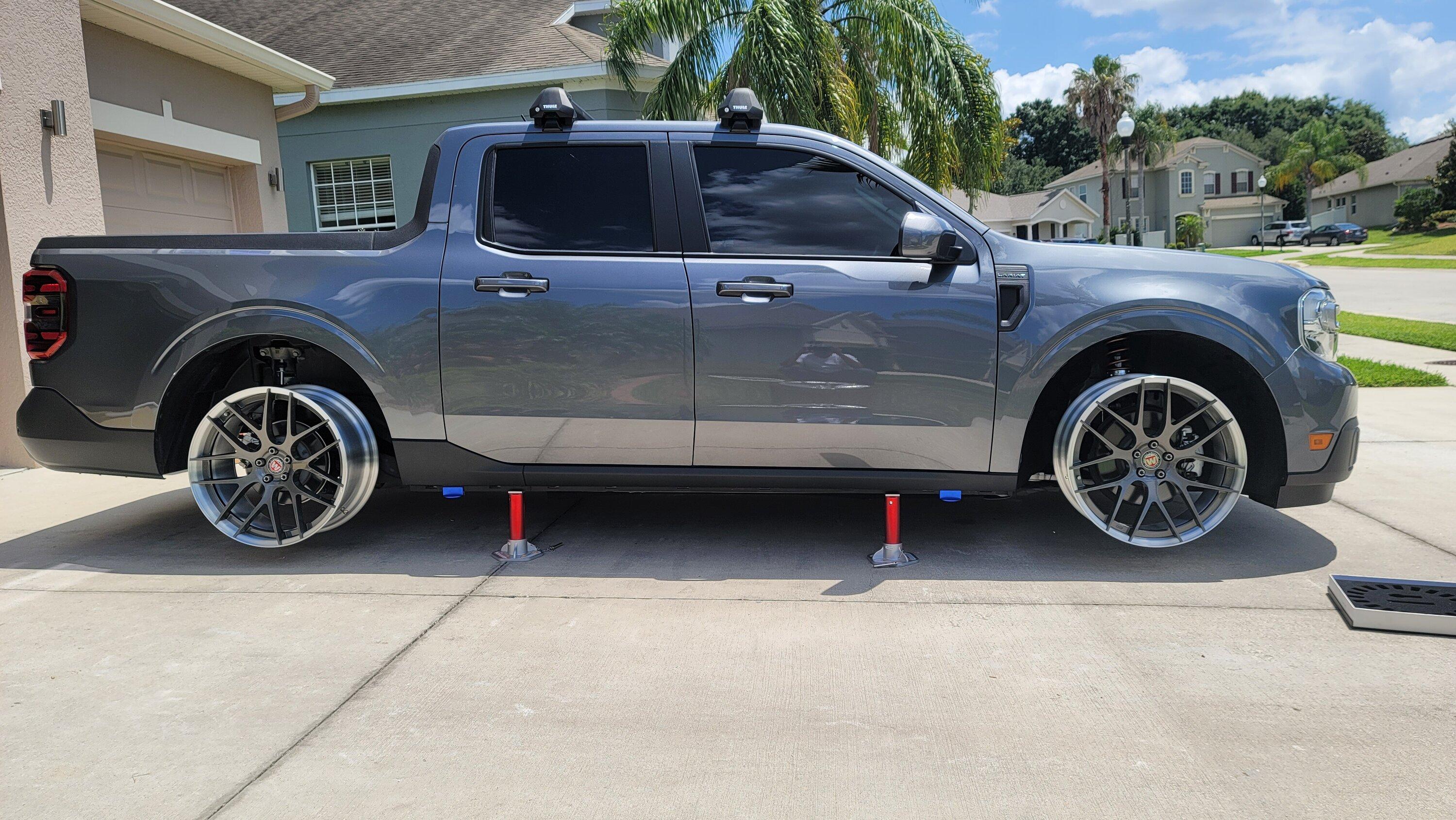

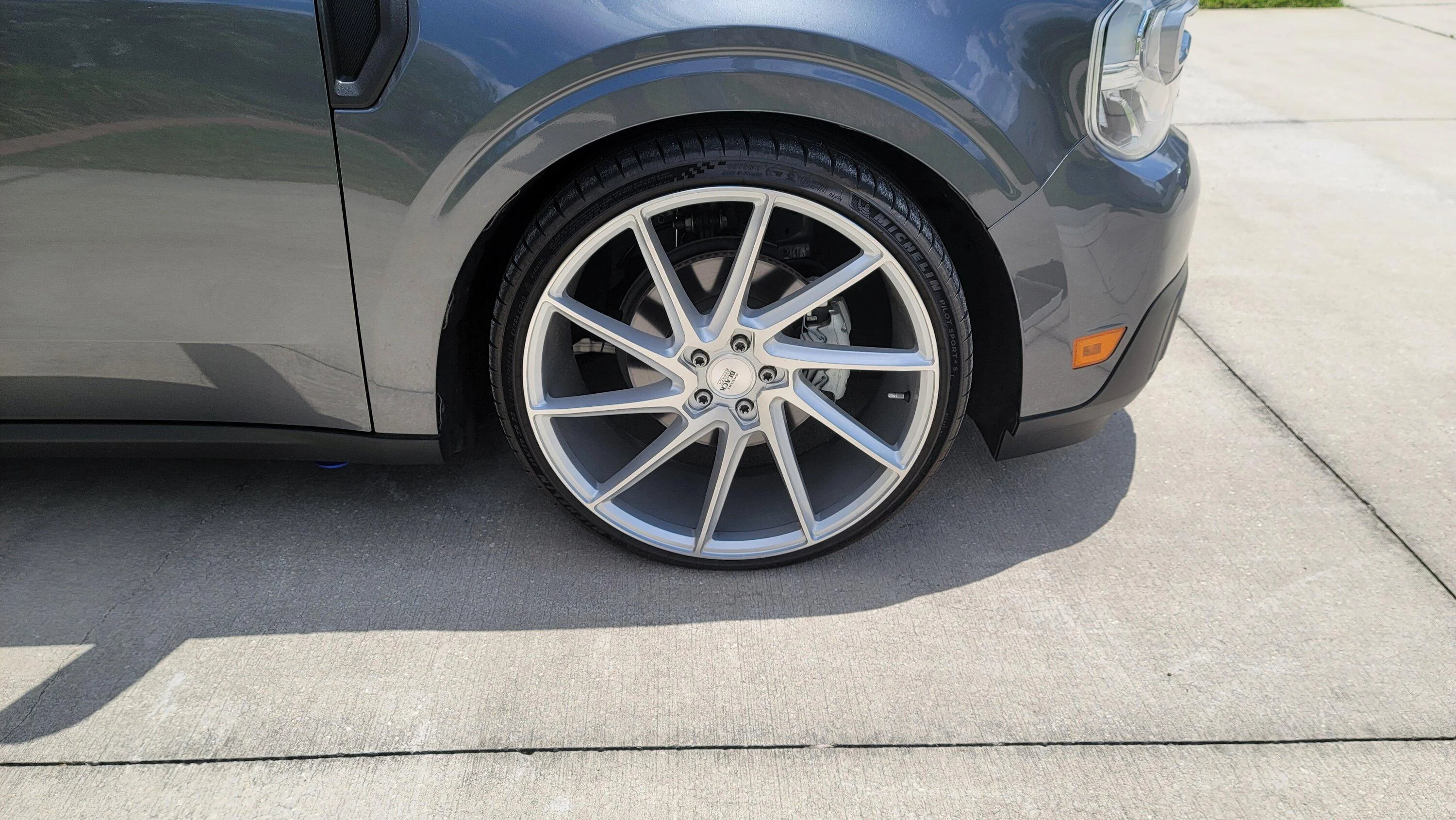

Looking like I should be able to do a 275/35/21 up front and a massive 305/30 or 35/21 in the rear. I'll have to calculate side was aspect to ensure front and rear match as close as possible. Not pictured, I will have a set of the oem version of wheel flares. They offer an additional 1/2" of width.
Aspect ratio is a percentage of tire width so with a staggered set up it isn't as easy as just matching them.
For reference, the current wheels are 22x9 on 255/30/22
