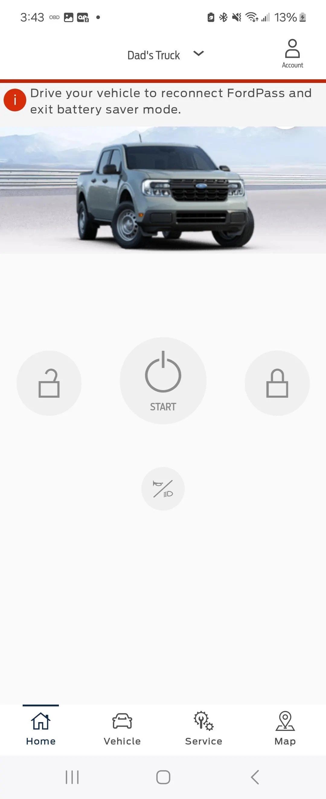

Hey all,
Recently, I replaced the battery in my Maverick since it was constantly stuck in Deep Sleep mode, and I don't really want to get stranded on the side of the road.

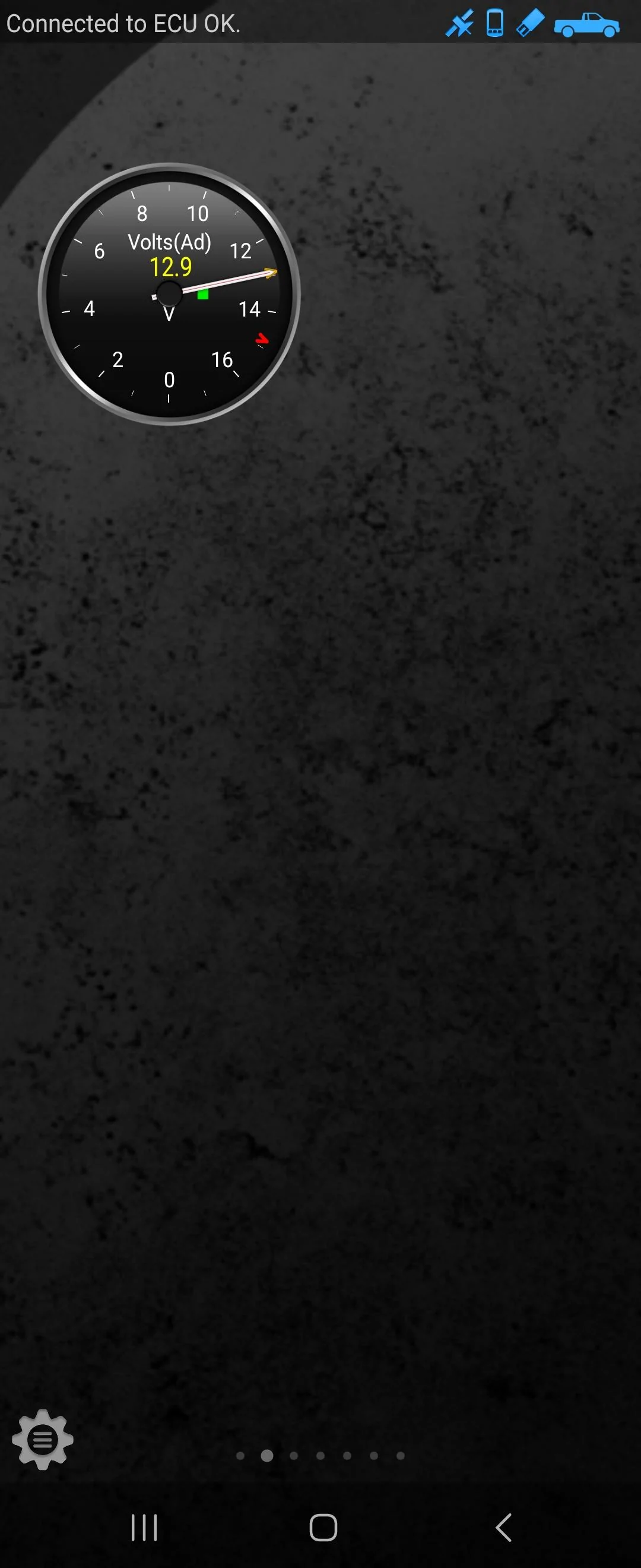

So after a bit of looking, I pulled the trigger on an AGM battery, and I performed the BMS reset procedure as seen in the manual. I also left the Maverick locked for 8 hours to ensure that the computer relearned everything.
The next day, the Mav does not appear to exhibit any symptoms of Deep Sleep, as the interior/exterior light turns on when the truck is unlocked, and the battery holds a steady voltage between 13.0V-12.5V.
However, FordPass still insist that I drive the truck to exit Deep Sleep mode, which is what I did, but it never work. Out of curiosity, I headed to FordPass Connectivity on the truck's setting, and I was greeted with an infinite loading screen. I tried hard-reseting the infotainment system to no avail.
Does anyone else happens to have the same issue?

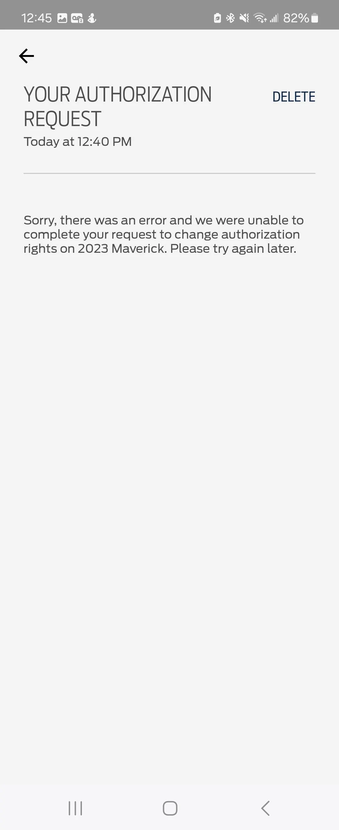

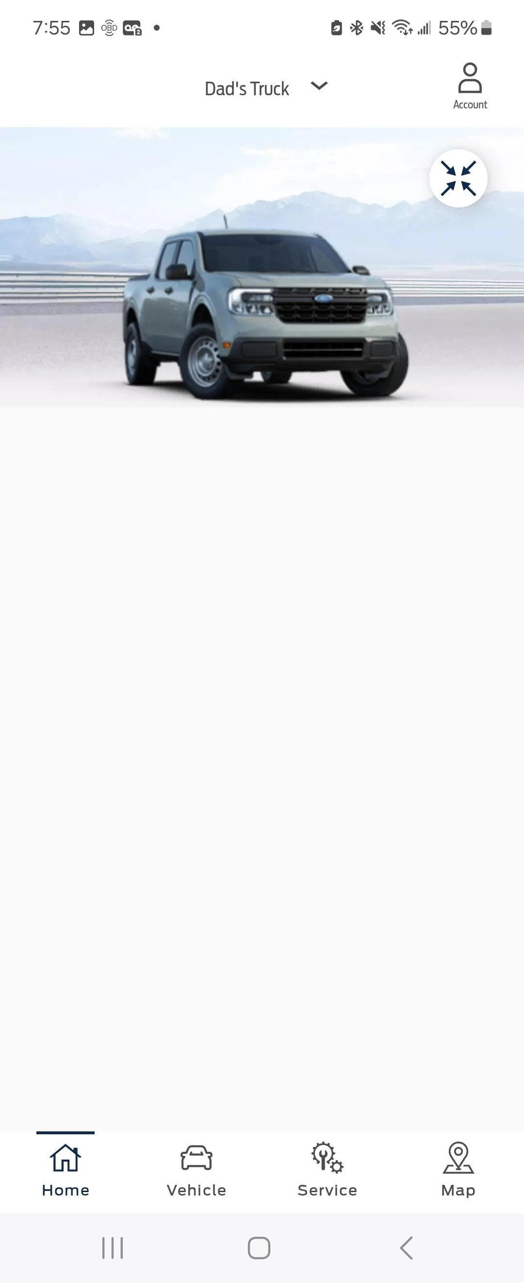

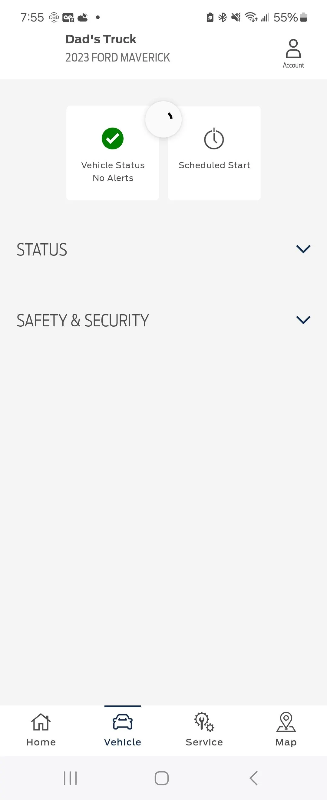

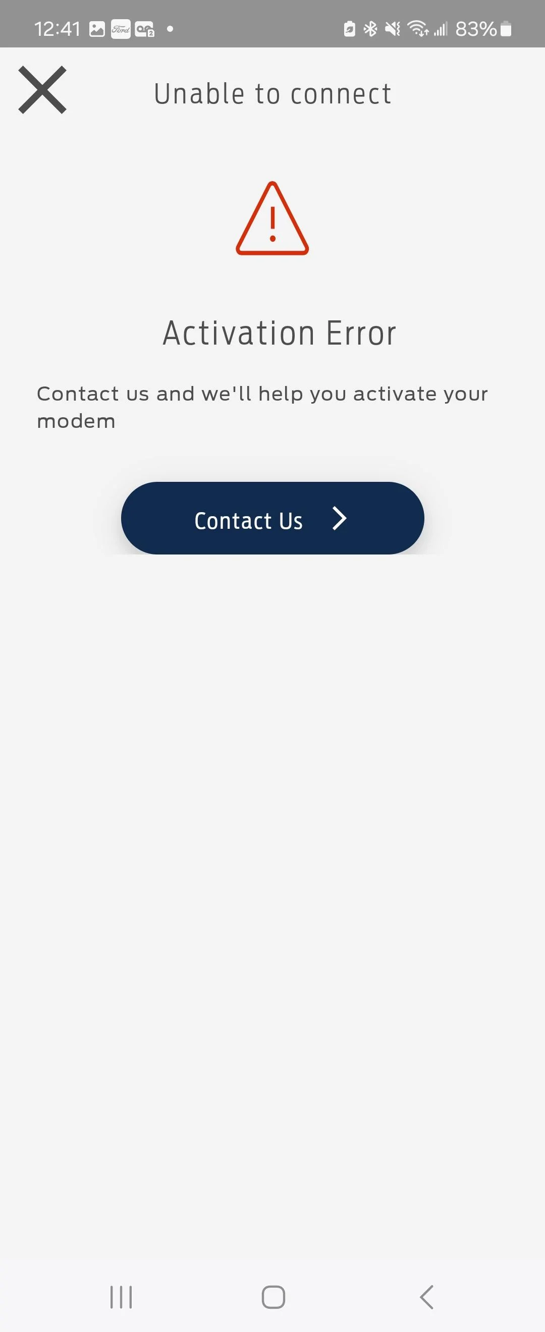

Well, I am glad to say it is solved, and it was indeed a very stupid mistake.
While hooking up the sub, my dad took out the fuse for the Telematic Control Module (by accident or not knowing, I'll probably never know). After reinstalling the fuse, the previously broken Connectivity screen now works and shows all relevant data. Thus, FordPass now works again.
