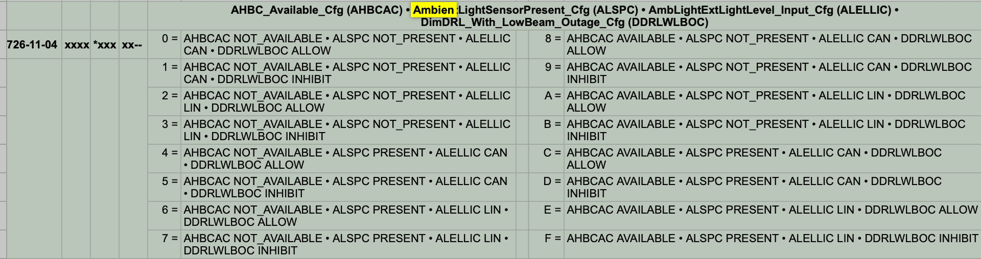

Problem is, the maverick comes by default with the value set to sensor not present. Weird, as it is obviously there and working just fine. The fact that it is also set to slow_fna is pretty much irrelevant considering the previous point.
Trying to set the sensor present to 1, setting the sensor tyoe to Fast_ROW, or both to present and fast at the same time, results in a failure to write due to incompatible config. Seems like this is completely diferent in the mav.

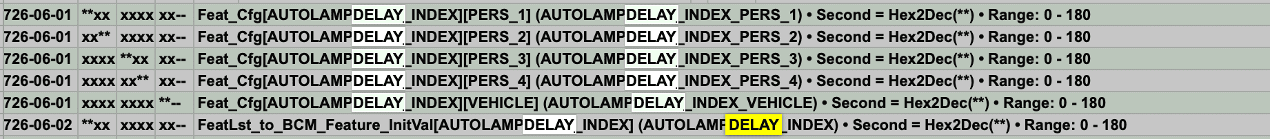

P.S. I already messed with the Autolamp Delay setting, it doesnt affect the time to auto-ON.

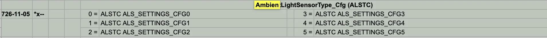

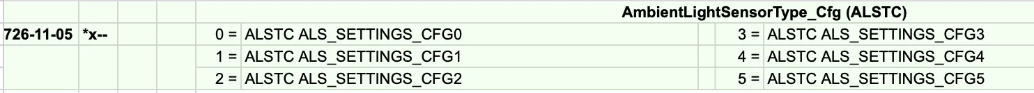

Hello, today I solved the problem on my Lincoln.
Maybe it will be helpful for you.
Try
726-11-05
5xxx
For my case (but it was in another bit position and before writing here I checked the Maverick spreadsheet), it was 3 by default (and as I can see different AB from different MY22-24 Maverick it's the same - 3)
I tried from 0 to 5 and only five helped me. I put the lamp selector in Auto, cover sensor by my hand, and whoa 1-2 sec - the headlight turned automatically
Sorry for taking so long.
CONFIRMED: your method works flawlessly on my truck, thank you for your work. I will update the title and OP to add the info and give you credit.
