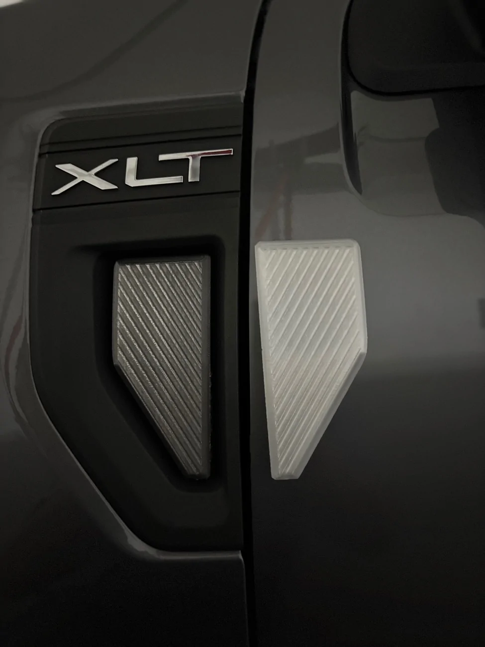

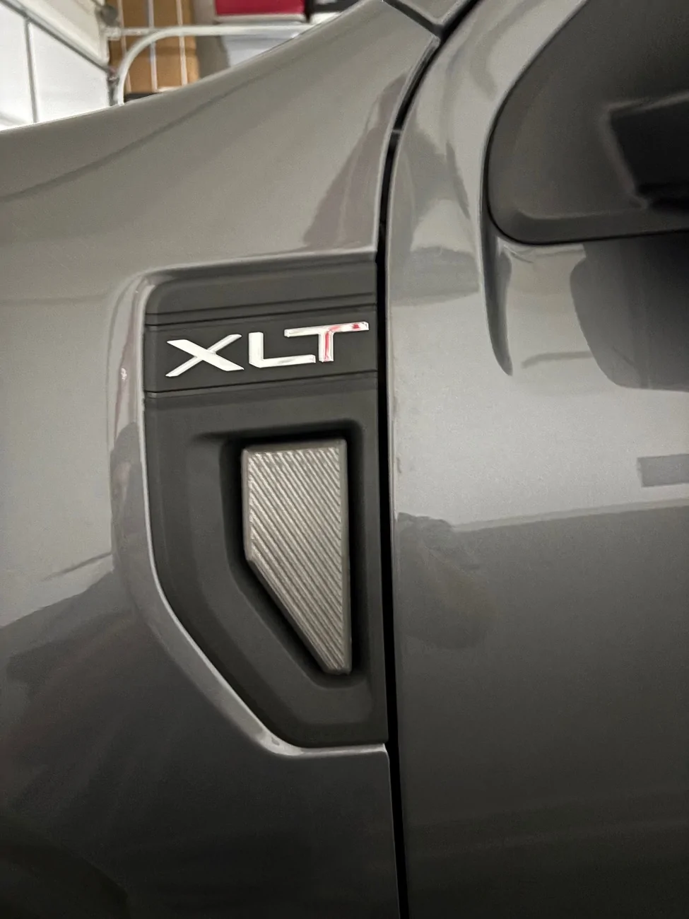

I decided to modify the side makers into turn signals like so many others on this forum have done and I used the GadCAD3d.com lenses. I ordered Smoke but they mistakenly sent me Frost. After contacting them about the error they could not have been more accommodating and sent me the correct color that same day. Better yet, they said I could keep the Frost pair which is great because I like them too and may change them out one day. I love doing business with a company that stands behind their products.

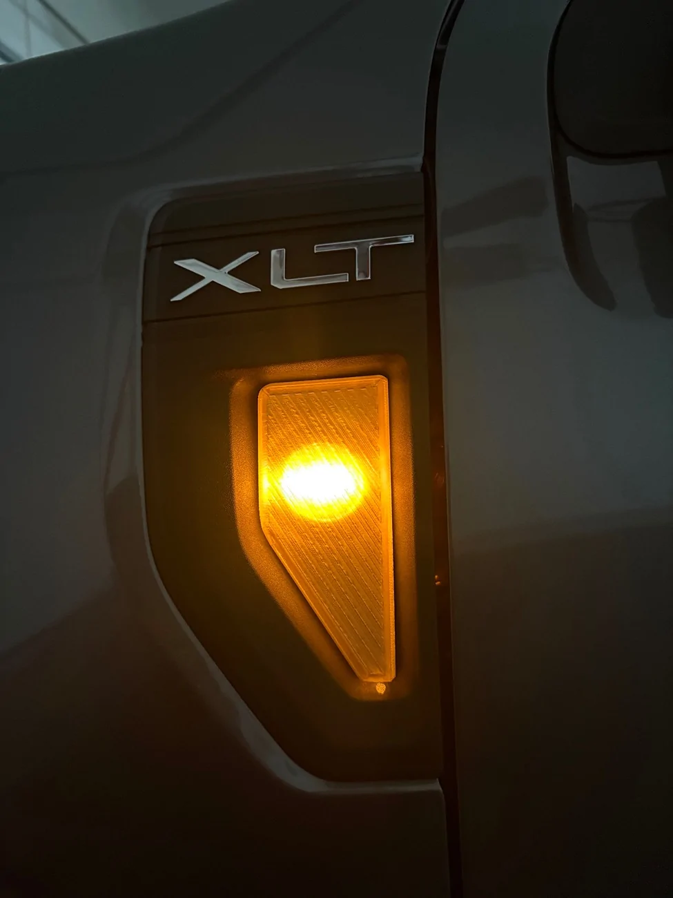

I did that mod using the GadCad2 amber lens to match the side lights and to get an OEM look. As stated in this post, no need to remove the side emblem. Drill in place. You can find the button style amber LED lights in many places online.
I used a new 3/4" paddle bit. Drill a pilot hole first. I ordered 15 feet of 4 conductor 22ga stranded wire in cable form and wired it into the the side marker light on the driver's side. Then ran the cable to the passenger side emblem. I used small zip ties to secure the cable plus some friction electrical tape where needed.
I soldered and taped the connections using automative friction electrical tape, not ordinary shiney tape. I don't trust the tap style connectors.
