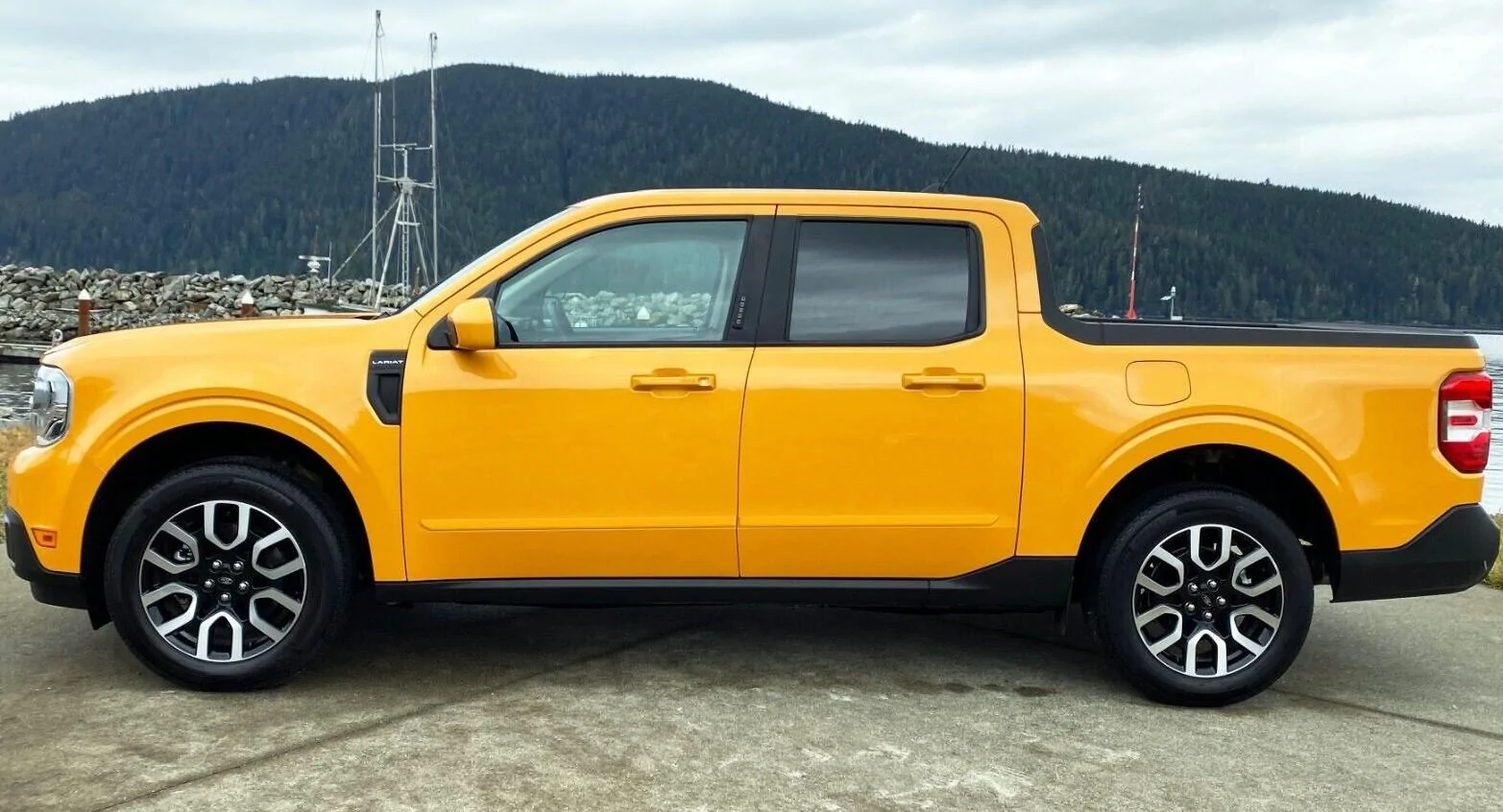

Oh yeah so they are. But Amazon doesn't seem to offer the lower version which I think looks sleeker. Maybe not as effective though, but still a better look.

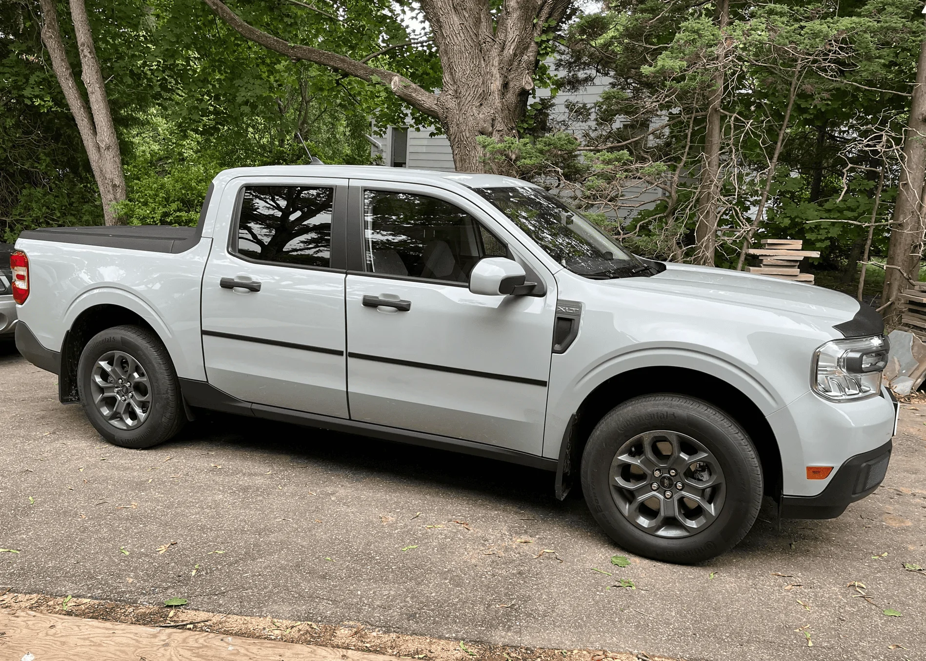

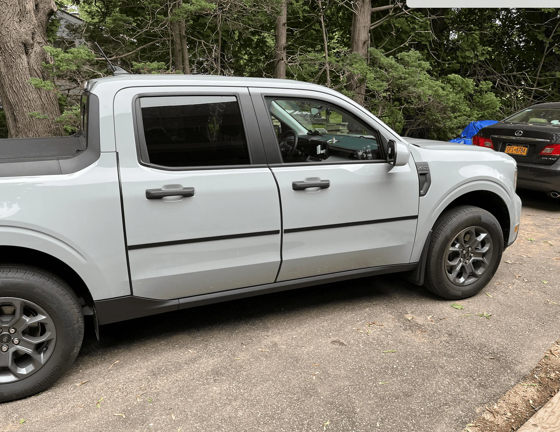

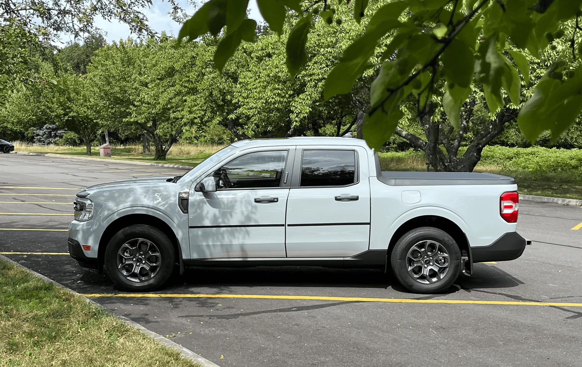

Has anyone found a moulding to apply to the doors to prevent thoughtless people parked next to us from dinging our doors with theirs. With all that open flat space on the Mav doors, it is a must for me.
The OEM moulding is far too low on the door to be useful. Need something to go mid door

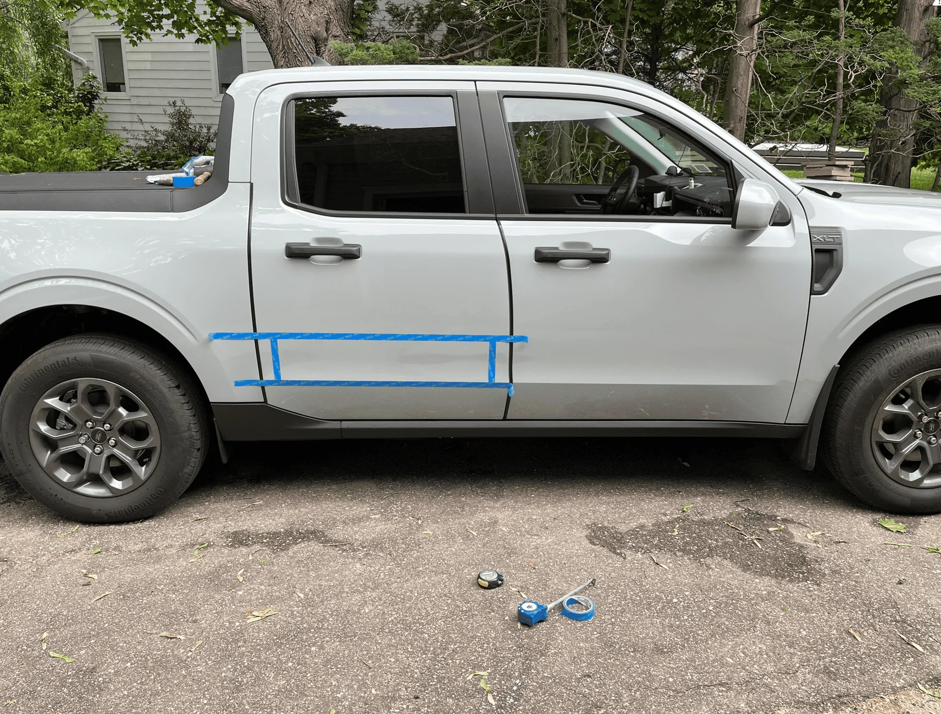

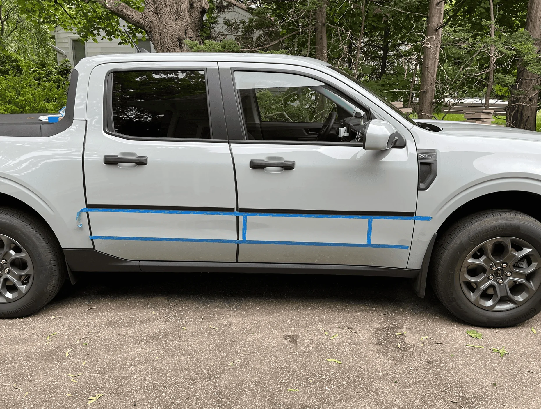

Yes - here's what I used :
It works well. The trick is to use painter's tape along the natural bend on the door as a guide. I went up 7 inches from the bottom guide. The pics should hopefully be self explanatory.
For a minute it looks as though they aren't there. (BTW, clicking on the photo did not enlarge). The look is more closely aligned with the exterior design of the Maverick. Nice addition to an already beautiful ride.
