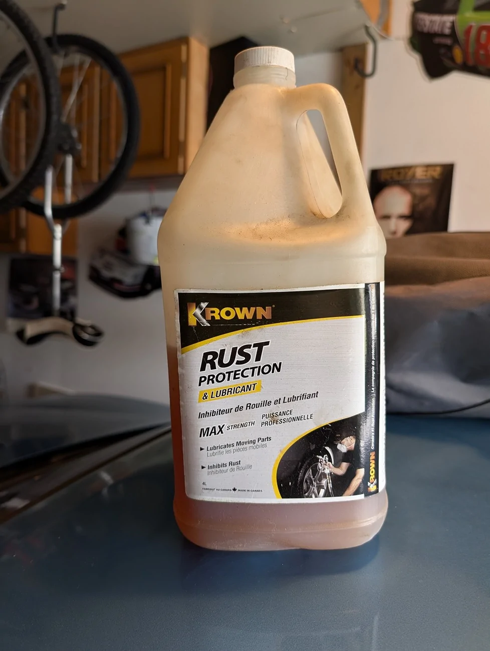

Just don't get a hard undercoating material like Ziebart or others. After a few years it will bubble up and hold water against the metal and promote rust instead of preventing it. Use a liquid or greasy compound like Krown or a cosmoline or lanolin compound with a creeping agent in it and update it every year. It will make a bit of mess in your garage every year, but it works an awful lot better. All of the dealers for all manufacturers around here use Krown underneath and Line-X or Rhino in the box. Also Krown is warranted not to mess up your hybrid battery connections.
