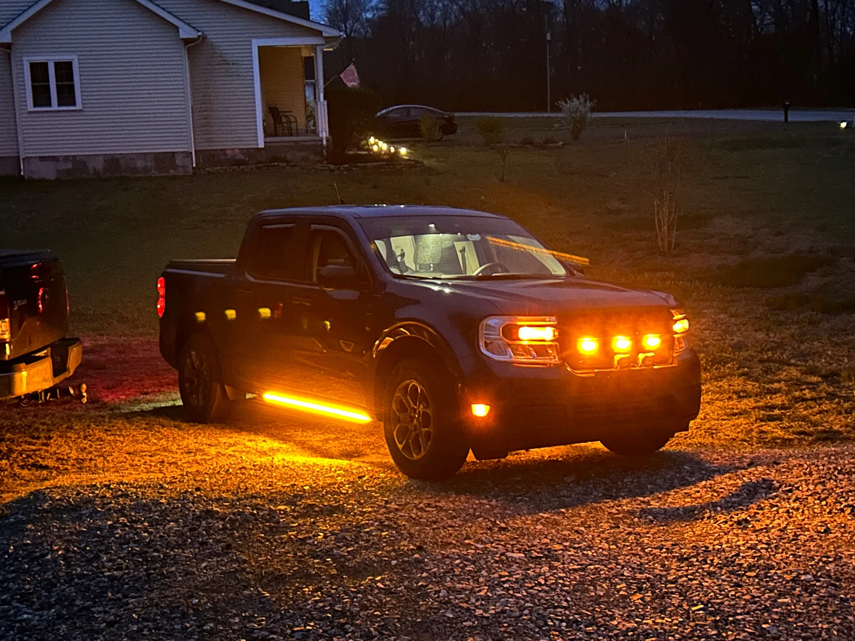

These fit perfect under the cab, 70" long, Sequential signals , and full length parking lights.
I did not hook up the white courtesy lights for the yellow parking lights are fine as courtesy lights.
I tapped in the parking lights on front. bottom bumper marker lights( tap into both sides, for if you try to hook into only one side, which I did, it will not light both side for some reason).

Video shows signal , then parking light.
