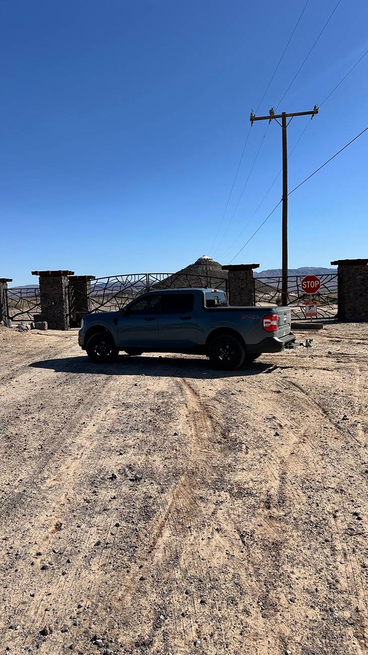

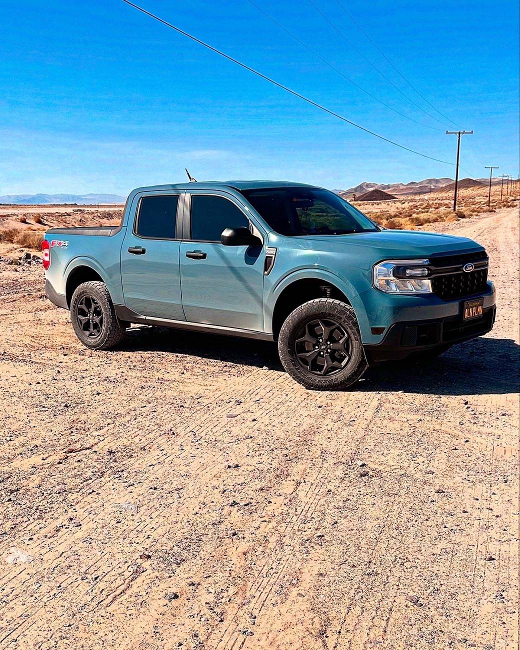

Installed 2” rough country level kit, very easy to install.
I also upgraded my tires from the (stock 225/65/17 perelli’s scorpion AT) , to 245/65/17 Toyo open country AT3
love the way it feels and rides, took it on some gravel and dirt roads, never felt like slipping or sliding, nor top heavy.
Ford Maverick Rough Country 2" level kit installed AD45B921-3D98-4D18-80D7-586F710697BC
Ford Maverick Rough Country 2" level kit installed IMG_2659

Is this the "spacers" kit, or the "shocks and springs" kit?
I've seen comments here saying the spacer kit is trash, I'm curious what makes it so bad?
Alan the Pool Man
Alan
Sep 18, 2023
los Angeles
anrpool.services
2023 Ford Maverick XLT area 51
Thank you, from start to finish it was about 4-5 hours once u get on side done the second side is super fast. Stock Bolts weren't super hard to loosen.
This is the pre assembled spring/strut combo in the front, and the rear spacers/shocks/spring combo kit.
On there website its $599.95.
it comes in 3 boxes,
Box 1 pre assembled strut/spring
Box 2 springs
Box 3 shocks, spacers/bolts, and springs alignment adaptors.
