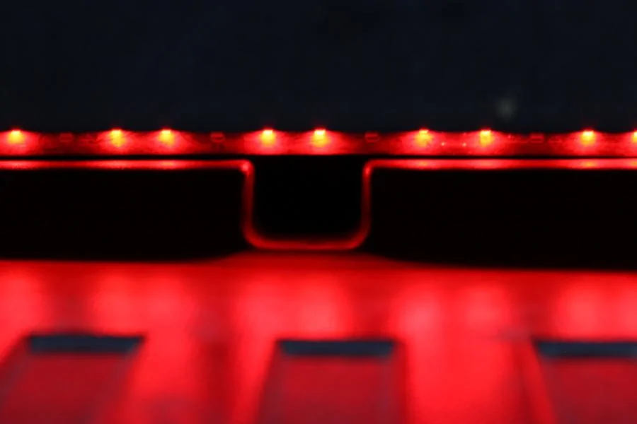

On the installation of the lightbar did you have to deal with running the strip over the hole that accesses the spare tire release?
The lightbar runs along the top edge of the spare tire access, as seen in this closeup photo, and does not obstruct the opening.
Also, plugging the lightbar into the hitch plug cancels out blind spot detection, so I wired a 4-prong plug to my driver-side tail light (with one of the turn signal wires crossing over to the passenger-side tail light) so I didn't have to plug the light bar into the hitch plug.
And -- I assume this is due to circuitry -- the lightbar does not come on as parking or running lights.

Thank you! I thought that’s what I saw in your video but this confirms it. I like not having to plug in to the hitch plug too.
