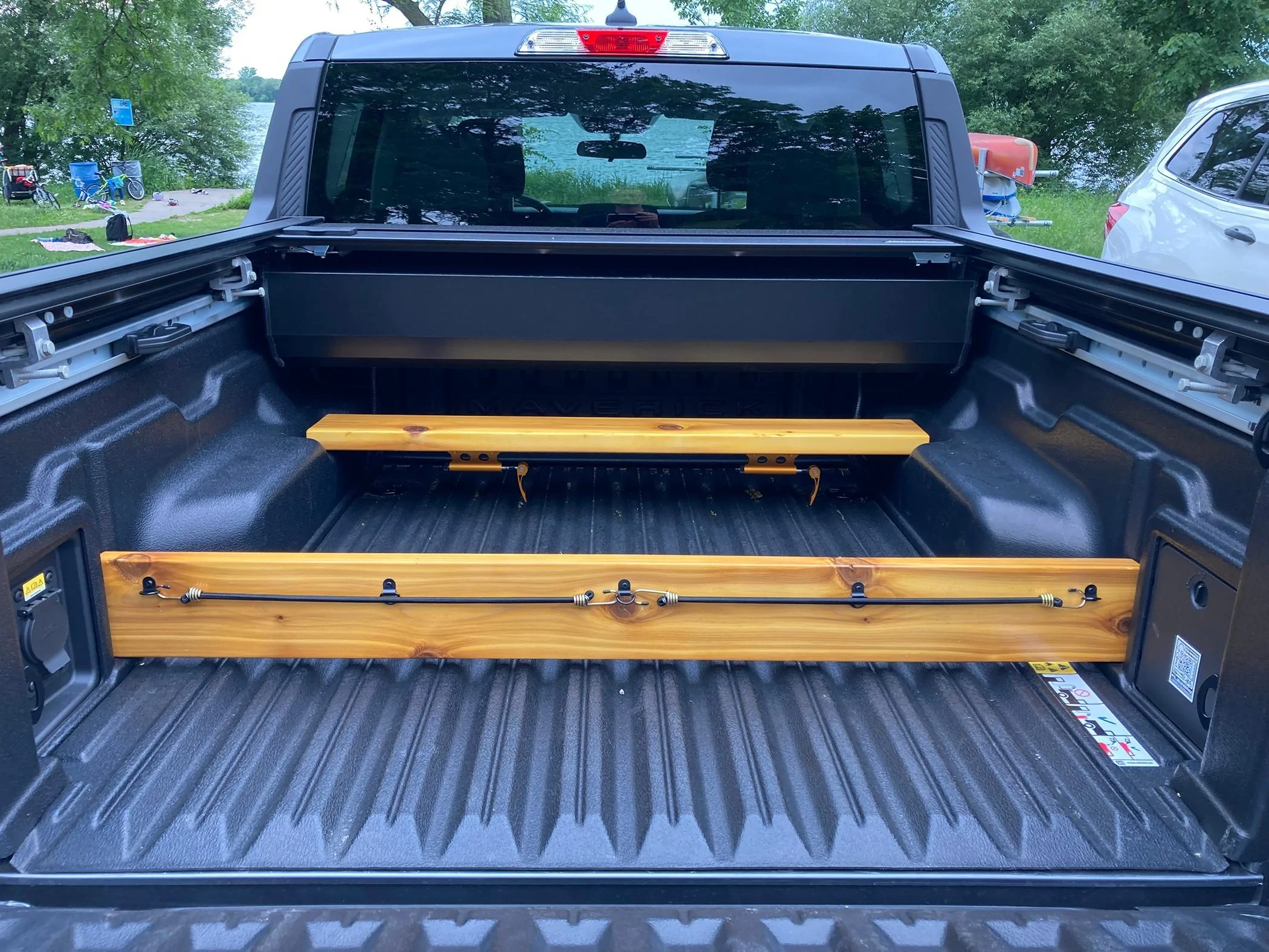

Am I right in thinking the board closest to the cab is not held in place by anything; so it's the Bungees that are actually holding everything down?
I just bought a SportRack 2 bike trailer hitch rack for $250. Works fine.
Hah! Thanks. I used some Cabots Gold leftover from another (outdoor furniture) project. And you are totally correct about the board closest to the cab — the downforce from the ratchet strap holds it in place. BTW: Love love the profile pic of St. Joe. :thumbsup:

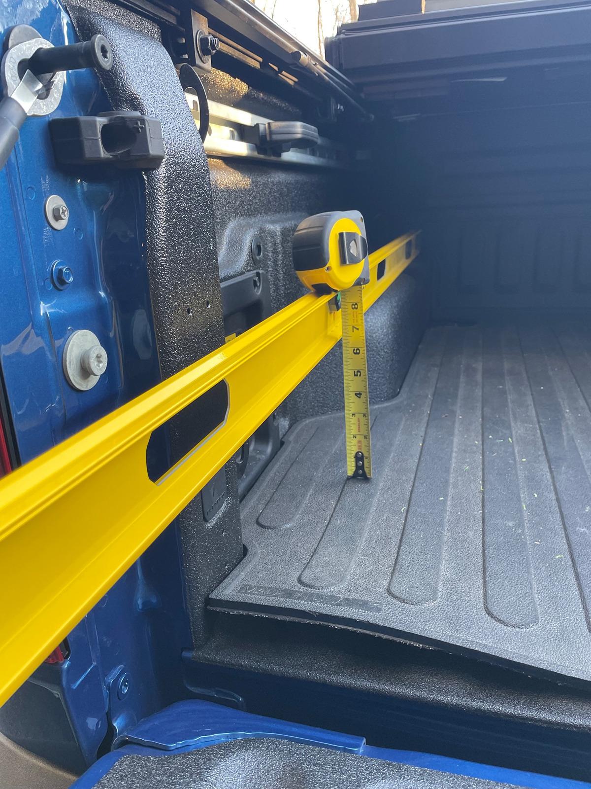

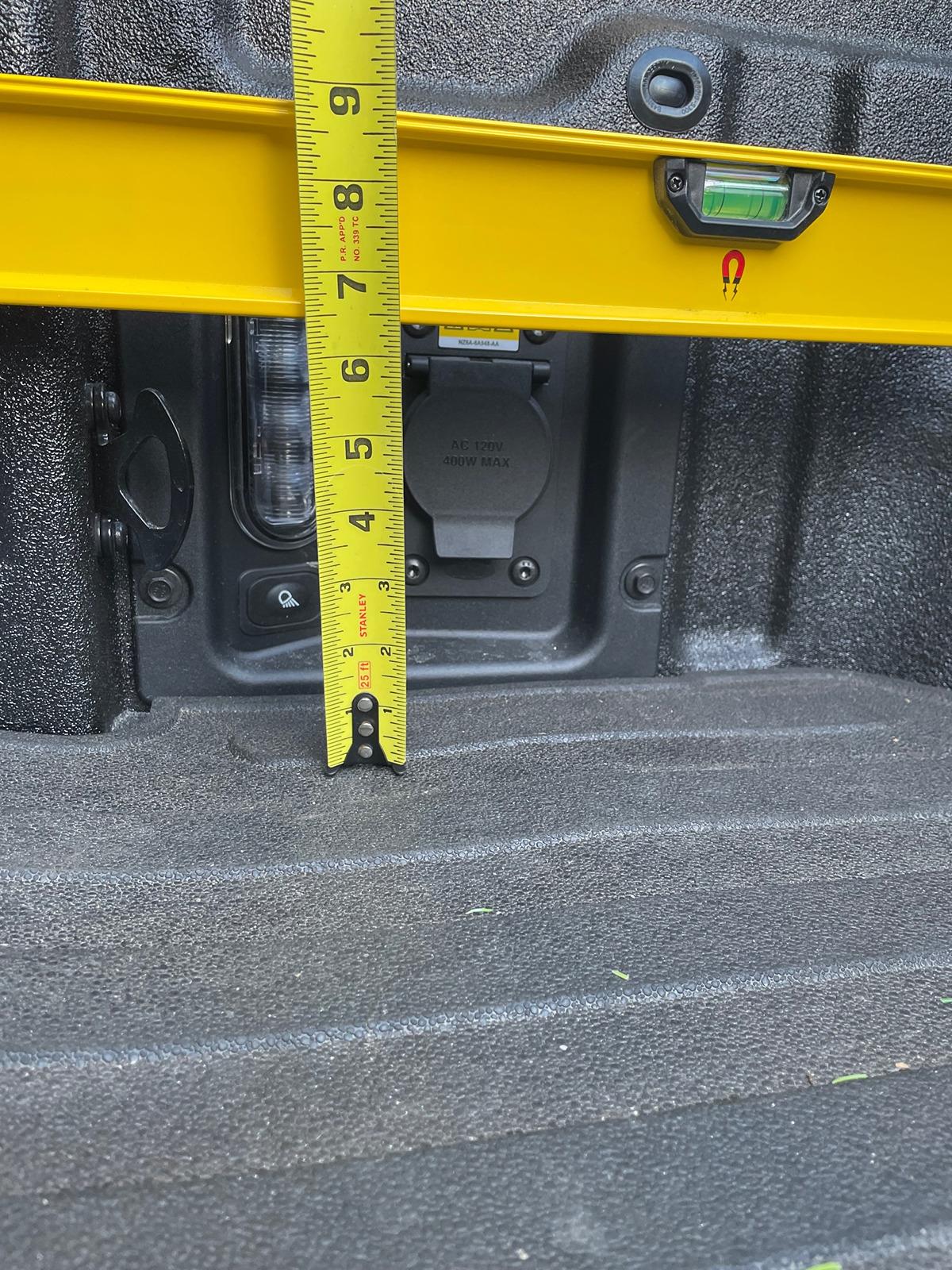

I get 6-1/2" from my bed mat to the top of the wheelwells/propped tailgate.

6.5 inches, and I'm guessing another 1/4 inch or so for the pad. Good to know. I know that the 2X6 is really only about 5.5 inches tall, but it also doesn't drop to bed level. Once I get mine, I'll carefully measure and probably rip a bottom piece to set the height right so that it's just about flush with the wheel wells. Maybe 1/4" shorter. Makes for a nice flat area for plywood or drywall sheets.

Yeah, I wonder if they could have dropped those wheelwells down an inch, so a standard 2x6 would provide support for 4x8 sheet goods. The one item that amazes me is that the 54-1/4" long crossbars fit nicely length-wise in the bed, like they planned it that way,,,,

Looks very CLEAN! I think I am going to steal your idea on the rear crossbar. I like how the bungee cords are adjustable for things like gas cans etc...
Nice work!

Another thing to consider maybe? If you use a horizontal board in the wheel wells to provide stability to sheet good or whatever you'll need to account for that as well. I haven't (and probably wouldn't) hauled drywall in mine, but if I did I'd use that horizontal board in the back along with the 1/2 tailgate position...maybe adding a horizontal board to the top of the vertical one at the rear slot would provide even more stability and help you get to your desired height at that level?? I have a much less nice looking set of 2x6 in my truck and it provides good function, but a two board setup might be nicer if going tall than that b/c they aren't the easiest to maneuver in and out and the larger the board the more difficult I think.

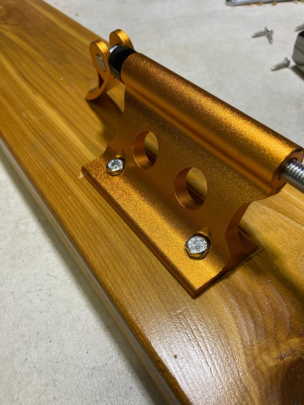

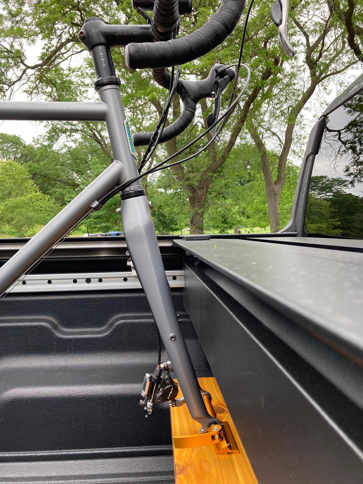

I wanted to circle back with you and share a quick update. I took a longer trip with two bikes. Everything we well enough, but when I returned I noticed the fork mounts had loosened a bit — enough so that I decided to make some adjustments. Given what I understand about the weight of ebikes, I thought I would reach out and share what I did to ensure a stronger connection.
I removed the mounting hardware and drilled completely through the 2x6 using the screw holes as my guides. Then I used a bolt to reconnect the forkmounts. I am much much more confident in the connection and think it is the right way to go. (I had my doubts about the screws that came with the forkmounts...but, :facepalm:...I ignored them. Next time I will listen to my gut).
