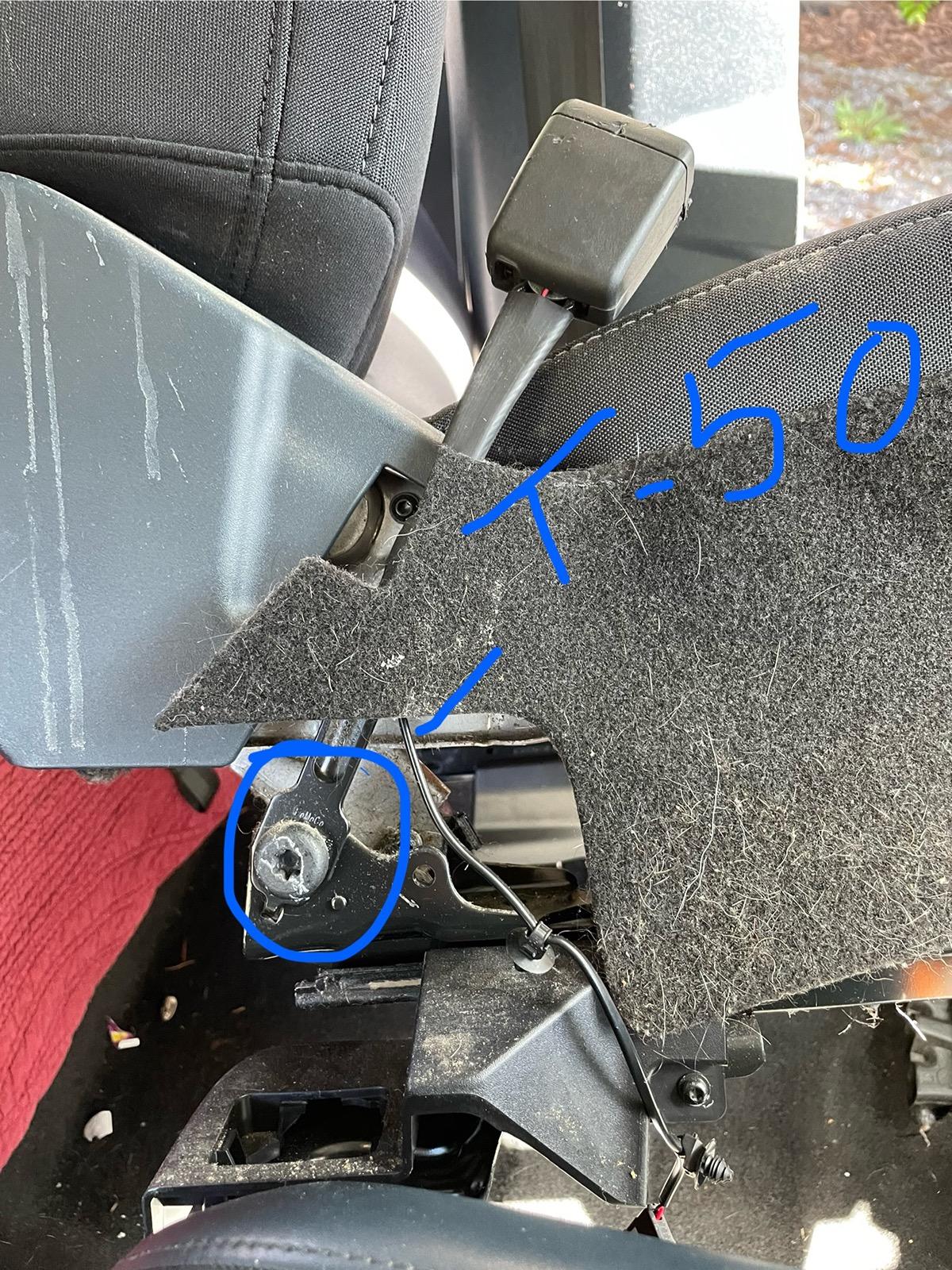

I can’t be the only one this will happen to:
Dog chewed my driver’s seatbelt buckle. To replace your front seatbelt buckle, you’ll remove the four plastic tabs, exposing four torq size T-55 bolts. From there you can move the seat a bit and expose the seat buckle itself.
remove one torq size T-50 bolt and disconnect the electrical connector.
Replace everything and torque it down to spec. What is spec for these bolts? I have no clue.
Notes: the drivers side and passenger side buckles are different. The drivers side has a Hall effect sensor (to know if your buckle is clipped in) and the passenger side has that plus another sensor.
Ford Maverick Replace Front Seatbelt IMG_7409
Ford Maverick Replace Front Seatbelt IMG_7410
