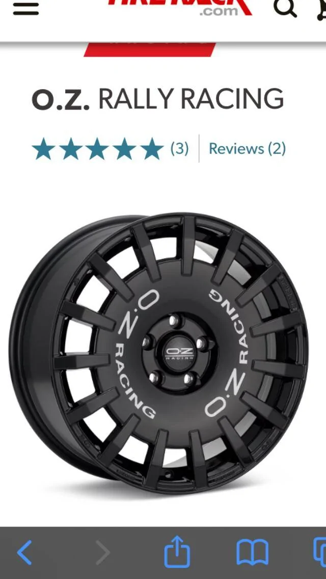

I’m going to weigh my Moonstone wheels tomorrow. I know they are not as light as world class Italian rally wheels (27lbs), but I’m hoping they’re not 40lb anchors.
Do lighter wheels reduce understeer?
“Yes, heavier wheels can increase understeer in a vehicle. Here's why:
- Increased Rotational Inertia: Heavy wheels have higher rotational inertia, making them harder to accelerate, decelerate, or turn. This can reduce the responsiveness of the front wheels, leading to understeer, where the car resists turning and tends to go straight.
- Altered Weight Distribution: Heavier wheels add unsprung weight, which can affect the balance of the car. In front-wheel-drive vehicles, extra weight on the front axle can exacerbate understeer by overloading the front tires, reducing their grip during cornering.
- Suspension Dynamics: Heavier wheels put more stress on the suspension, potentially causing slower weight transfer and less precise handling, which can contribute to understeer.
However, the extent of understeer depends on other factors like tire grip, suspension tuning, and vehicle setup. Lighter wheels generally improve handling and reduce understeer by allowing quicker responses and better grip.”
Grok3
I really like my Moonstone wheels. Lobo Exclusive.
(AI nonsense)
Grok3
I really like my Moonstone wheels. Lobo Exclusive. But ...
Yeah, AI can dream up some weird nonsense, and I especially wouldn't trust Elon's 😄
The biggest difference I've noticed going from regular to ultra-light wheels is the improved steering response; I can really feel it. *BUT* this is on a very light car with double A-arm front suspension, and a lightly-assisted hydraulic steering rack which is known for great road feel.
On a Maverick, with electric power steering that gives zero feedback, I'm pretty sure if wouldn't make a noticeable difference.
I'd save my money if I were you, especially if you like the wheels
Yep, makes sense. And tires with better grip would help the handling better than any wheel I bet.

I know the Lobo turbofans are heavy..and it is a bit of a concern. But, I think there are other suspension and handling components that may need some attention first.
Lighter wheels would be more efficient and better for performance all around. I thought I saw numbers like, its possible to shed ~20 lbs PER wheel, which is massive for wheels... But for now I like the turbofan look.
The stock rubber is not great for getting overly aggressive, and will require an upgrade..but I'm going to use up these stockers first. Its good for feeling out the limits, and providing some playfulness though.
