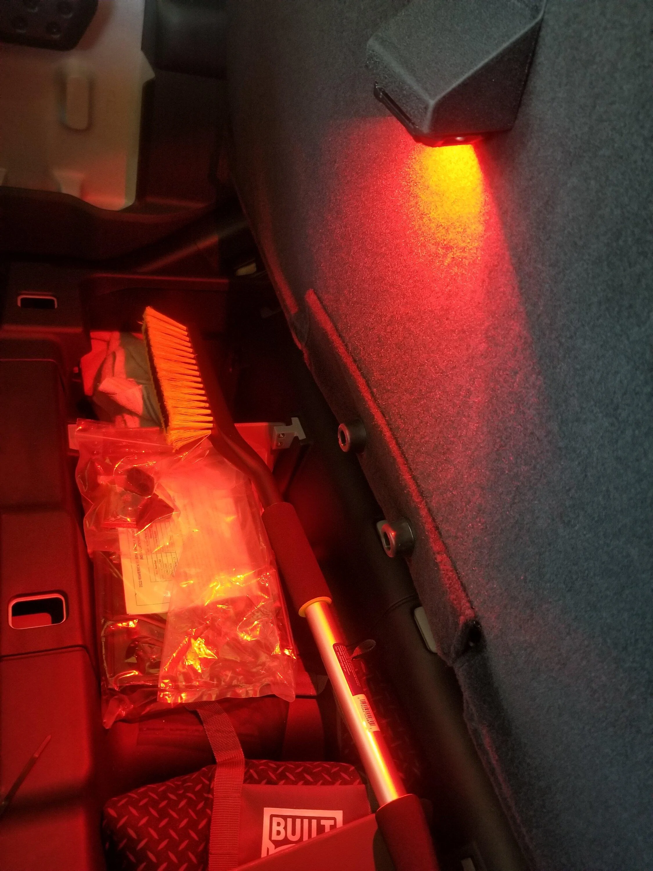

Looking for the rear dome light wire color code so I can tie in power for under seat storage lighting. I have no desire to pop off side panels and run the wire all the way up to the dome light when I can splice in at the rocker panel sill plate.

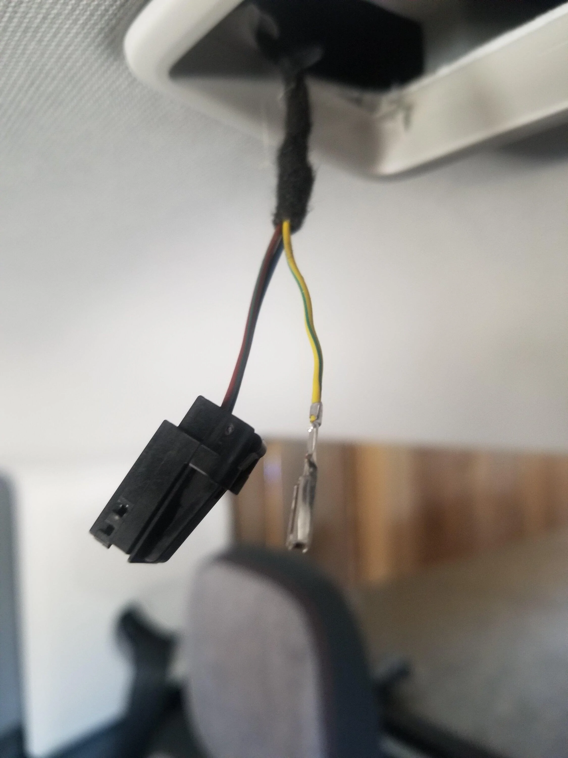

Ok thanks. I suppose the easiest way is going to be to tie it at the dome light. How to I remove the dome light. I am assuming it just snaps out, or do I remove the lens, and theres screws behind it holding the rest of it in place. I dont want to break anything.
Darnon
Jul 4, 2021
5,764
7,307
WNY
It just pops/pivots down. There's clips at the rear and tabs at the front that hook above the headliner. However Yellow w/green is constant power. You might rather want the Gray w/ Violet strip Courtesy Lighting circuit:
Pin 17 at the BCM
Or if you don't feel like crawling beneath the dash possibly Pass side A-pillar connector Pin 9

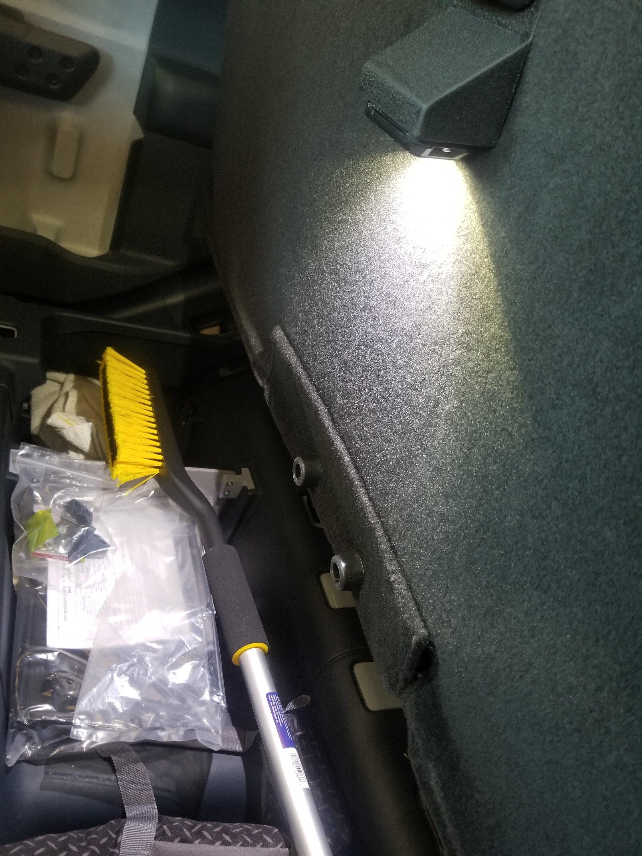

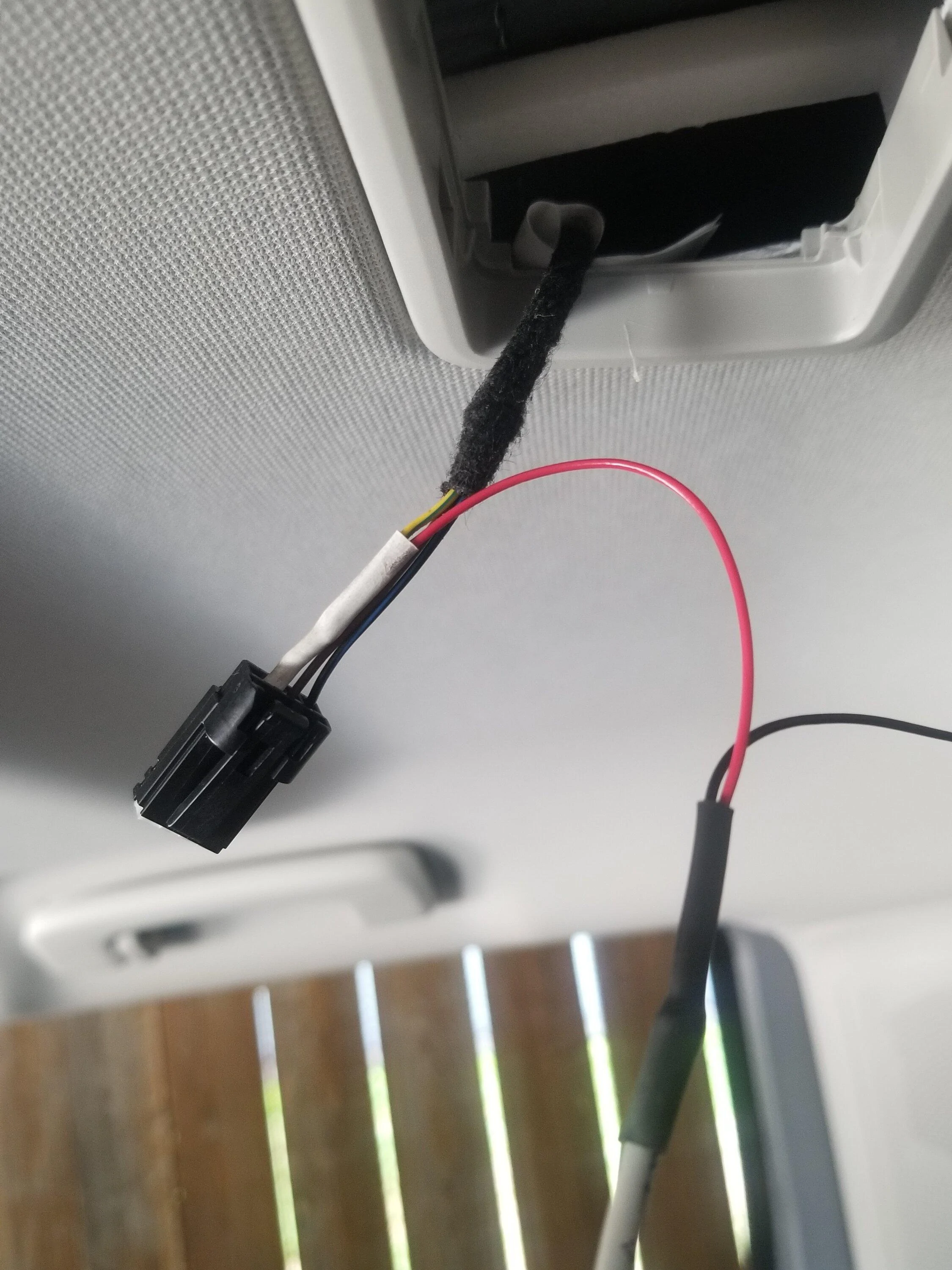

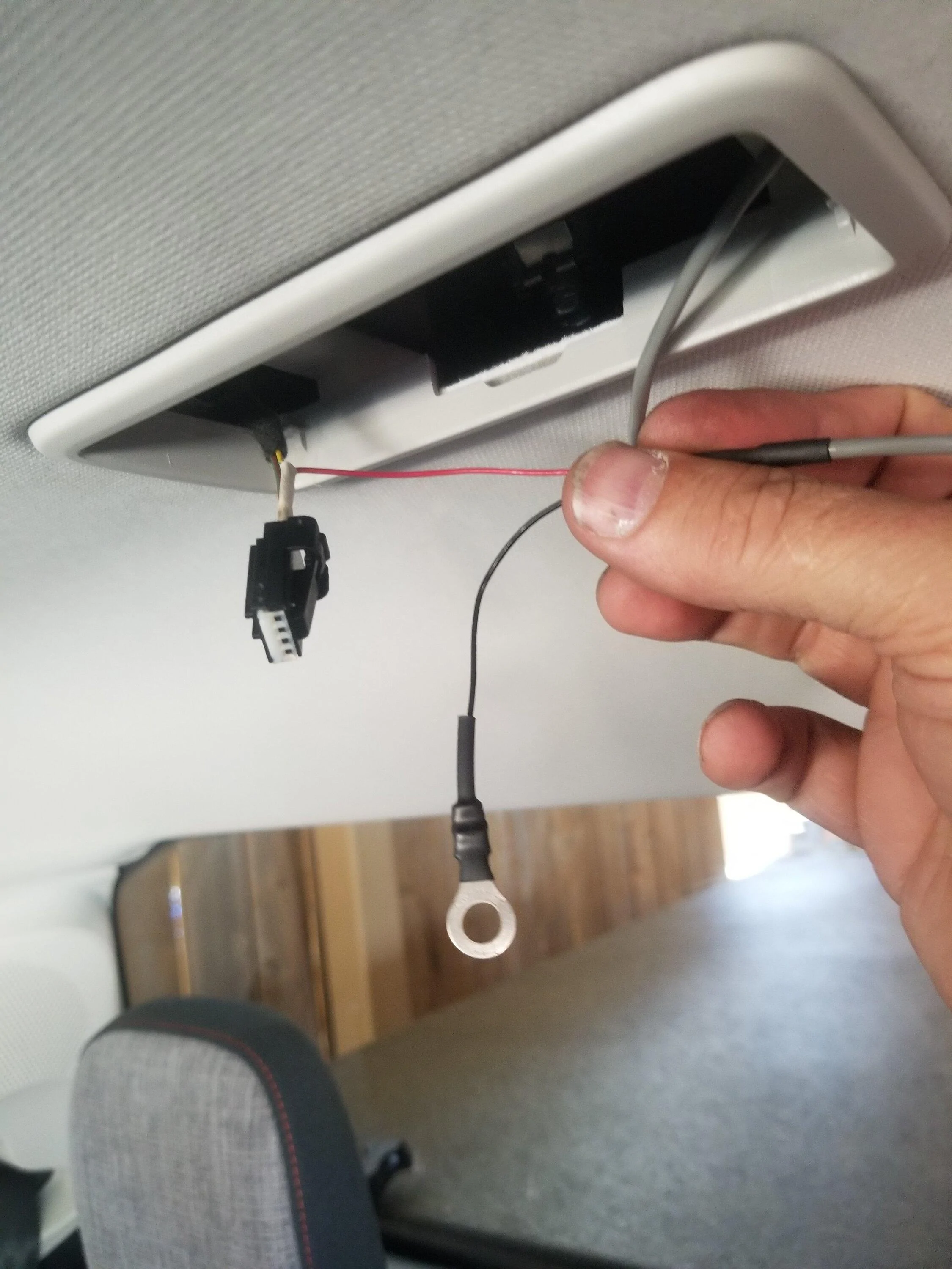

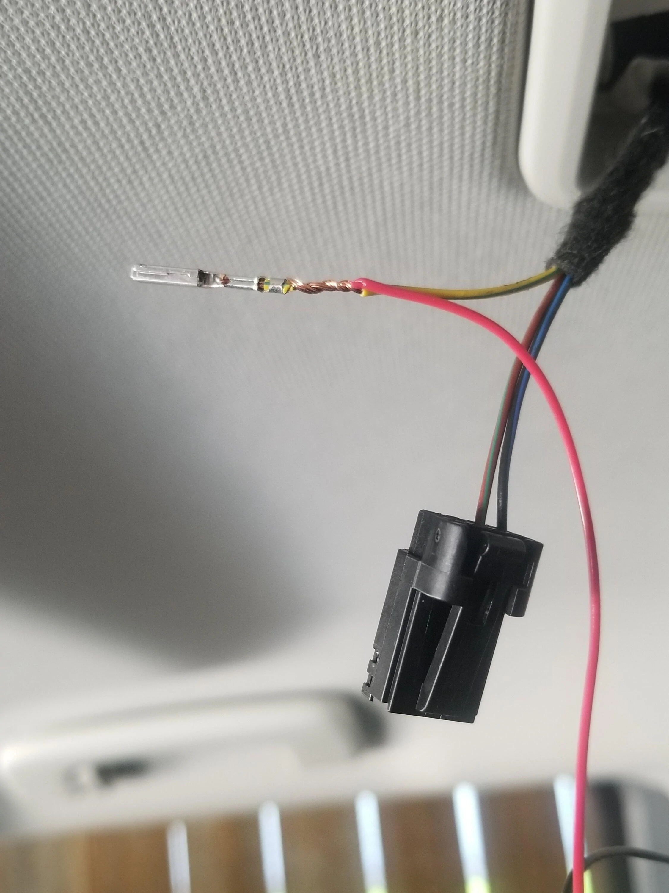

I tied into the yellow/green wire at the dome lamp. I figure by the time the dome lamp times out and turns off, I would have gotten what I need from under there anyways. Also my under seat light is wired with a mercury switch. As soon as I put the seat down it goes out.
