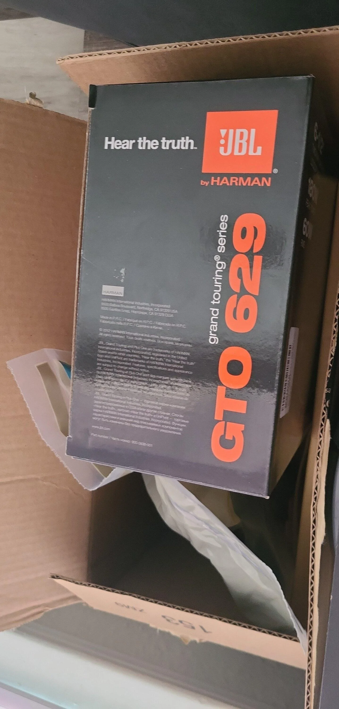

Ready for install.
JfredTrem
Justin
Nov 6, 2022
84
188
Maryland
23 Maverick XLT Tremor
All the parts and tools and bits needed to swap out the speakers just sitting in a box waiting...
Not on my Maverick.. just the weather to improve so I can actually do the work.
Went with the JBL.. Got em on Amazon for only 66
Sound deadening
Tools
Adaptors
All from Amazon.

I have these same speakers sitting around from a previous car, but Crutchfield says they won't fit the Maverick. Did you have any issues installing them?

They fit great with the metra adapters.. Def a huge improvement. I drilled a hole in adapter to feed wires through

Perfect, thanks a lot. I just ordered a pair of the adapters, so hopefully I can get these installed this weekend.
