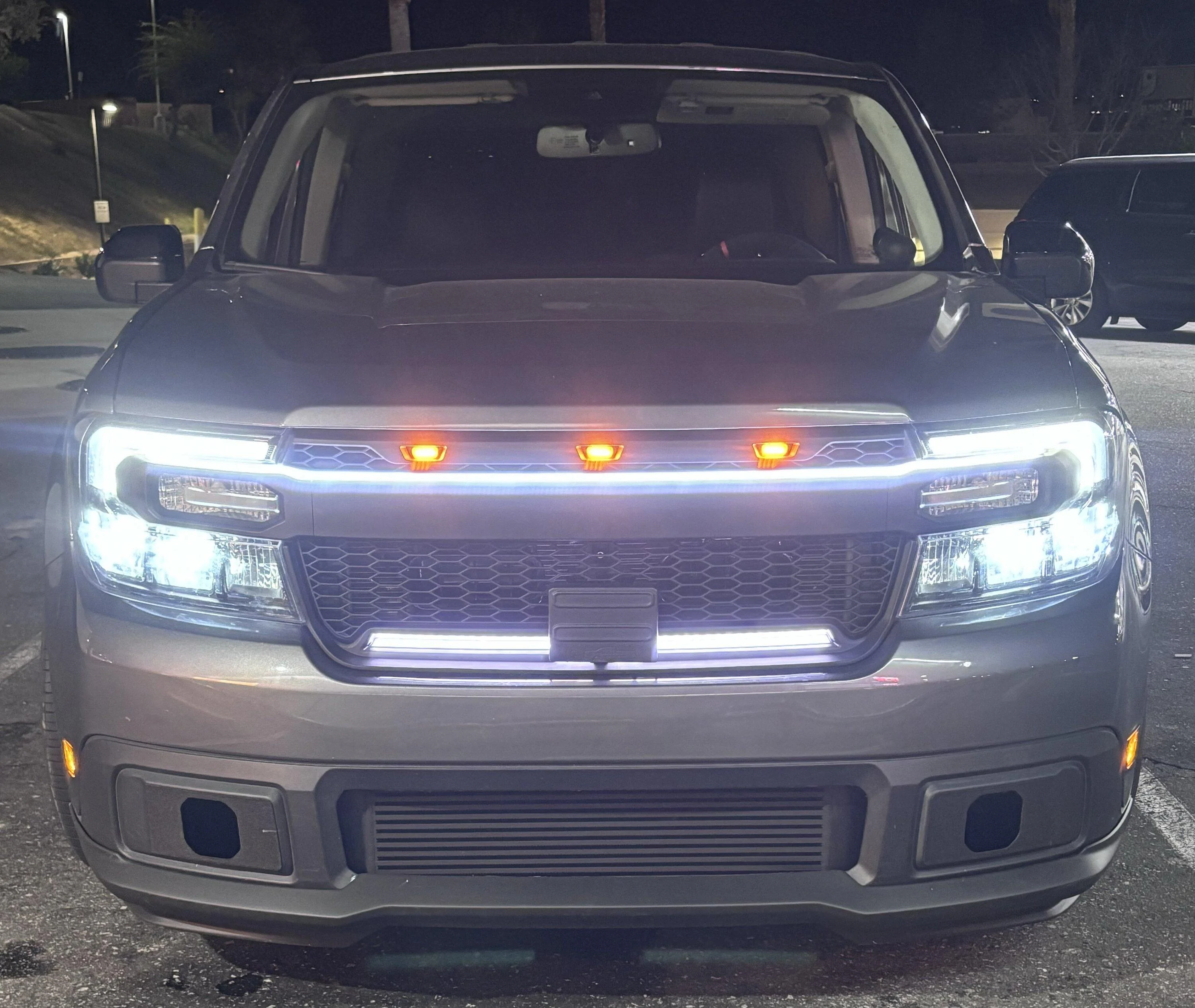

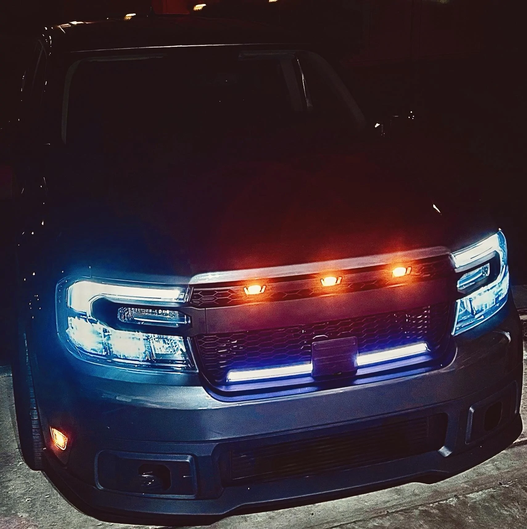

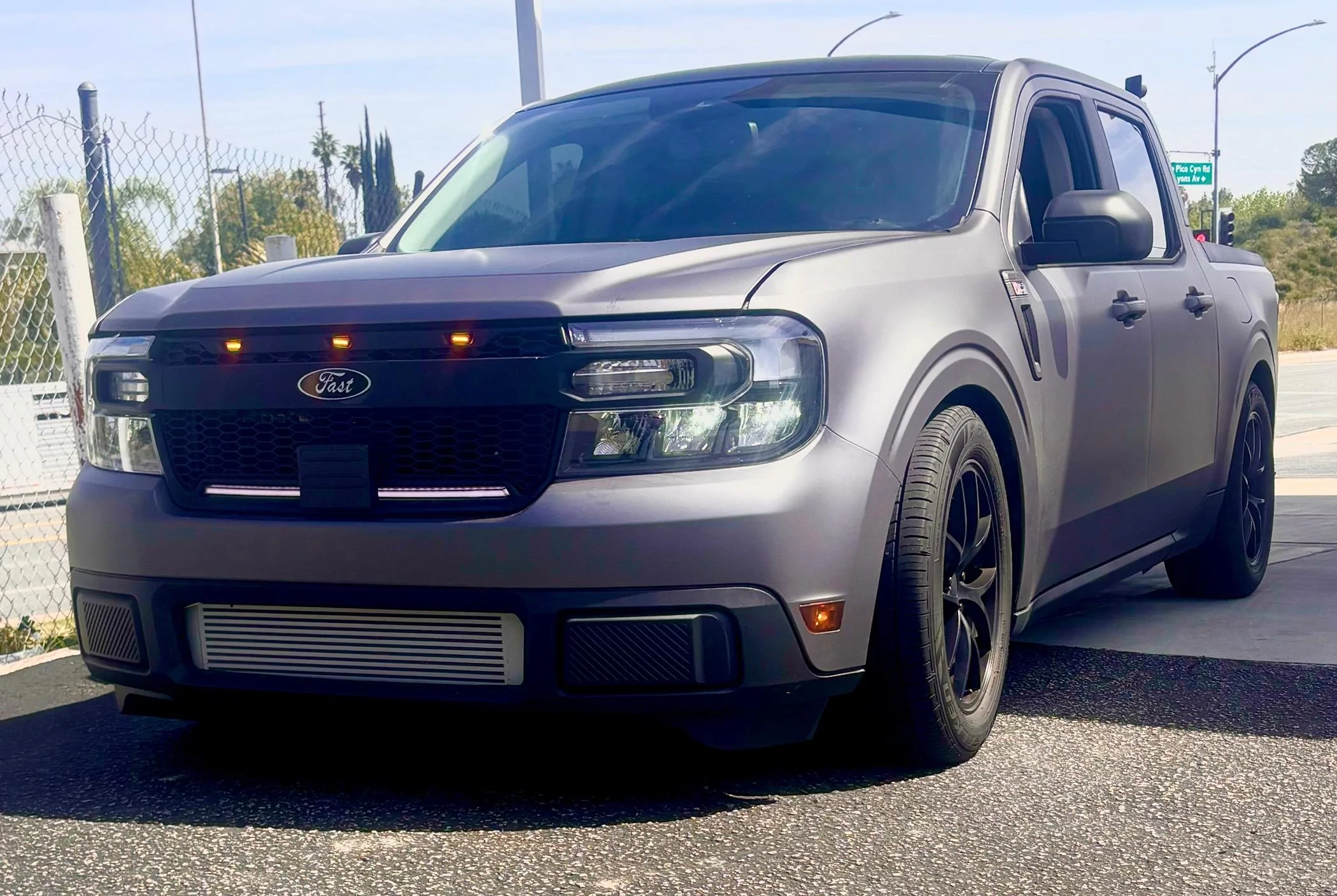

Always wondered why the Raptor grill said it didn’t work with Adaptive Cruise. Figured I’d take one for the team and try it out. Well you literally just have to cut the square opening for the radar. Then I trimmed the radar bracket so the light bars would clear. Last thing was trimming the ACC cover so it would sit flush and used super glue to attach the cover to the grill. Took it for a spin and ACC works like normal.

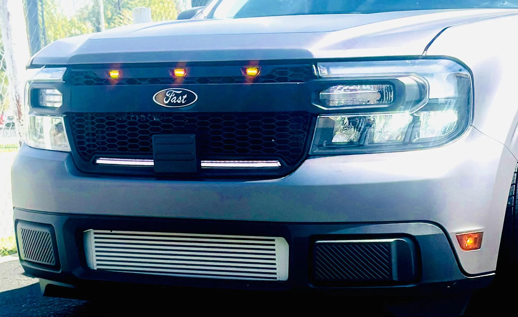

Never cared for the big FORD on the grill so I left them off. Will probably put a Fast emblem to match the rear. With my impeccable timing I bought the JLC fog bezels and lights the day before Diode Dynamics announced their kit. Purchased the kit so now I patiently wait for the final piece of the front end makeover.
With the new lip and grill I’m really liking the look. I’ll post some better pictures once the new fogs and emblem are installed. Maybe now a manufacturer will make a grill for trucks with ACC.

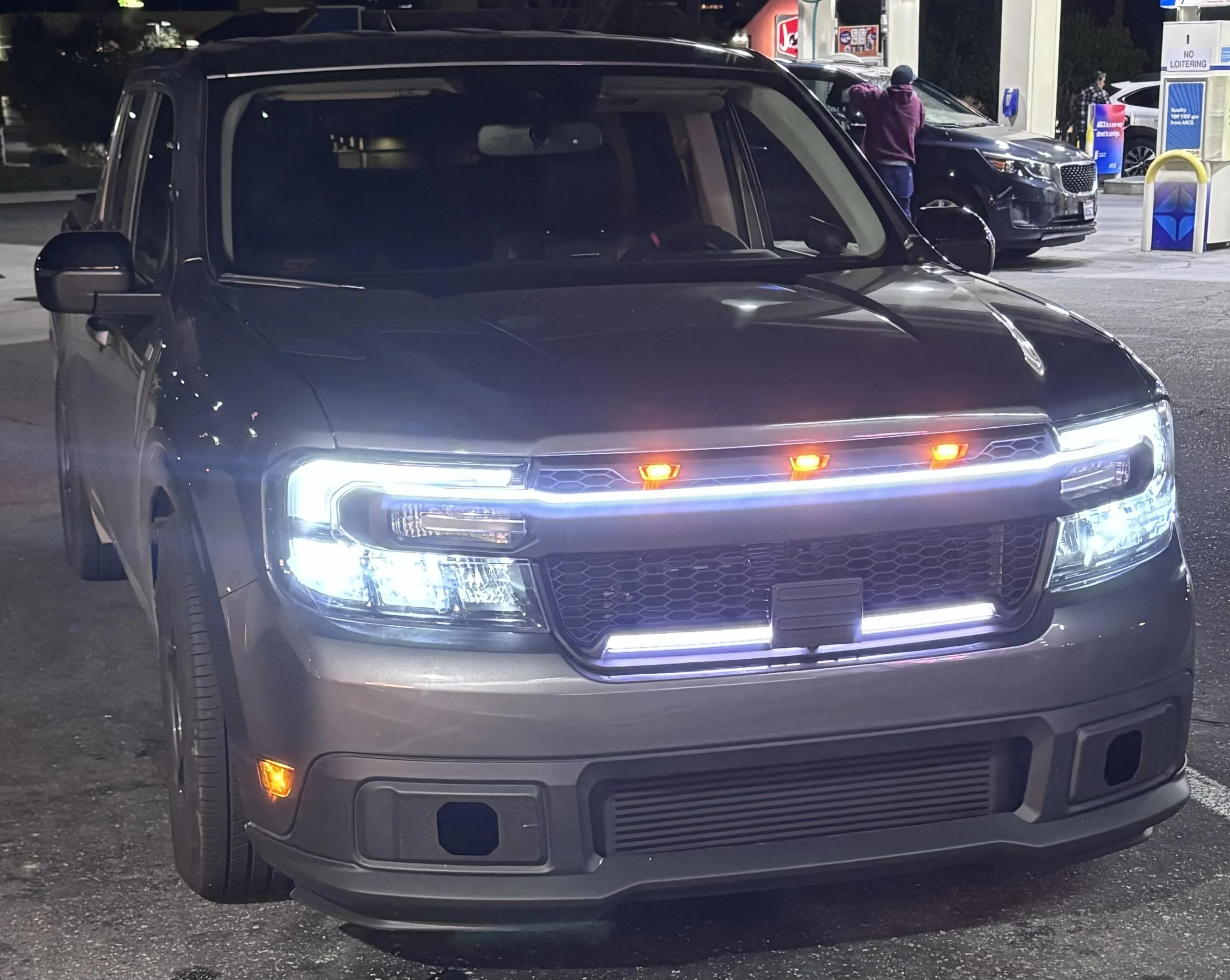

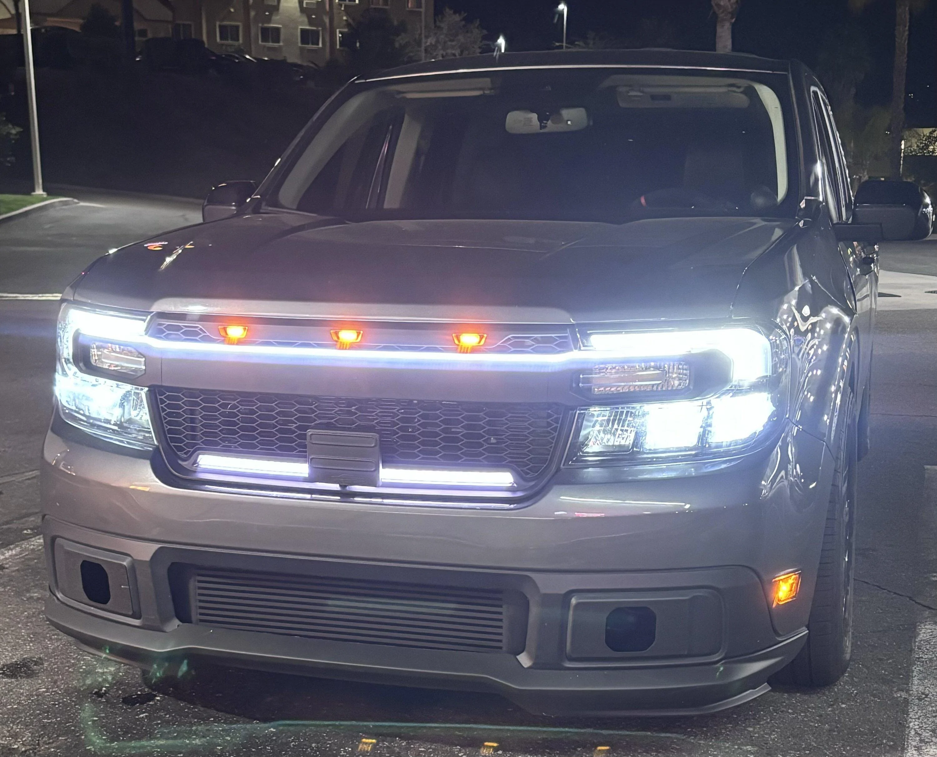

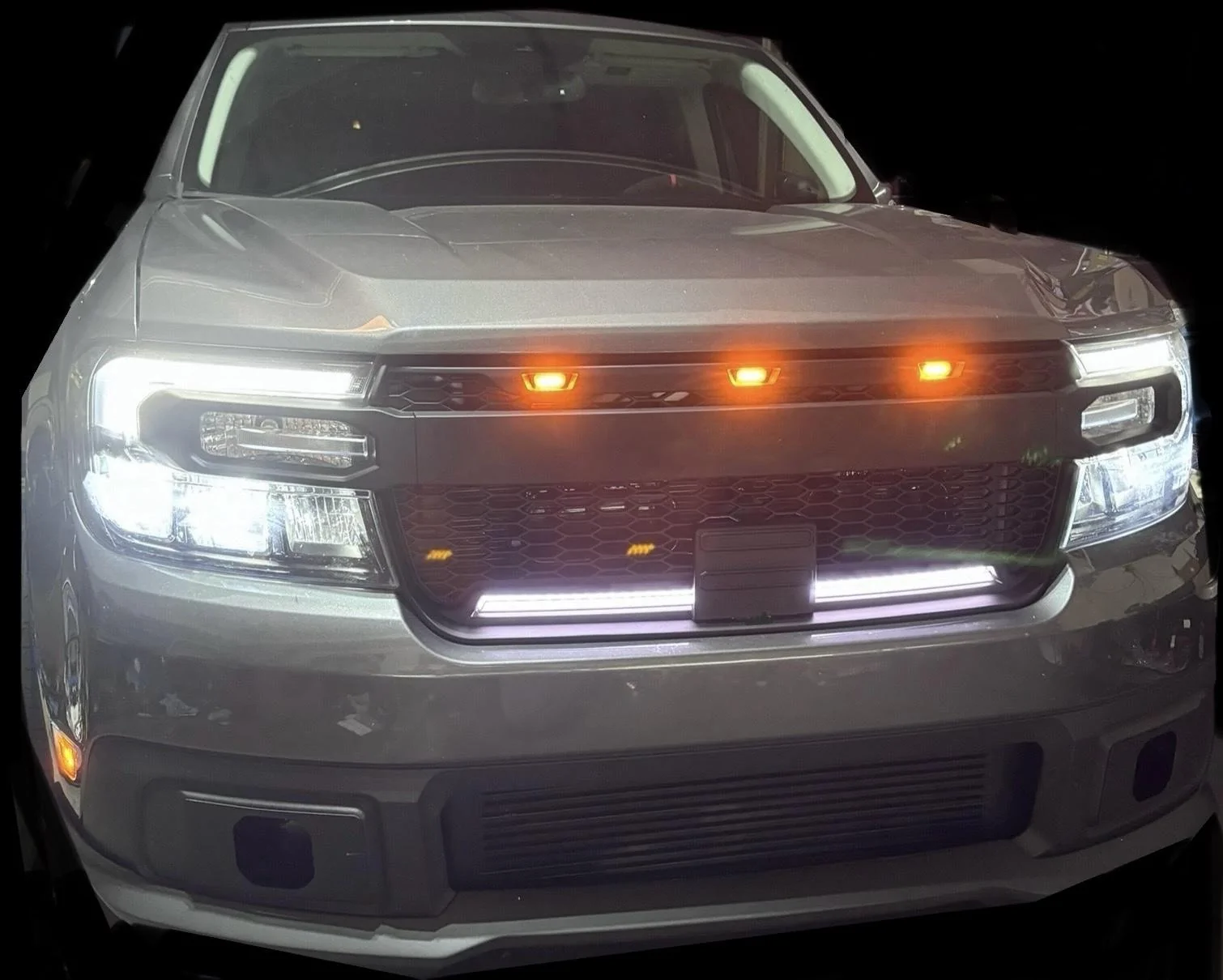

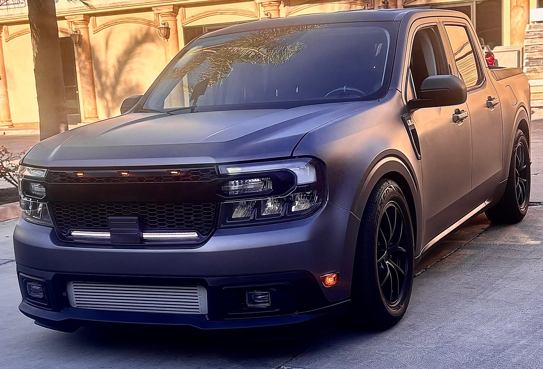

Updated photos:

Updated photos:
