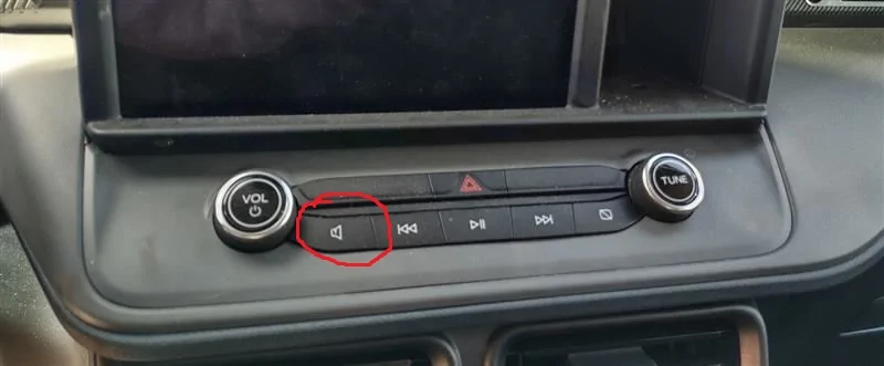

You don't have to unplug the phone to switch Source.
Either push the Ford logo in Android Auto(may be Sync3 only,) or press the Speaker button to get to the main screen, then press Audio/source.
