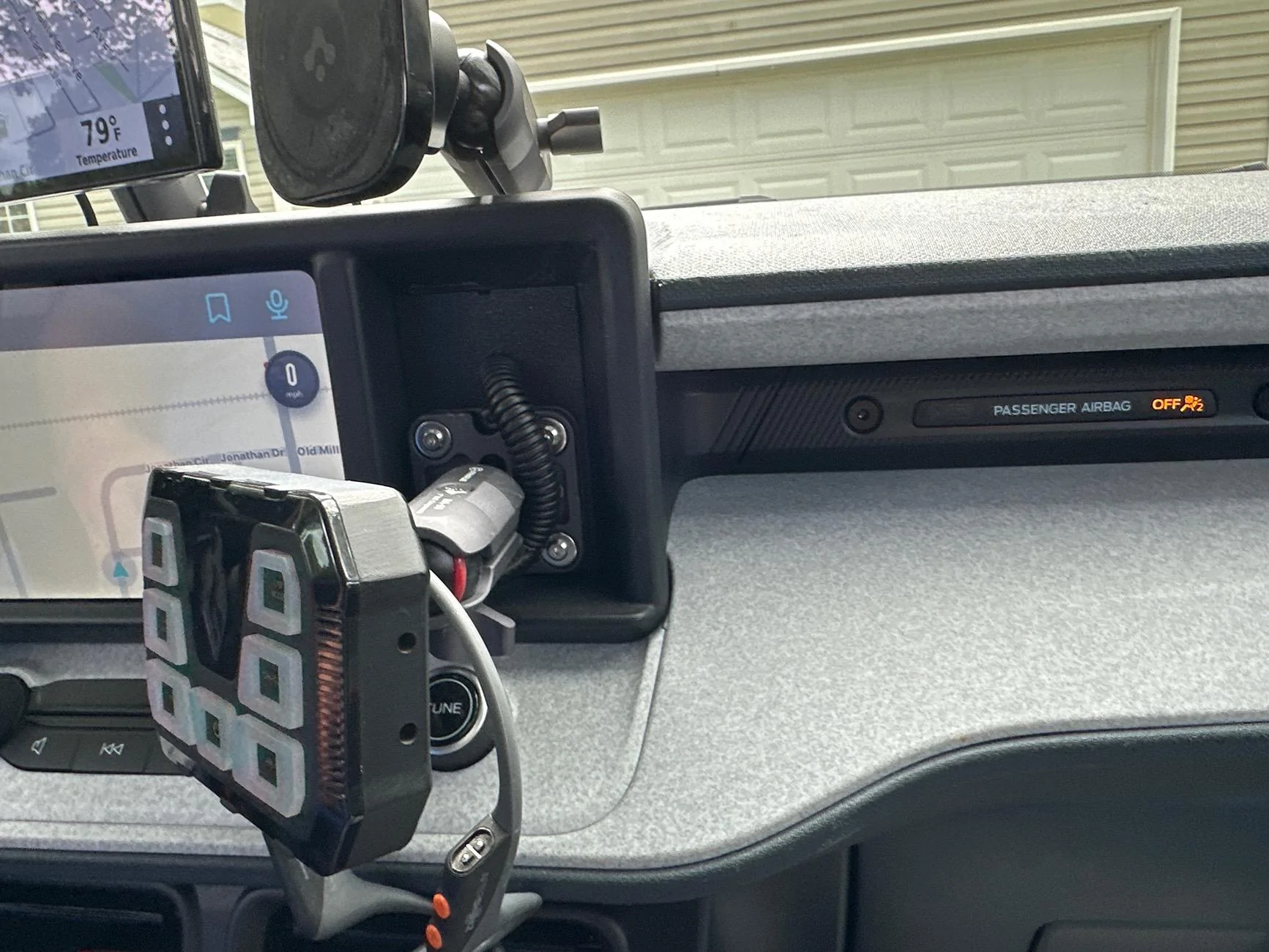

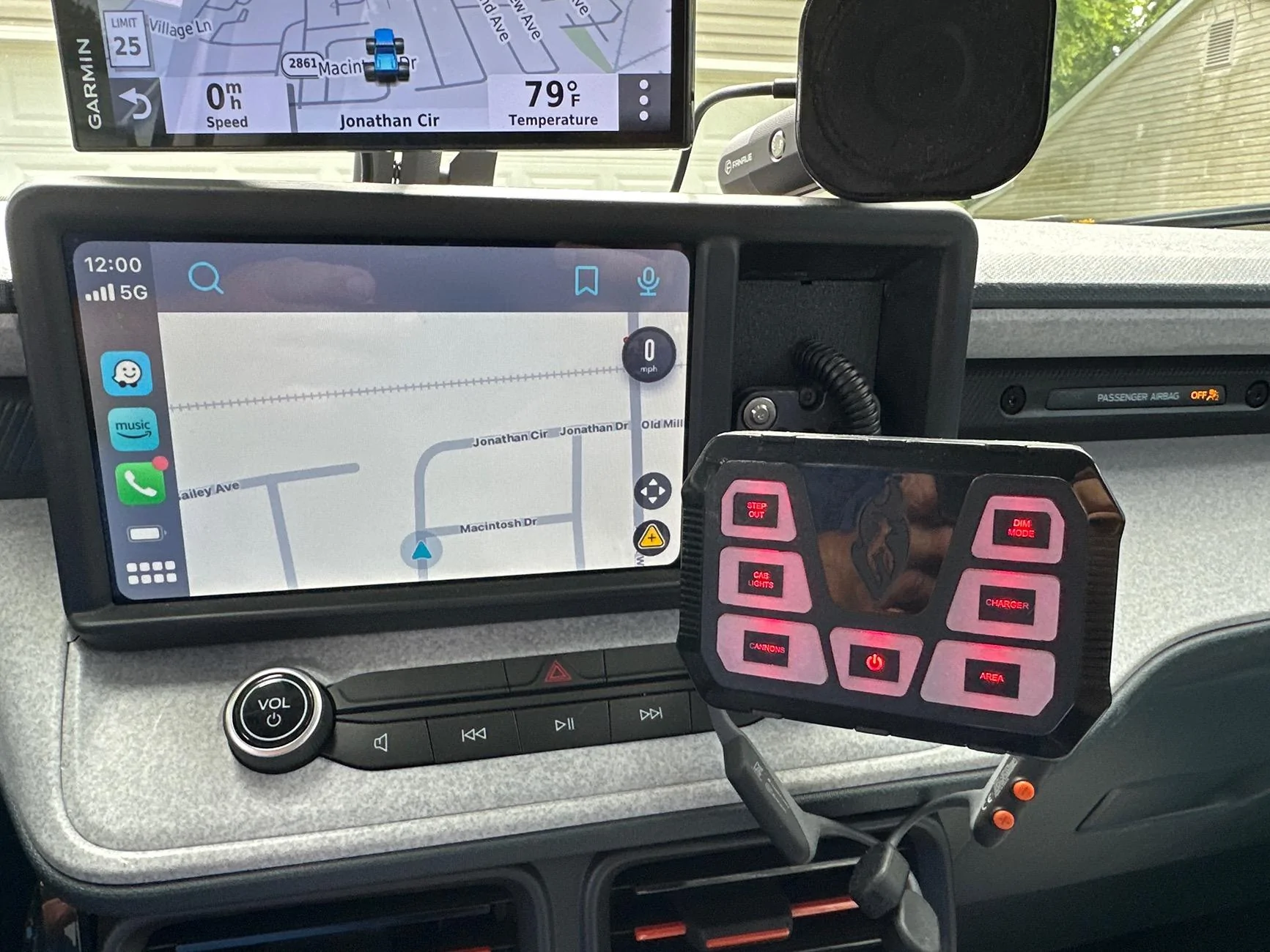

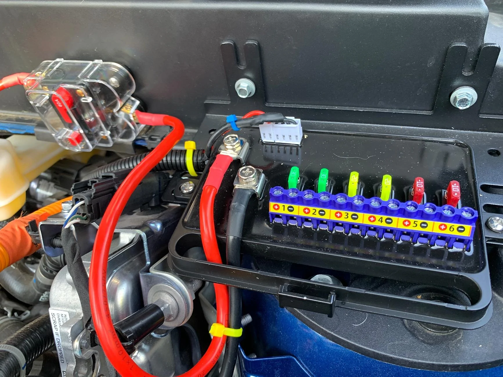

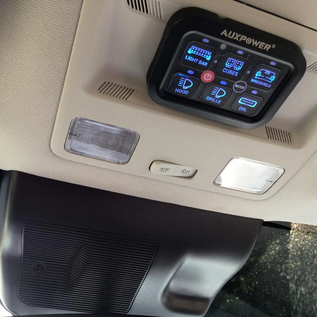

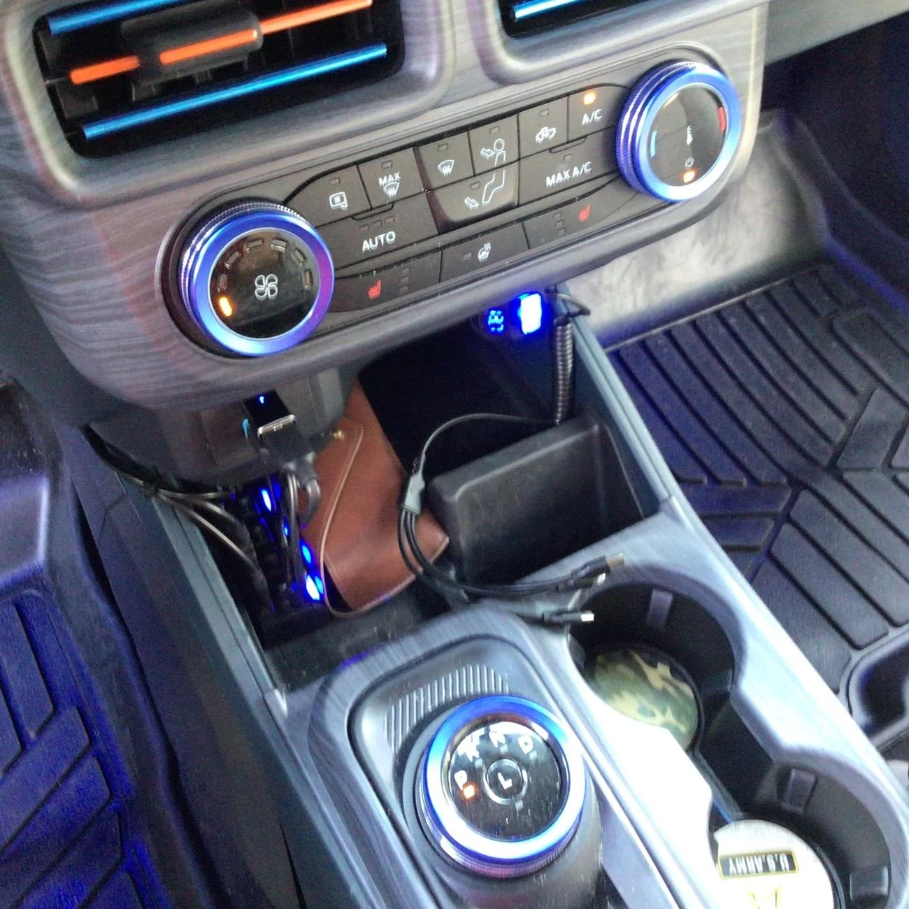

It was easy. One wire runs from the switch panel control box mounted to the firewall on the driver’s side. It passes through the firewall entry rubber plug into the driver’s footwell. It goes up, under and across the dashboard, behind the center console to drop down toward the fuse panel. I didn’t connect the fuse tap until I had routed the wire@AbnRgr how did get the fuse connector to the fuse box? Also, did your kit include enough wire to get it to the fuse box? I’m trying to replicate what you did.![]()
did your switch panel come with a long enough acc cable.It was easy. One wire runs from the switch panel control box mounted to the firewall on the driver’s side. It passes through the firewall entry rubber plug into the driver’s footwell. It goes up, under and across the dashboard, behind the center console to drop down toward the fuse panel. I didn’t connect the fuse tap until I had routed the wire
