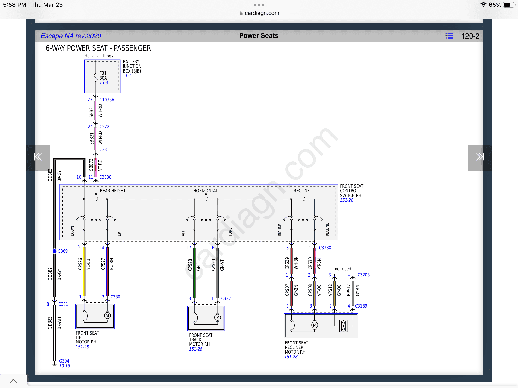

Here is the wiring diagram for the Escape passenger seat. You can see it just needs power and ground from the vehicle.
Ford Maverick Power Seat IMG_0623

This is extremely helpful. Thank you!
