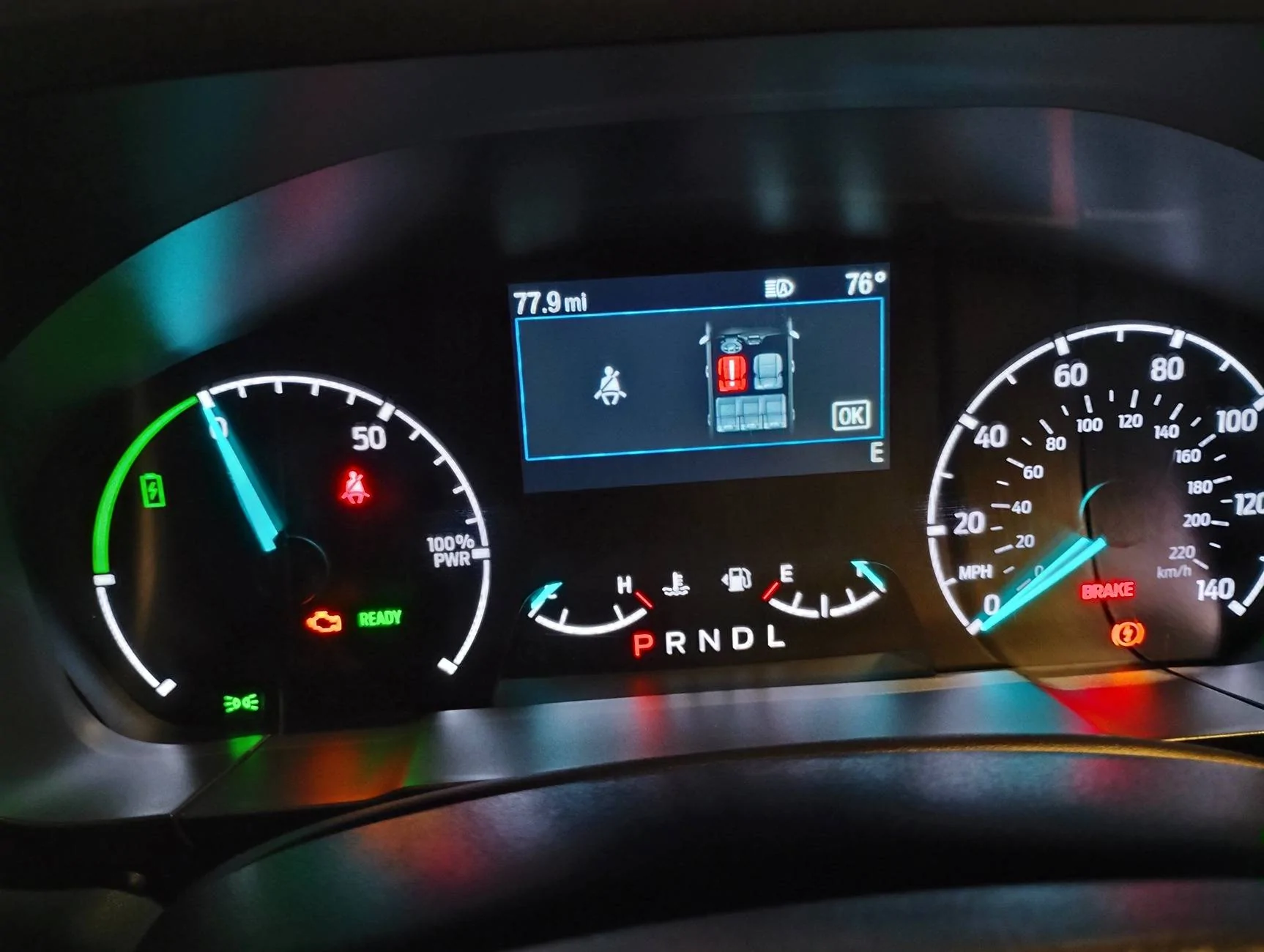

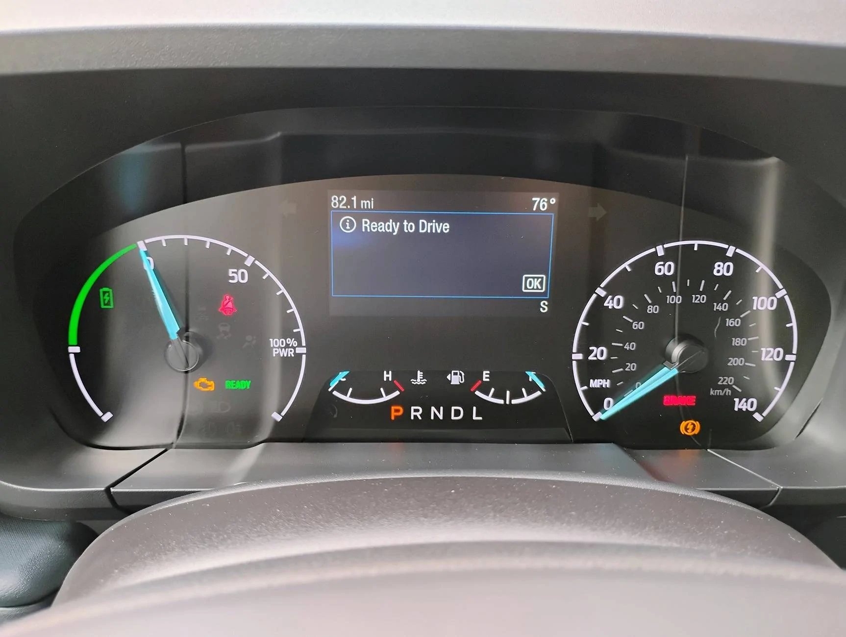

Parking E-brake malfunction photos

25 XLT Hybrid at dealer for 6 weeks. Parking brake would not disengage in neutral tow mode. Replaced PCM & ABSM modules to clear all fault codes. So far so good

I have a 25 AWD Hybrid that had a similar issue. It spent 3 weeks at the dealer. They replaced the electric brake booster. It took two weeks to get the part and then a week for them to install it.

My '25 literally just got dropped off at the dealer for the same problem. They're replacing some sensor (name is escaping me) that basically tells the vehicle if it's in park or not; and therefor whether the ebrake should be toggleable or not.
It took them a week to get the part, but only a day to diagnose it at the time. I'm not sure what they're dragging their feet on.

Thank you, my fordpass also had the warning. Right now, from the app, they may remove one rear wheel, because I could only see three tire pressure.

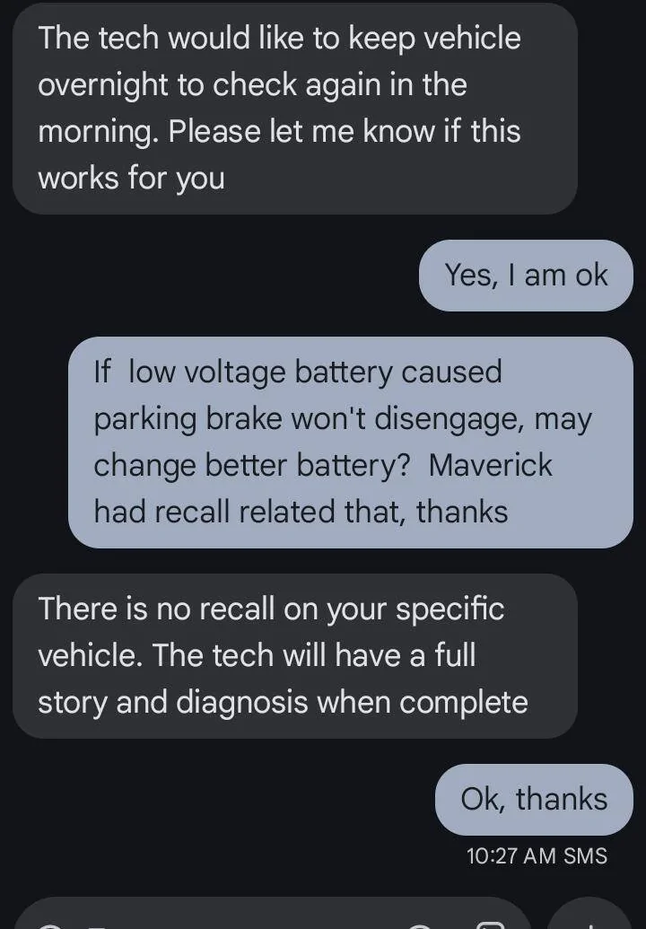

Update: this morning, I noticed app showed car has been driven twice, each about 10 miles, I called dealer, dealer read tech notes, only mentioned "low 12 voltage battery", then he talked to the tech, text me to keep car one more day.

I have been thinking through, mine might be issue of PCM too, I guess. The puzzling is dealer has not contact me for what the problem is they think, but I can see they are testing something, because the car has been driven ~10 mile per day in three days so far, but never called me, only said they are diagnosing and observing.
My worry is they did some "easy-fix", like reset something, then test drive 10 miles, let car parking overnight, however, next morning, issue appeared again, E-parking brake still not disengaged. They probably puzzled too, otherwise, there is no reason not to inform me what happened.
I also checked this thread, "Neutral tow mode", yours and mine are different, ours are related to E-parking brake, since replacing PCM helped you, mine might be similar.

Thanks, dealer said it was the "battery".
So, this Morning, dealer called and let me pick up the car. I looked their report, basically they said it is due to "low voltage DTC". They first retrieved three codes, ABS C0020:11; ABS P0503:86, ABS P0562:16, also run OASIS. What they did is: disconnect C135A/B, charge battery, run load test, inspect all the cable and connection, then test drive three days, 10 mile per day, let car sit overnight, next day, no warning code came out.
The one I talked to , he said, he thought when repairing hail body works, the door might be kept open or others, then drain a lot power from battery. It kind of make sense, but given it is brand new car, still felt bad, and hoping Ford issue battery either recall or software update after this quarter.
