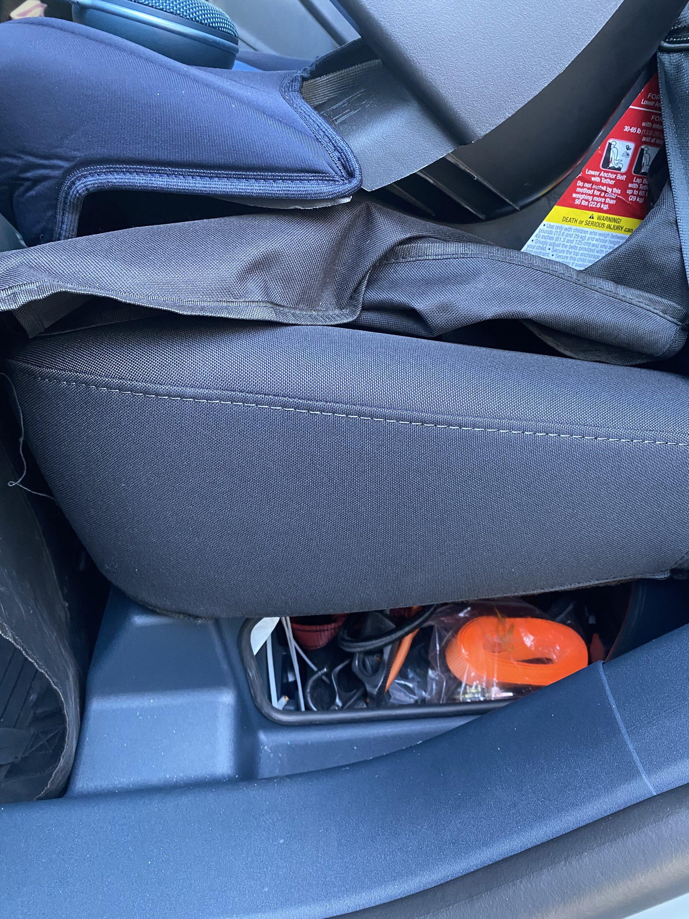

This one goes out for anyone with kids car seats. The last thing I want to do in an emergency is remove the seats, especially side of the road with them in the vehicle to get to the jack. And since this is a family/work vehicle, I needed to maximize the little bit of storage we have under the rear seats.
So I traced my line, cut the plastic with a knife/multi tool, sliced one side and threw some 5/32 vacuum tube I had laying around, and now I have under seat access for the jack, ratchets, net, and whatever else I want. You can also buy some plastic U-channel trim online if you want. I believe the plastic thickness is 1/8th of an inch or .3 mm.
You used a knife?! Not even a rotary tool/dremel? How long did it take?
Good job, looks clean.

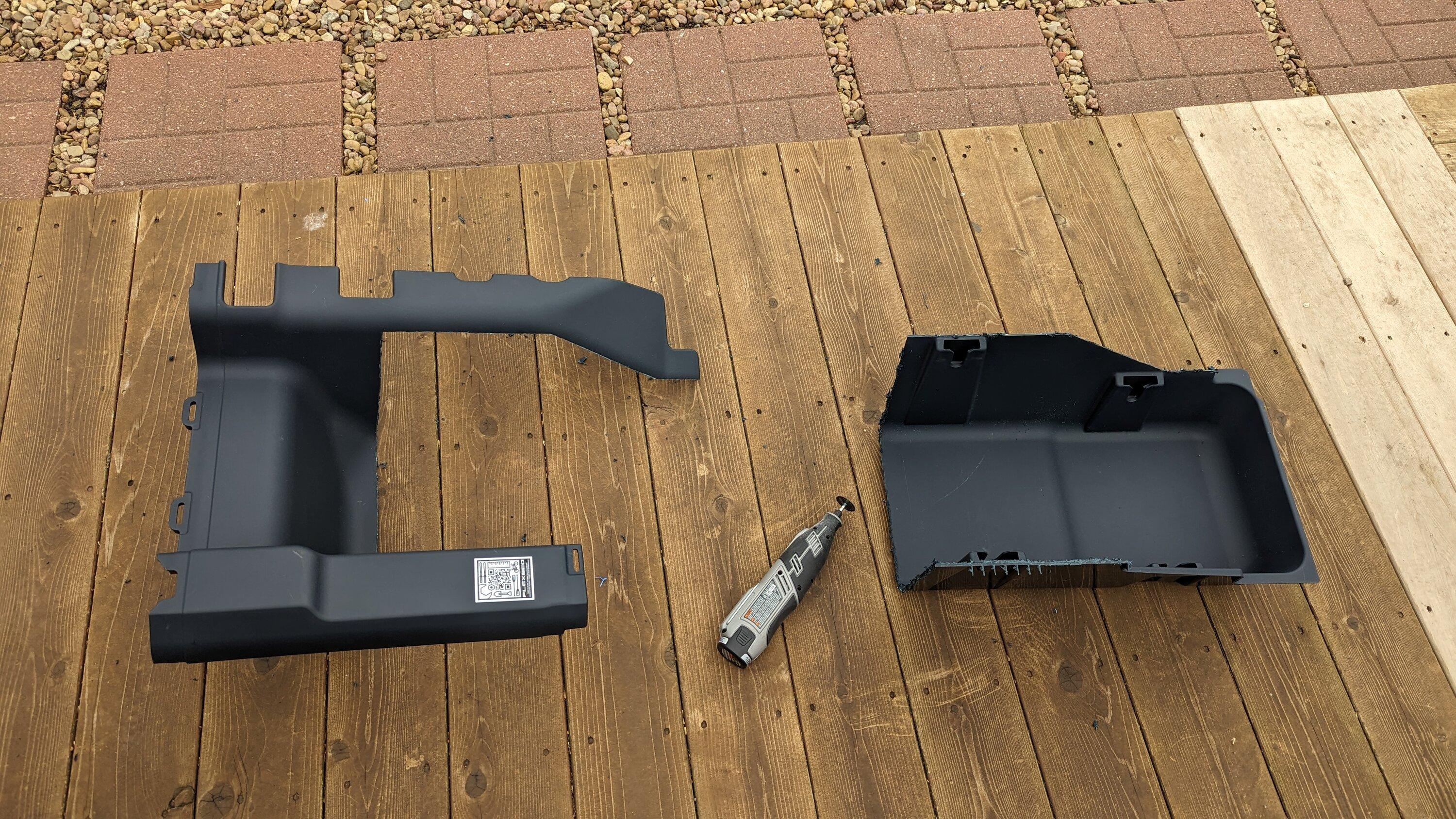

I scored mine with a utility knife, but found it was not necessary or even beneficial.
Measure if you want, put some masking tape on it as guide lines, and then cut with your dremel. Takes 2 min to dremel and 5 min to pull off any extruded and melted plastic that remains.
I think rotary/dremel is all unnecessary and makes more of a mess.
I used a hole saw (1-2" would work) for the two bottom corner radius, then drew the straight lines where I wanted them and cut through with a fresh blade. It's soft plastic. Planning my cut took the longest, but the cutting was only a few minutes per side.
Agreed on both counts, but if you already own a dremel, I'd use it.
The plastic is soft and fairly thin, but don't kid yourself. There's a good bit of effort to cut through it straight, and it's safer and faster to use a dremel instead.

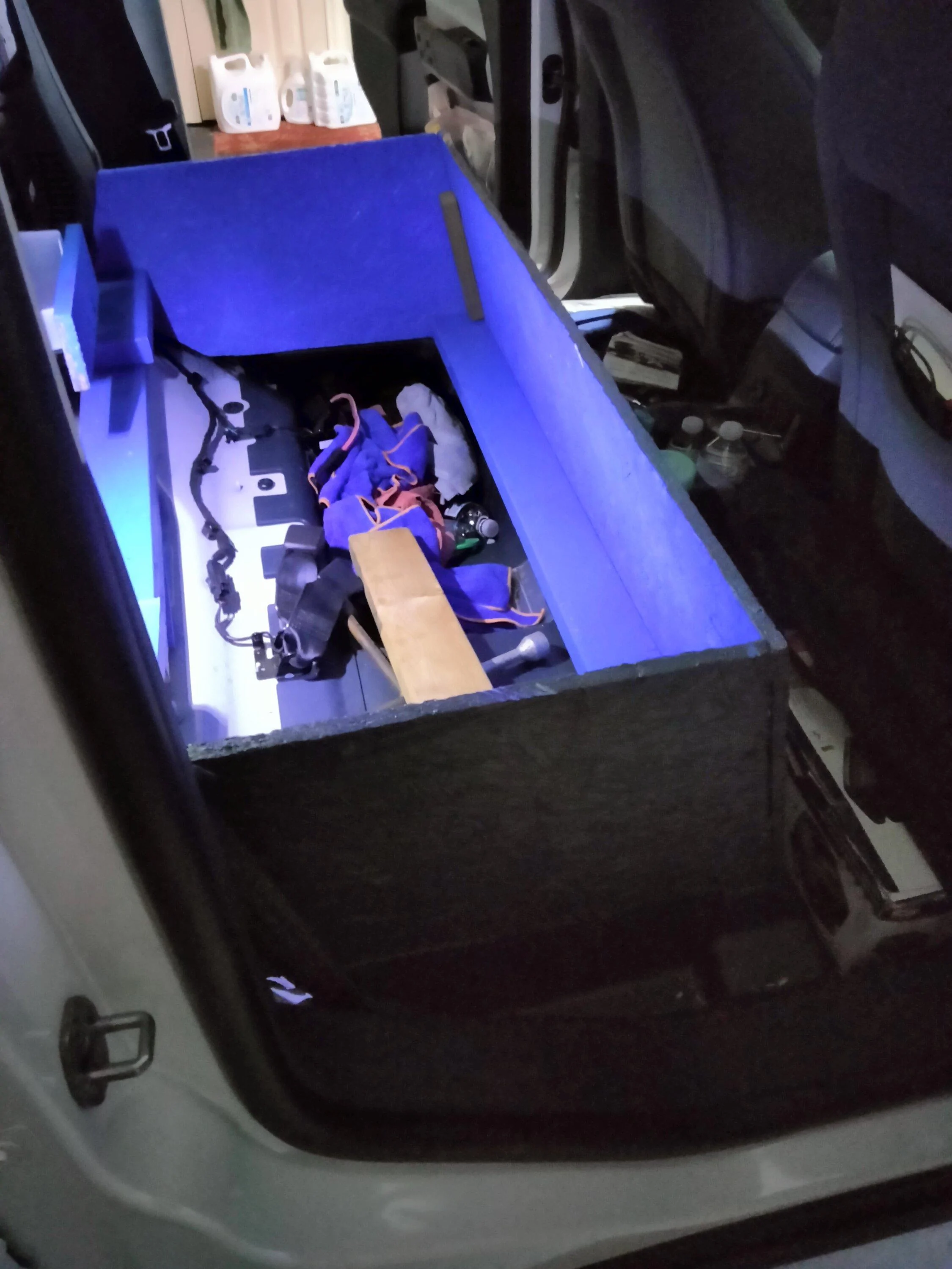

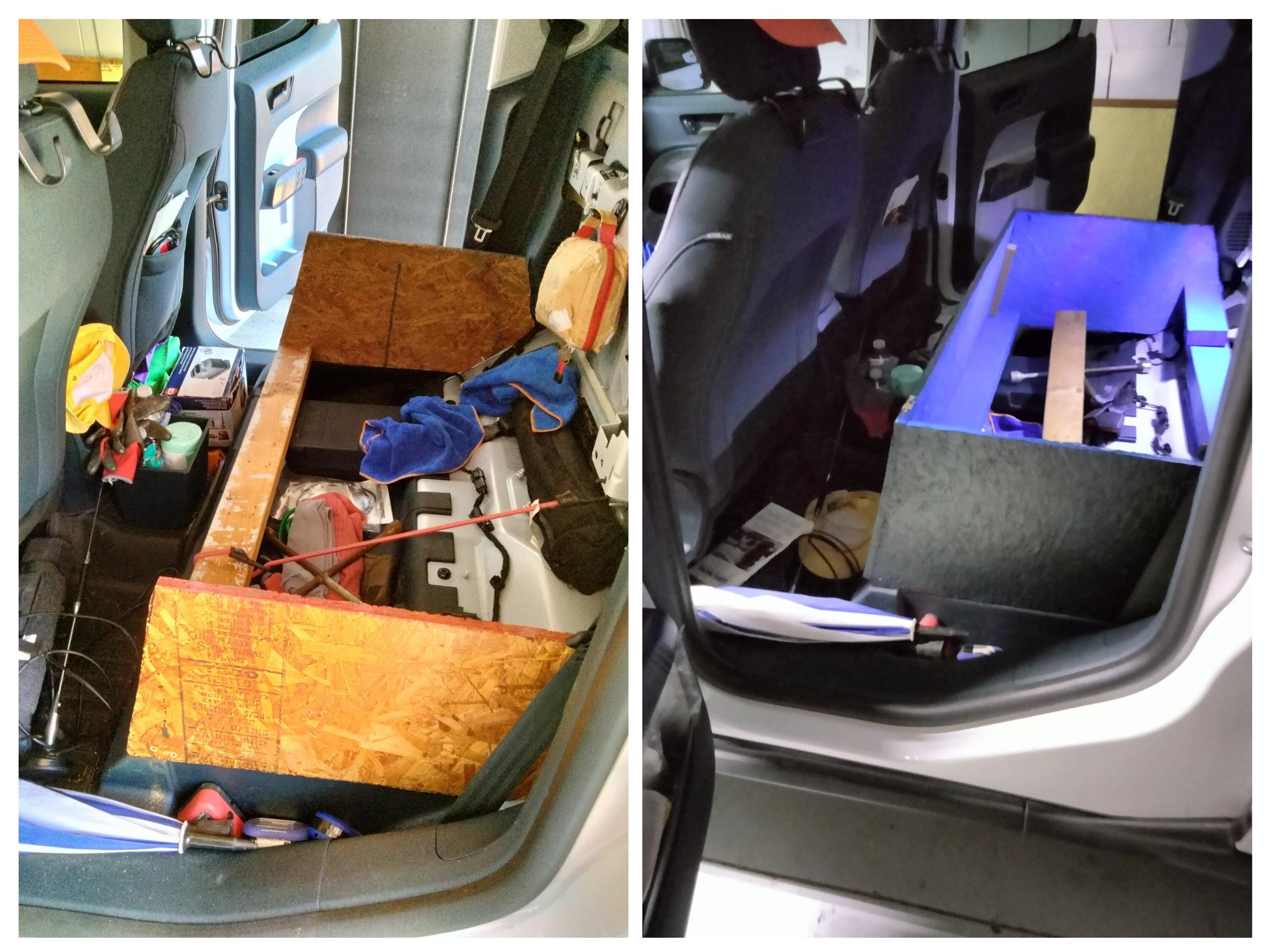

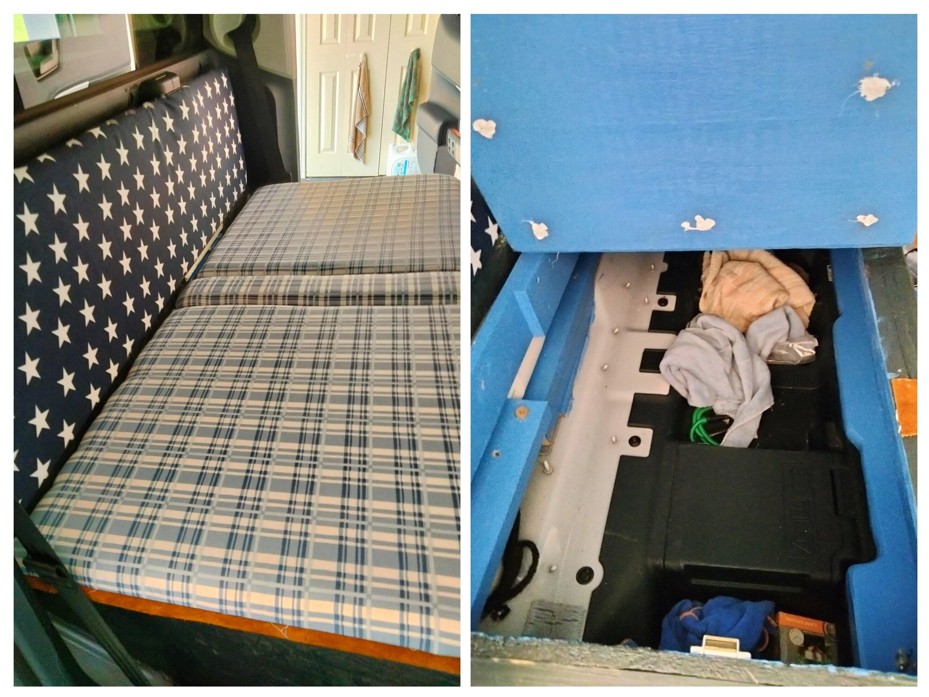

No just these and a couple of const photos, it's pretty straight forward, find something to attach it to front and rear, decide on materials and cut and fit, repete until you are happy with it.
I'd done this for the PriusV, the guy who bought the V insisted I leave it installed because it gave him a 6+ foot long platform that was about queen size at the doors but tapered to a single at the feet like the bow of a sailboat.
