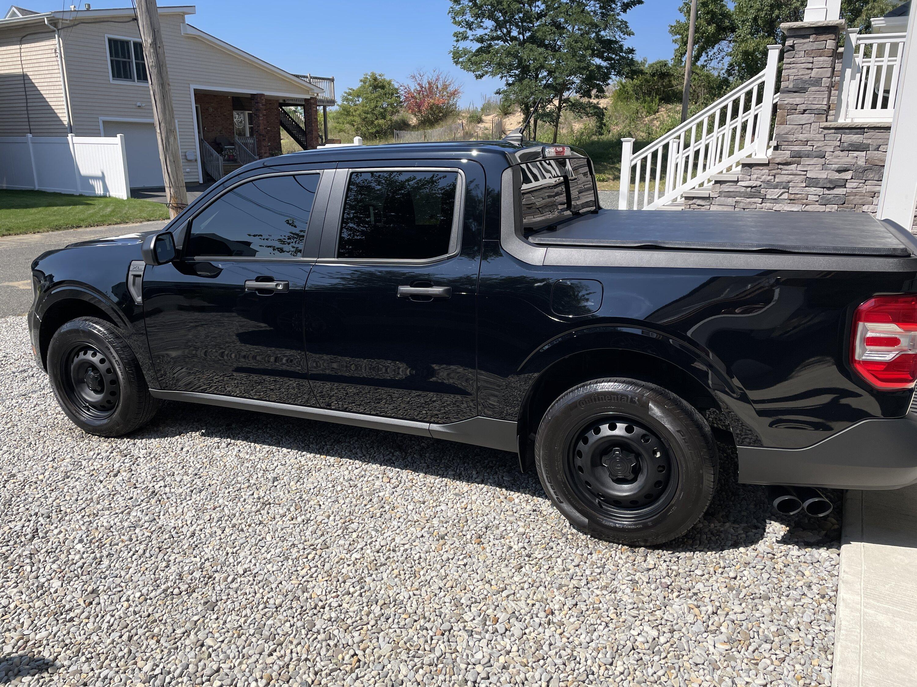

Decided to paint my rims. Used Raptor satin black wheel paint. And RustOleum satin black paint + primer for the caps because said adheres to plastic. I think came out pretty good. Cleaned, sanded w/ 400 grit, scotch brite scuffed, cleaned again and then Duplicolor prep spray and plastic adhesion spray. Let me know your thoughts.
