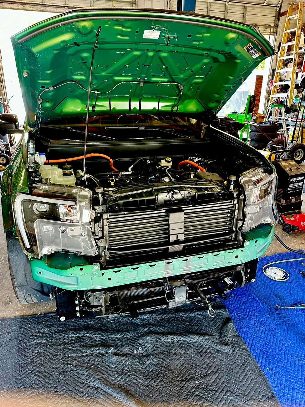

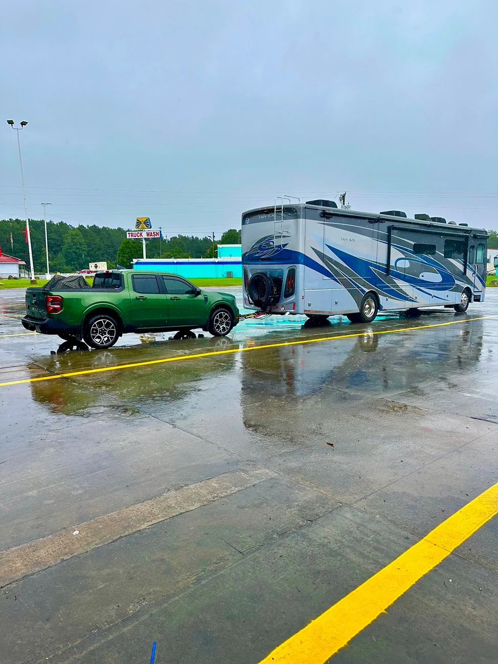

I did Blue Ox as with my many previous installations.. The install went as expected. I've installed many of my own baseplates. This one was not challenging. It did involve thought, a lot of time, and skinned knuckles.
I would ABSOLUTELY advise getting the [more than you need but, no, you need it] Blue Ox Apollo. Don't go cheaper. Don't go less.
Works great.

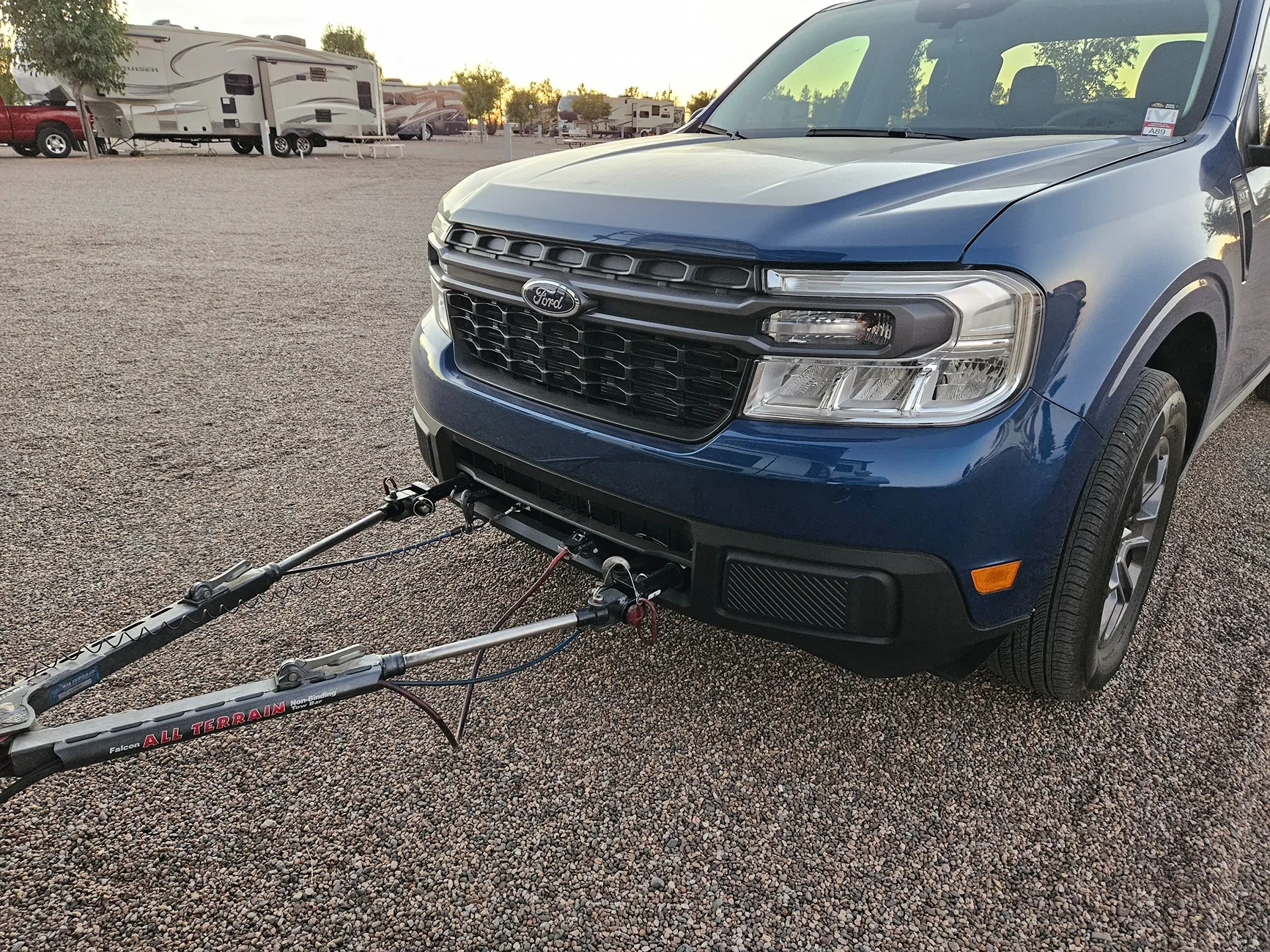

I installed the Roadmaster base plate on my 2023 XLT, which like the Blue Ox requires removing the lower active shutter vanes. The Demco baseplate does not require removal of any vanes. The Demco was not available when I installed my baseplate or I would have gone with it. I have a Roadmaster Falcon All-terrain tow bar and use a RVI2 supplemental brake. I also tow a 2006 Jeep Liberty so the portable brake works best for me. I now have right at 22,500 miles towing the Mav with no issues.
Ford Maverick NSA Ready Brute Flat Tow System? Maverick hooked up 01
