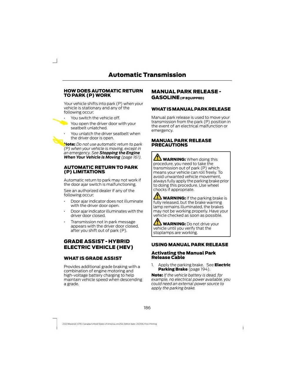

Did you have you seatbelt fastened?
If your seatbelt was not fastened this is normal operation for your safety and the safety of those around you.
If your seatbelt was fastened you probably should have your dealer check it out.
Associated page from the owners manual -

So it will do that going forward.. That is interesting.
