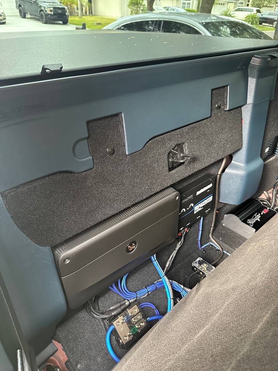

Looks clean especially the wiring of sub and amps, would post a detailed write up on it and where did you get that black trim for the rear trunk wall, looks so clean.

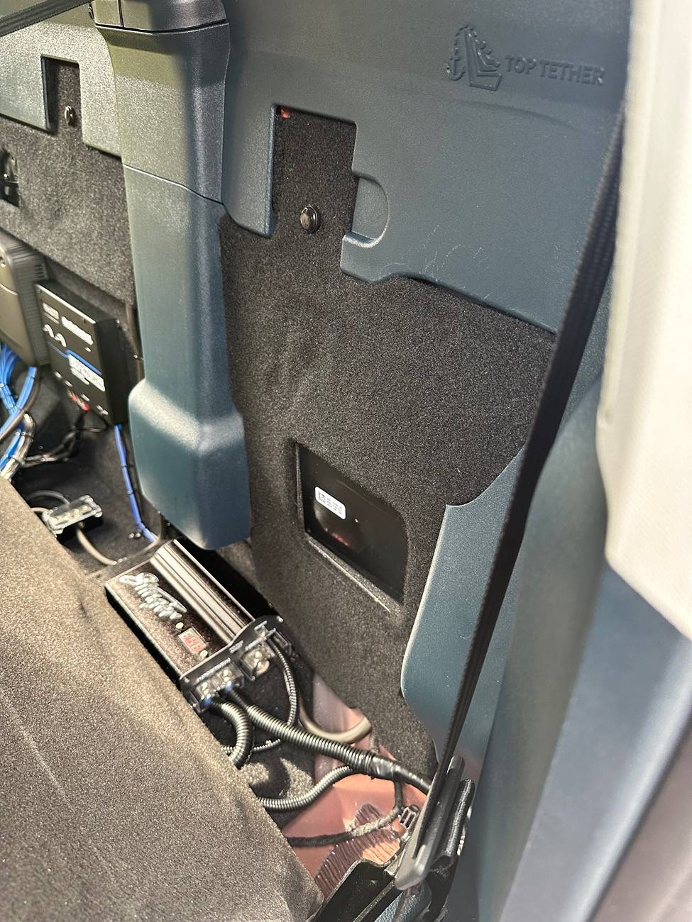

The black trim on the back wall is just black car carpet from the install bay wrapped around some 1/8" luan paneling. Easy to work with and very light. The system runs from the head unit via an audio control line level converter. Goes through the epicenter, the EQL, then to the 5 channel amp. I am using Morel components up front. Using channels 1/2 for the components. Channel 5 is mono feeding 500 watts to the subs. Channels 3/4 are unused at the moment, and may be used for a center channel in the future. 😜 Running 4 gauge from the battery to the distribution block, after passing through a 5 farad hybrid capacitor. Ran a 1/0 cable to the ground block and cap, so no chance of weak ground. The little panel under the HVAC controls house knobs for bass level and the epicenter. Been doing car audio since 1988, so I am PASSIONATE about it. Using Morel 4" coaxes in the rear, with the head unit supplied signal. Just for fill, but still wanted the right "tembor" from 'em. The components up front are using their supplied passive crossover, and they are mounted under the dash. Had to run new leads to the tweeter, but didn't have much issue with that. I initially put the tweeters under the dash grills, but didn't feel like they sounded quite right. After putting them on top of the carbon fiber "grills" they sound so much better. The Optima yellow top does a fantastic job with keeping up with the draw.
I might need your contact info, have few questions about the Audio install

Send me a DM, I would be happy to help anyway I can
