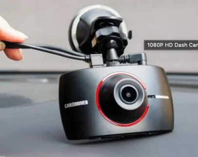

Maverick "Chirping seat" problem solved! Yesterday, when I got into my Maverick, the chirping problem got so bad I was able to isolate the sound and it's origin. Turns out it was my four-month-old Car & Driver dash camera. I unplugged the camera, mounted in the passenger windshield area, and suddenly no more chirps. Now I need to get another dashcam.
