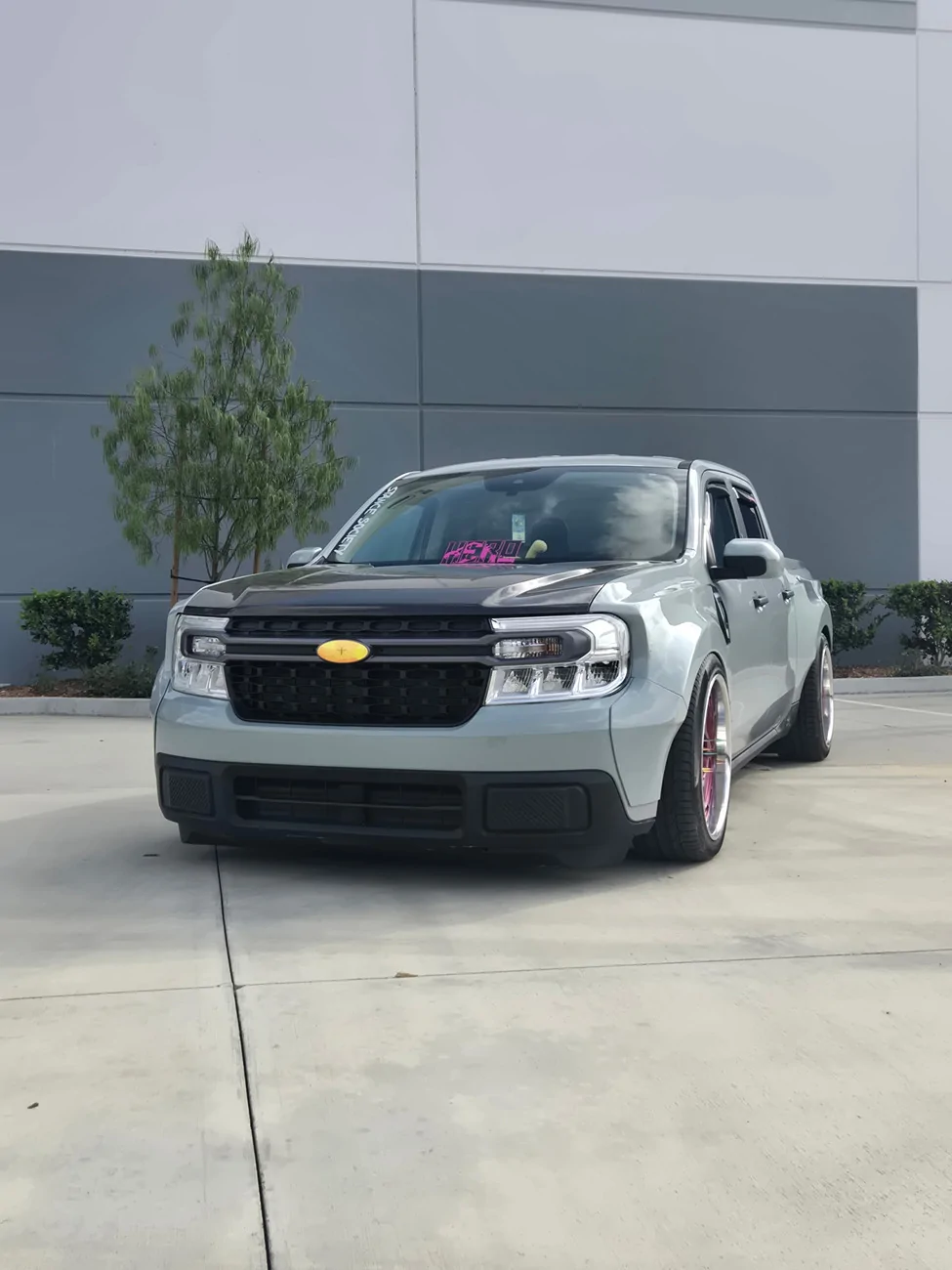

Sorry for the quick pictures, but the livery has returned. So this part of the builds complete. (Widebody, wheels, livery refresh). Time to enjoy her while I work on an interior and lighting plan.
The new livery has more pink and also reflective bits. It's close to the old one in design, but not identical. @MABETT side turn signals and tails. I'll post better pictures in this thread after I get some.
That’s pretty cool. The mods look as expensive as the truck itself! Was this an xlt model? It’s a beauty!

Yea. I haven't taken any good pictures. But here are a couple without.
Def see the 'wide body' bits a bit more now.
Do they replace the front fenders, or 'addon' to existing (looks l ike something adds onto the front bumper).
Or are they cutting stock front and rear fender wells?
Then using offset spacers to get the wheels to stick out?
Looks like you could fit a big fat wheel in the back, and give it a 'drag truck' profile in the rear, with a skinny in the front. :D
(Ex-V8 S10 owner here, I had some fatties on the rear of that.)

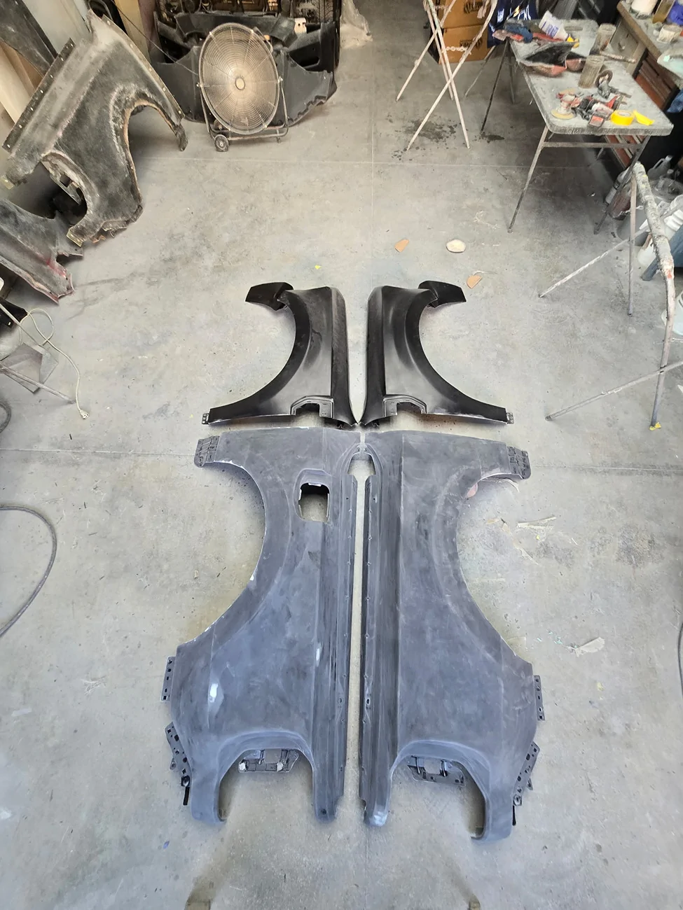

We cut my stocks, and installed the flares and molded. then made molds. So these are full fender replacements. They are 2" wider each side in the front and 3" wider in the rear. Available for purchase, but he hasn't gotten a website up.
My wheels are custom 2 piece. 20x9.5. offset +4front and -23 in the rear.
