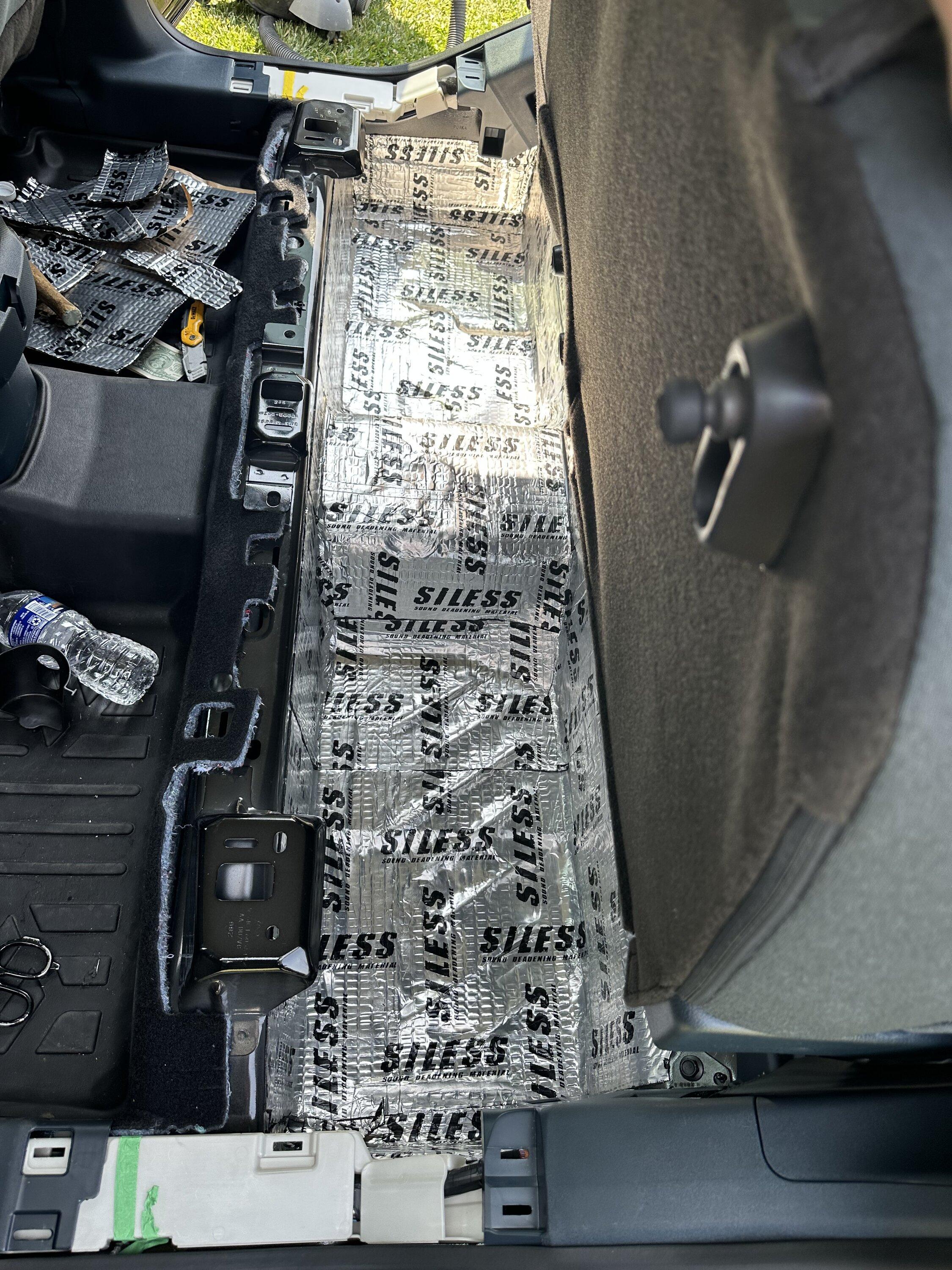

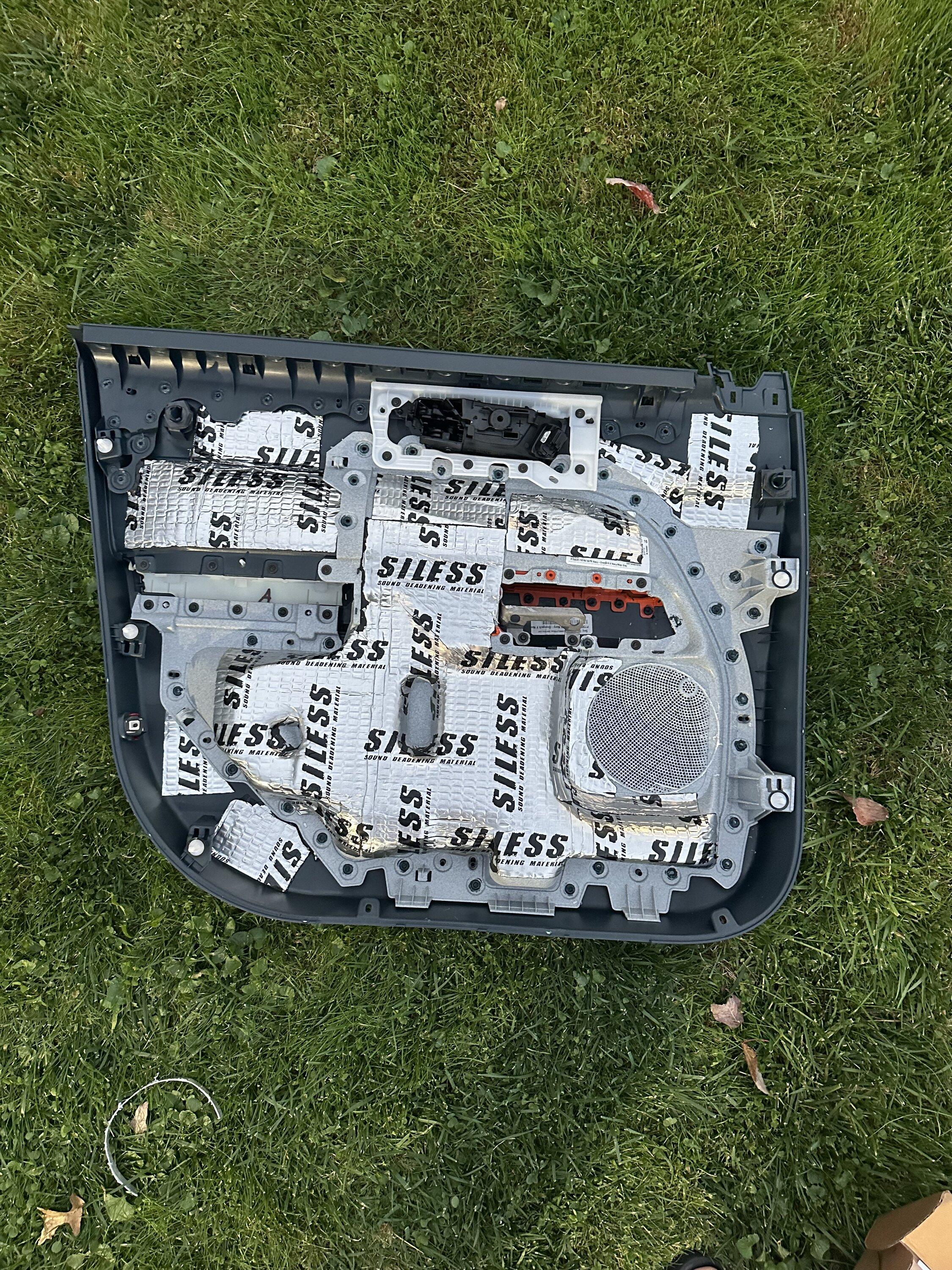

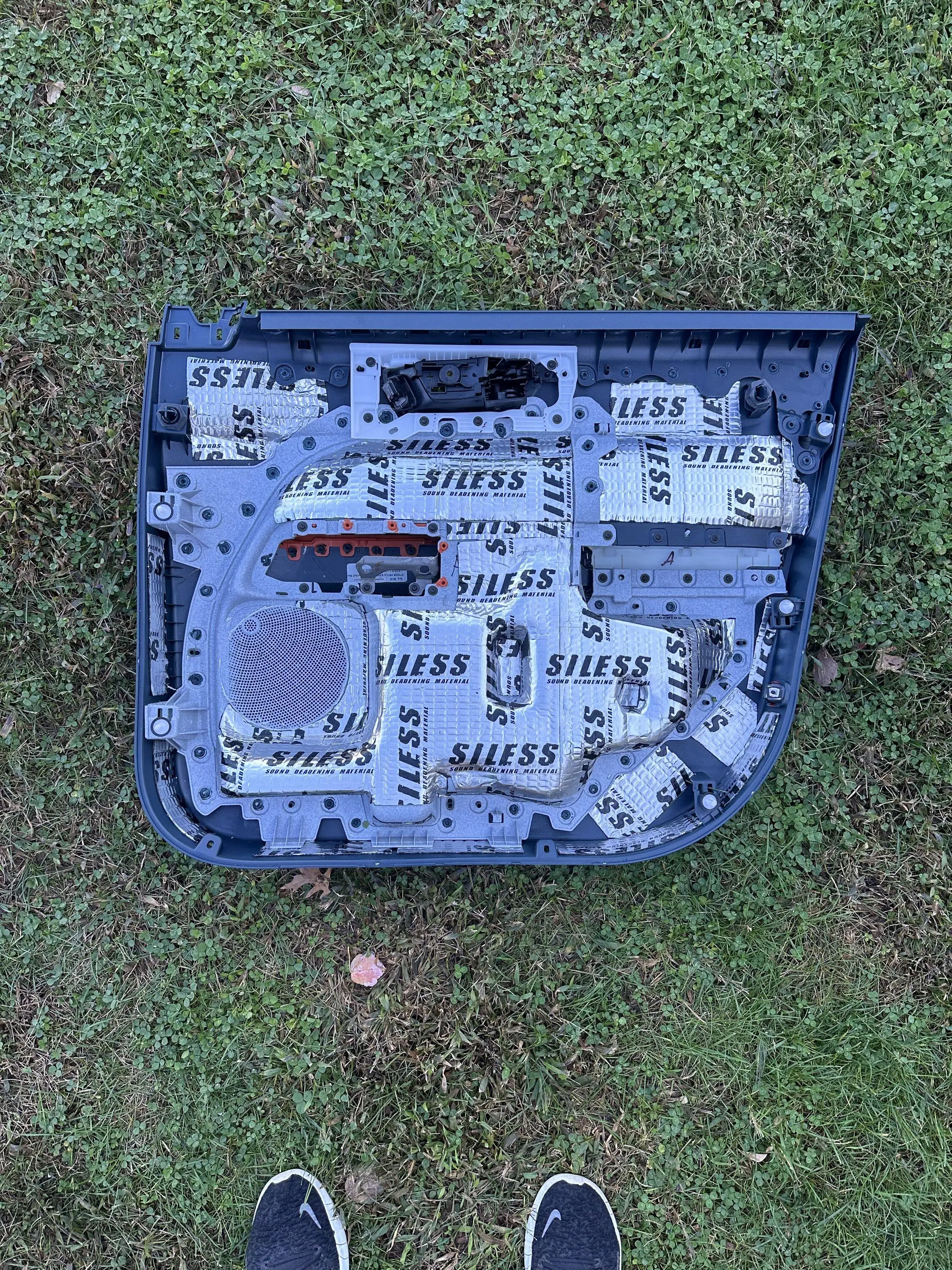

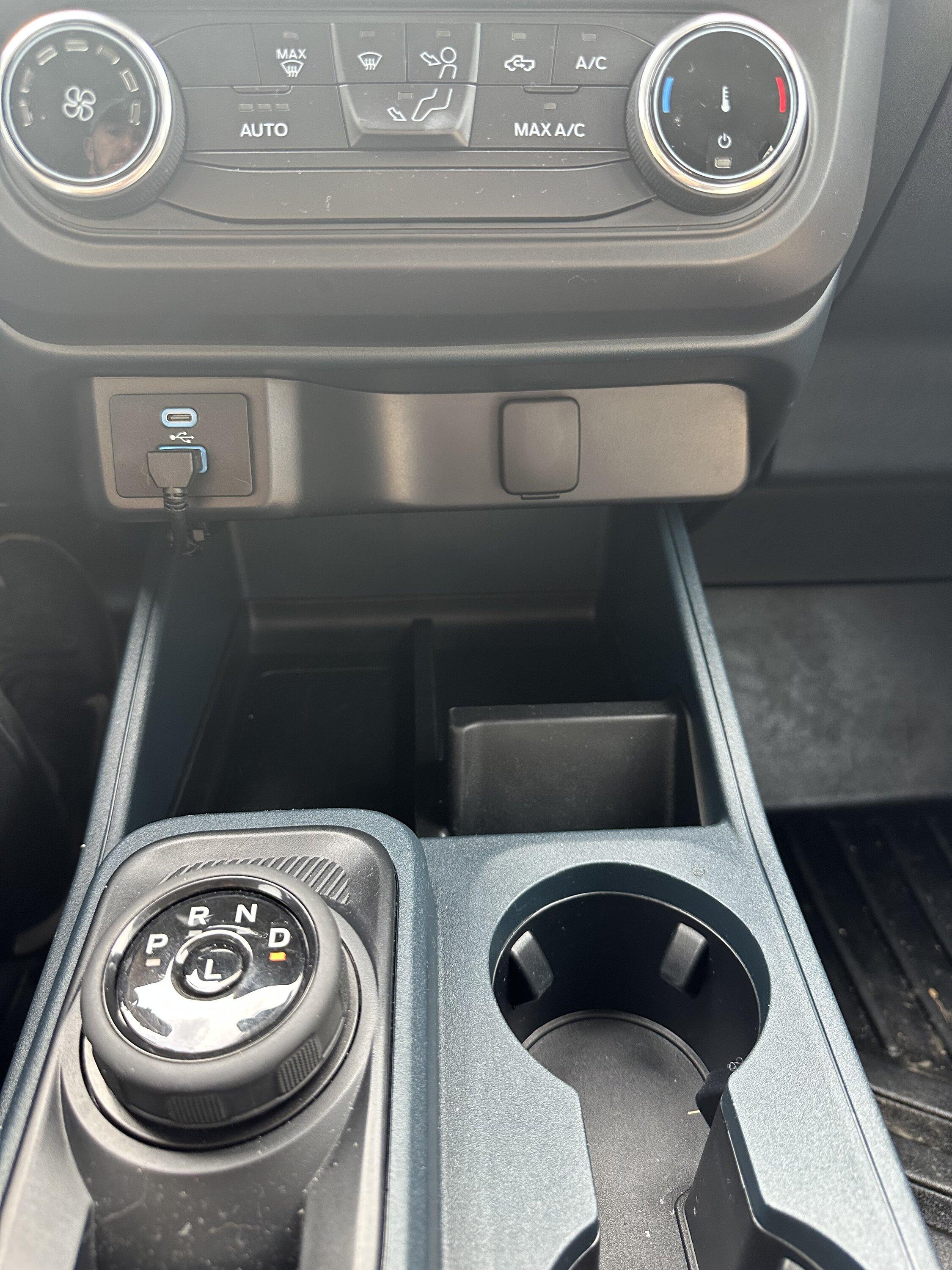

More process on the stereo. Put some sound deadener underneath the seat bin and sub box.
Ford Maverick Mikey’s XLT IMG_5785

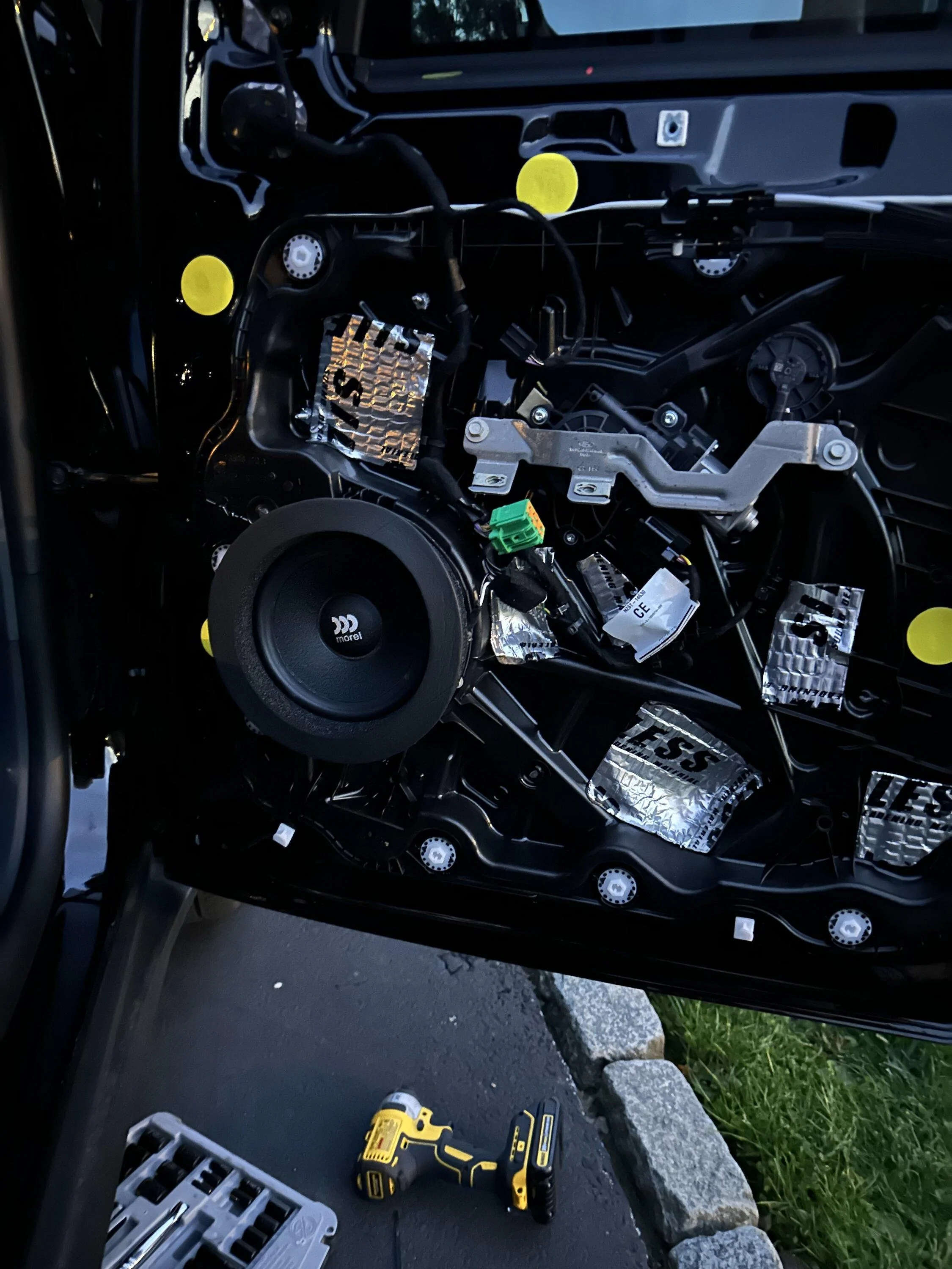

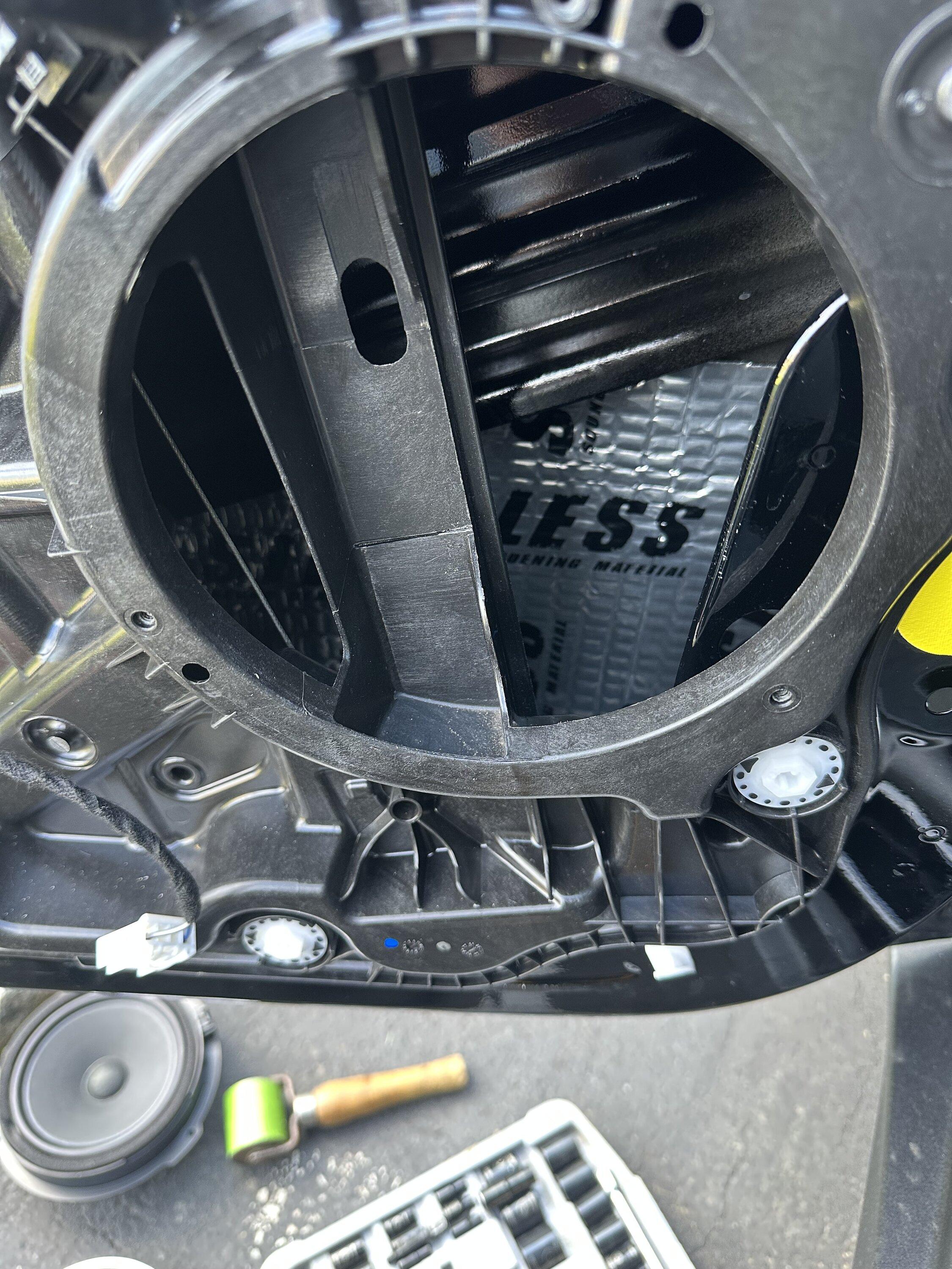

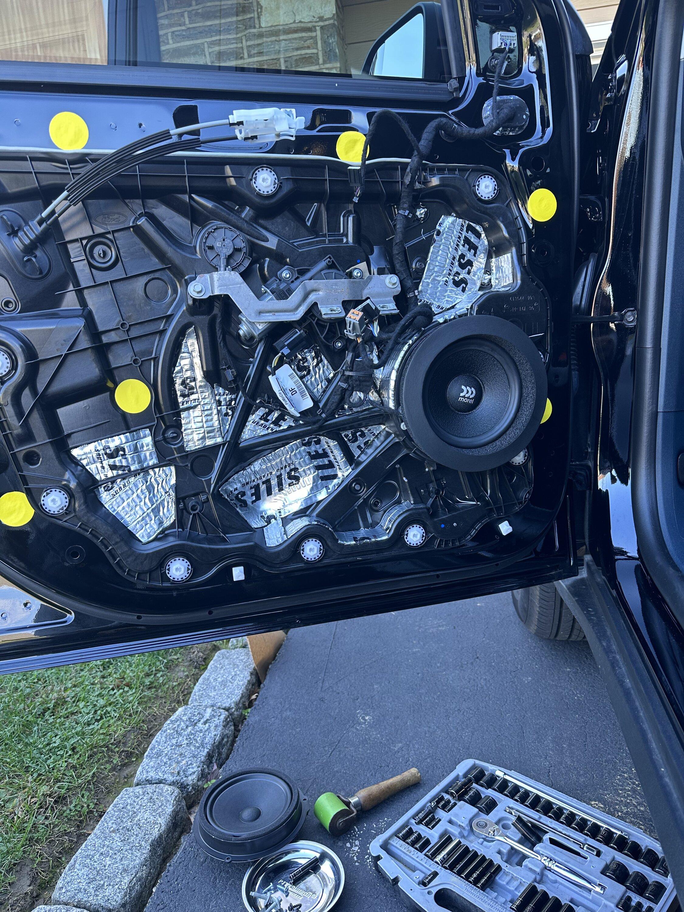

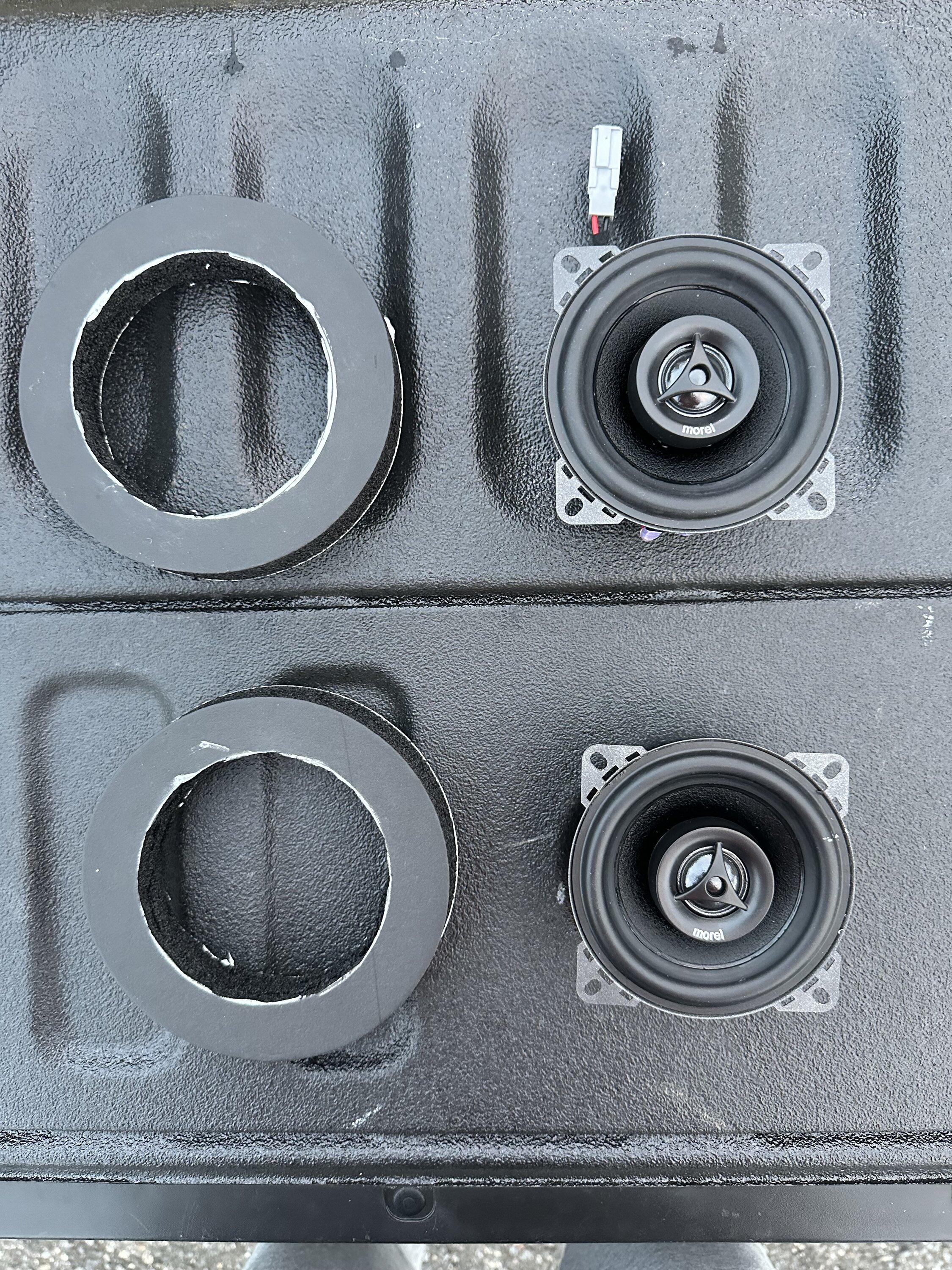

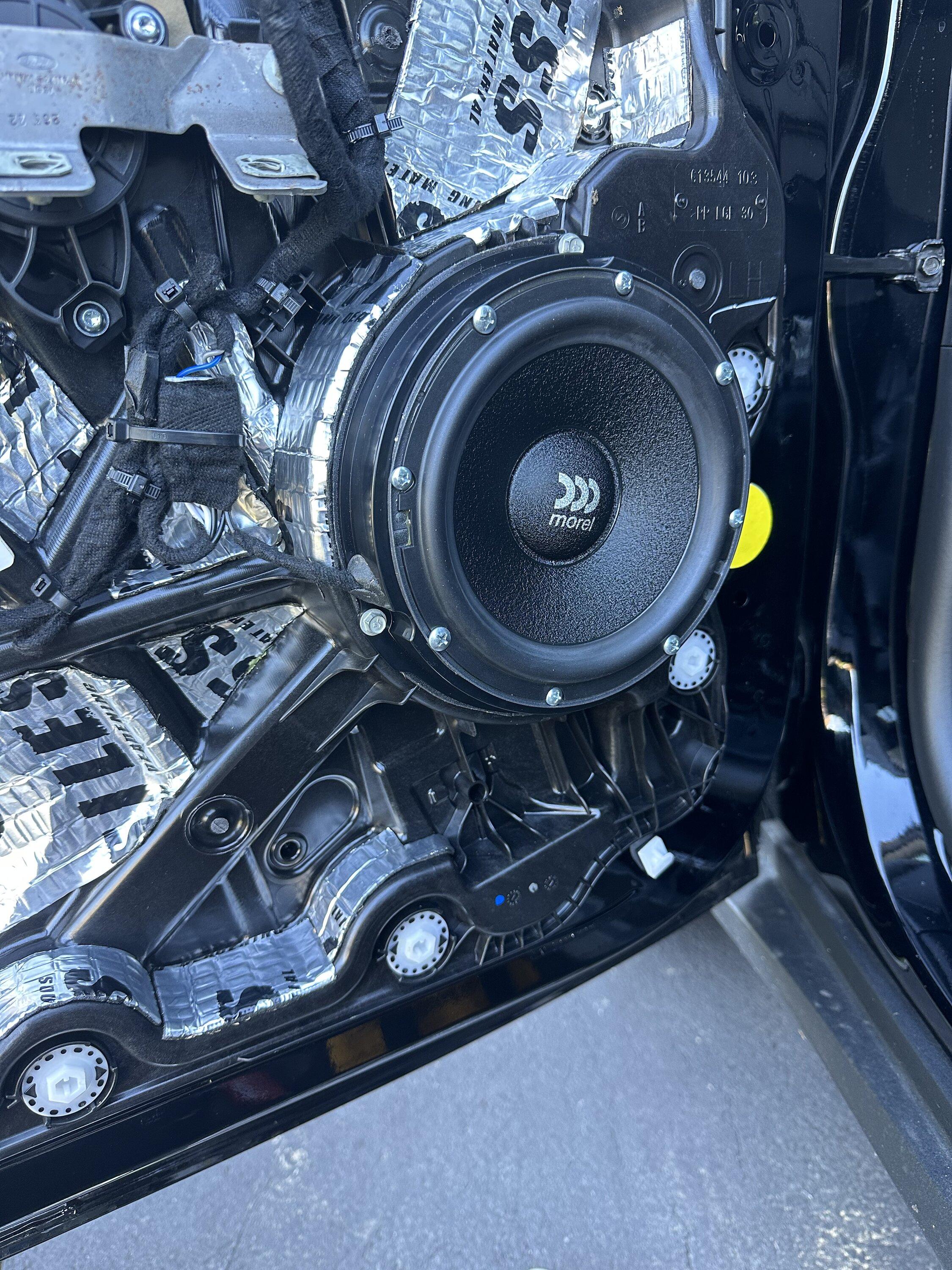

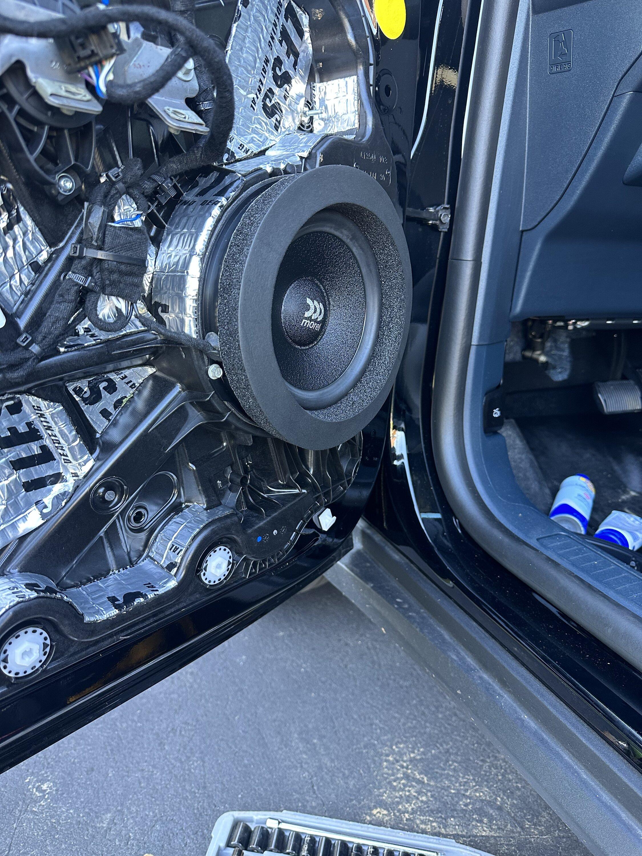

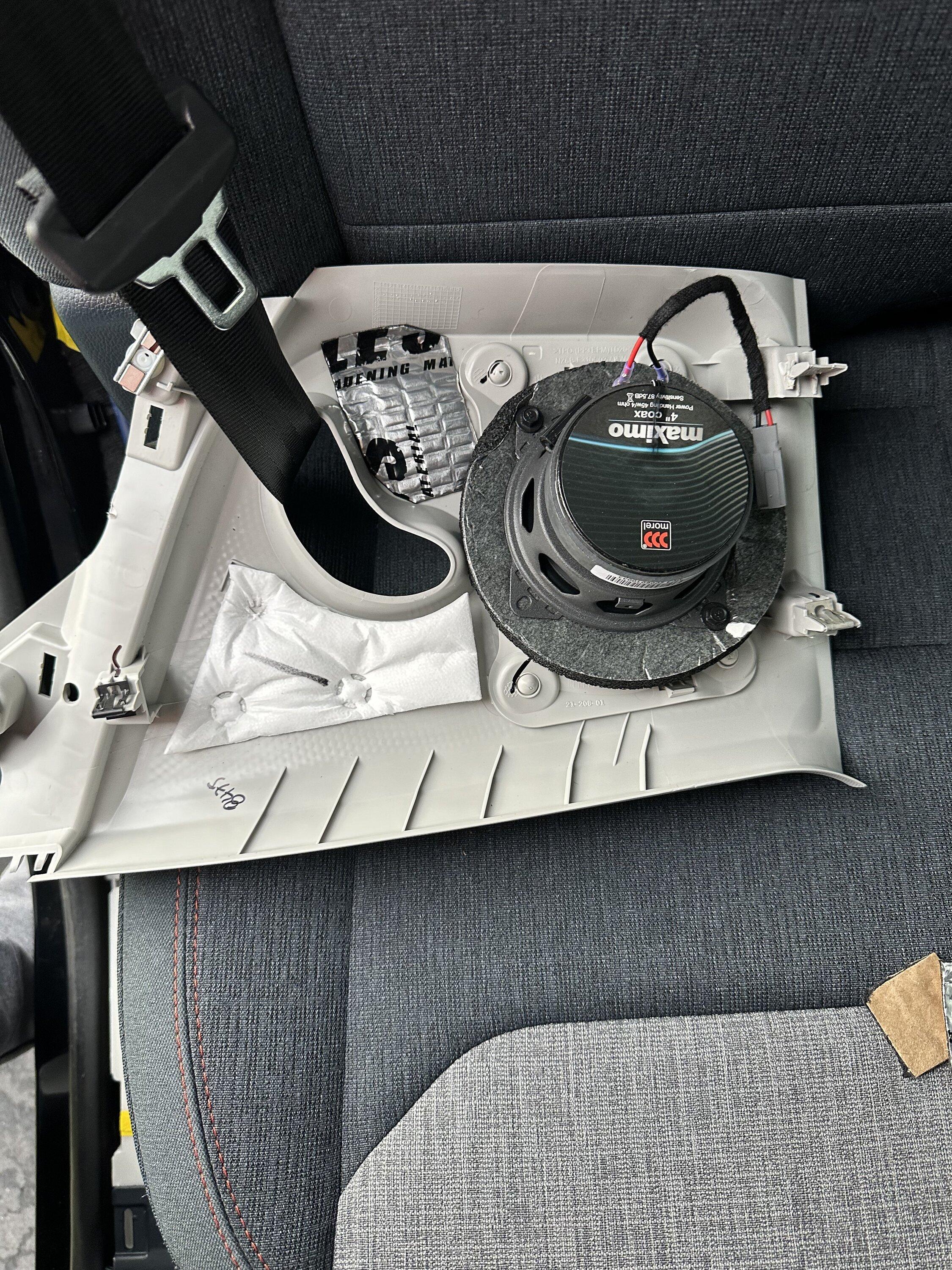

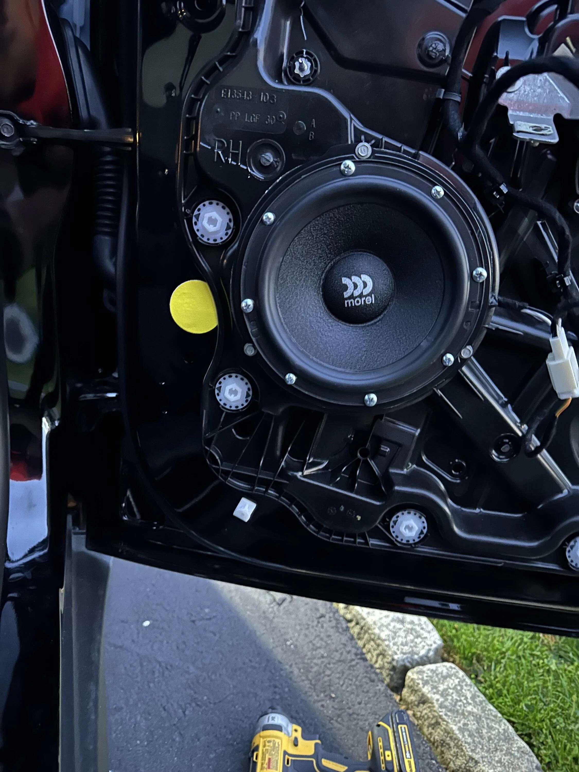

Also installed the front door speakers
Ford Maverick Mikey’s XLT IMG_6771
Ford Maverick Mikey’s XLT IMG_6772
Ford Maverick Mikey’s XLT IMG_6770
Ford Maverick Mikey’s XLT IMG_6782
Ford Maverick Mikey’s XLT IMG_6783
Ford Maverick Mikey’s XLT IMG_6788
Ford Maverick Mikey’s XLT IMG_6789
Ford Maverick Mikey’s XLT IMG_6778
Ford Maverick Mikey’s XLT IMG_6790

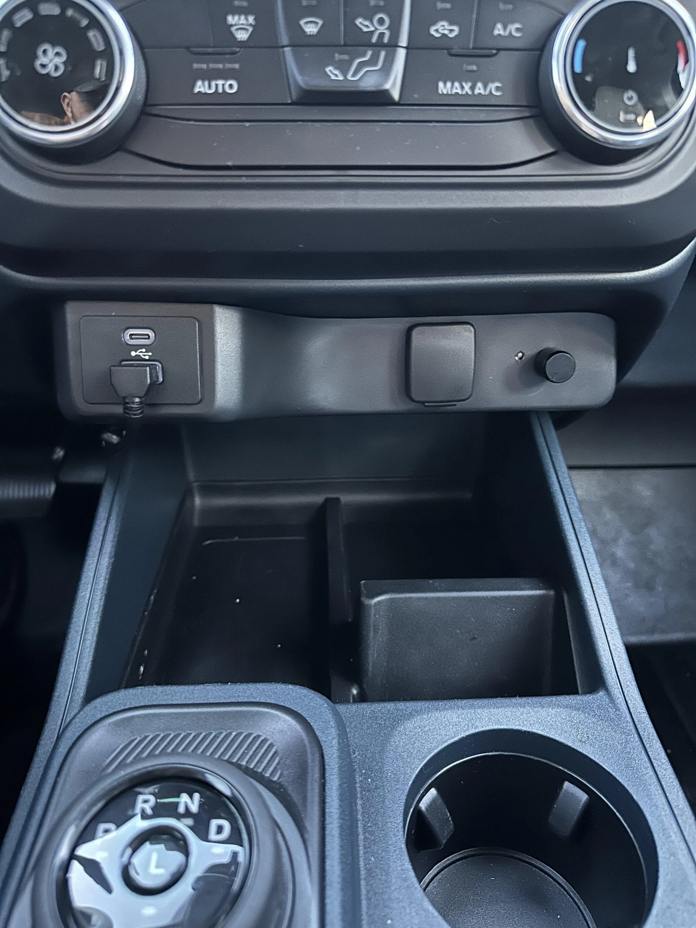

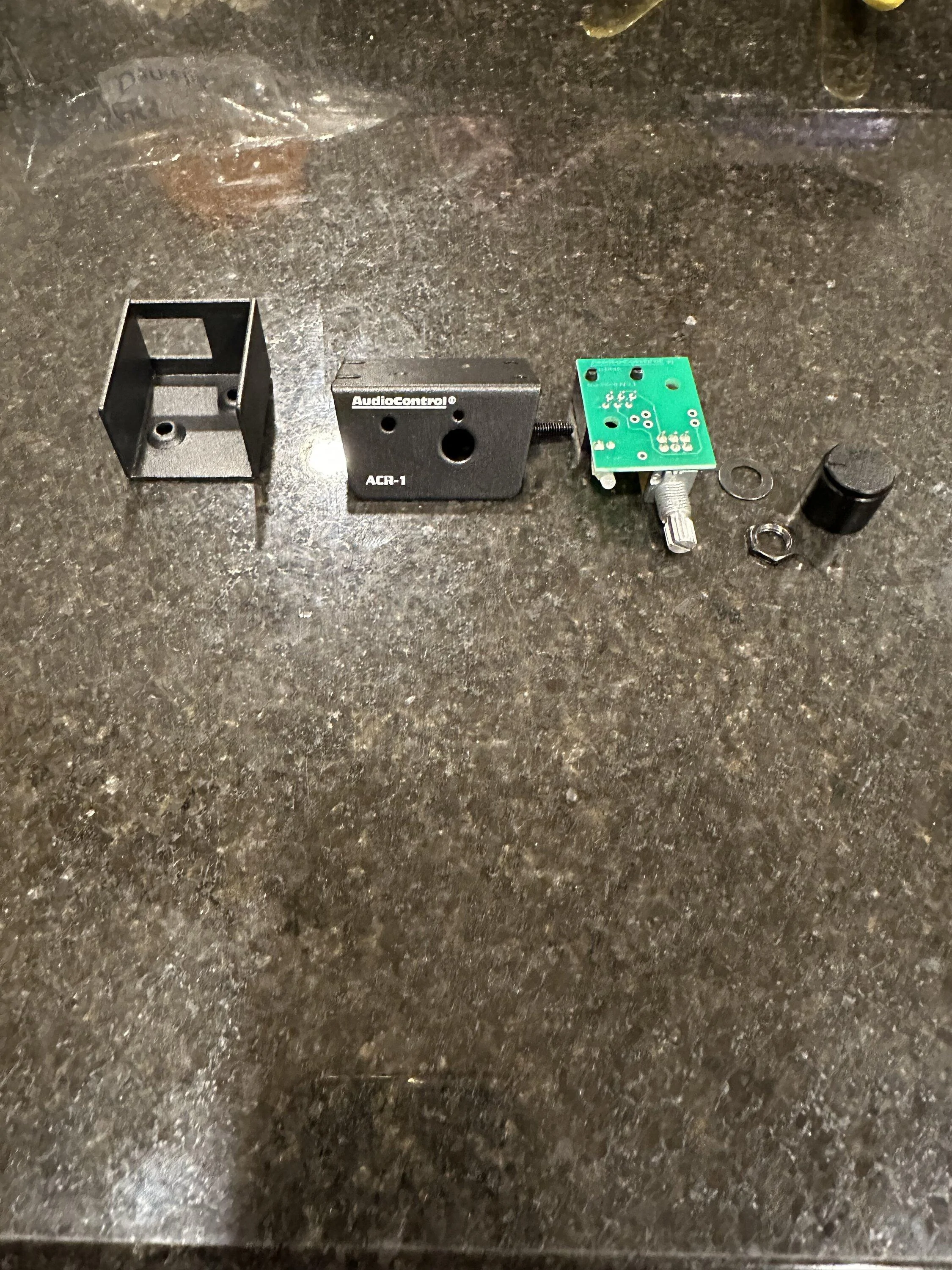

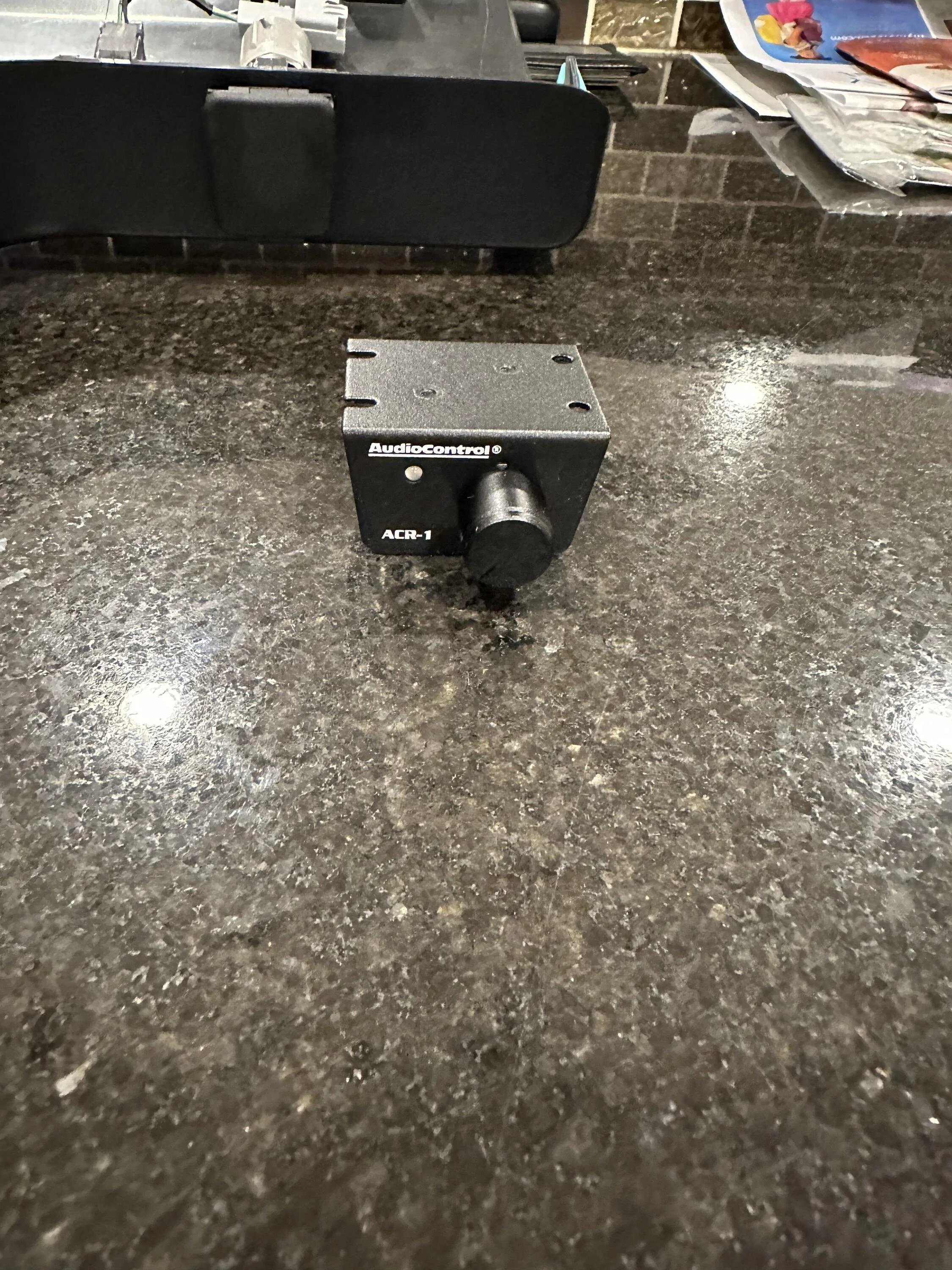

Got the audio control bass knob mounted.

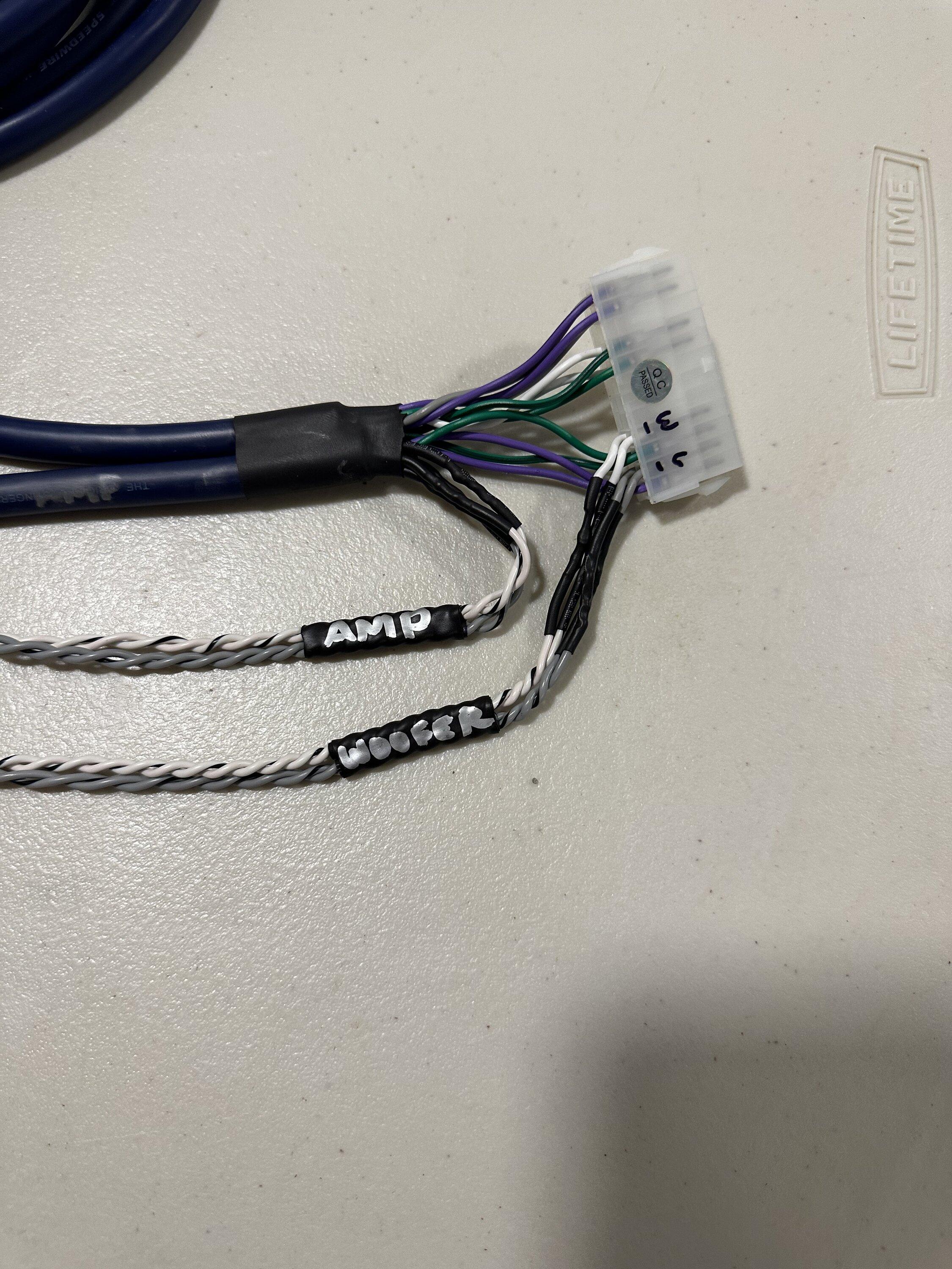

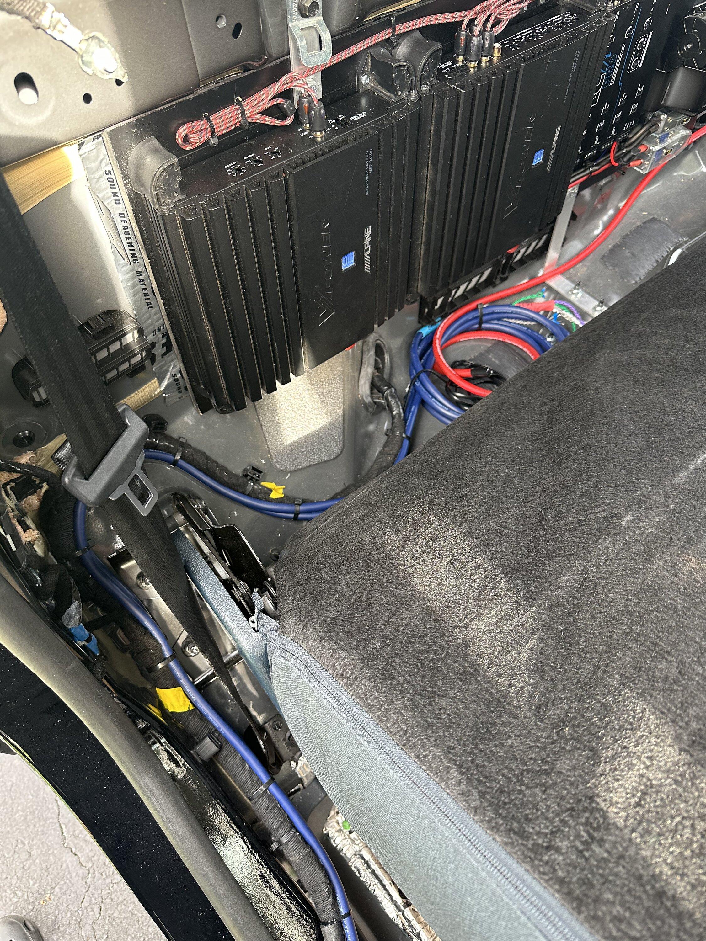

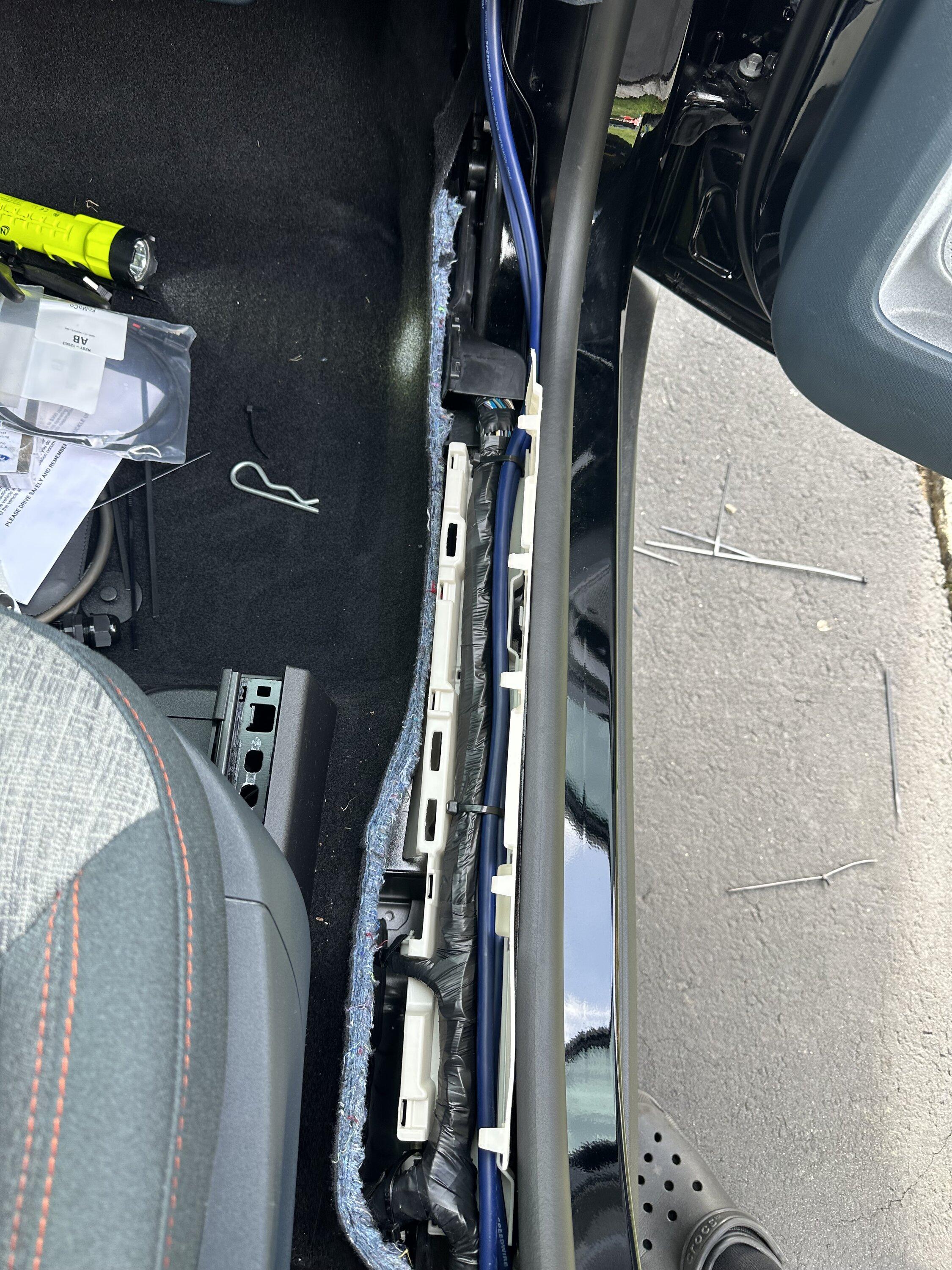

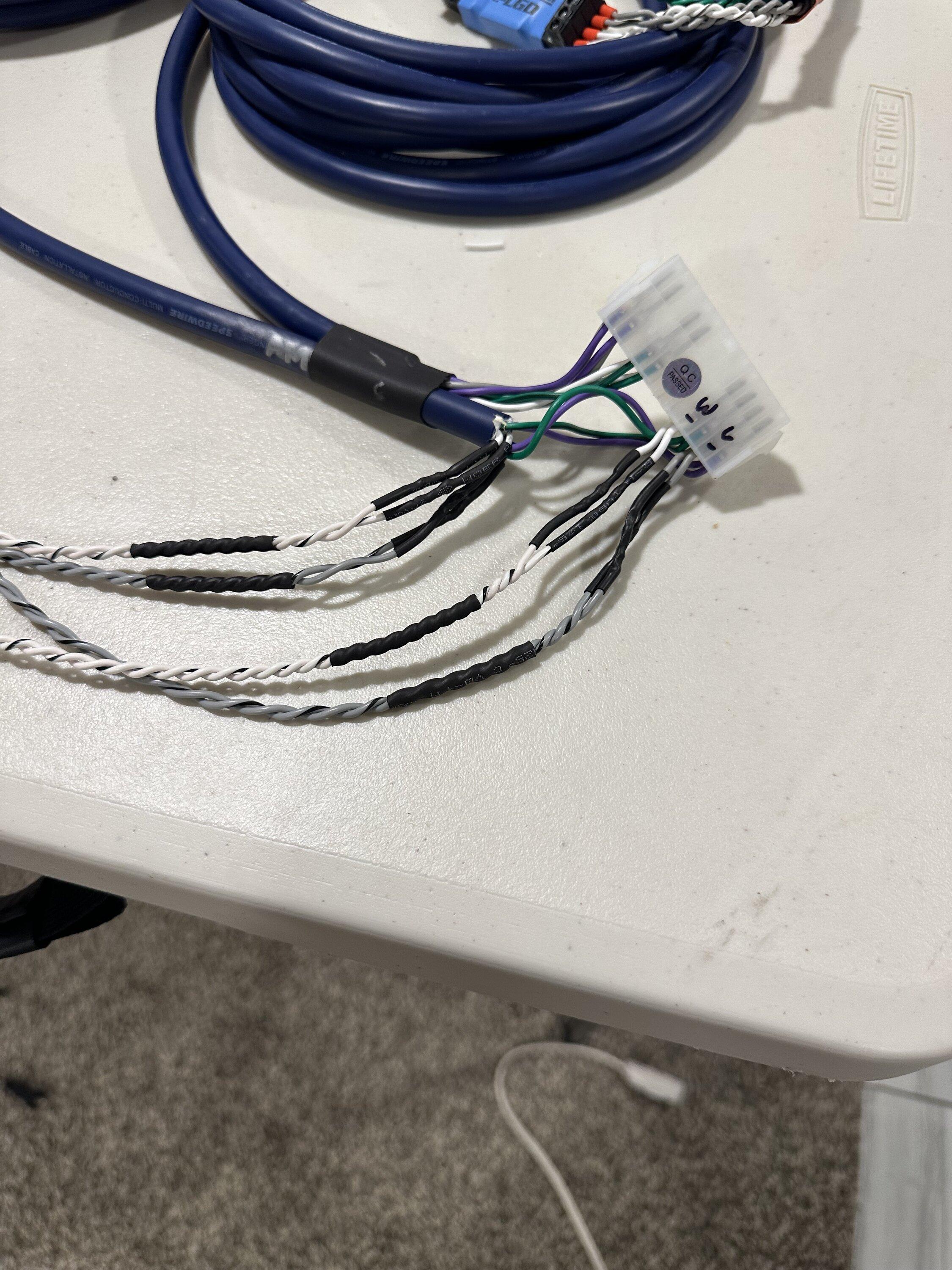

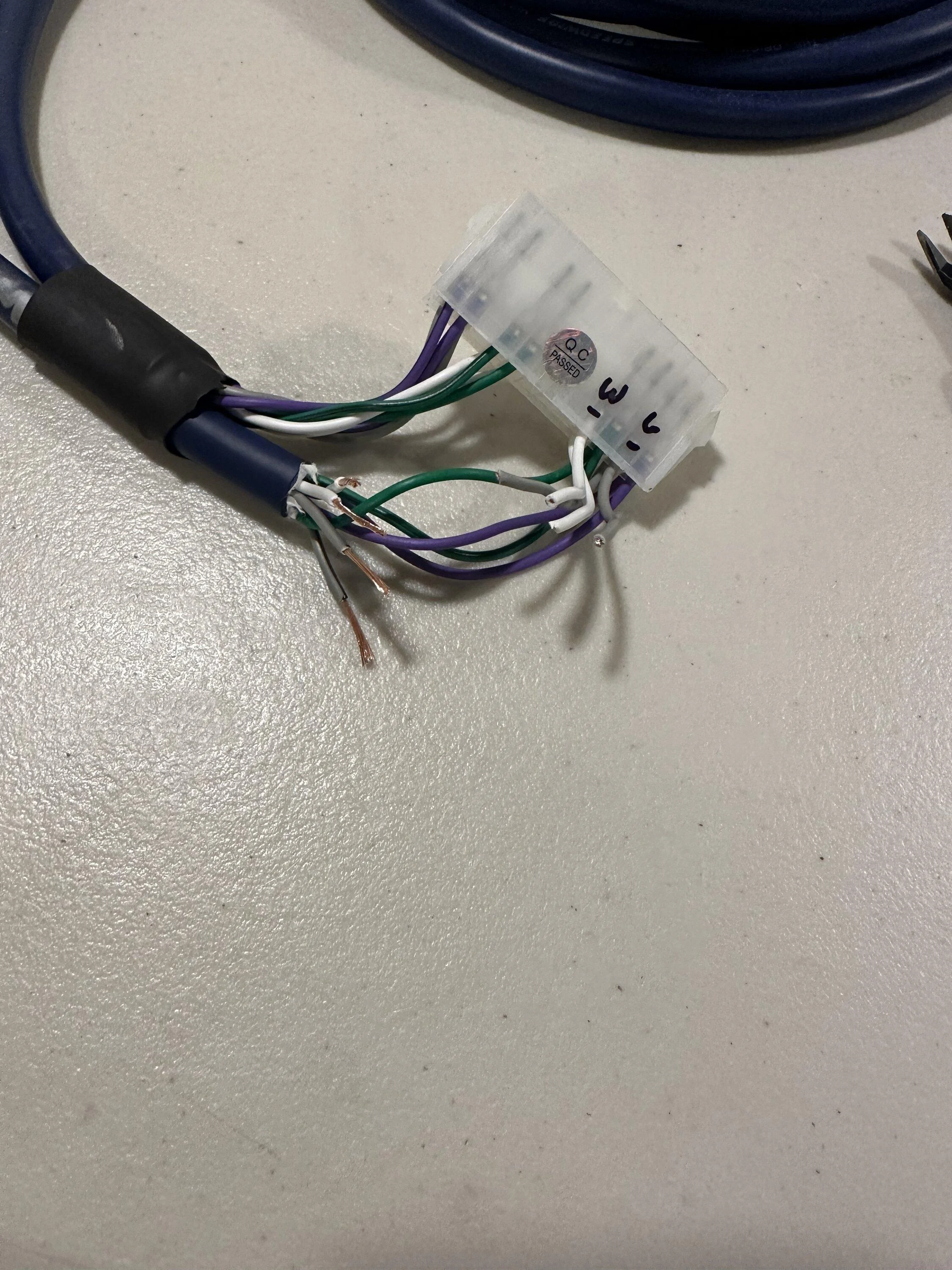

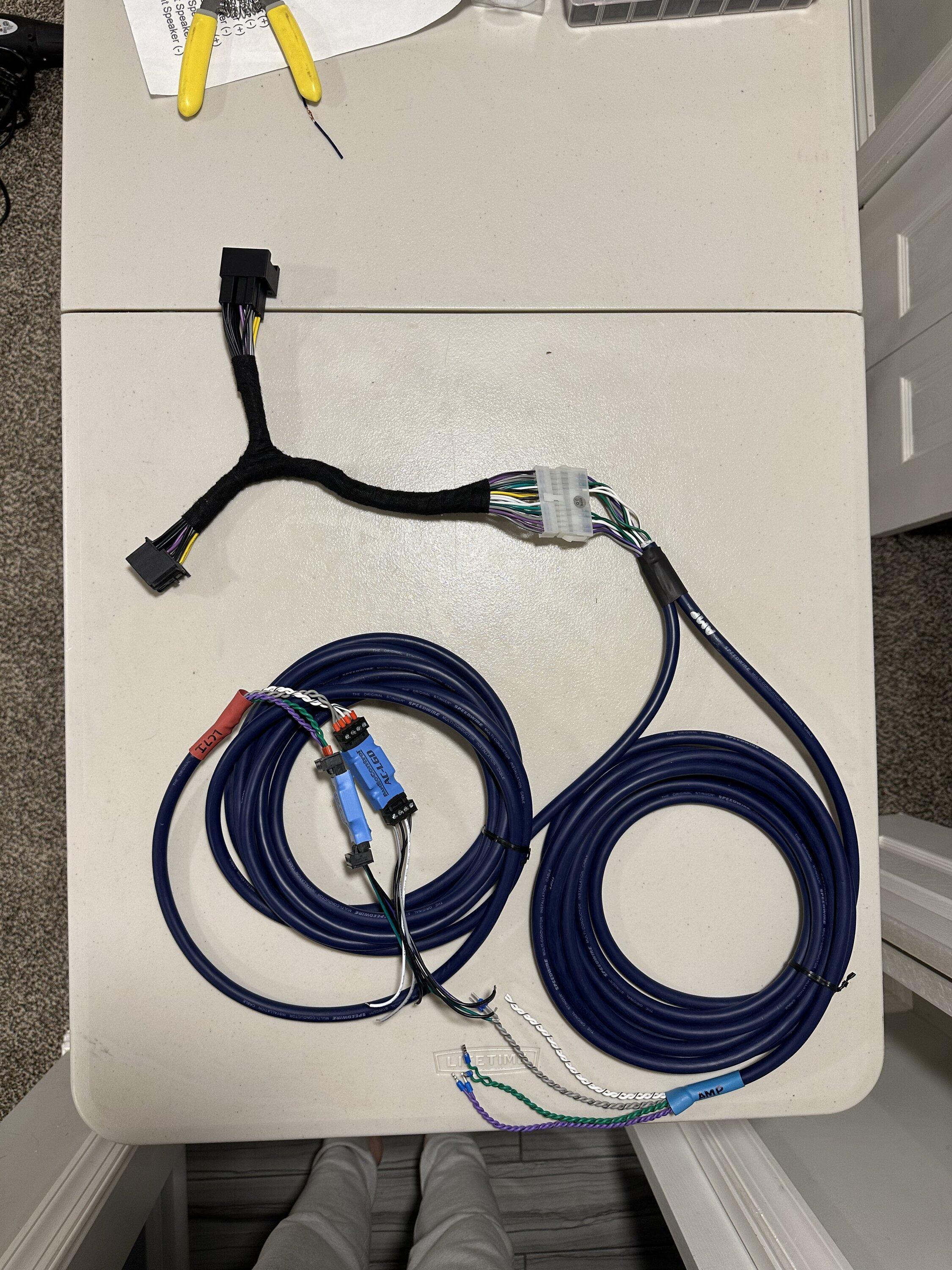

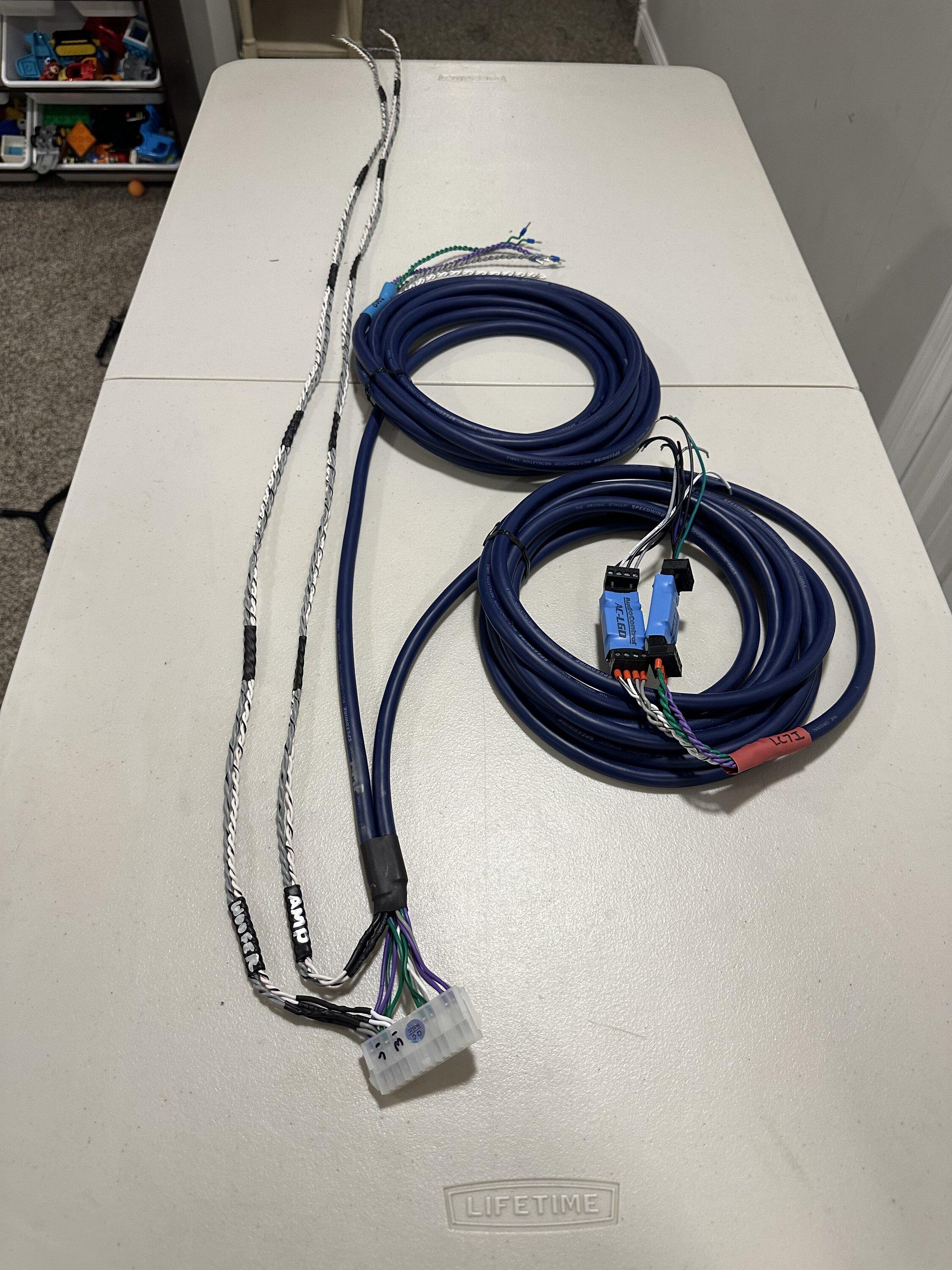

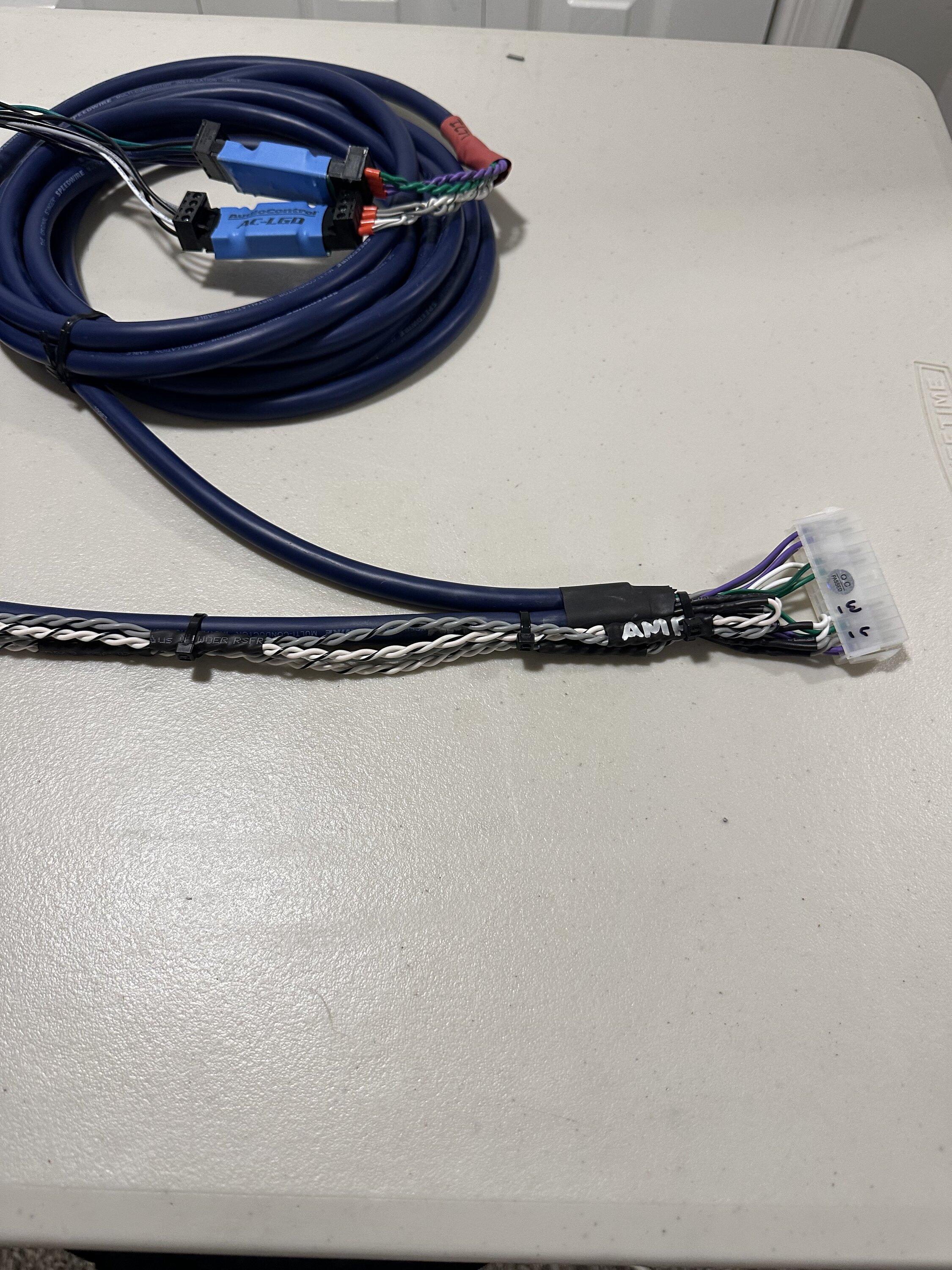

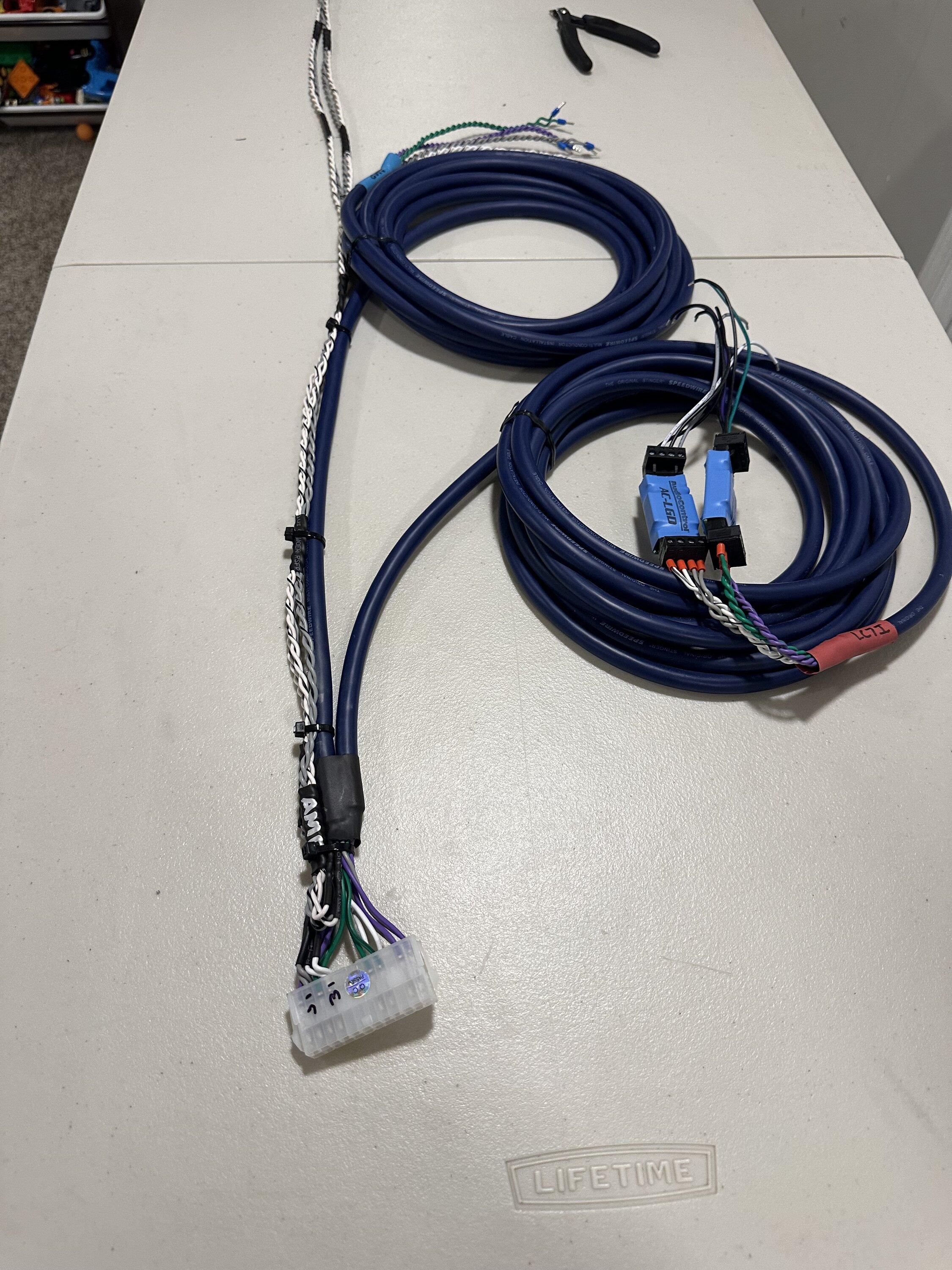

Making some more process on the stereo. Got the loopback harness ran and the amp power wire. I had to modify the loopback harness with longer wires to run into my crossovers. For anyone not familiar with what the loopback harness does. It’s two 9 wire conductor speed wire that comes with a t harness that tires into the the radio harness. They both run from the radio to back behind the rear seats where my amp rack is. The one side taps into the speaker wires for the signal and brings that back to my lc7i and the other side goes from the amp and brings the amped speaker signal back to the factory speakers. The amped side I had to cut and extend the wire to tie into the amped side and door speaker side of my crossover. For the tweet I will just run my own wire once I put them into the factory location.
Pics of the loopback
Ford Maverick Mikey’s XLT IMG_6866
Ford Maverick Mikey’s XLT IMG_6867
Ford Maverick Mikey’s XLT IMG_6868
Ford Maverick Mikey’s XLT IMG_6873
Ford Maverick Mikey’s XLT IMG_6874
Ford Maverick Mikey’s XLT IMG_6875
Ford Maverick Mikey’s XLT IMG_6876

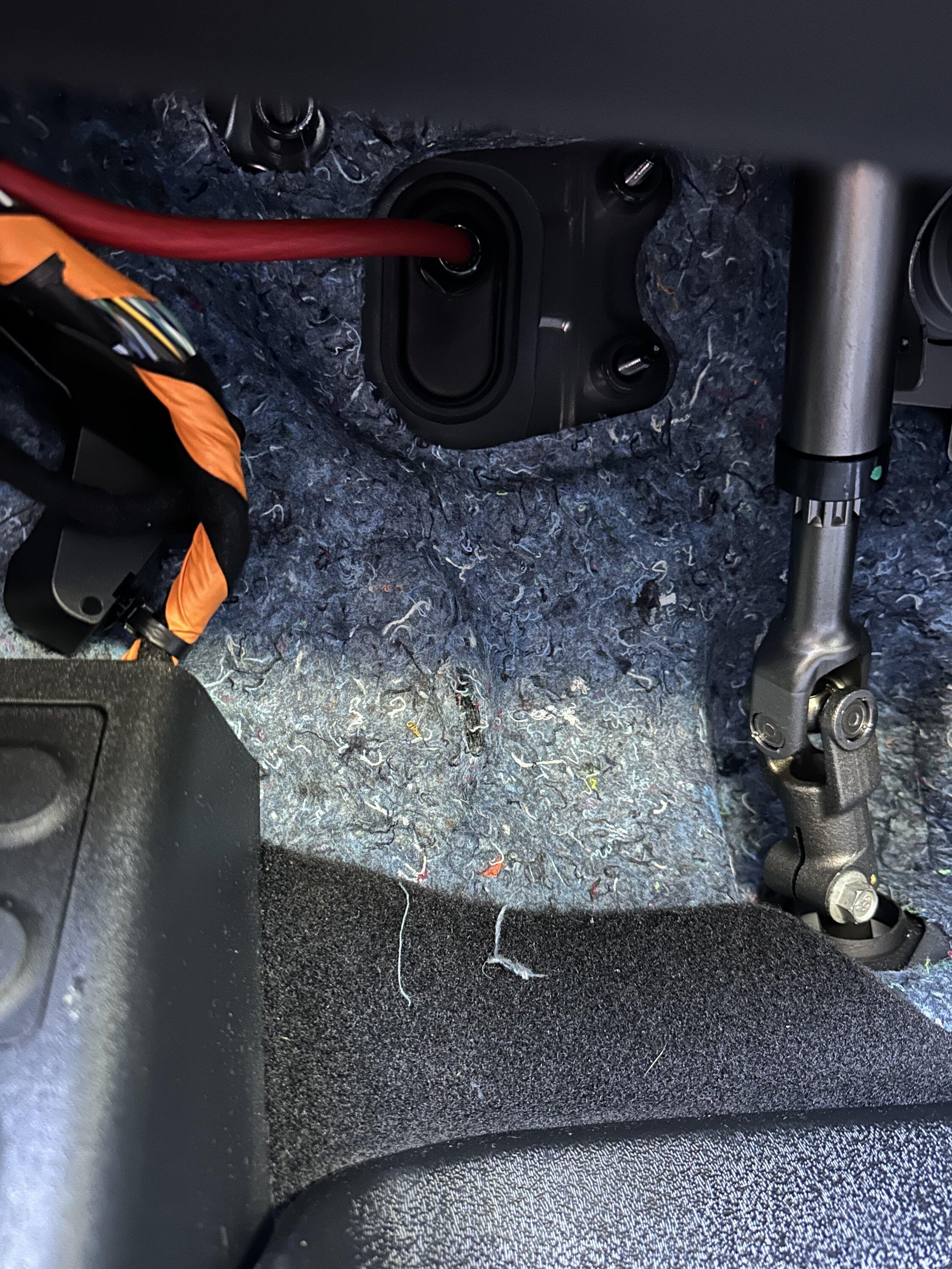

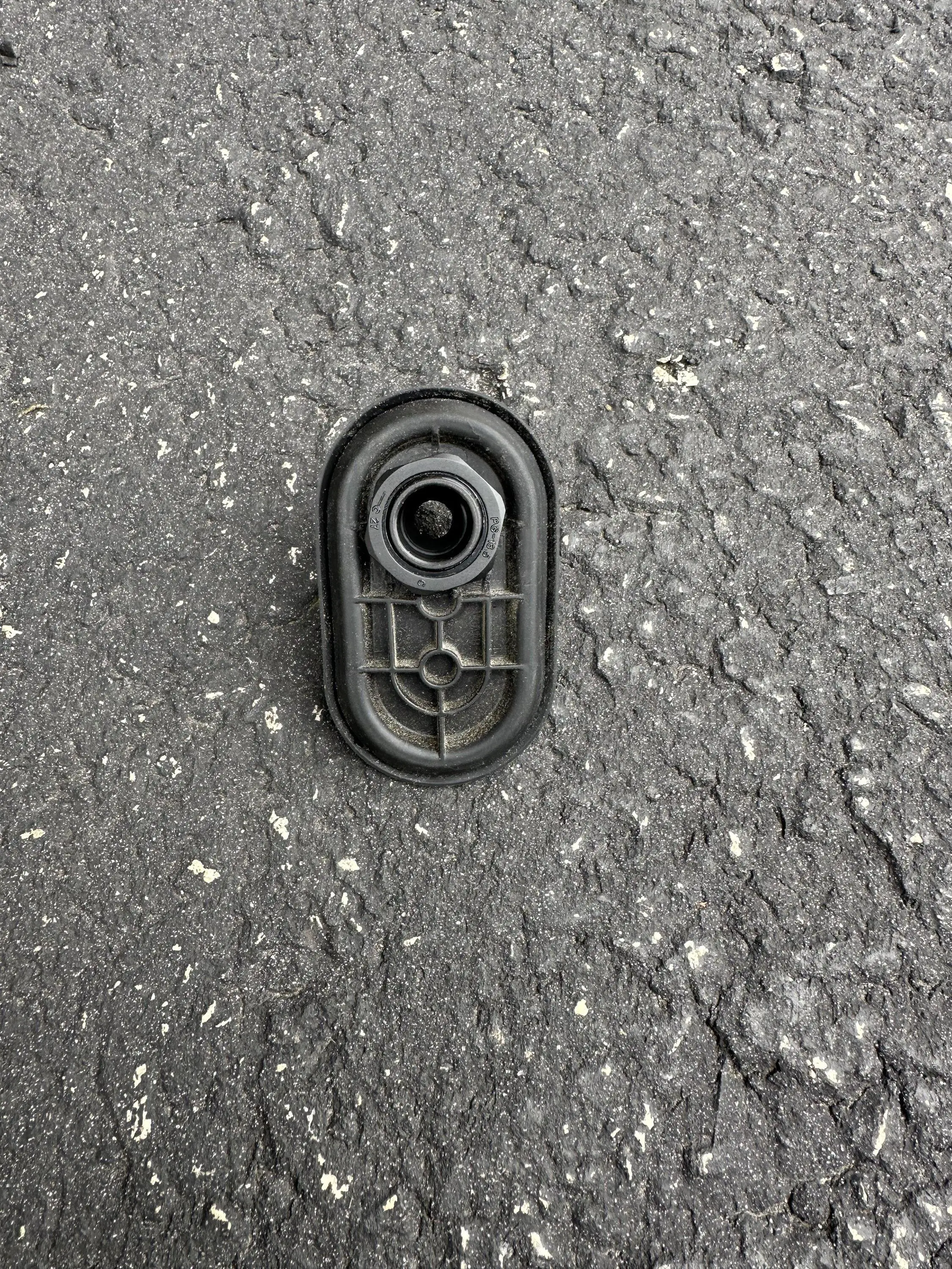

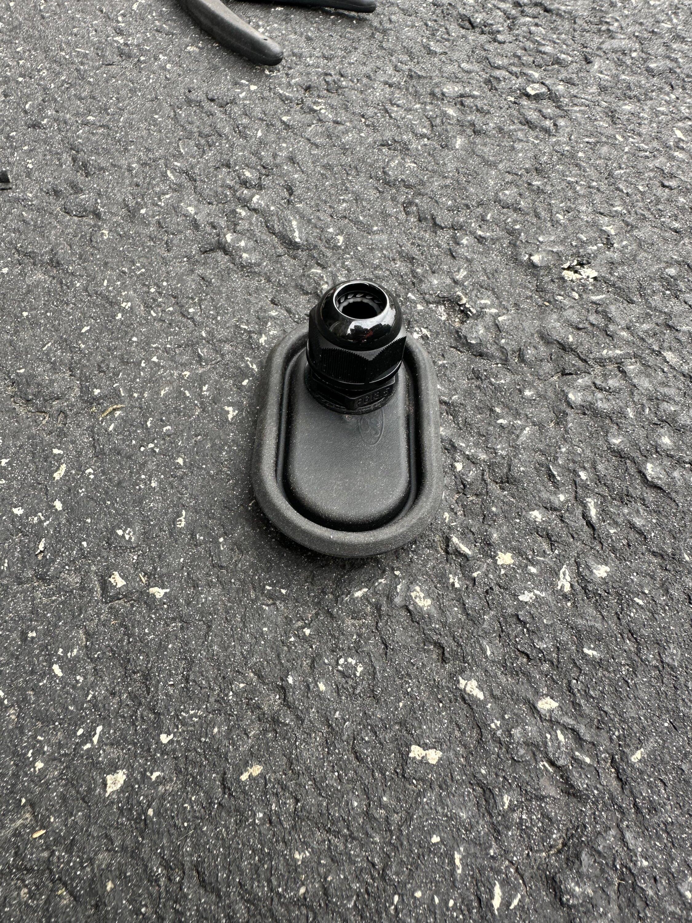

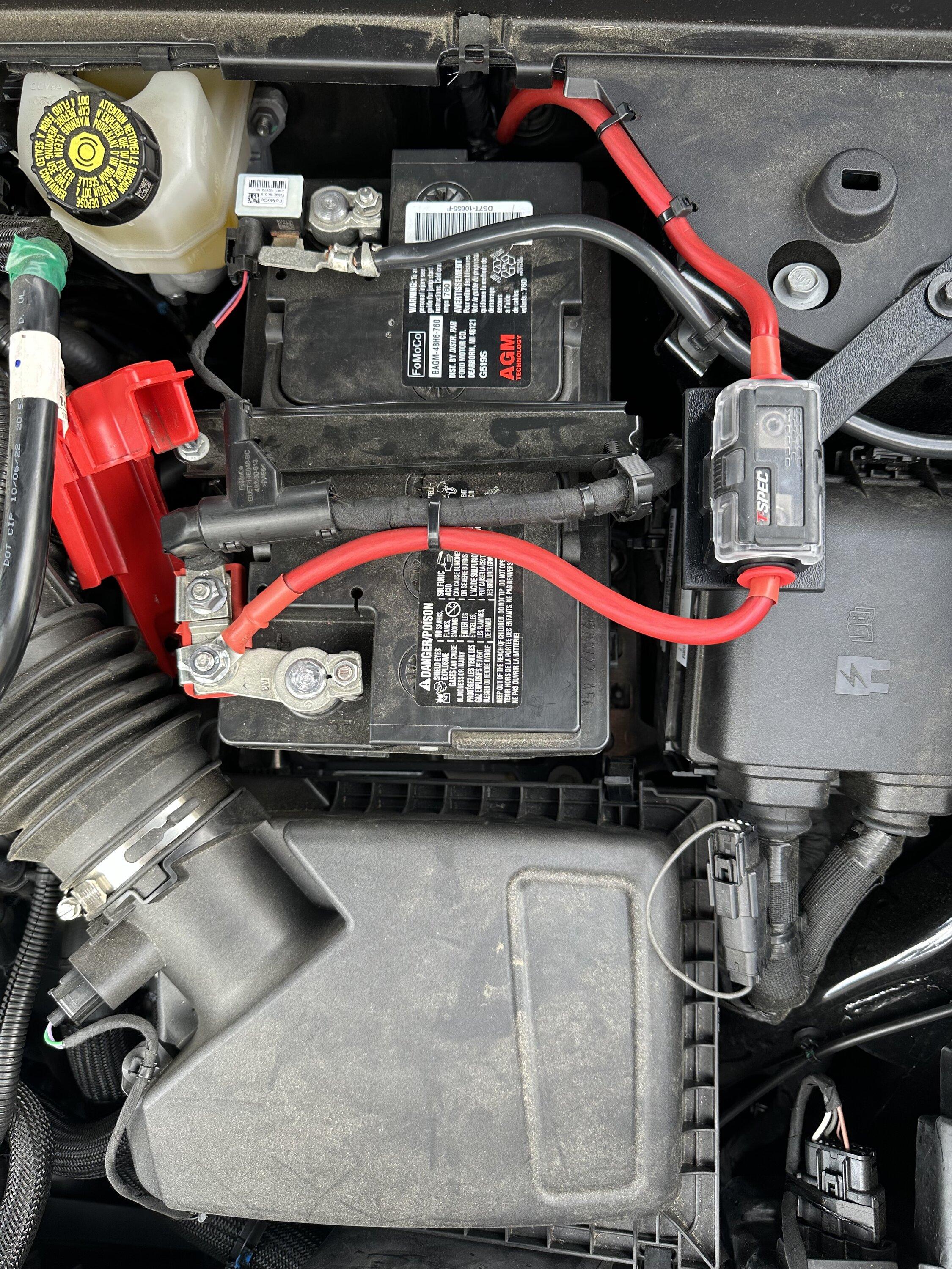

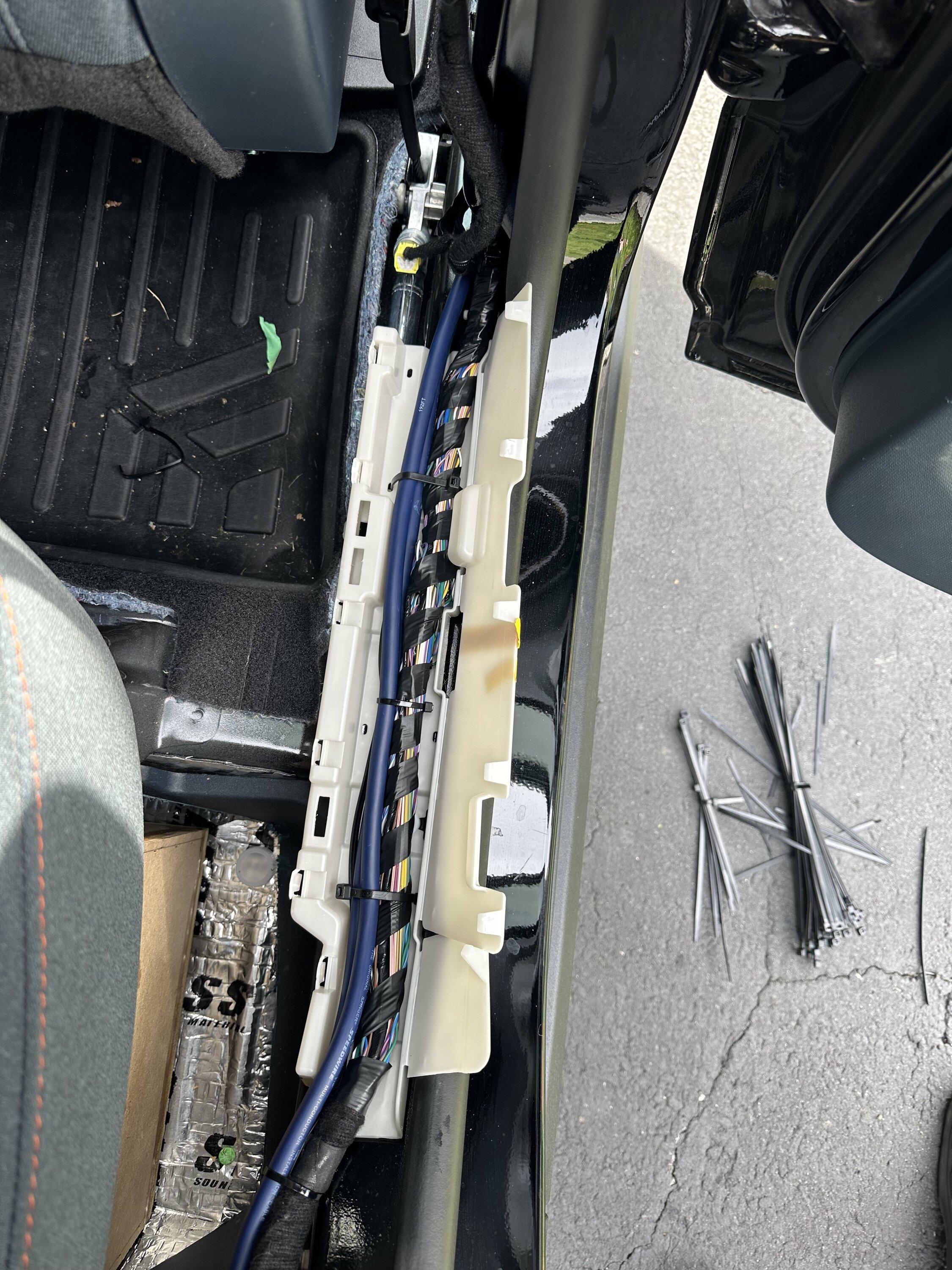

For the power wore someone had mentioned using a firewall bushing to keep down on the noise from the engine insurers of just putting a hole there.
Ford Maverick Mikey’s XLT IMG_6879
Ford Maverick Mikey’s XLT IMG_6878
Ford Maverick Mikey’s XLT IMG_6890
Misc pics of the wiring ran

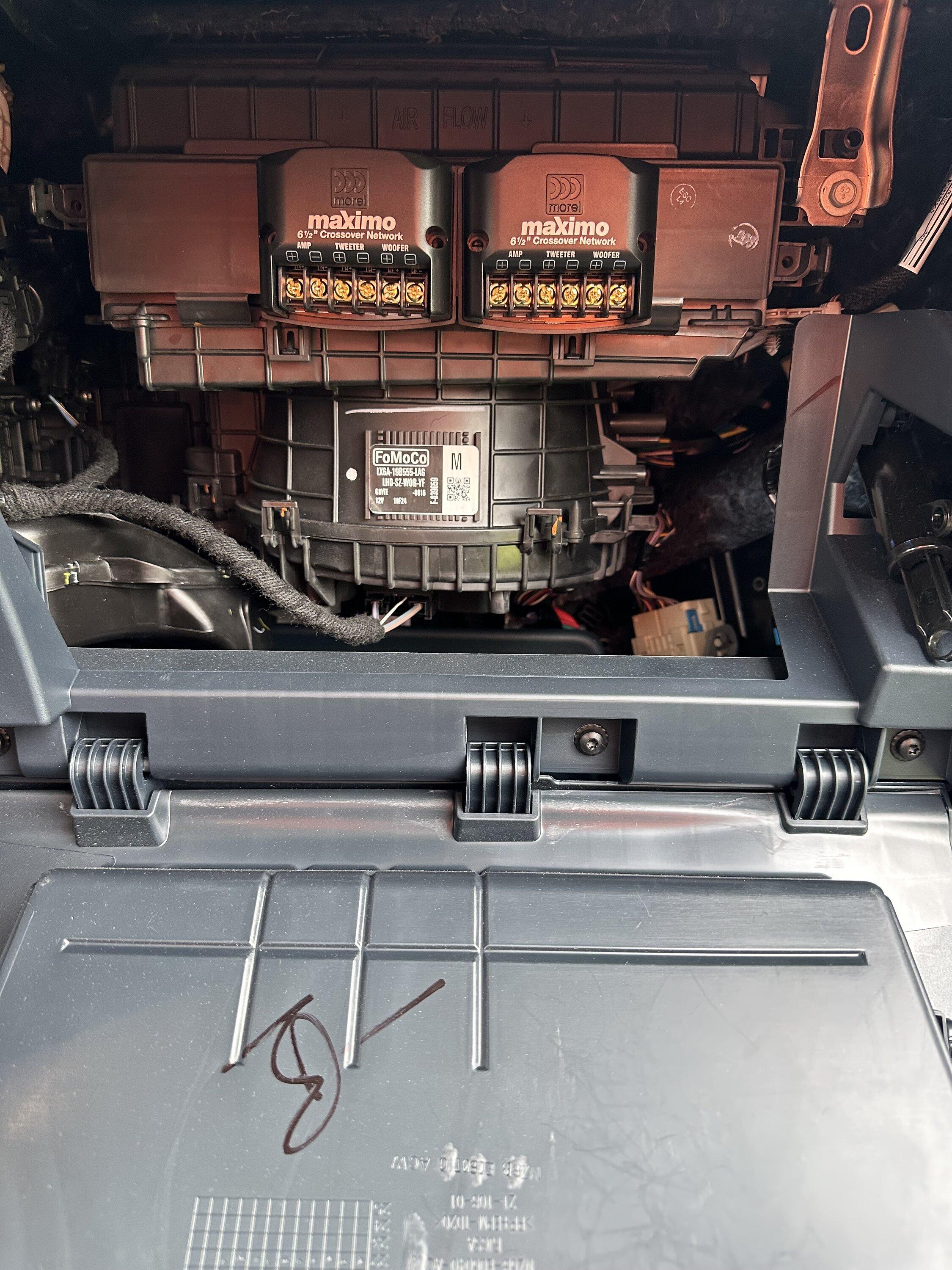

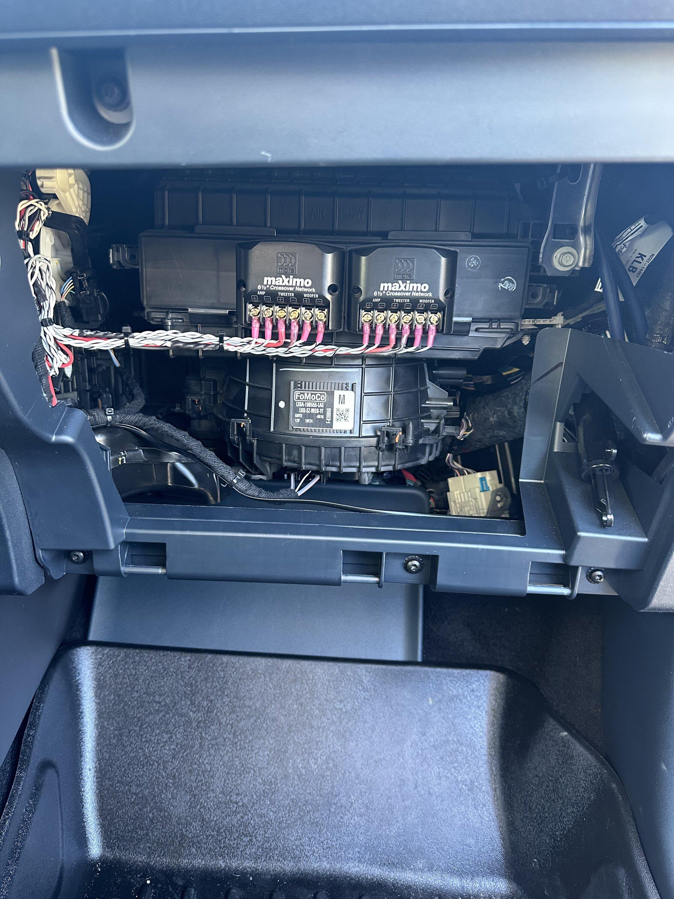

Crossovers mounted behind the glove box
Ford Maverick Mikey’s XLT IMG_6880

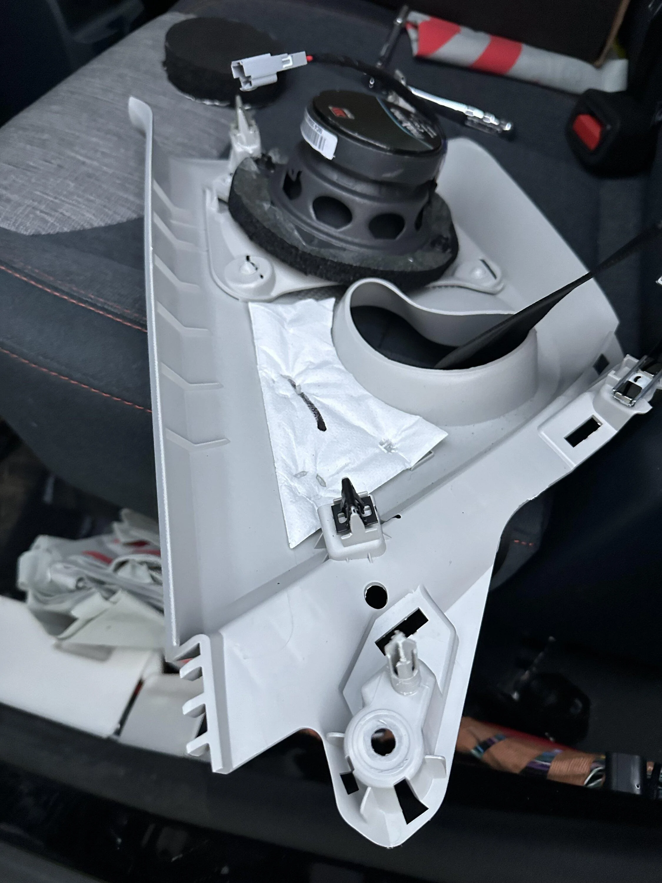

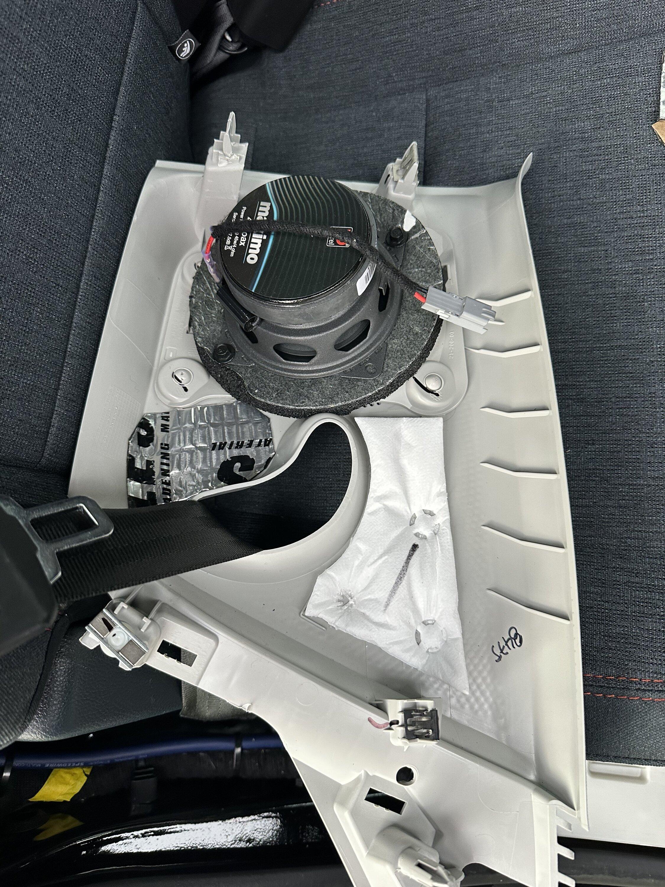

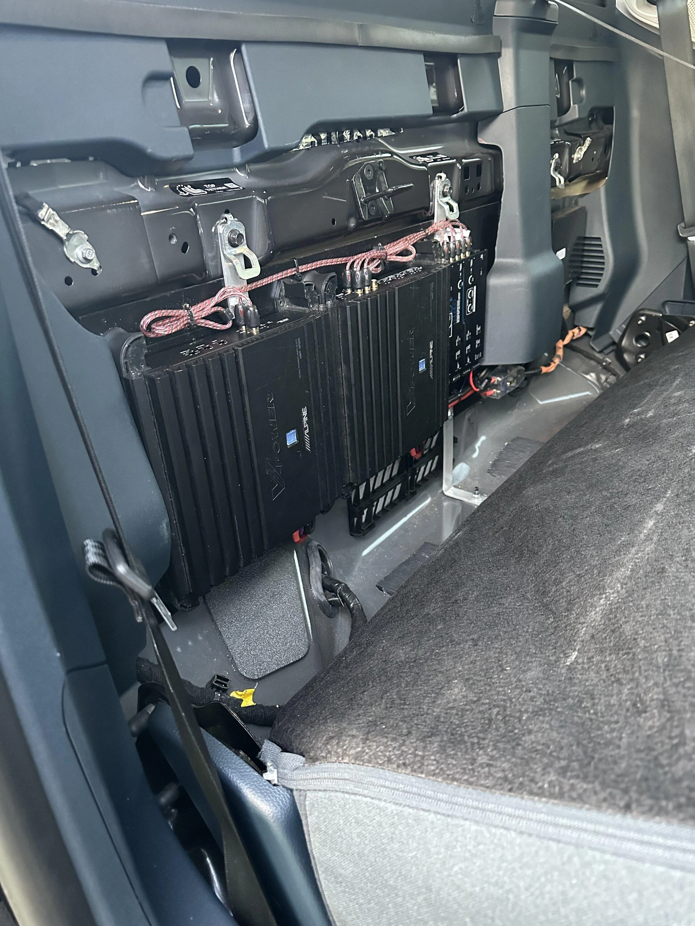

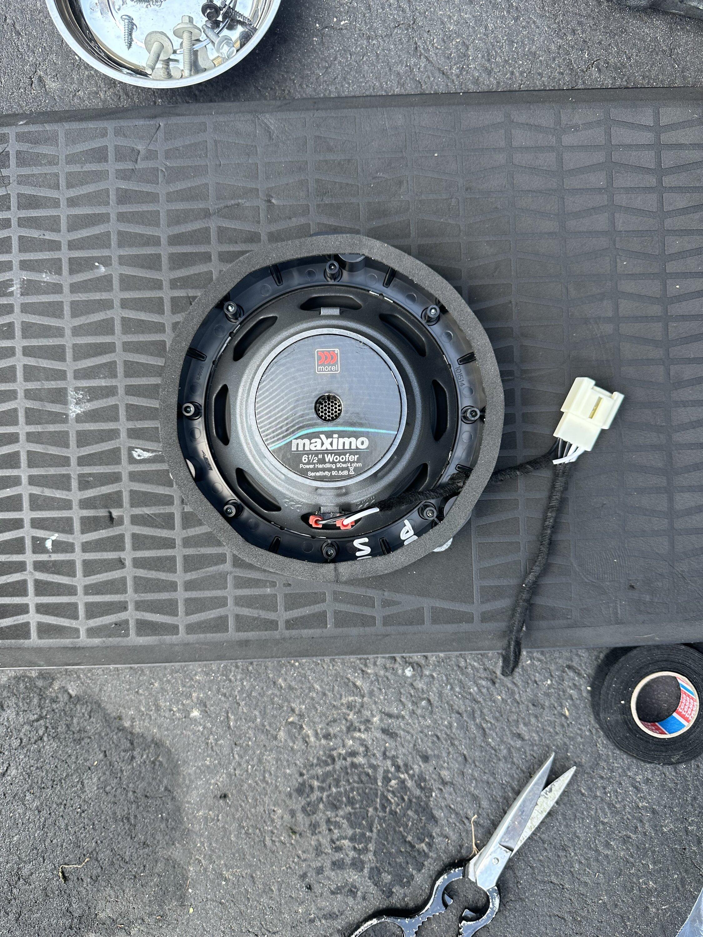

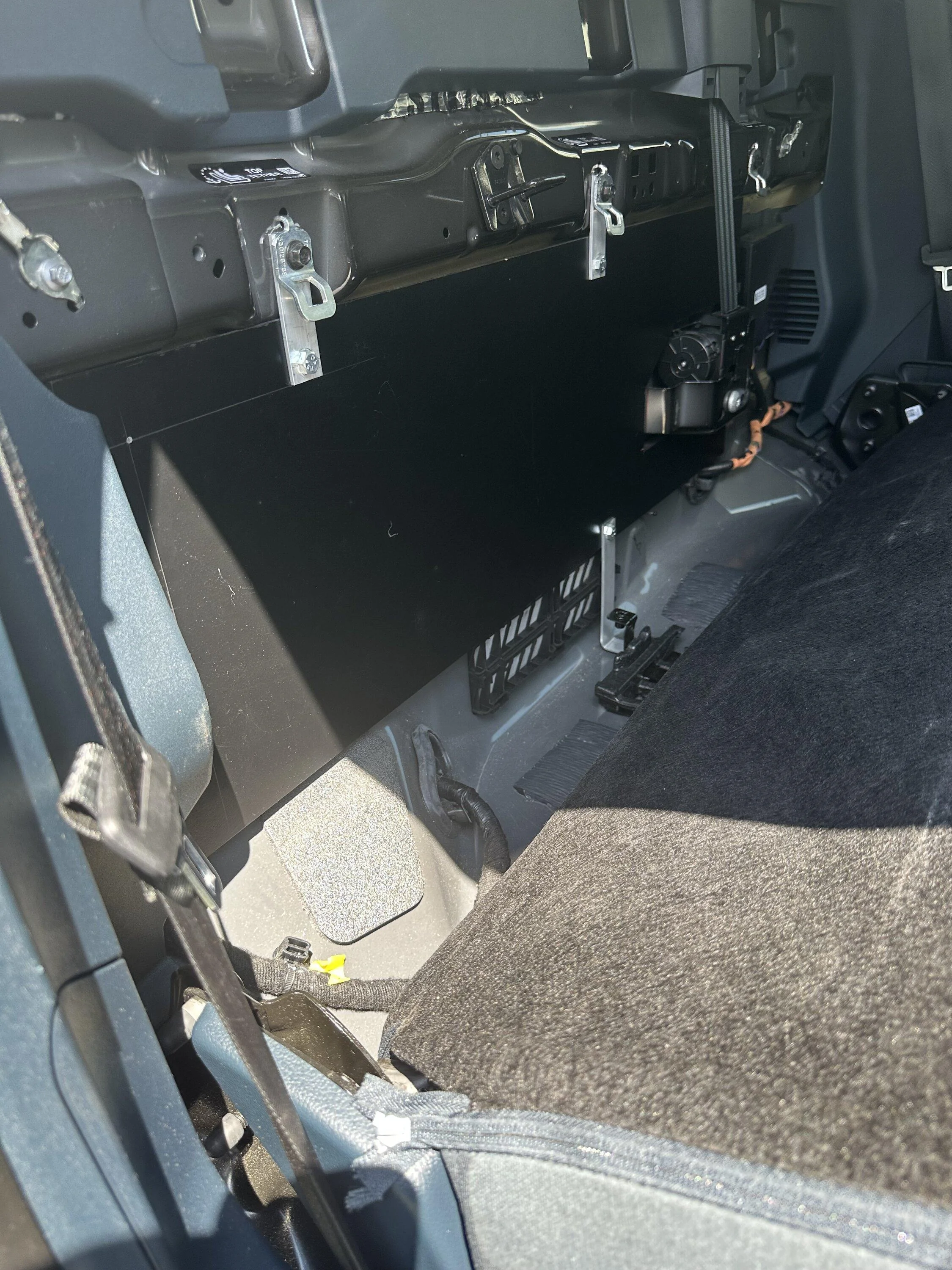

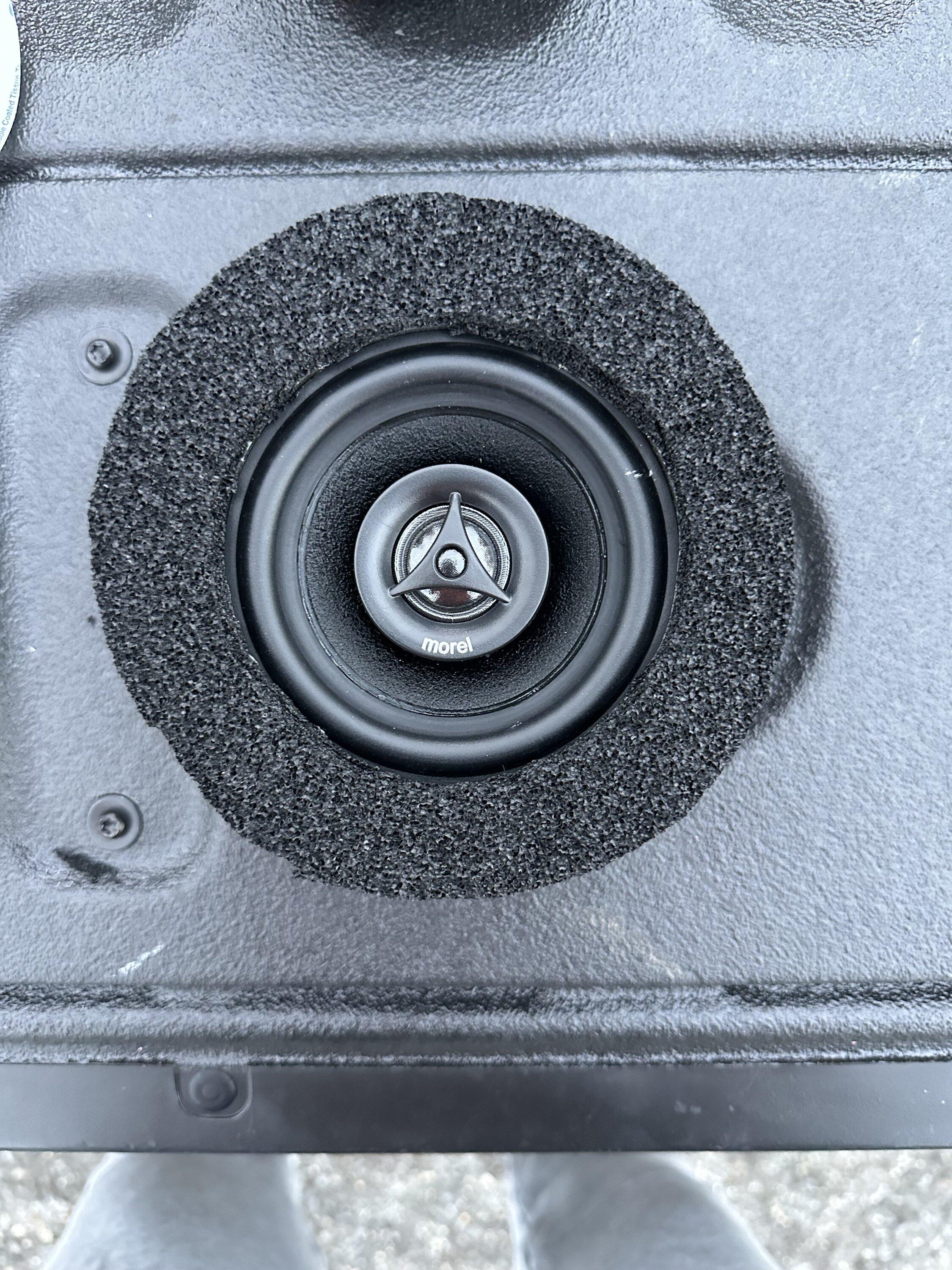

Also got the rear speakers mounted. They were tight! Also cut some extra foam I had left over from my front door speakers.
Ford Maverick Mikey’s XLT IMG_6926
Ford Maverick Mikey’s XLT IMG_6928
Ford Maverick Mikey’s XLT IMG_6931
Ford Maverick Mikey’s XLT IMG_6936
Ford Maverick Mikey’s XLT IMG_6938

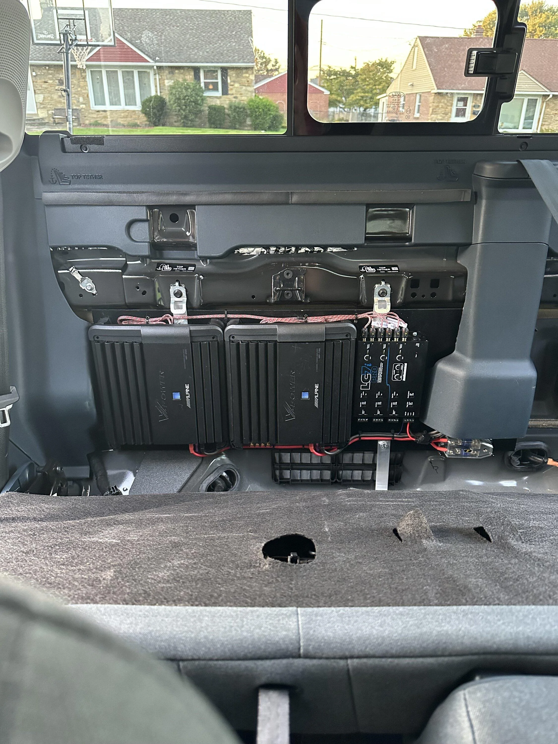

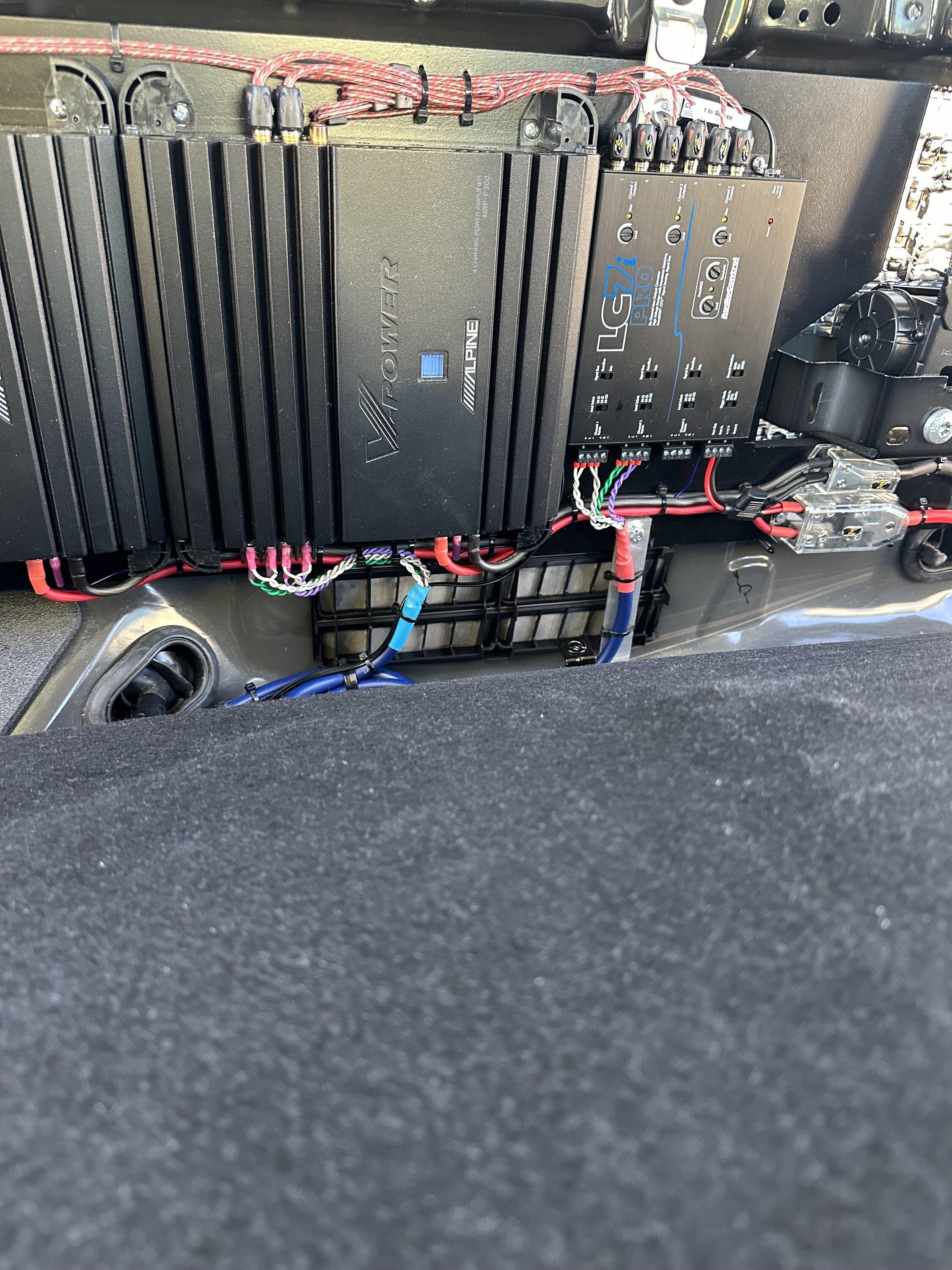

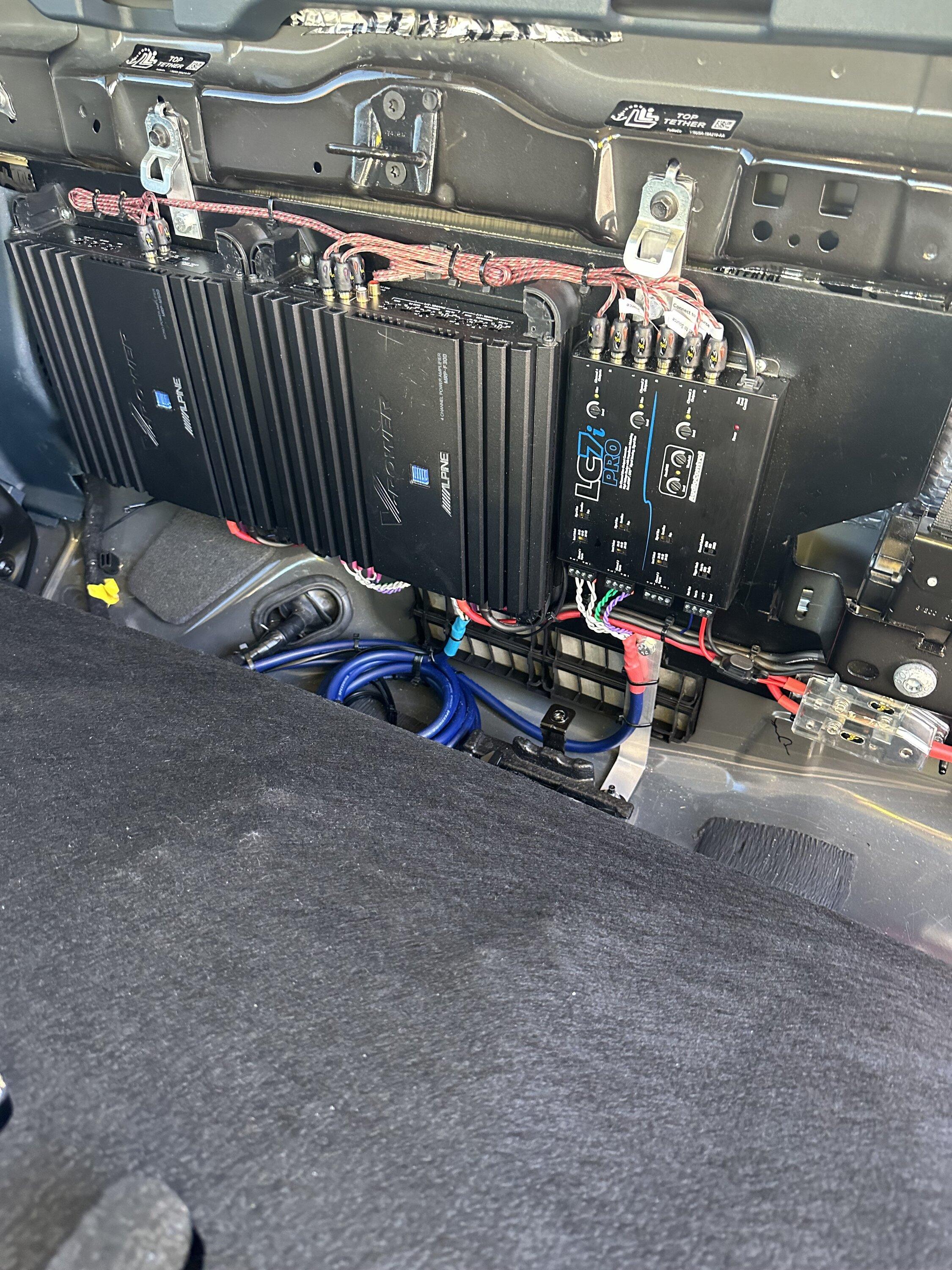

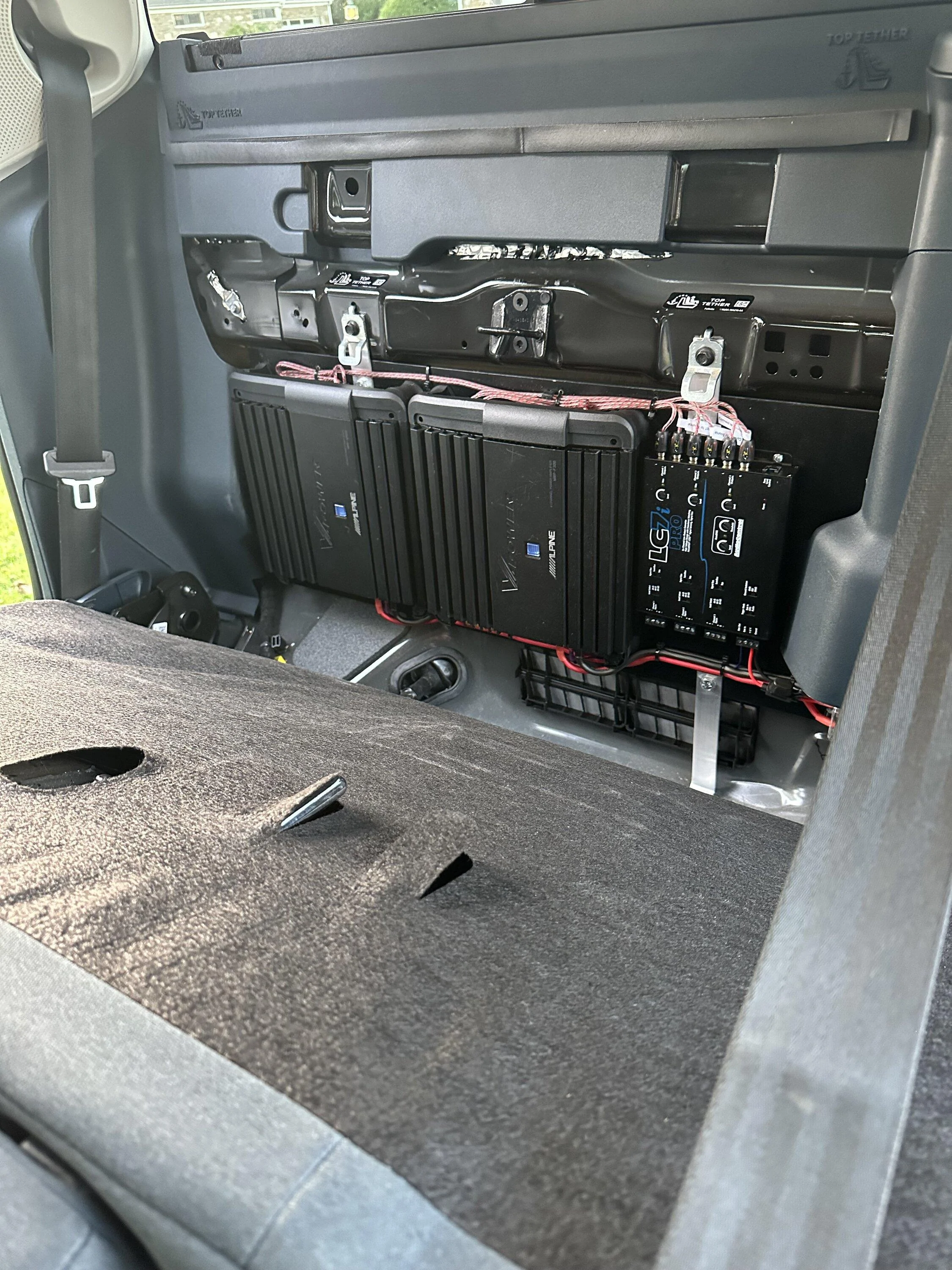

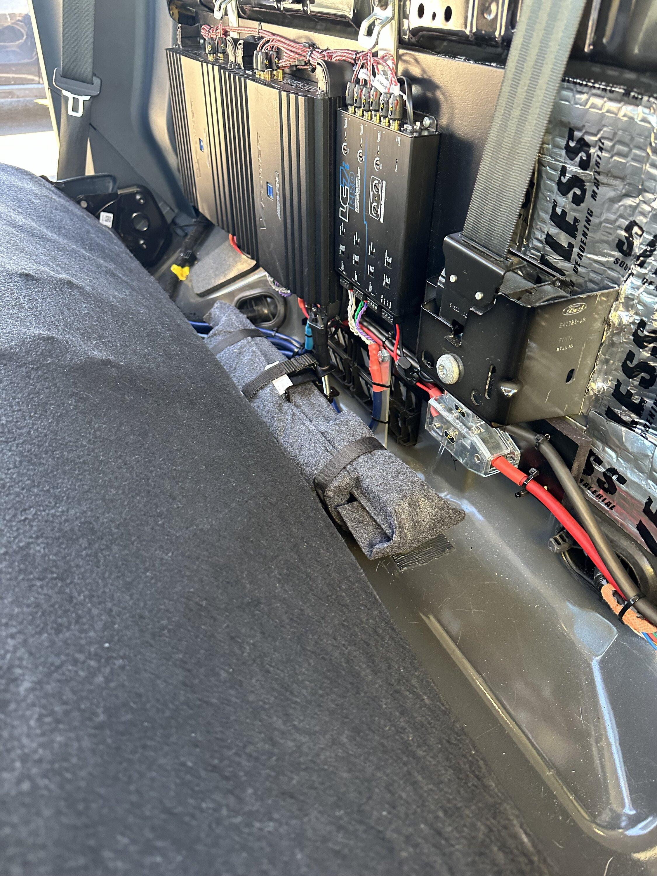

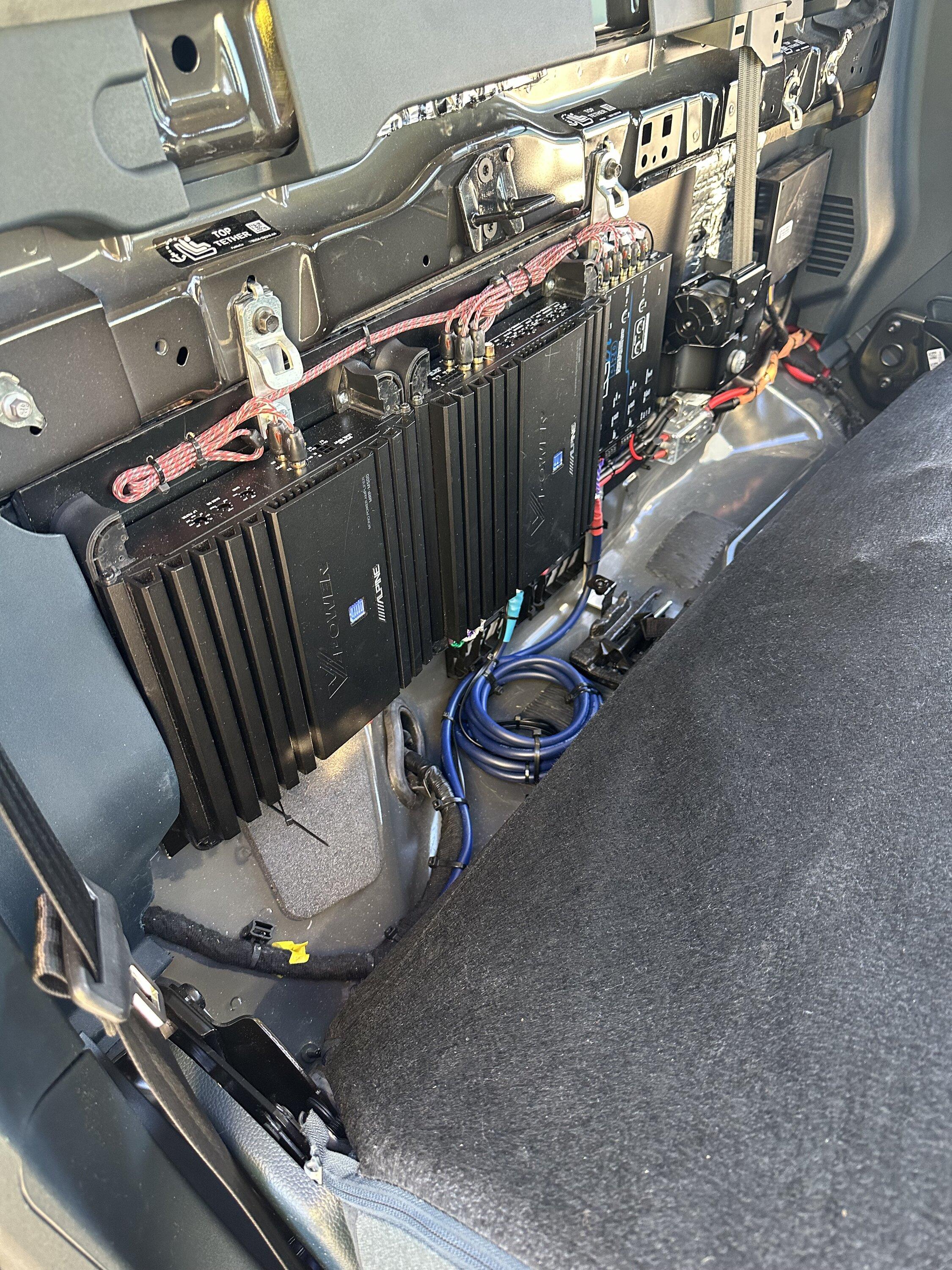

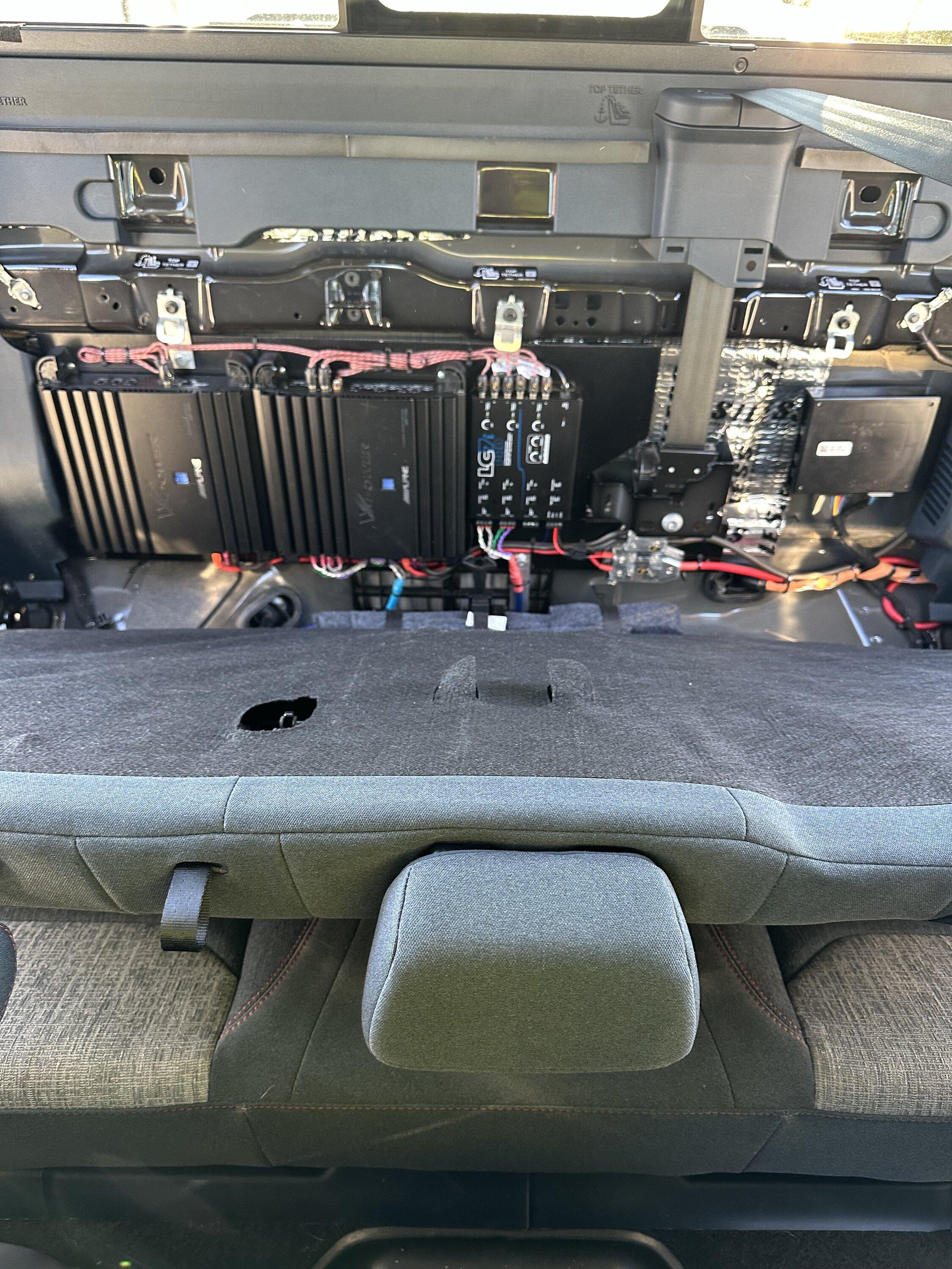

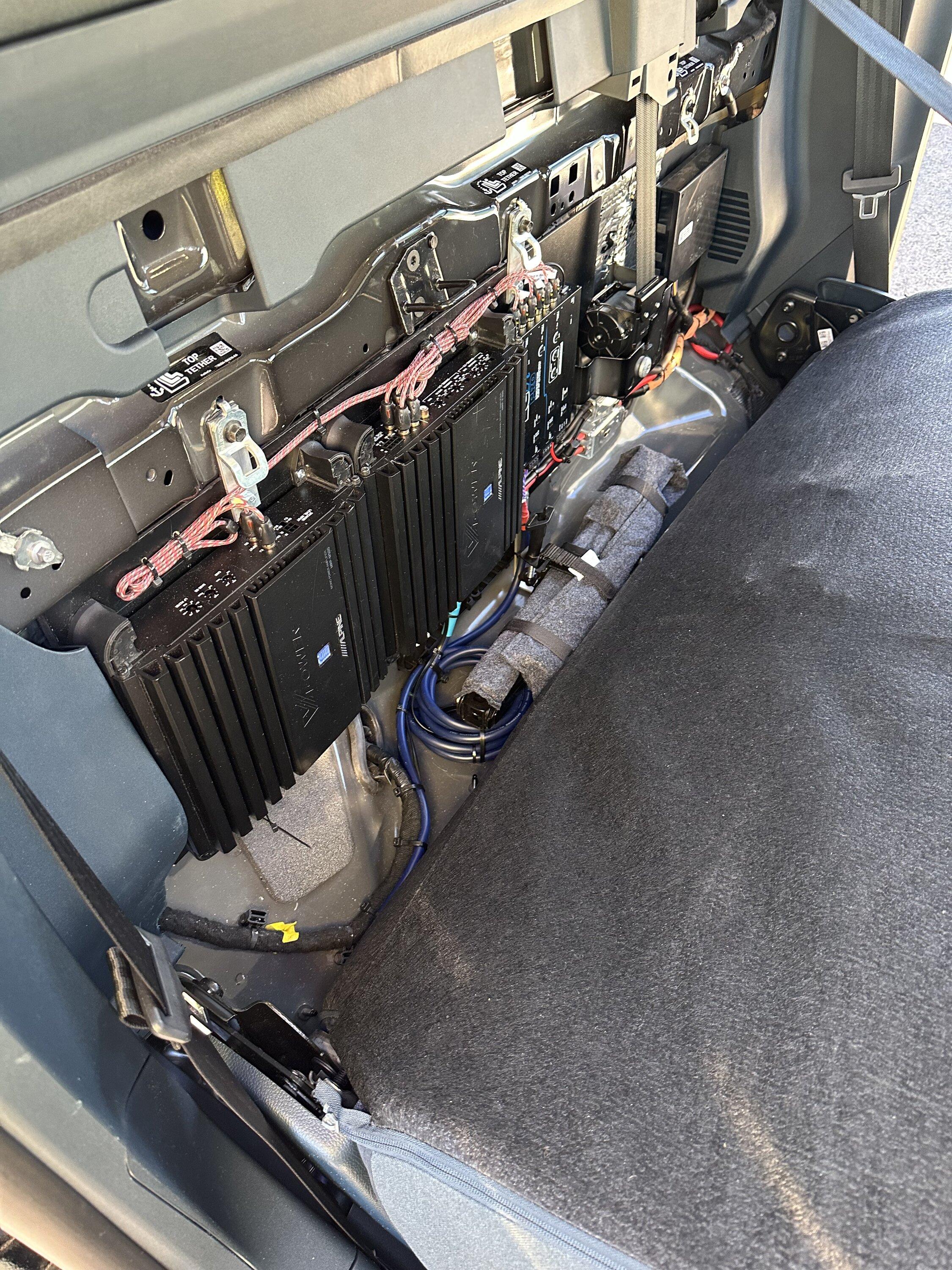

Also got the app rack all wired up
Ford Maverick Mikey’s XLT IMG_6992
Ford Maverick Mikey’s XLT IMG_6993
Ford Maverick Mikey’s XLT IMG_6994
Ford Maverick Mikey’s XLT IMG_6995
Ford Maverick Mikey’s XLT IMG_6997
Ford Maverick Mikey’s XLT IMG_6998
All that’s left is mounting the tweeters, running the wire for them to the crossovers and mounting to inline fuse by the battery but I’m trying to figure out how I want to mount that. 👍🏻

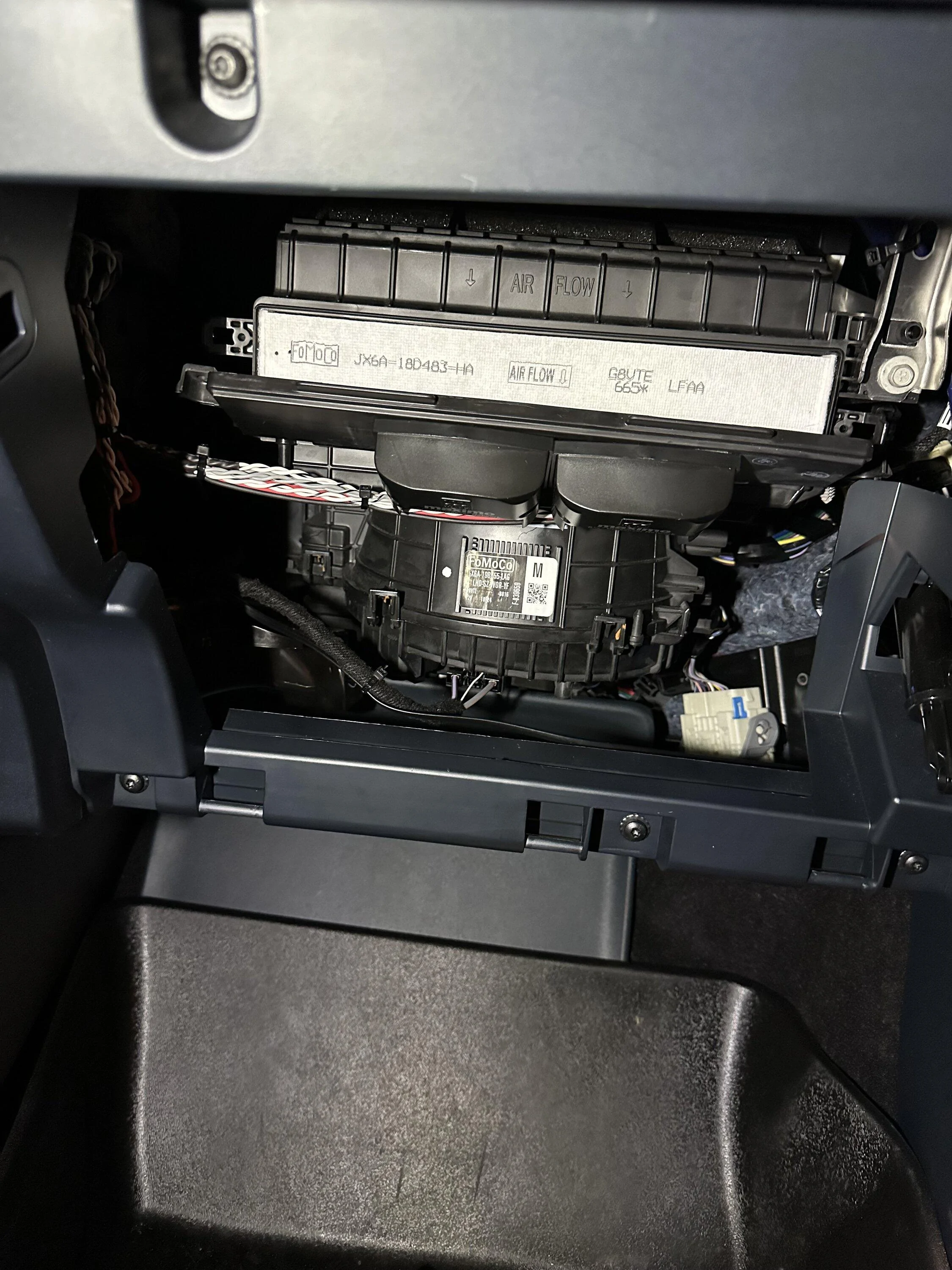

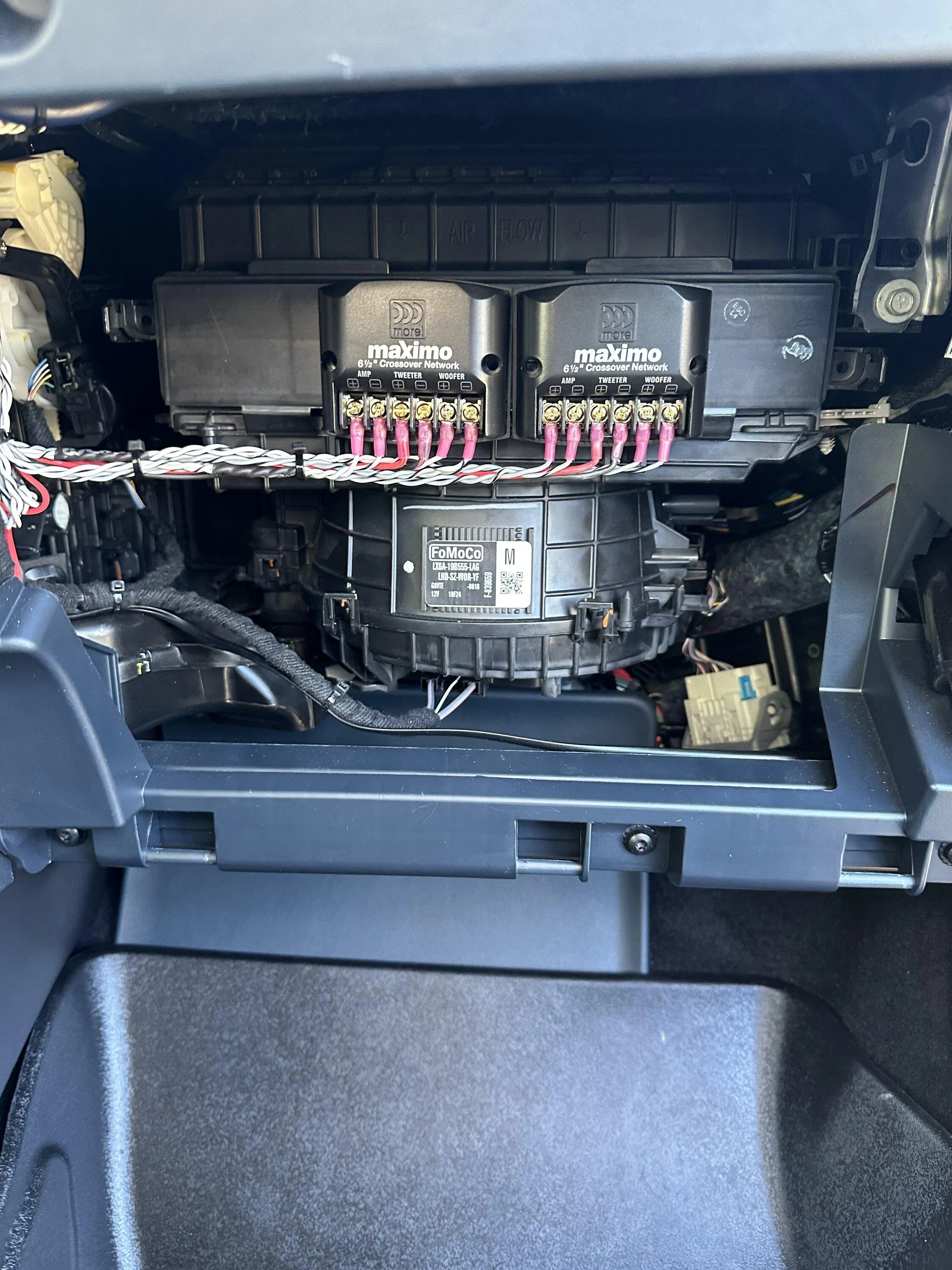

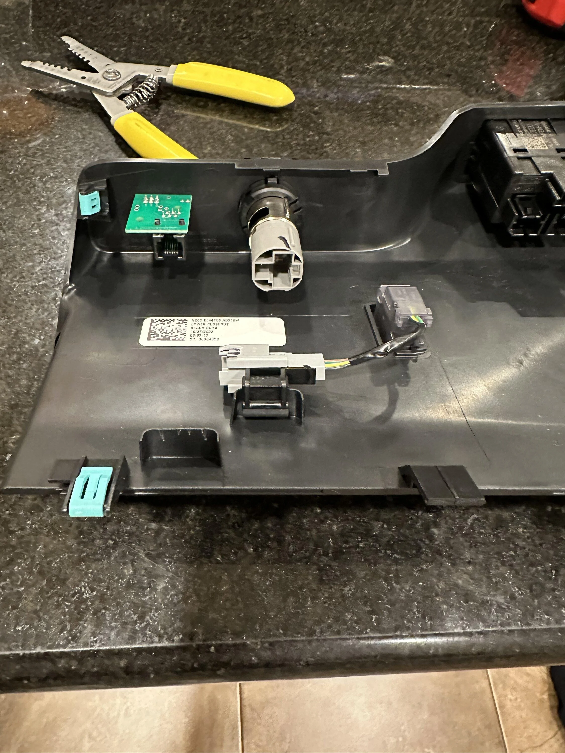

Got the crossovers wired up
Ford Maverick Mikey’s XLT IMG_7078
Ford Maverick Mikey’s XLT IMG_7076
Still can access the cabin air filter 👍🏻
Ford Maverick Mikey’s XLT IMG_7053

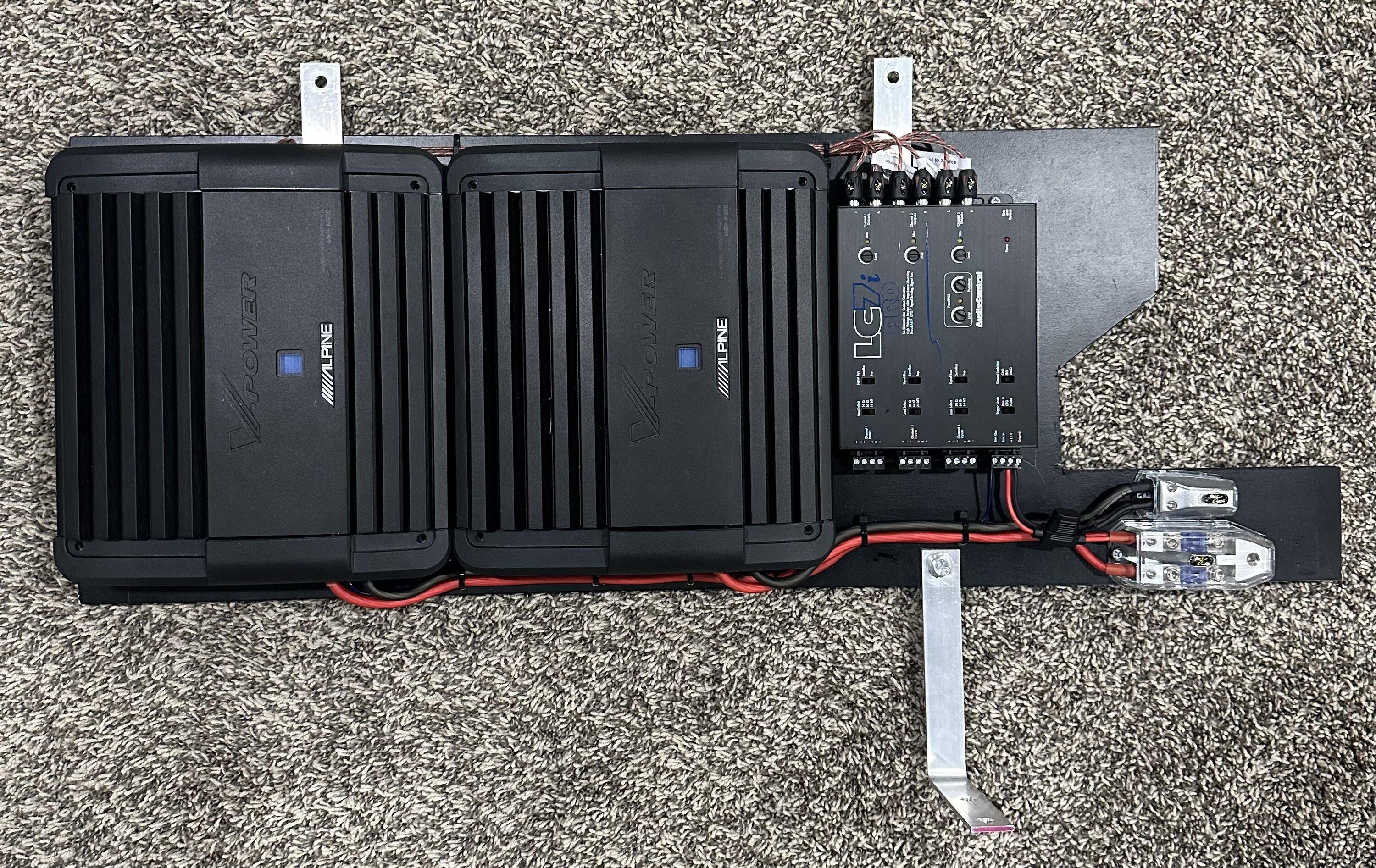

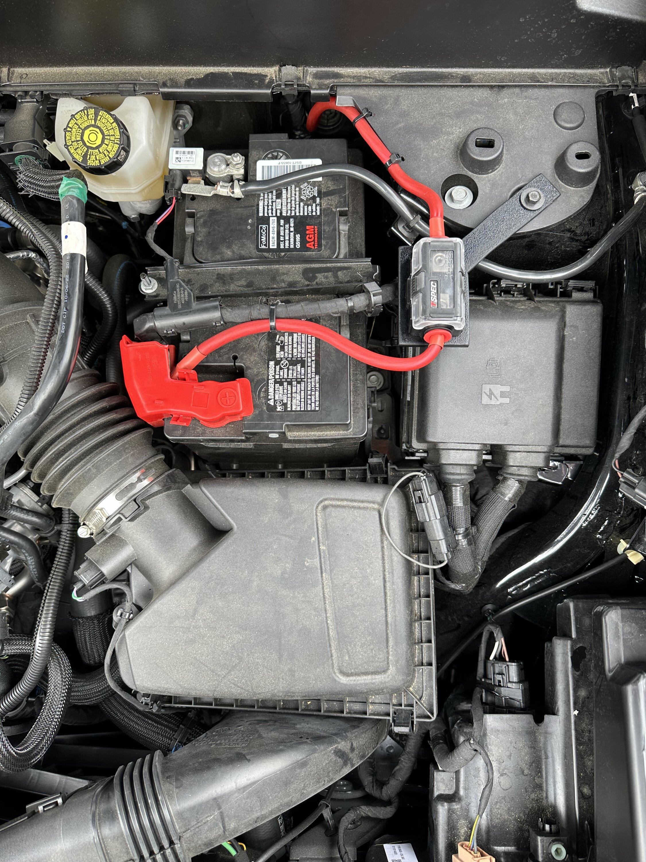

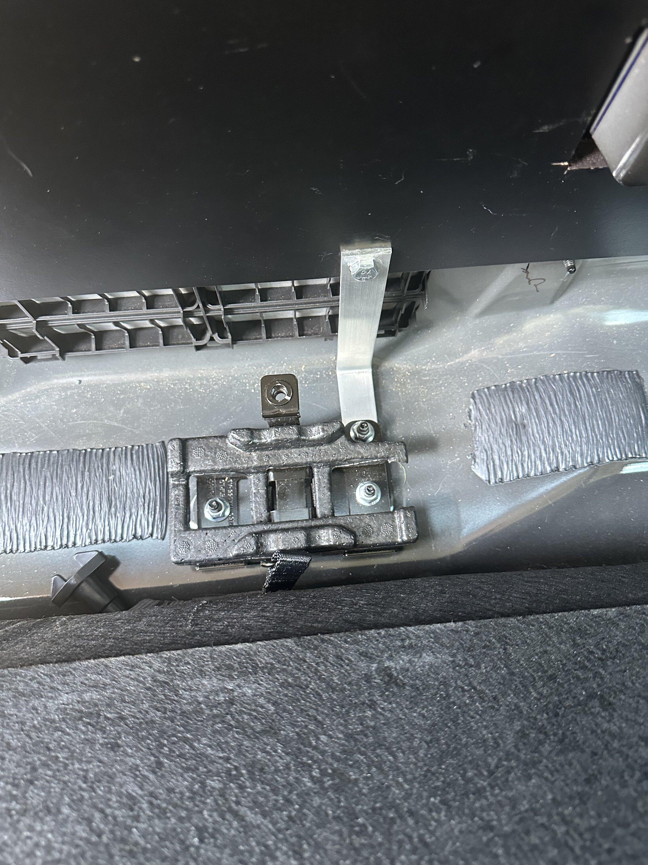

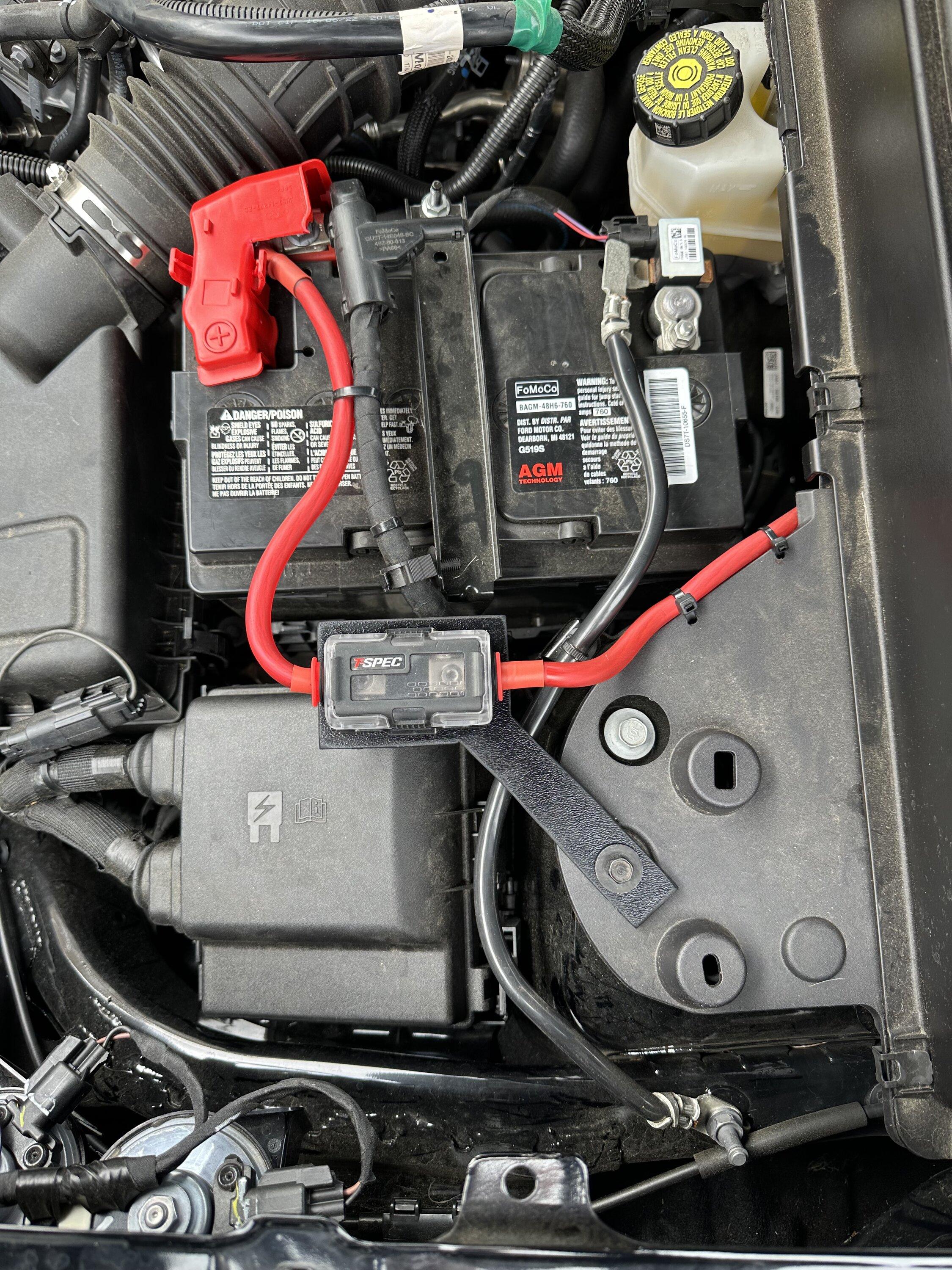

Made a bracket for the amp inline fuse. Just have to get some wire loom.
Ford Maverick Mikey’s XLT IMG_7151
Ford Maverick Mikey’s XLT IMG_7157
Ford Maverick Mikey’s XLT IMG_7154
Ford Maverick Mikey’s XLT IMG_7155
Now all I have to do is figure out how to get the tweeters installed in the factory location and then I can finally listen to this system

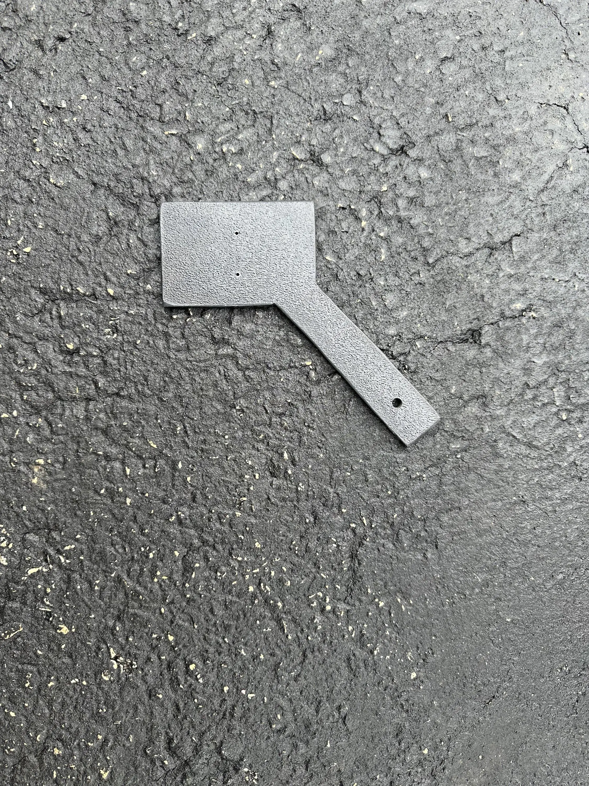

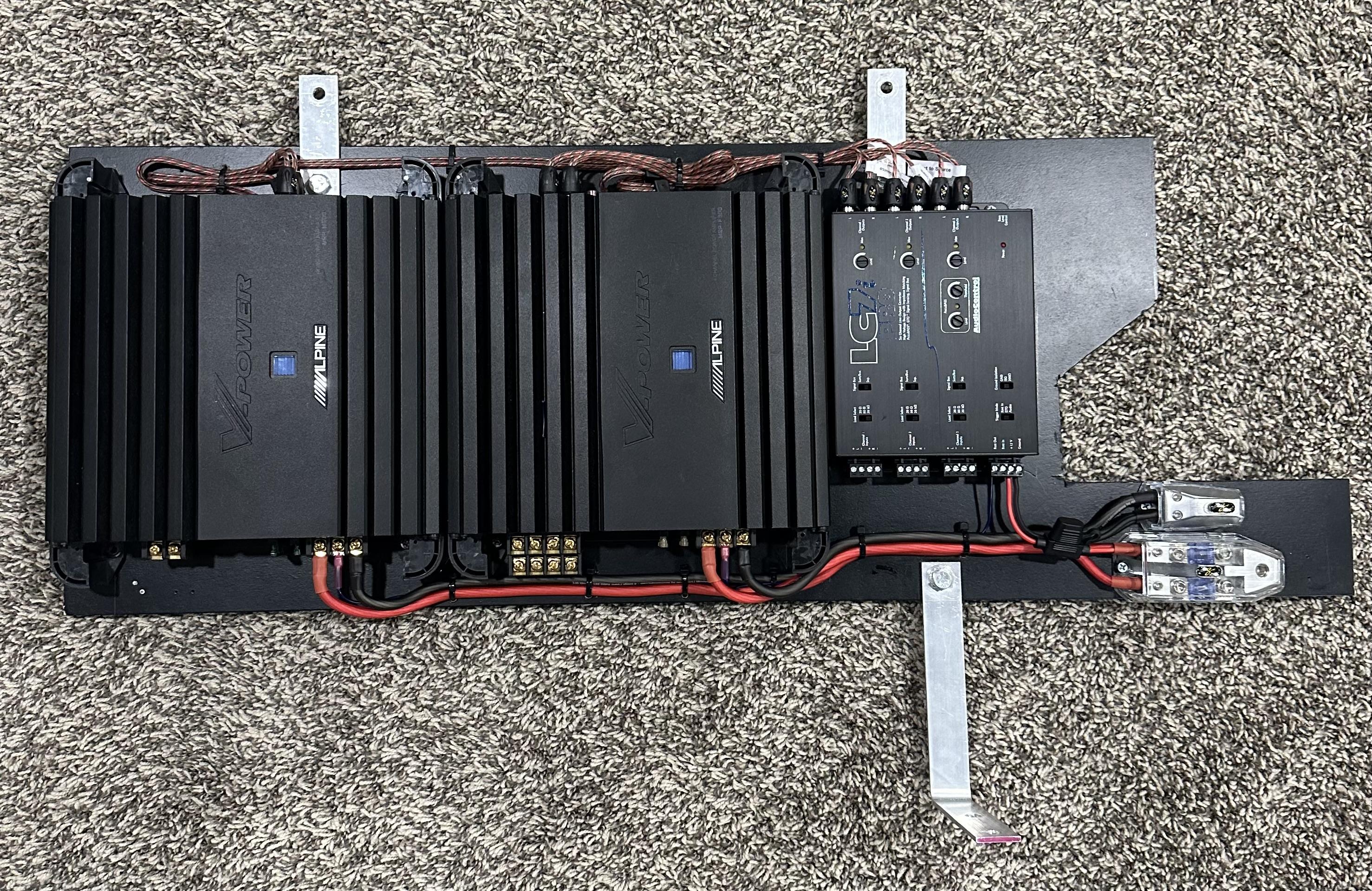

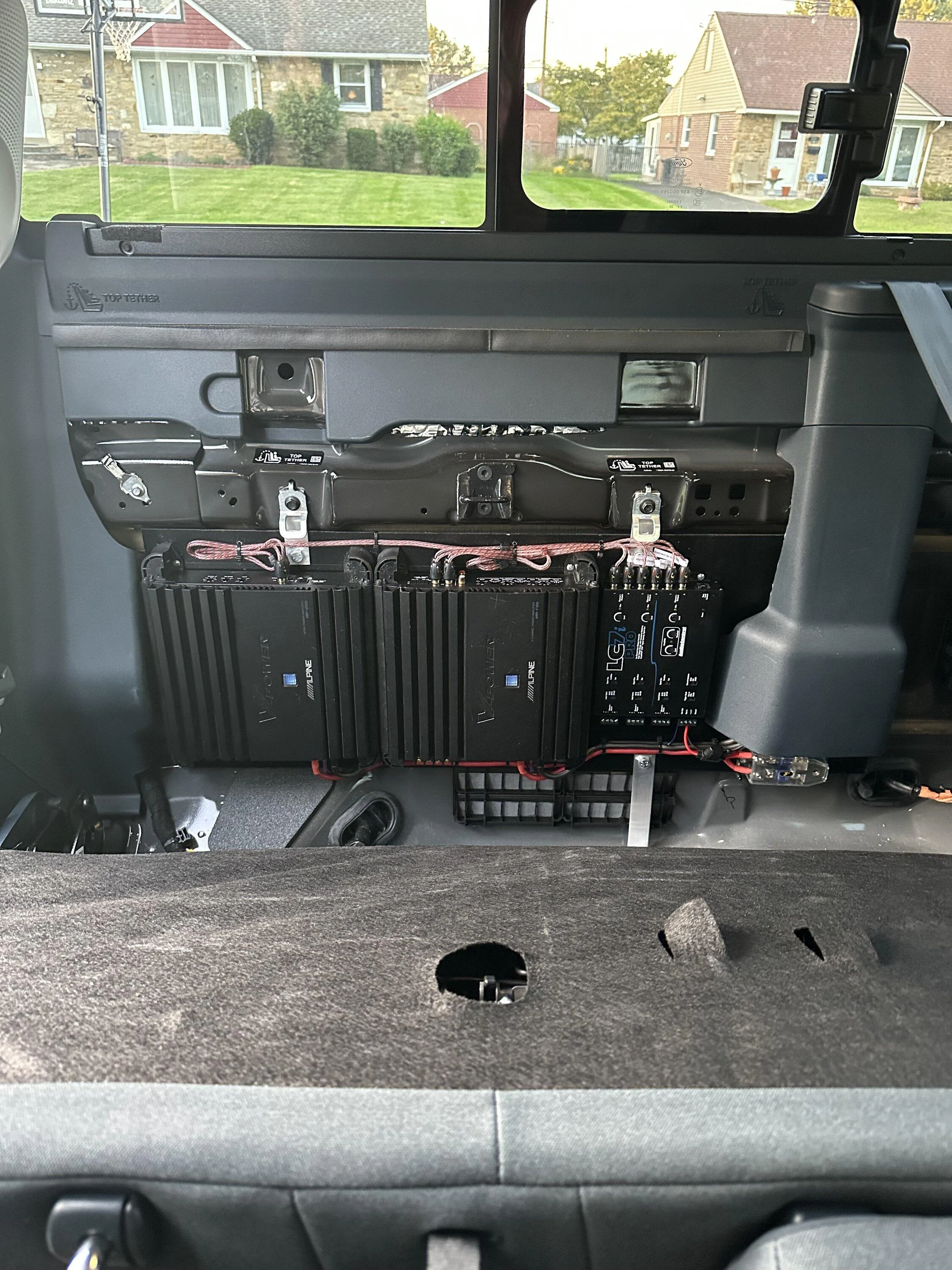

Slow process is better then no process I guess lol. Finally got around to getting the amp rack done. Might add one more brace to the left side and still have to sound deaden behind it but just wanted to mount it to see what it looked like. Next up is running the power, loopback harness and install speakers. Here’s some pics of the amp rack.
This is a genius idea! Is that aluminum off the shelf or did you bend and cut it yourself?
MikeyG
Jan 23, 2022
338
190
phila

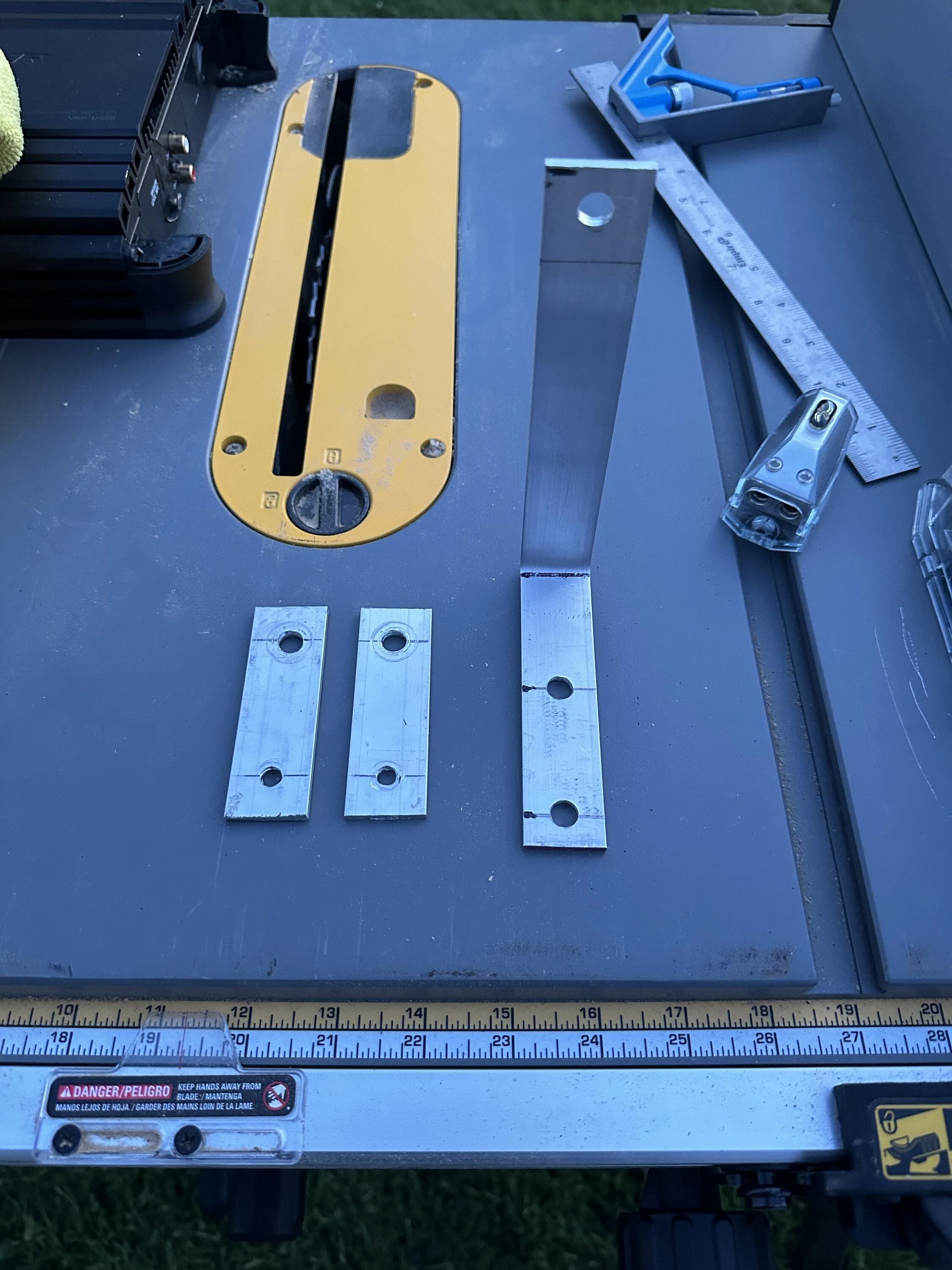

Thanks! It was a piece of straight aluminum I bought at Lowe’s that I bent and tapped holes in.

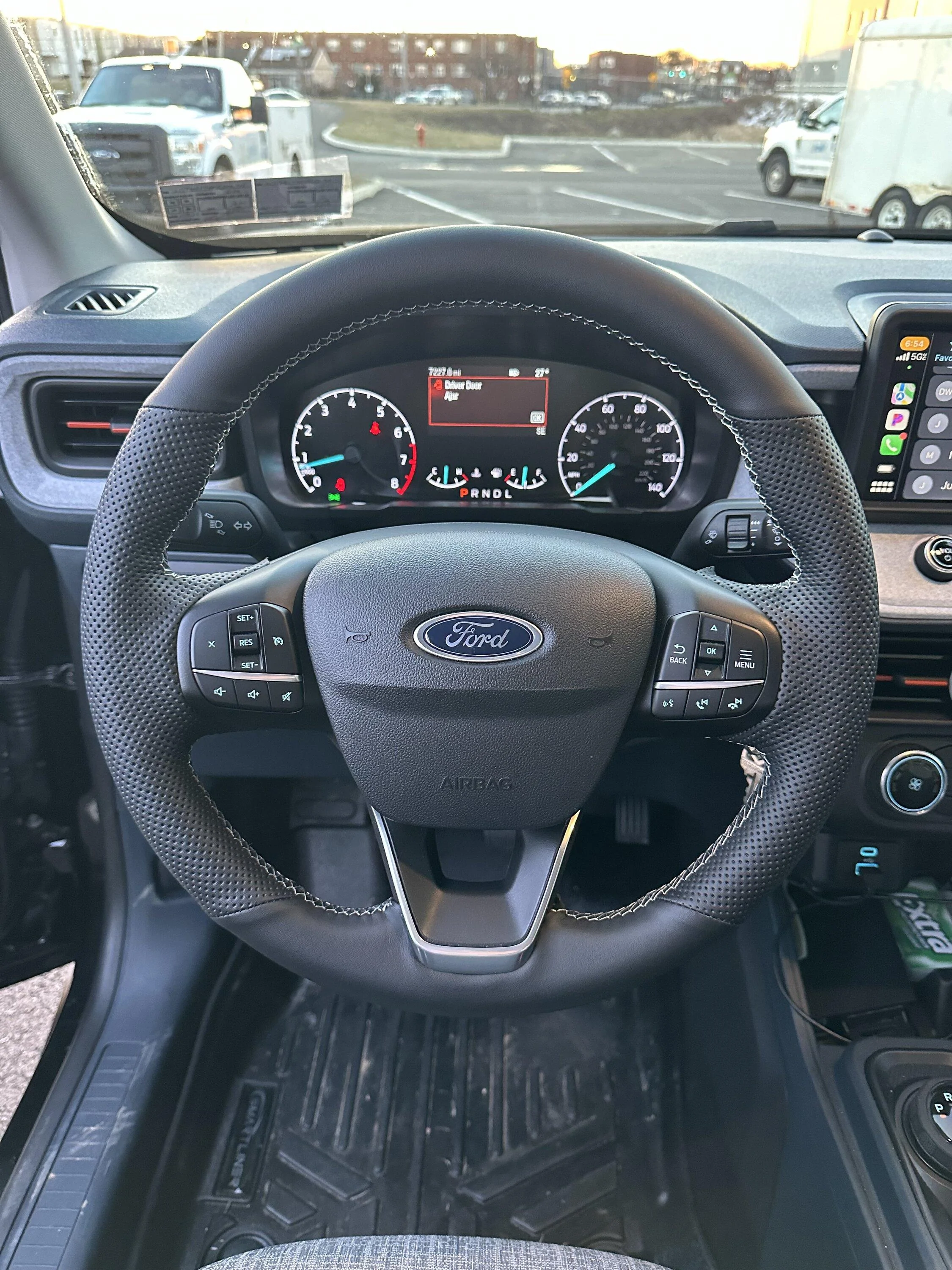

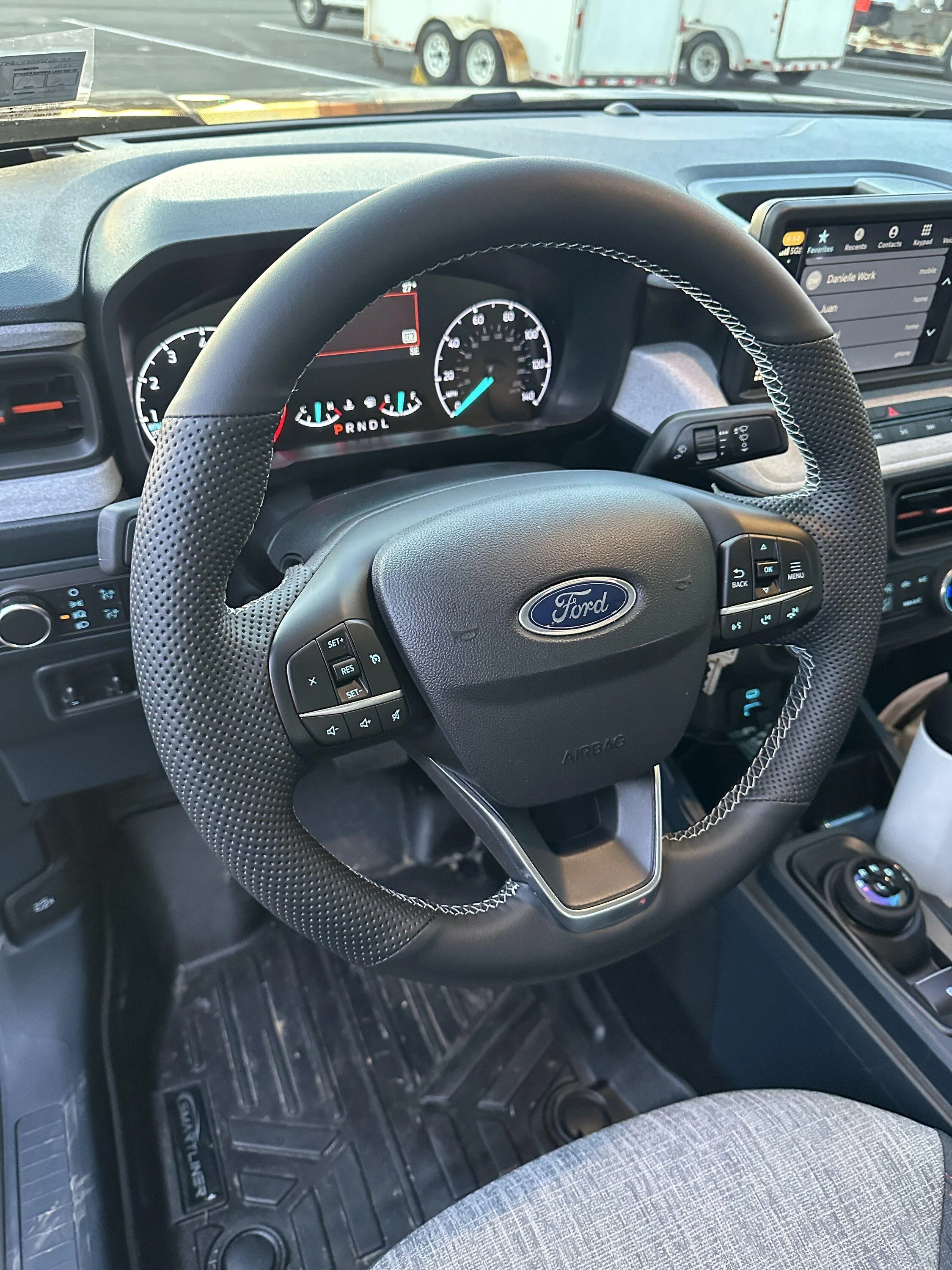

Bought a stitched steering wheel cover off aliexpress for $11.50 and installed it this past weekend. It was my first time doing one and it wasn’t too bad.
Before
Ford Maverick Mikey’s XLT IMG_7747
After
Ford Maverick Mikey’s XLT IMG_7765
Ford Maverick Mikey’s XLT IMG_7766
Ford Maverick Mikey’s XLT IMG_7756
