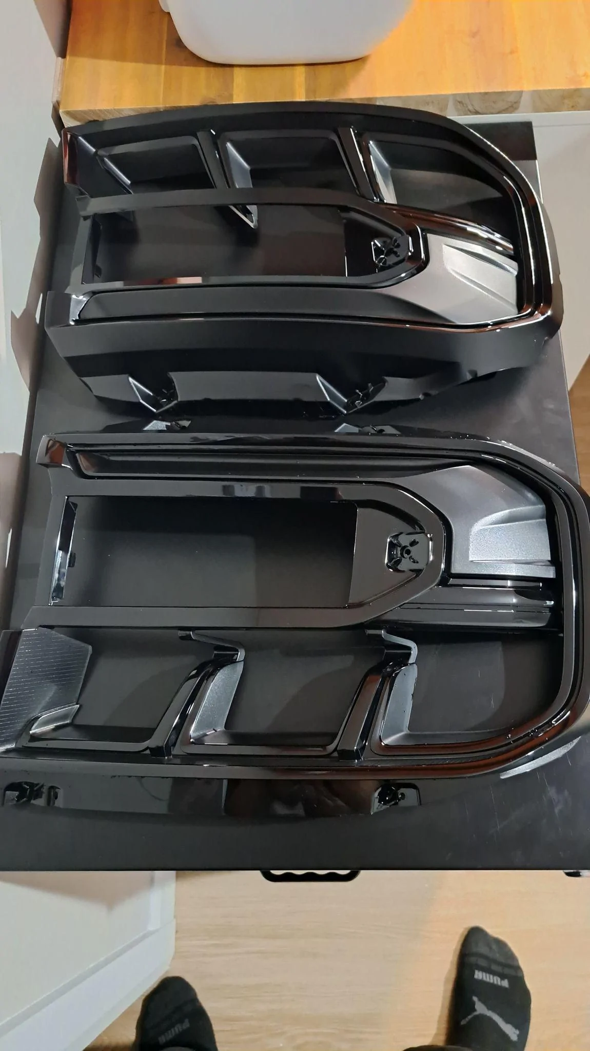

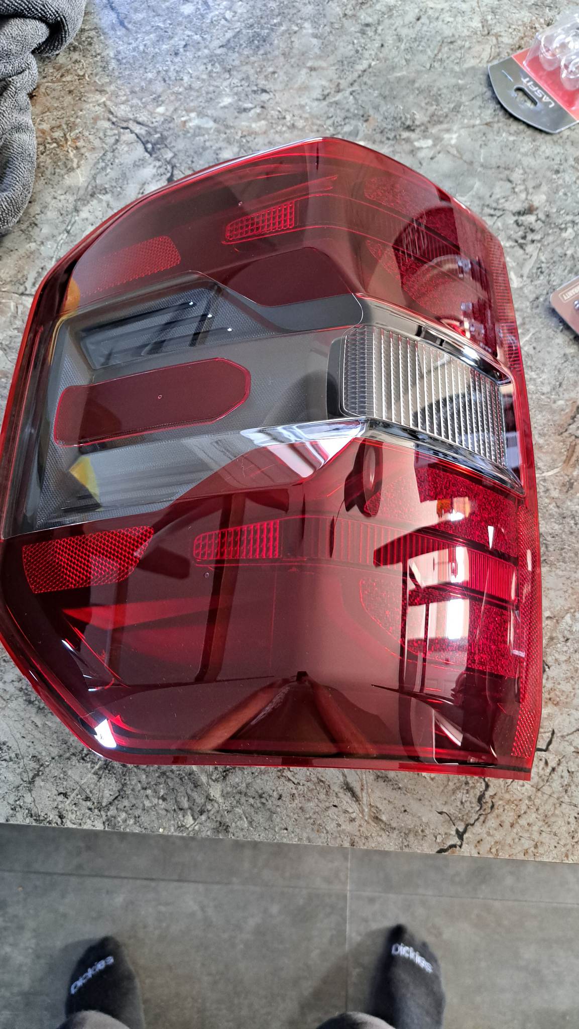

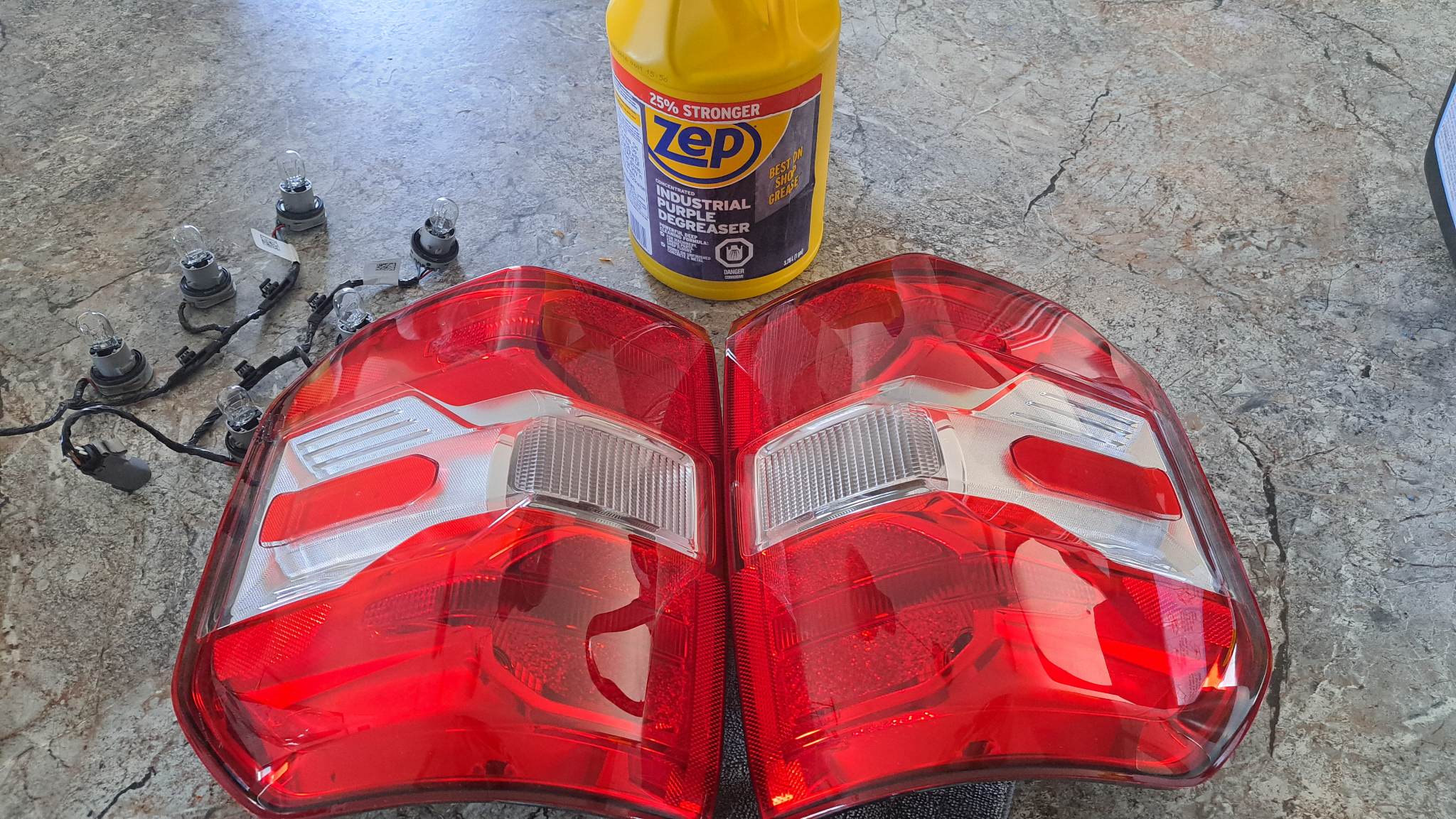

DIY black housing headlight with zep degreaser ( took them apart)
DIY black housing tailight with zep degreaser (Filled them up and rinsed with distilled water )

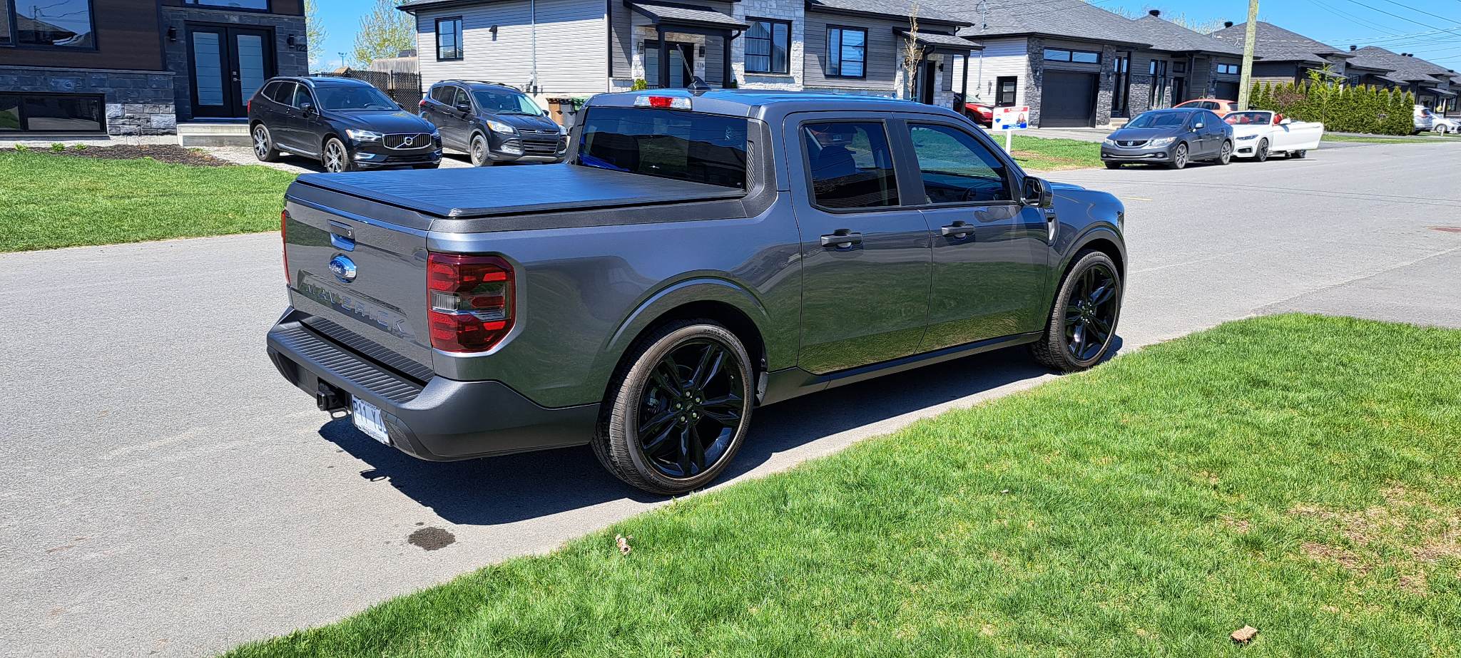

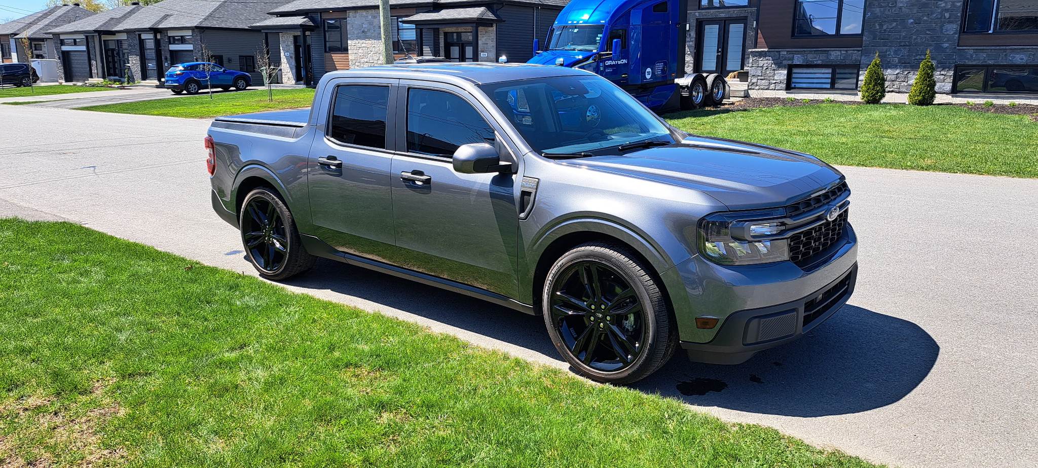

H&R super sport lowering spring 2.2 front 3 rear
set of wheel from a Ford edge st 2022, wheels and brand new
1/4 wheels spacer for the rear because of fender liner rubbing on driver side
3d maxpider mat front and rear
Deeze tailgate assist

I don't think it will work , because exterior chrome is 'real' chrome plating and headlight and taillight are aluminium powder plated and degreaser can disolve alu

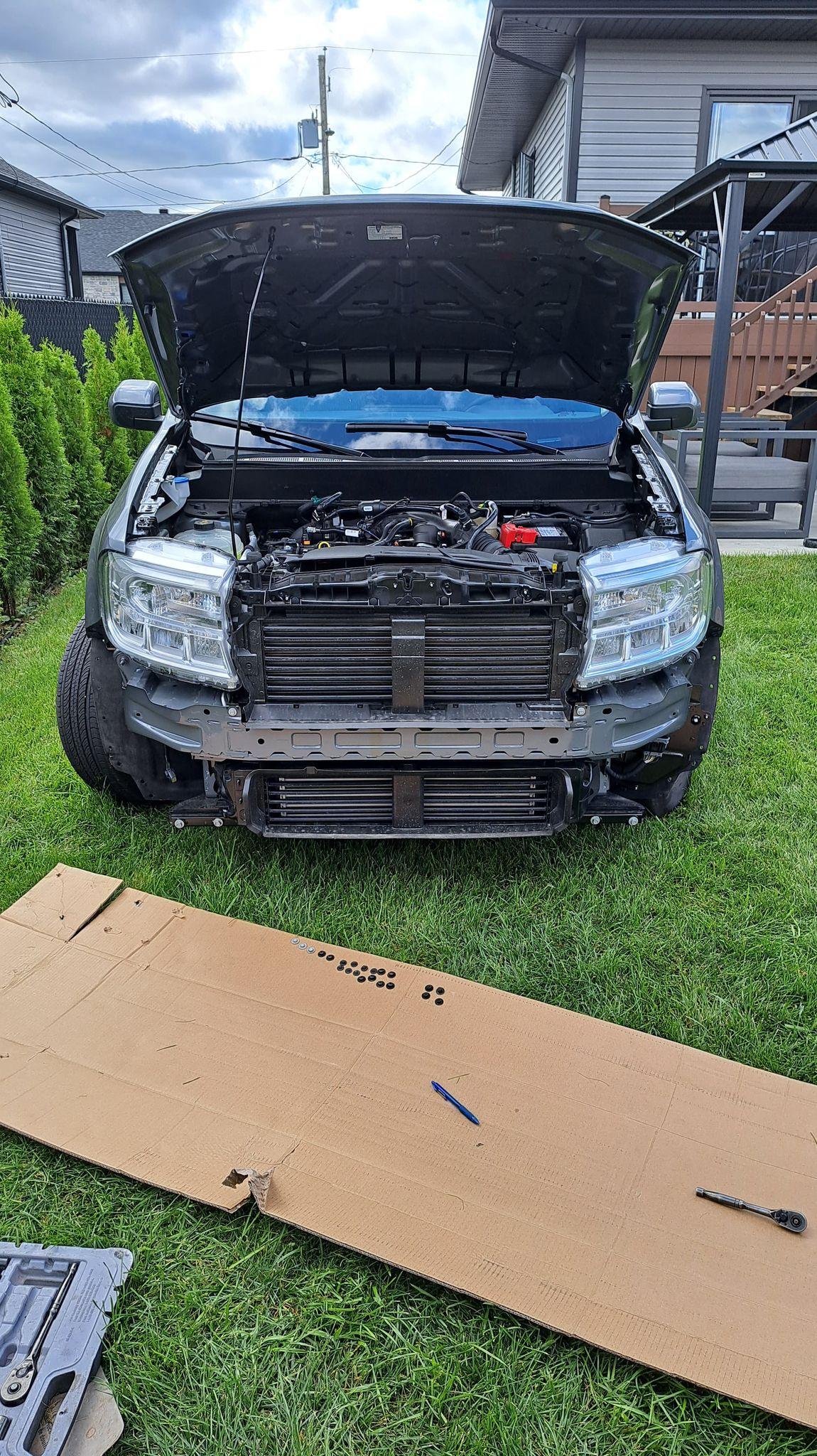

Reviving an old thread. Any reason you couldn’t do the same trick with the taillights for the headlights instead of disassembling?
CurtisB
Jan 11, 2024
2,013
2,656
92868
2023 Maverick XLT Hybrid
The headlights are sealed LED's. I wouldn't try it. Probably would cause moisture problems to say the least.
