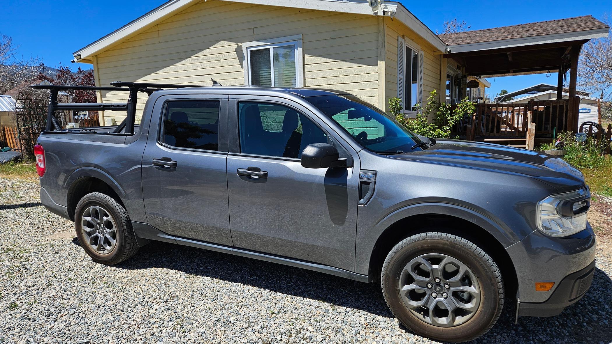

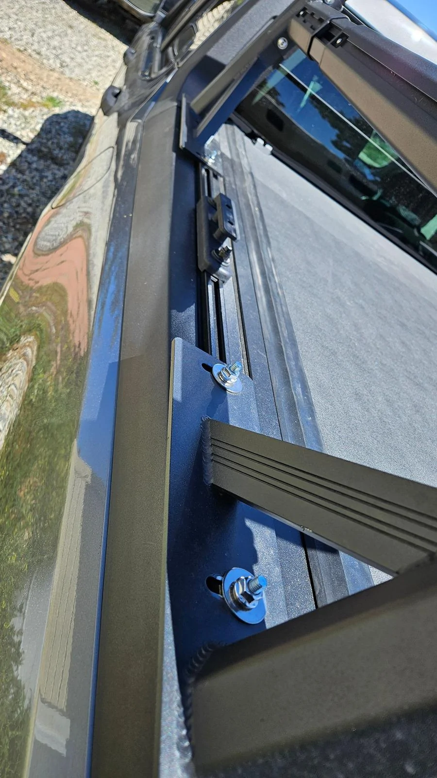

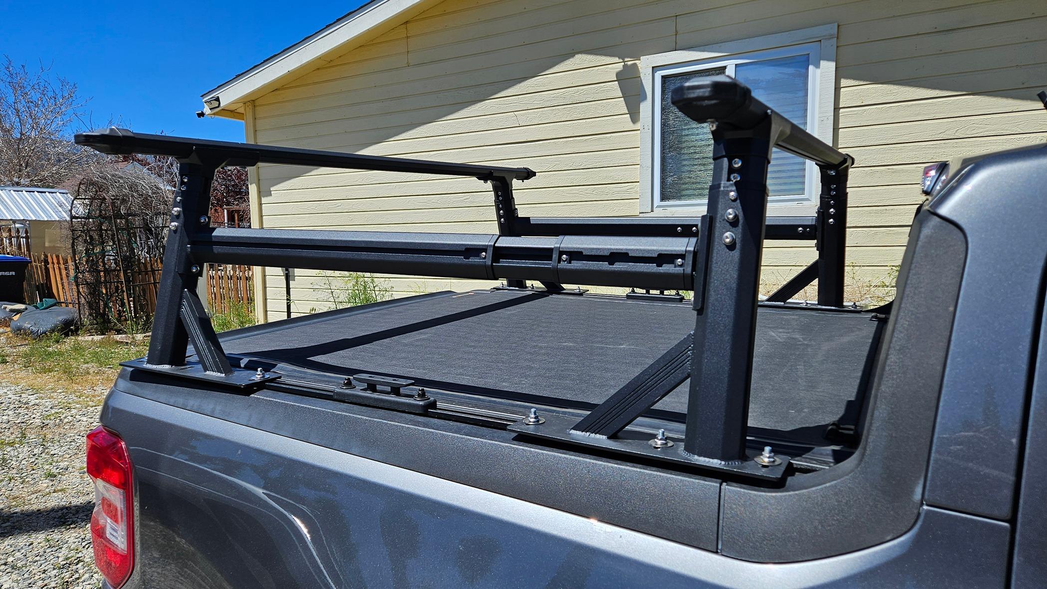

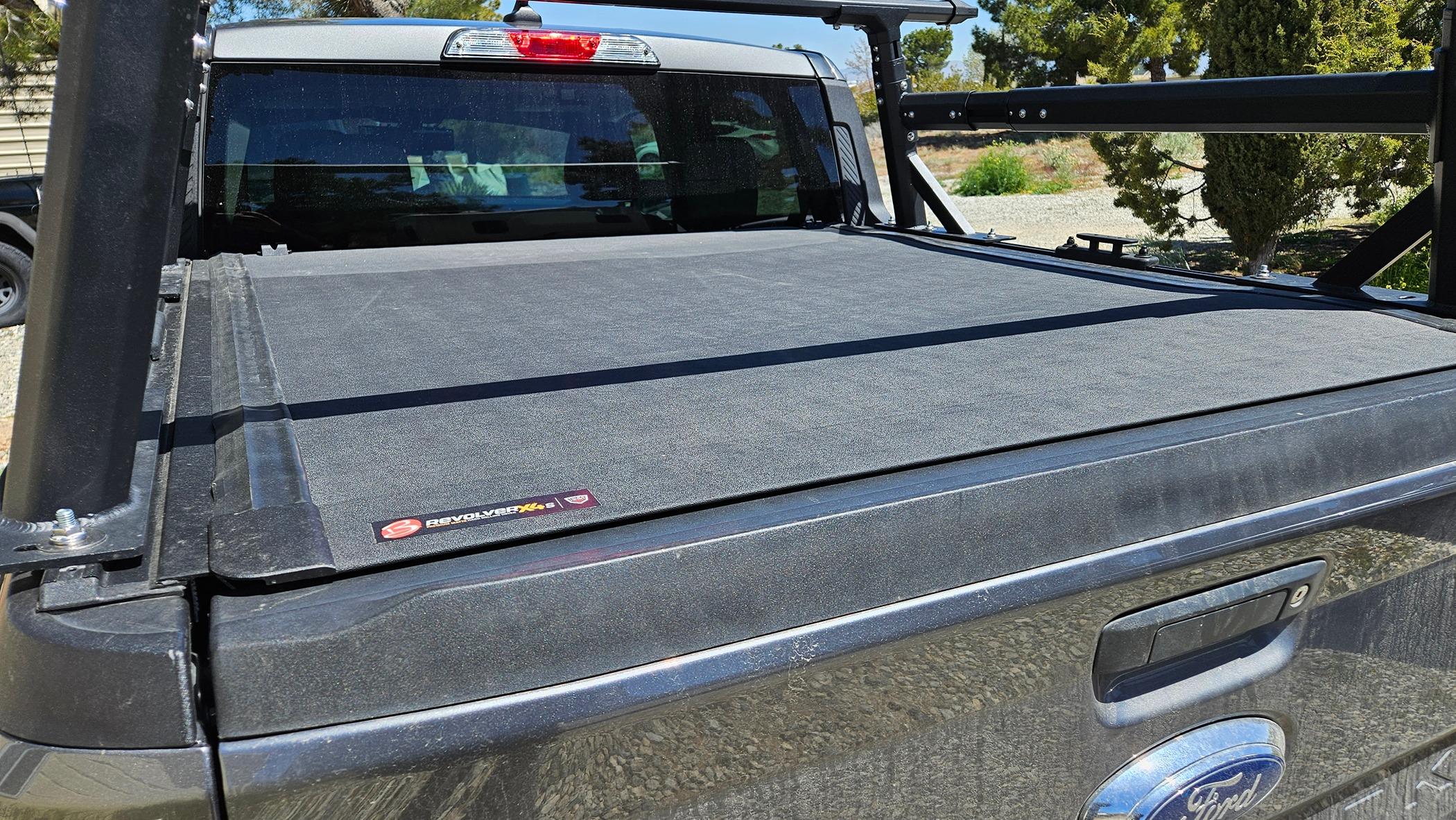

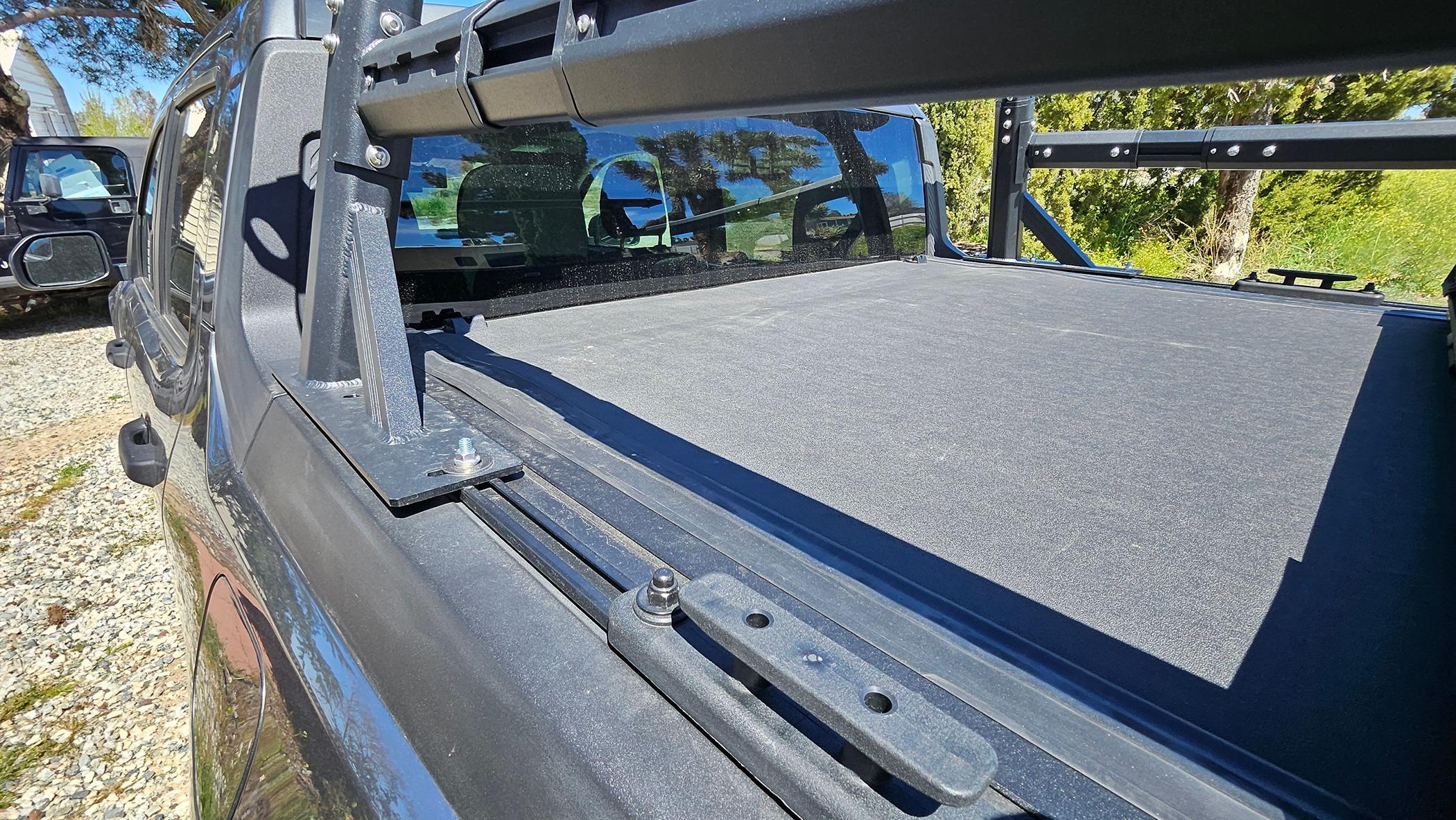

Originally saw this rack on Performance on Wheels YT and Irvinec32's Melipron channel. looked great except i wanted a tonneau cover. did some research and found that the Melipron rack could be installed on TS Rails. i ordered the inner rail system, same price as the others. extra hardware is always welcomed on the ranch.
I found a set of used full size TS Rails on Ebay and picked them up for 100 quid cut them to fit the Mav. Chose the BAK Revolver X4S even though I read the X4TS was going to be available on April 1st. The X4S arrived and had some mfg. defects. they are shipping out a full replacement as of this writing, they say i have to drill a few holes in the cover,
what they call self-destroy.

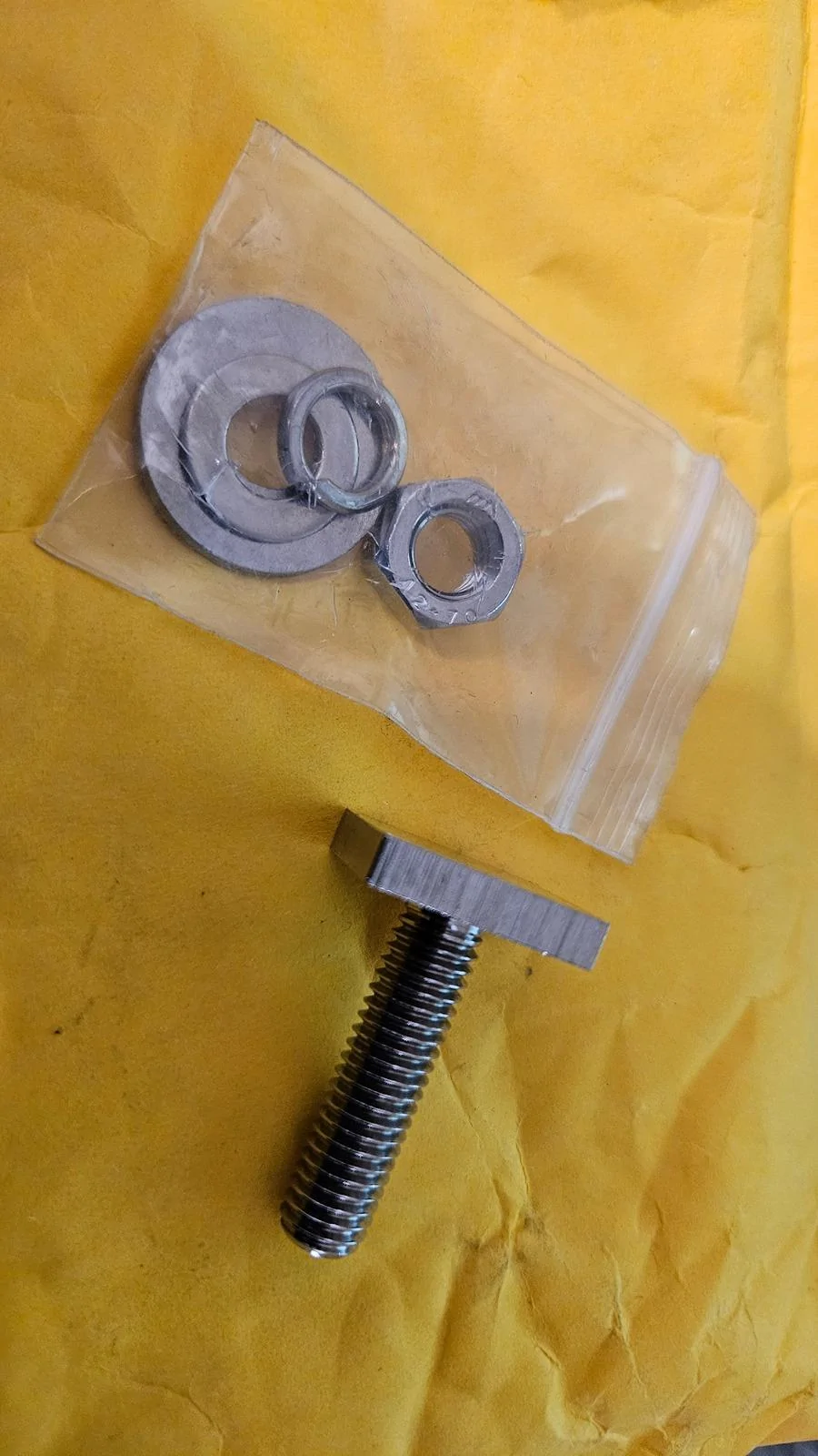

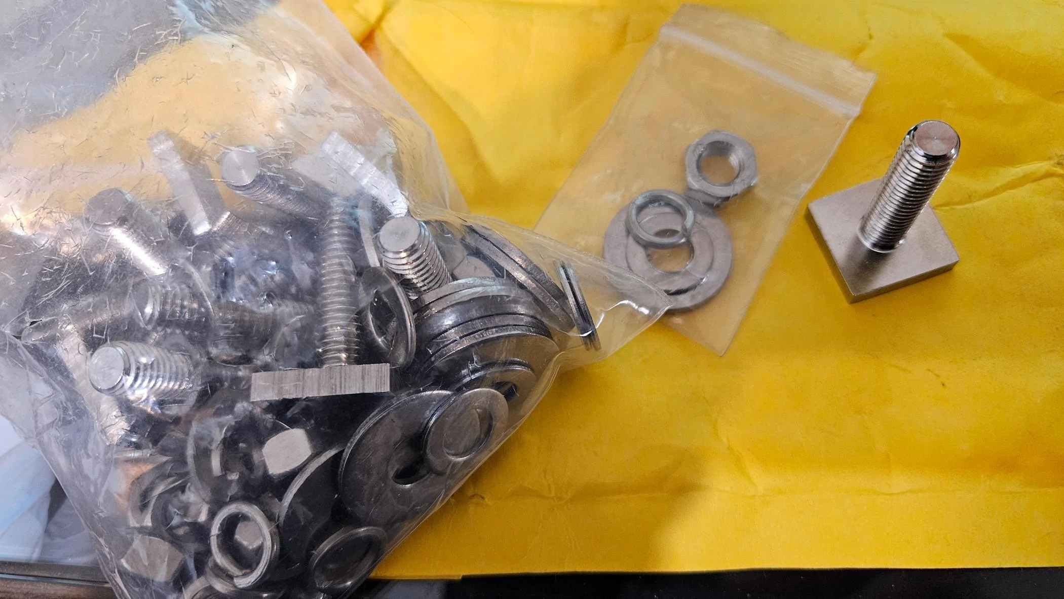

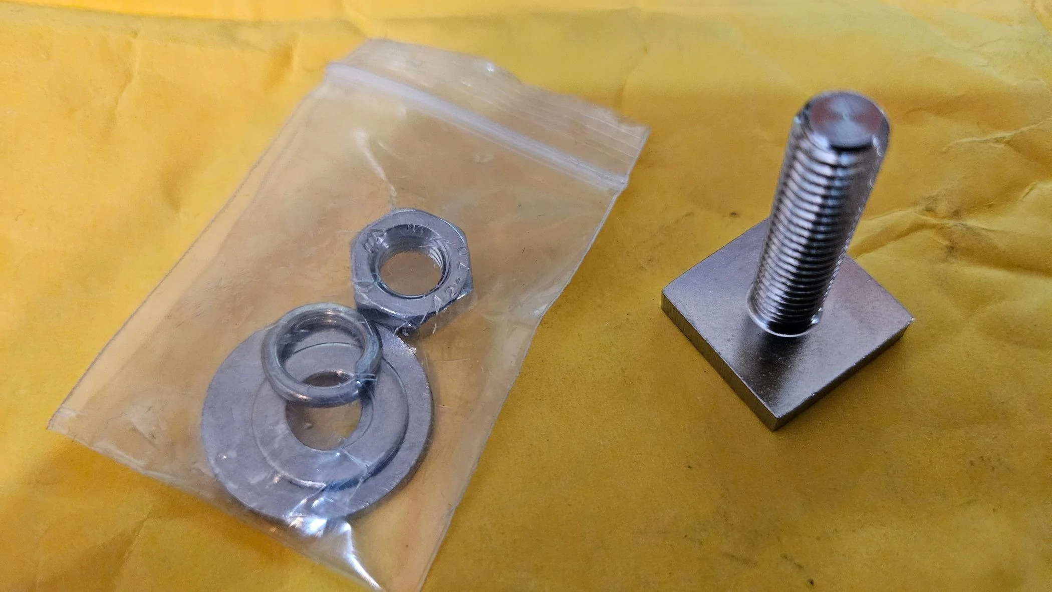

Melipron t bolts are not stainless steel, i picked up a set of stainless bolts, nuts and washers on ebay for 21 dollars M8x30 bit long ill cut them down once the new cover arrives, ordered a 2nd set of t bolts, nuts and washers becasue the quality far exceeds what Melipron provided.
I am happy with the results.
