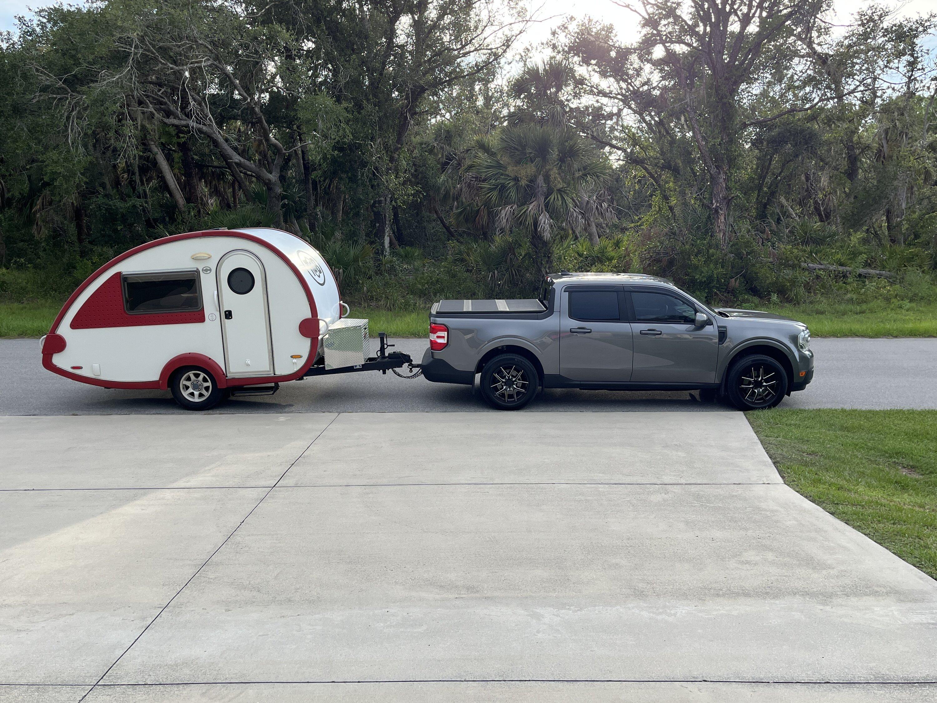

Glad to hear other hybrid Maverick’s towing campers.
We bought our little teardrop camper a few weeks ago. 1670 lbs. Currently swapping the hydraulic brakes to electric brakes. Installed a 7 pin connector with a brake controller.
we’re hoping to go camping one weekend a month.

Hi, looks like a great time.
Teardrops are always very popular in the camp grounds, the Maverick is a perfect fit with it.
Have fun!

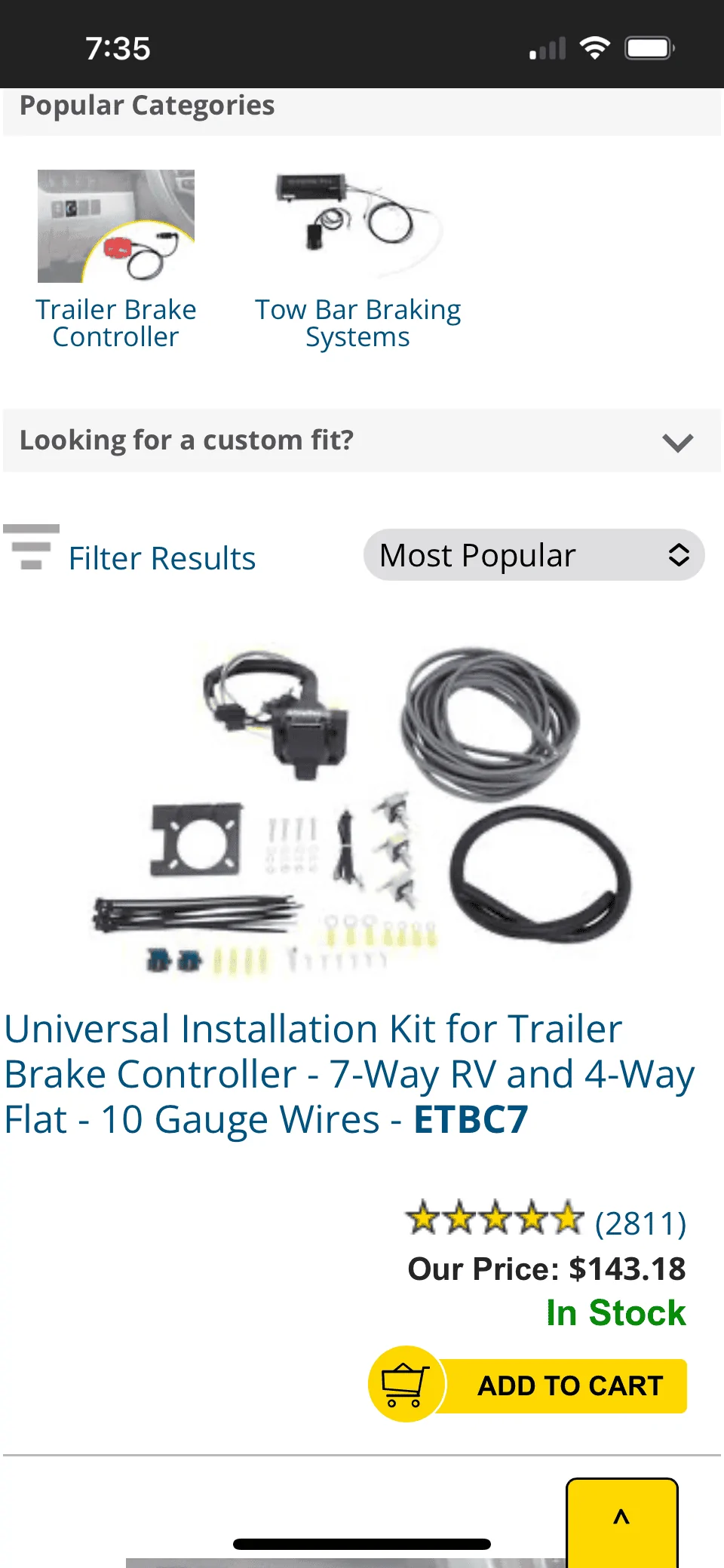

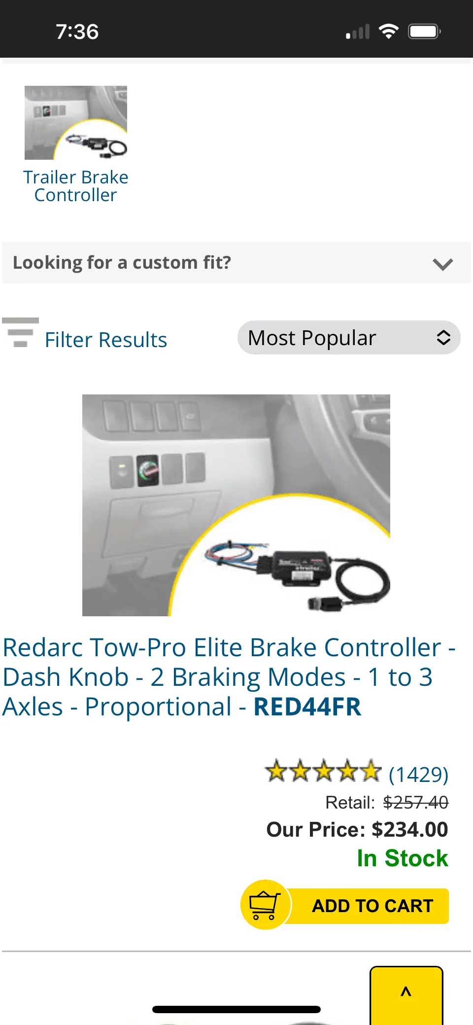

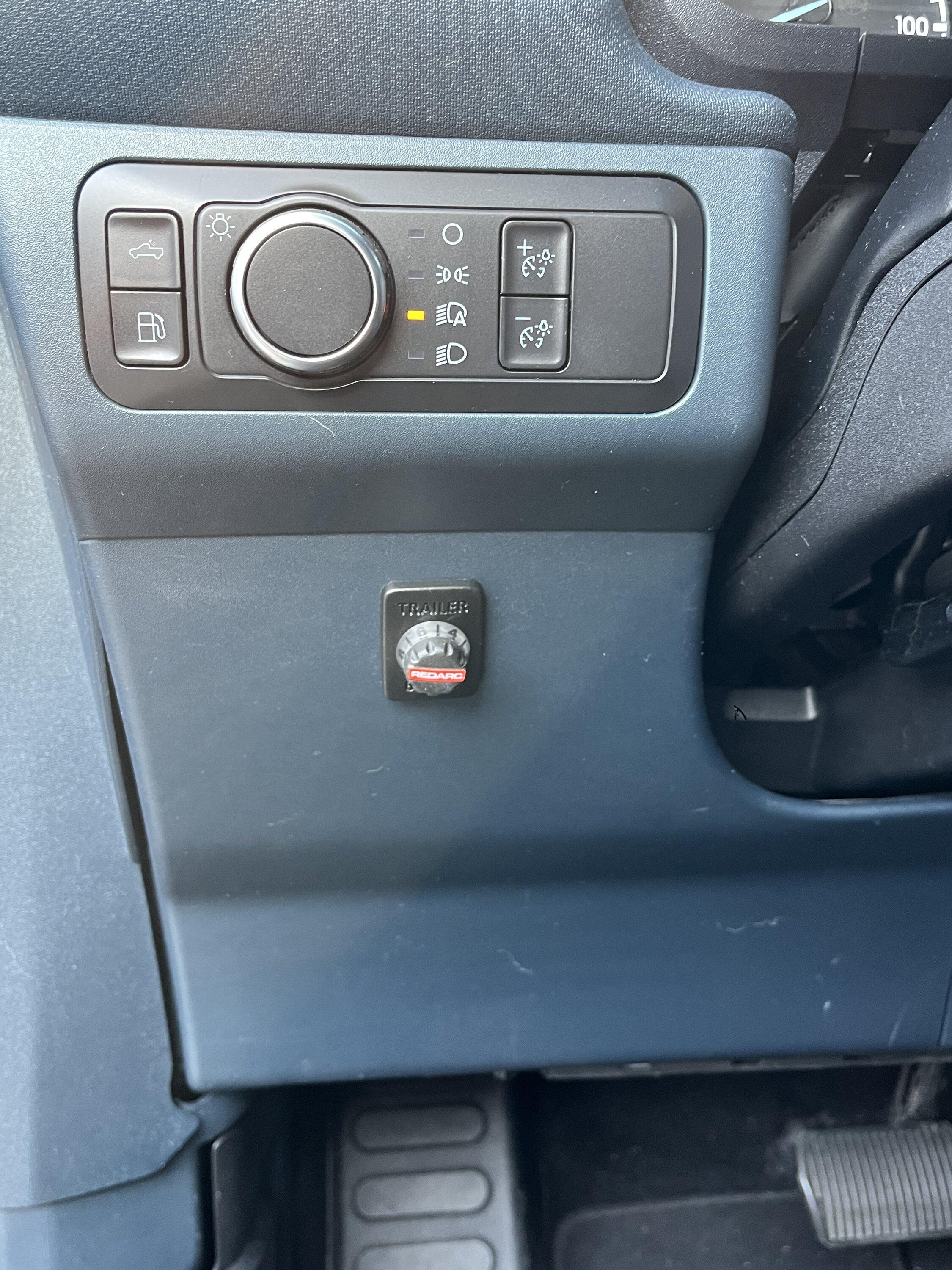

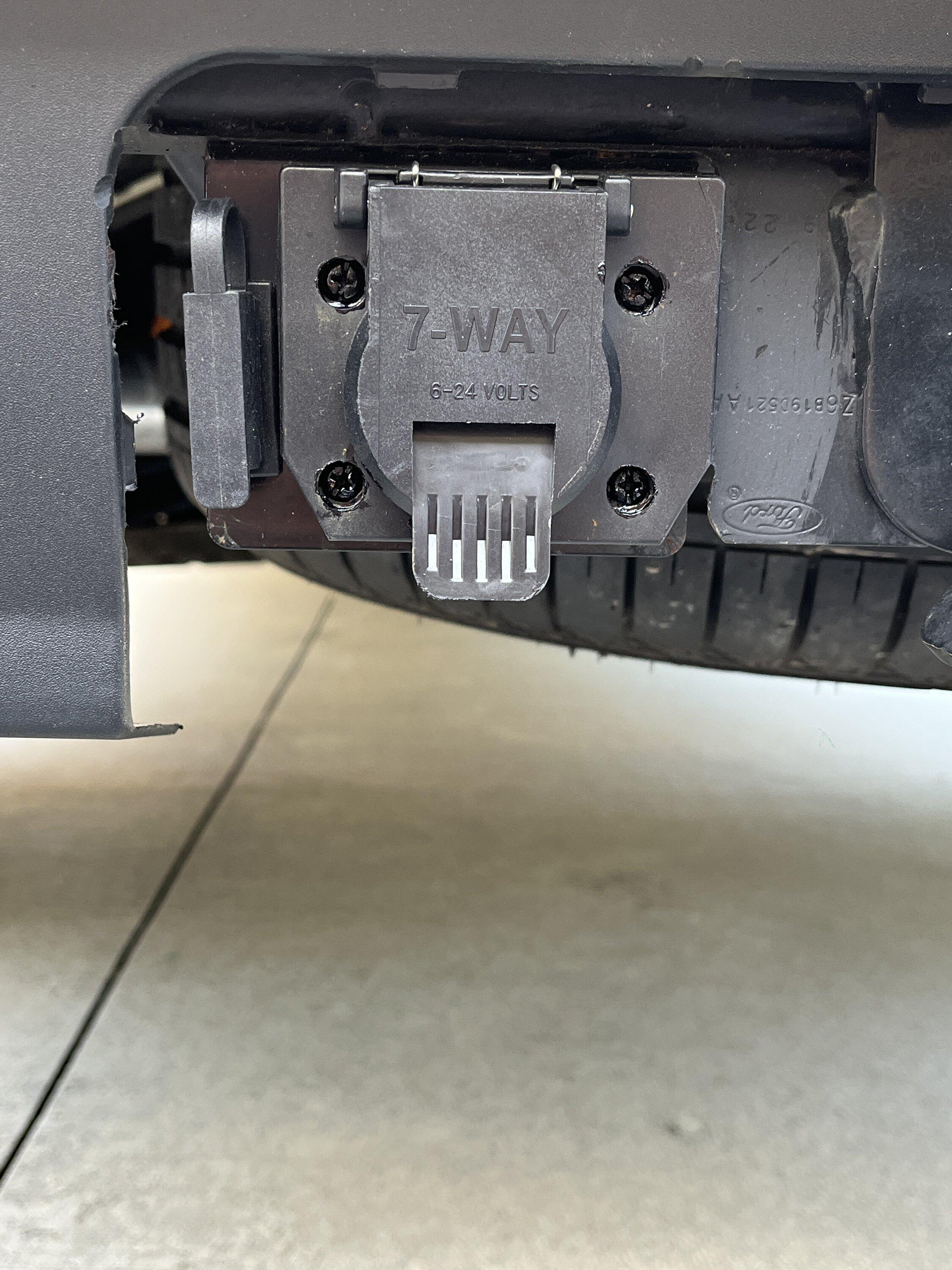

Ordered 2 parts from www.etrailer.com and installed it my self. I followed the instructions on both parts. On their website you can find an installer if your not comfortable installing it.
Finished swapping the camper’s hydraulic brakes to electric brakes and the campers brakes awesome with the brake controller. Definitely worth the investment and work installing it. Hope this helps.
1) Universal Installation Kit for Trailer Brake Controller - 7-Way RV and 4-Way Flat - 10 Gauge Wires
2) Redarc Tow-Pro Elite Brake Controller - Dash Knob - 2 Braking Modes - 1 to 3 Axles - Proportional.

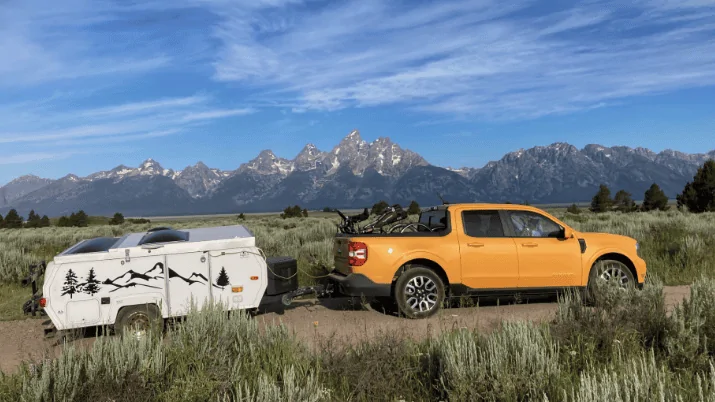

We also have an A-frame trailer. Sport model 10' and 800lb dry. Our Mav is a Hybrid.
We have towed a trailer about 4,500 miles of our 8,100. Averaged about 28 mpg with the trailer. Our worst was 3,000' of climbing over 115 miles and we got 24mpg. Our best was 75mph on a busy interstate with a tailwind and semi trucks all around. We got 35 mpg for about 200 miles on that run.
Been a great lil' truck. Did a little "off road" too. Got it up on three wheels once. No problems even towing the trailer up loose rocky trail.

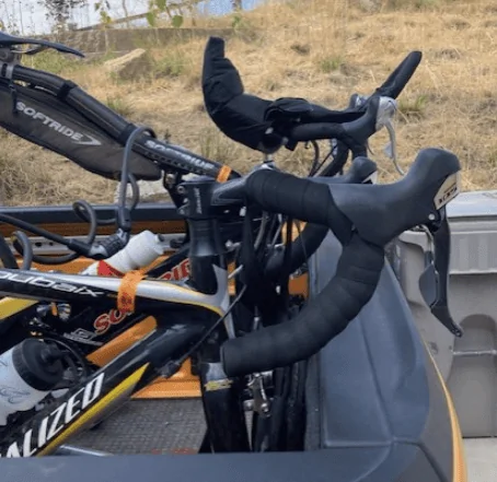

PS Two road bikes fit really nice diagonally in the bed. Mountain bikes are a bit of a squeeze. The Ford DIY board thing only works for small bikes with flat bars. I moved the board to the back, just set it flat and the handlebars could stick out over the tailgate.

This install looks really good.
Did you retrofit the original Mav hitch and 4-pin connector or start with nothing? If the first, how did you cut the metal plate where the original 4-pin connector is located that is part of the hitch?

It came with the hitch and 4 pin connector from Ford. I took a grinder and cut off the 4 pin connector and added the 7/4 pin connector bracket.
You disconnect the 4 pin connector from the back of the original and it plugs into the new 7/4 wiring.

Ok. Angle grinder it is…. Thanks.
