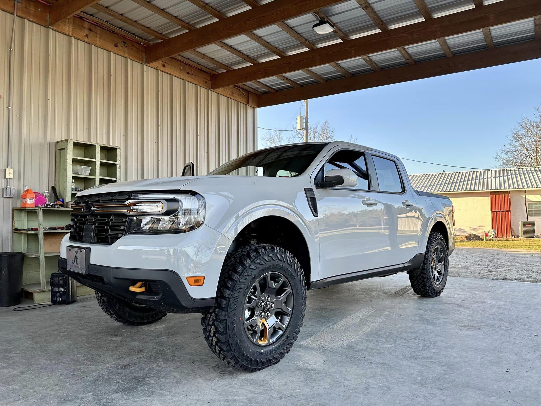

I'm looking into getting a Maverick Tremor, I really would like it to look like the one that's pictured, the post it's on says it's a 2in Rough Country, so I'm assuming it's a 2in puck kit. With that being said, will these things handle a 3in lift and tires fine? If it's more trouble than it's worth, I'll order a non-Tremor and lower it like I originally intended before I saw this truck. If it is feasible what all would be required to make it work great as a daily driver? And would it even be comfortable to drive?
Just to add, I don't care that milage will probably be 20mpg or less. Or that there are more capable trucks of being lifted/lowred. I just like it. I already have a low car though, I want a lifted daily.
Ford Maverick Maverick Tremor, with a 2in lift. 332167443_590069525994866_5577645904312204030_n
