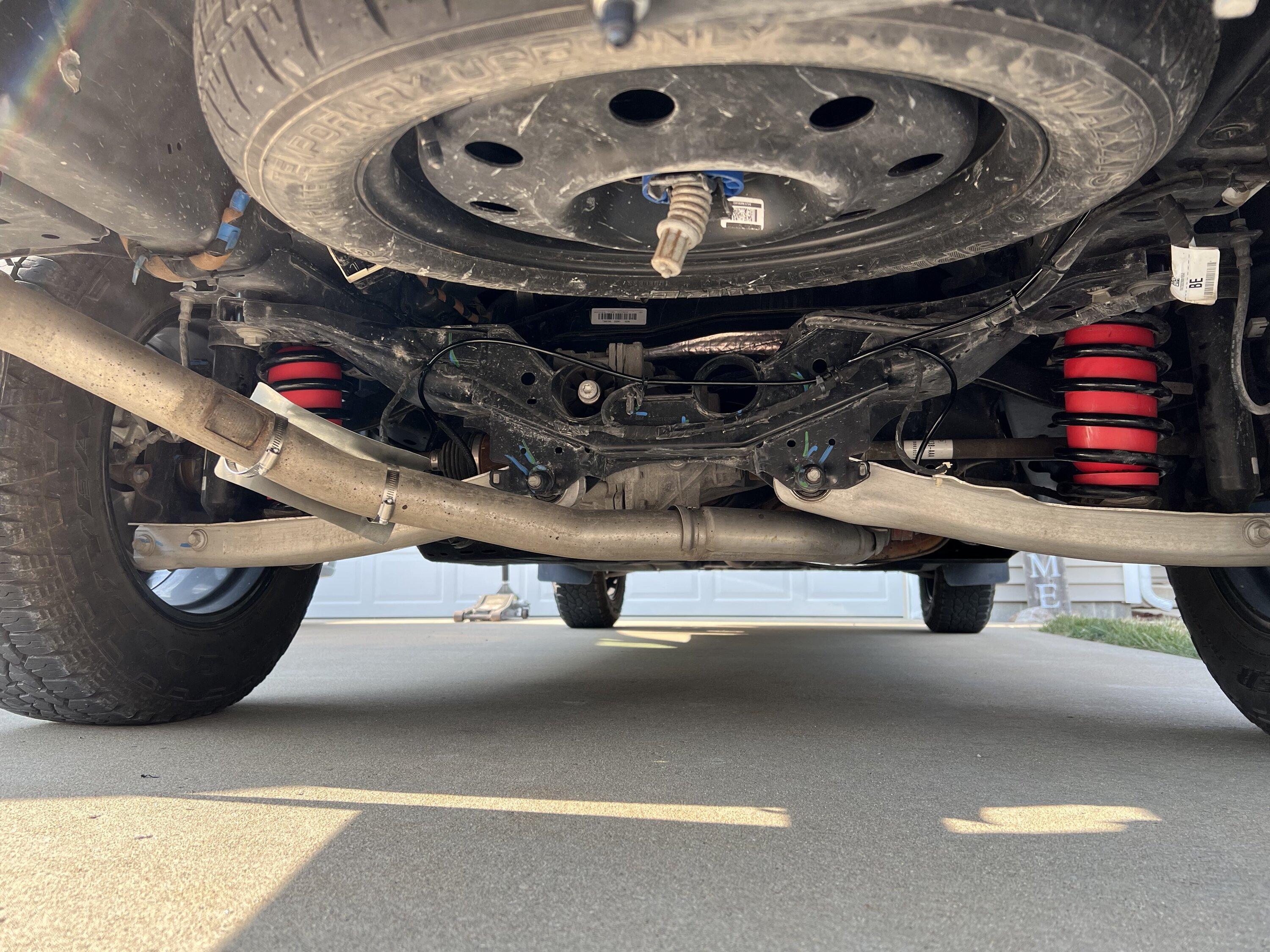

As I sit back and watch, I'm hoping that Ford just gets their a** in gear and builds the orders. I just ordered the Air Lift bags for my 22 XLT hybrid to keep the truck from wallowing while towing the camper, I'm perfectly fine with the factory build and can't see the"lowered stance" as being a good fit for a truck.
Please let me know how the Airlift bags installed. I just spent 2 hours trying to get one in and gave up, took 30 minutes to get out. 4th vehicle with air lift bags, but these new ones are so much more stiff I gave up trying to get them in. Not sending them back just yet, but I'm close. Hoping you found an easier trick to getting them in there.
Jack up the truck to let the weight of the axle and tire stretch the spring, I had to fold the ends toward the middle to slip it through, I have spring spreaders if that doesn't work, used them on a set of McPherson struts I'd overloaded but couldn't afford to replace in 2011 while out of work, Country Boy Will Survive.

Finally got around to trying to install the Airlift bags in in the coils again today. One piece of advice - DO NOT FOLLOW AIRLIFT INSTRUCTIONS! Do NOT squeeze the air out of the bag before installation, SO much easier to install. Just remove the cap to relieve the pressure. When you squeeze the air out, it is much wider than the interior of the coil and cannot be "taco-ed" to squeeze in. Larger coiled vehicles don't have the same issue. Leave the cap off so you can squeeze as needed which keeps the widest diameter smaller. You'll notice Airlift doesn't post a video on the Maverick installation. I think it's because - if the installer was following the instructions - there would be too many *beeps!* ($#&%) in the video.
So far the bags work fine, have about 25lbs in them currently.

One more piece of advice to this is heat them up. I set them out in the sun and put a space heater an inch away from them. Makes them a lot more pliable and easier to work with.
