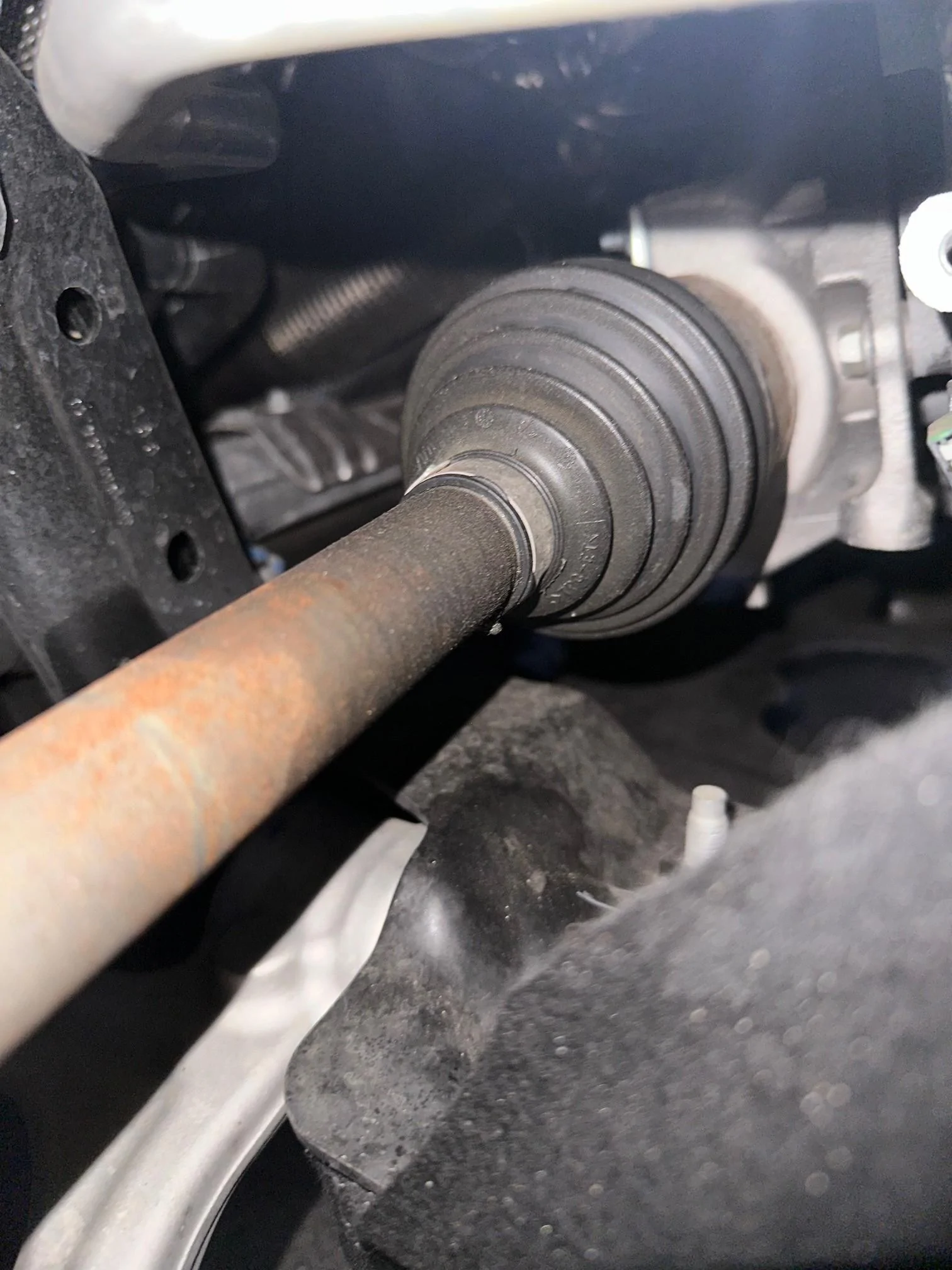

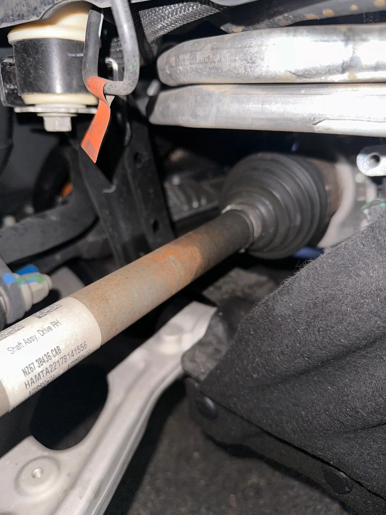

Have Hybrid XLT 2022, about 22,000 miles on it and started to shake on highway speed only when accelerating.
Took it in this morning, waiting to hear from the dealership.
I am reading other threads here and see some mentions on axles and CV leaks - Is there anything else it might be based on experience?
Love the truck but it feels like I'm at the dealership more and more lately and its only at 22,000 miles =\
Update - Just got a call from the dealership, said the lower transverse mount is faulty
2nd Update - Mounts replaced, tech found some "play" in axles and recommended replacing them as well, parts ordered but not ETA as they are backordered... they recommend not driving it as they think the vibration from the axles is what might have caused the mounts to fail as well so they provided with loaner car until axles will arrive.
all done under warranty.
will update.
