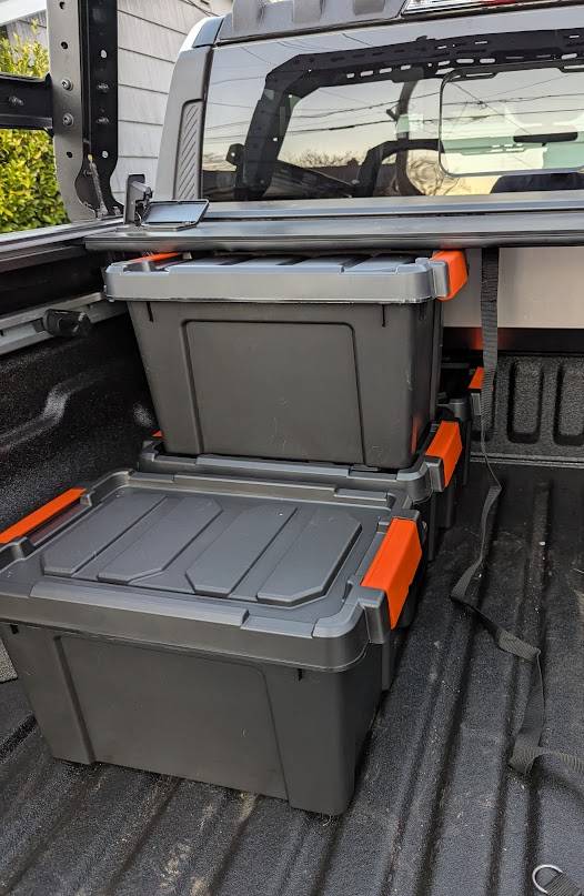

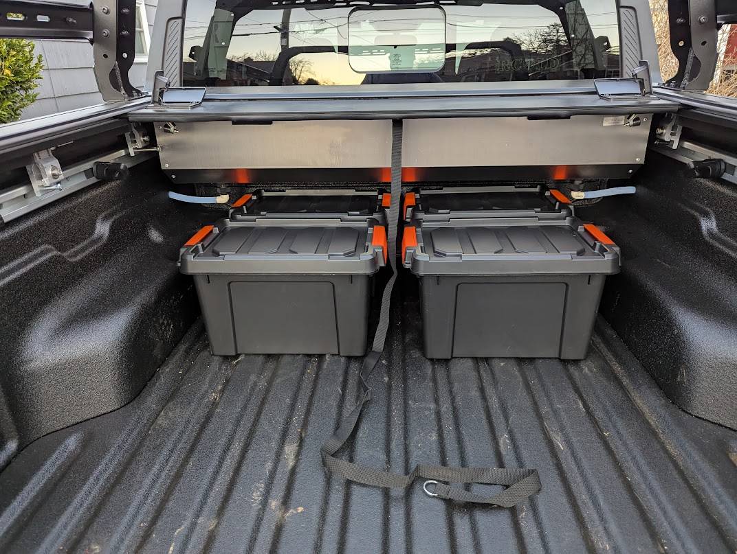

I wanted to create some bins that would fit under the housing for the Synetic MR rollup tonneau cover and between the wheel wells. Just drilled some holes for the magnetic hardware and sealed it with silicone. Ignore how mine looks I would recommend getting the bigger 50lb magnets and putting them on the 4 corners. I had ordered smaller 25lb ones and had to use a lot more. I underestimated how much the spray in liner would mute the magnets. The completed bins stay put even when loaded and don't slide around. they don't take much effort to pull up either. The ribs on the bottom of the bins are 4.5" apart which is exactly the centered spacing of the ribs across the truck bed. I kept the 4.5" spacing on the short sides as well so I can load the bins either direction. The bins aren't waterproof but are water resistant. With the width of the bins you can get two across and still have clearance on the sides so have access to the D-Rings on the bed floor
