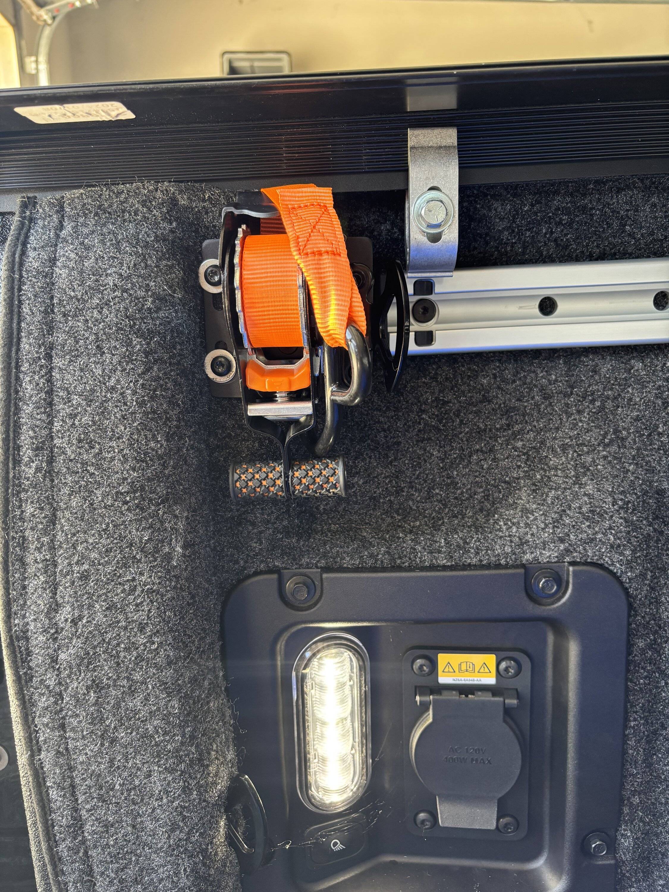

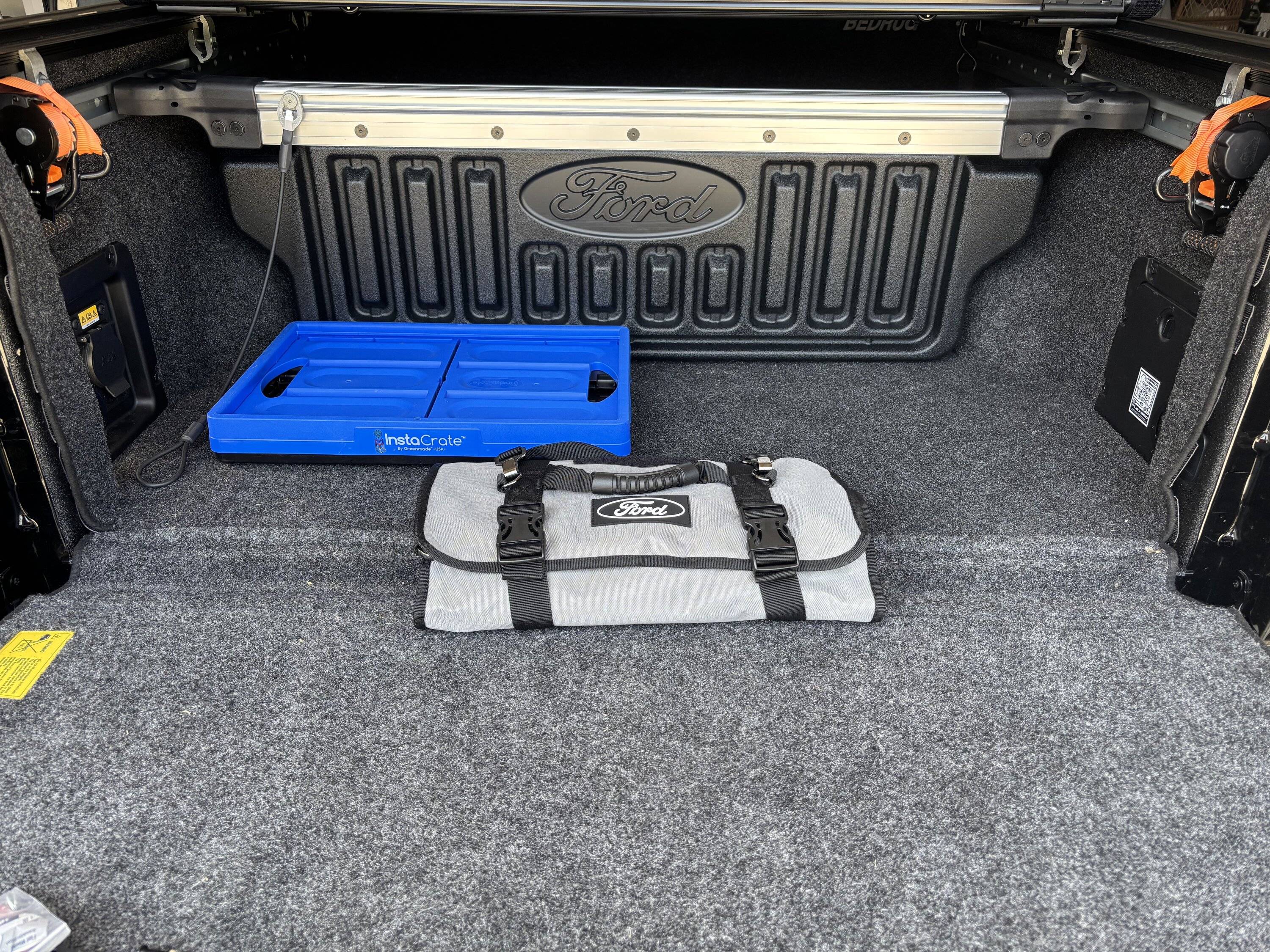

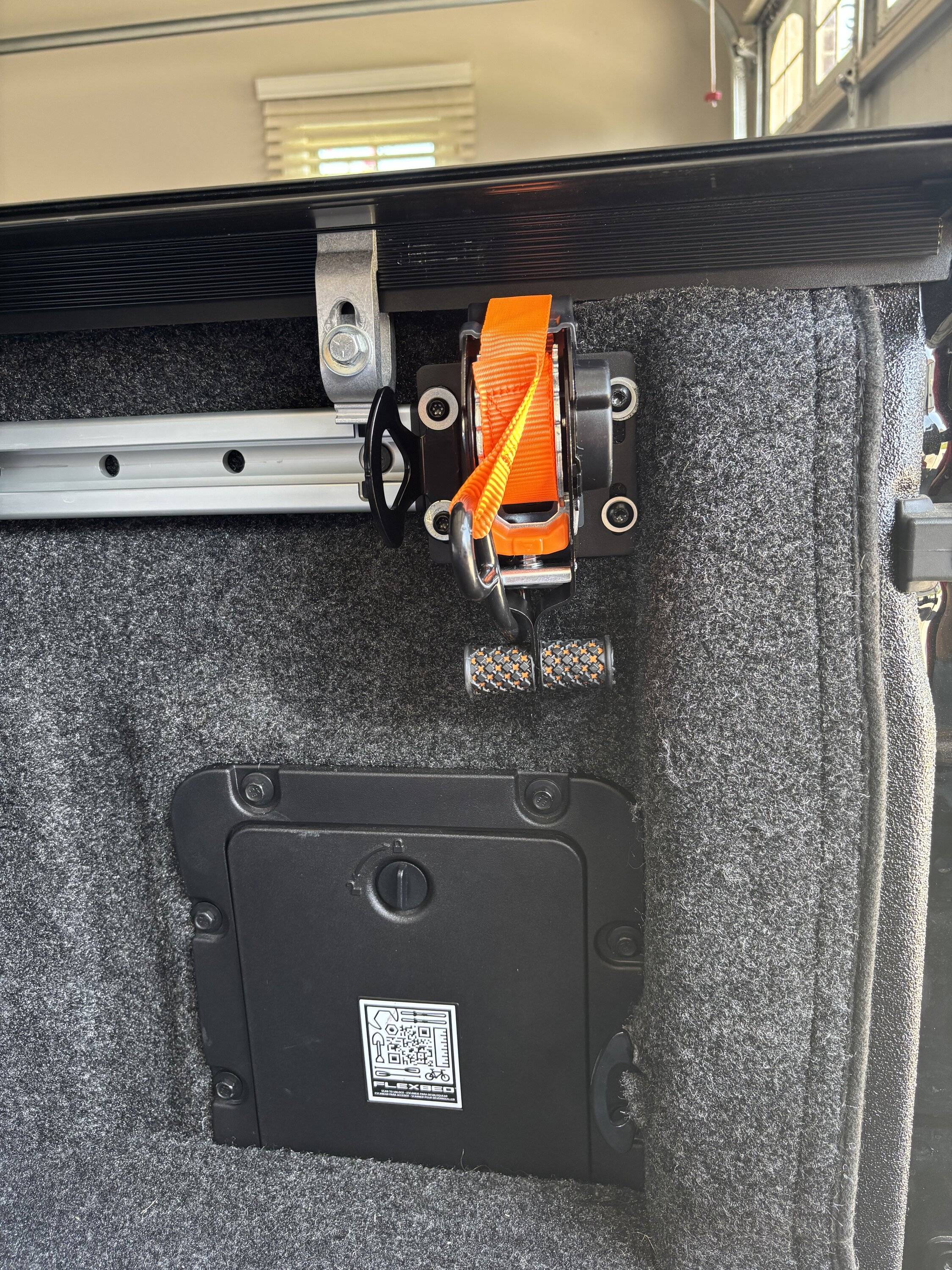

Just finished installing the @MABETT Retractable Ratchet Straps, so I thought I'd post my take on them.
Installation is very easy. I was concerned that it only attaches to the bed wall on one side of the device. It seems like heavy force could bend the back metal plate, but we will see how that pans out. Since the original tie down is mounted on the opposite side of the device from the mounting to the bed it really seems like any hard pull from using these would be more likely to damage the ratchet because of the increased leverage.
I added washers (none were included) because the mounting slots/holes were only a little smaller than the screw heads. Again, it seemed like a wear/damage potential with heavy use.
Other than the concerns I mentioned, they seem like really useful devices that will greatly help with securing loads in the bed. They look really nice as well. Operation of the latching mechanism was straight forward and convenient for securing items quickly and easily.
Ford Maverick Mabett Retractable Ratchet Straps Installed 2025-07-16 10.21.00
Ford Maverick Mabett Retractable Ratchet Straps Installed 2025-07-16 10.21.11
Ford Maverick Mabett Retractable Ratchet Straps Installed 2025-07-16 10.21.27

Are there 4 screws per strap???
There are only 2 on one side that actually hold the device to the bed wall. That's why it was a concerning design to me. It would've been stronger, for example, to bolt a plate to those 2 bolt points from the old tie down and then secure the device to that plate with 4 bolts - one in each corner.

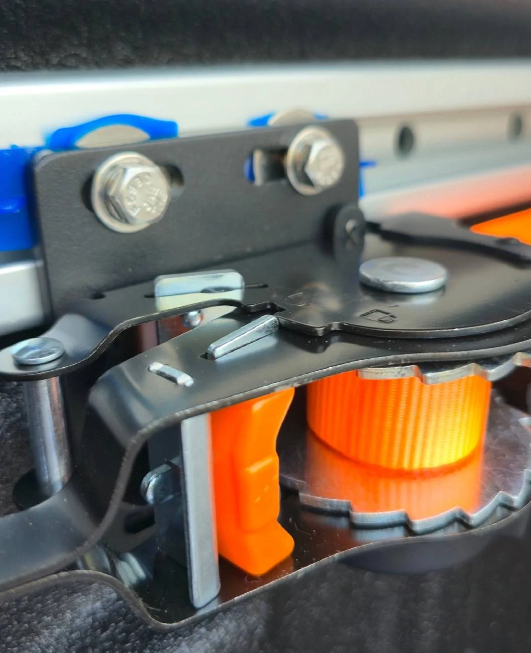

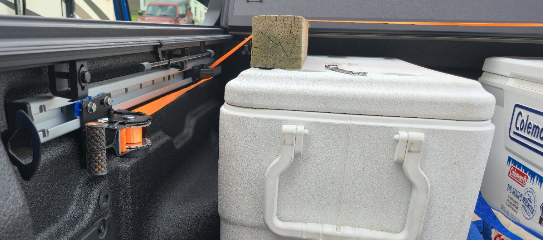

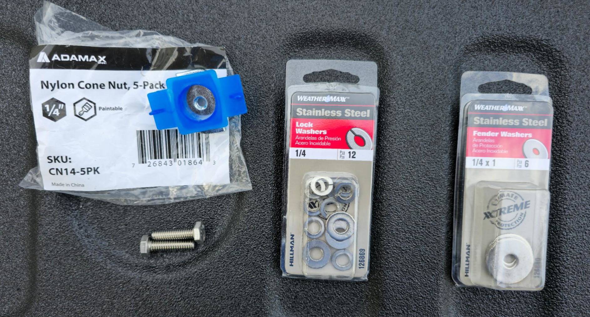

I have tried a new slant on the Mabett Retractable Ratchet Straps.
1> After purchasing Nuts, washers & bolts from Lowes:
Ford Maverick Mabett Retractable Ratchet Straps Installed Mabett Retractable Ratchet Straps a bolts 20250715_194134[1].JPG
2> I mounted them horizon:
Ford Maverick Mabett Retractable Ratchet Straps Installed Mabett Retractable Ratchet Straps b bolted yo rail 20250715_194152[1]

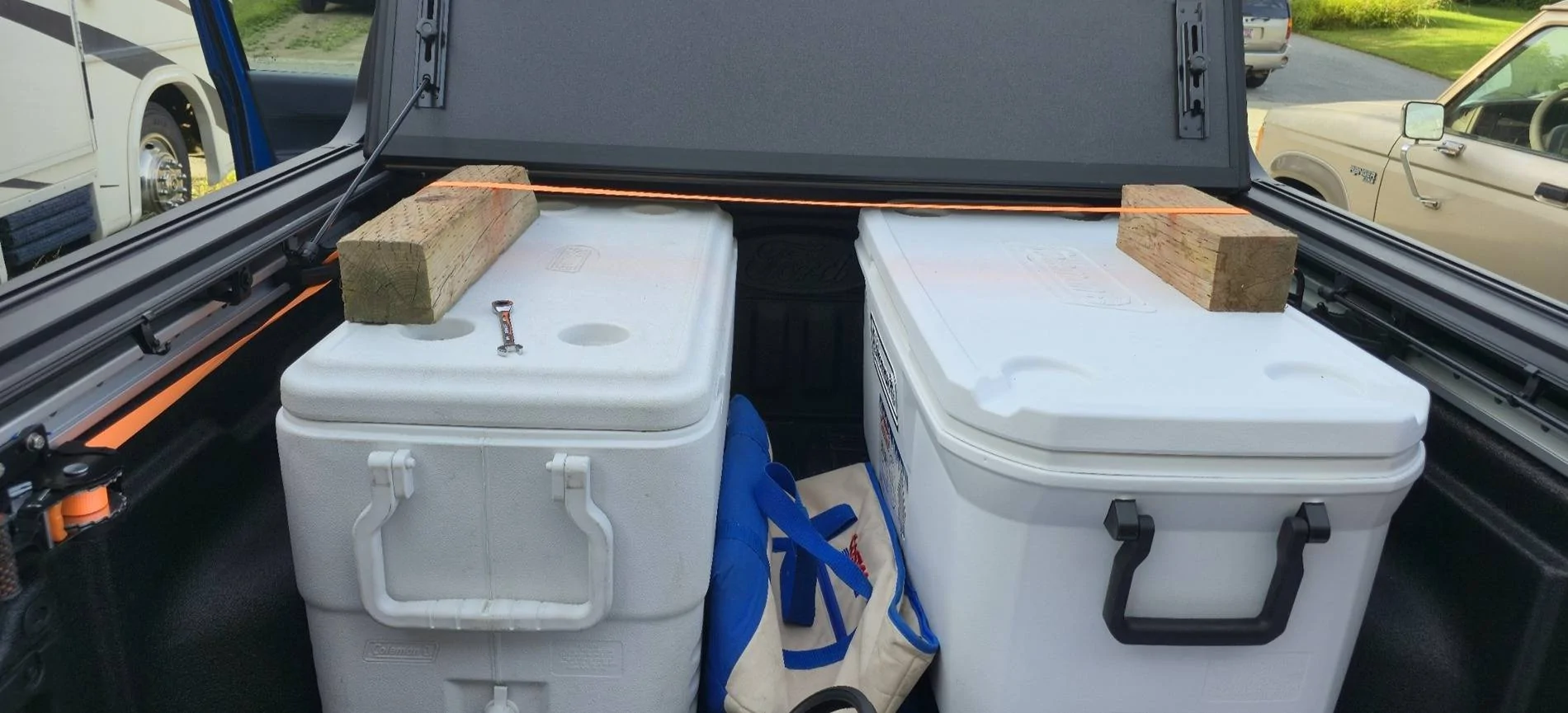

3> Drivers side pointed forward & looped off of OEM cleat to cross the bed.
Ford Maverick Mabett Retractable Ratchet Straps Installed Mabett Retractable Ratchet Straps c 20250715_194021[1].JPG
Ford Maverick Mabett Retractable Ratchet Straps Installed Mabett Retractable Ratchet Straps d 20250715_193404[1]

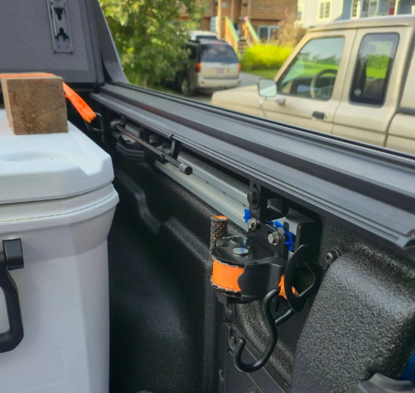

4> Passenger side faced to tailgate to secure any load too long for the bed.
Ford Maverick Mabett Retractable Ratchet Straps Installed Mabett Retractable Ratchet Straps e 20250715_193624[1]
I am still undecided on the mounted vs retractable ratchet straps in a bag. :unsure:
