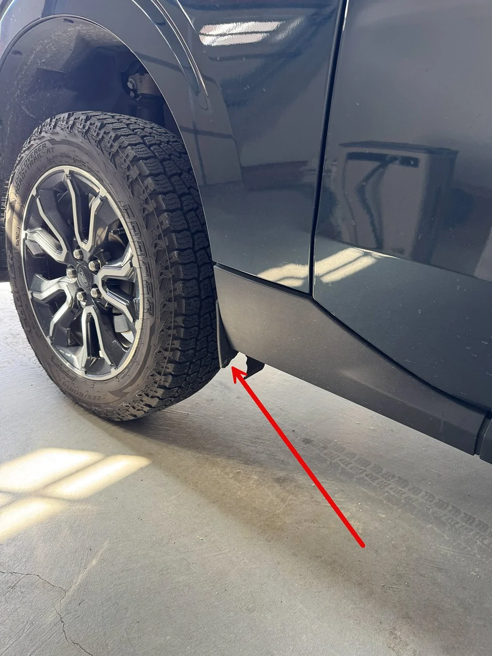

Hello, I had this noise which would creep in the back of my truck when I went over 40 mph. On three different occasions, mechanics and body shop people have looked for the source of the noise but couldn't find it. Now that a certain portion of the rocker panel trim has fallen off like it was broken into two pieces, the noise is gone away. This is not a part of the Ford OEM mud flap. That would be the rear of the right wheel well. The part I am looking for now is the front part of the right front rear well.

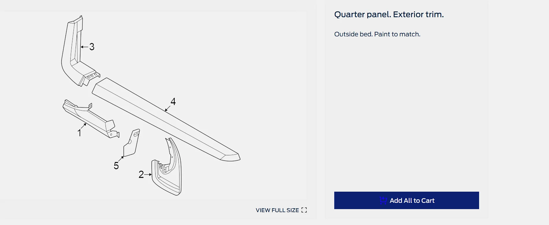

As best as I can tell, I need item #2 in this diagram. It is not part of the mudflap package. I asked car dealer for the part number,
and I think he gave me the part numbber for all these items in a bundle. It's a small rubber piece. No idea how it got broken.

You need item 5. Item 2 is the mudflap that goes on to the rear of the wheels.

Here's what I ordered for the right side a few years ago.
NZ6Z6011398A
Ford calls it a stone deflector.
That has to be it I needed the drivers side and that number was NZ6Z6011398D maybe the D was for drivers side in My case?
