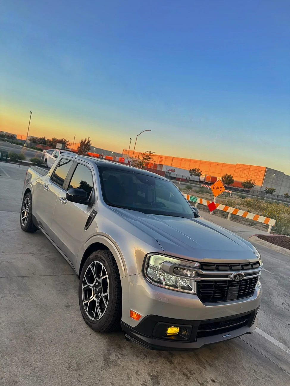

I have a 2024 Lariat lowered on eibach springs
Anyone know if the Lobo front struts are compatable ?

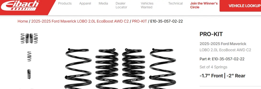

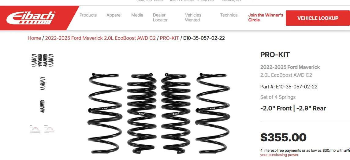

I previously posted before searching but I did just notice that Eibach does not have specific lowering springs for the Lobo. Their 2025 LOBO page links you to the same part number as the 22-24 (which is now updated to 22-25) AWD springs: E10-35-057-02-22
Ford Maverick Lobo front struts on a 2wd Lariat? 1755784485868-m9
Ford Maverick Lobo front struts on a 2wd Lariat? 1755784508497-
I post all of this to say that you may very well not notice much difference, if any, swapping to the Lobo struts. Eibach is a very well respected company with knowledgeable engineers (one used to post quite a good deal on here, IIRC). And to me, if Eibach didn't feel the need to develop a Lobo-specific set of springs, the valving of the Lobo struts can't be vastly different from your stock (non-Lobo) struts.
Unless you really need new struts (or can find some Lobo take-off struts on the cheap) I'd personally pass on the idea. Per Ford, the Lobo is only lowered 1/2" in the front, and the Eibach's drop quite a bit more than that. The valving may be different, but if Eibach's engineers determined their existing springs to be a good match for both the Lobo and non-Lobo struts, I'd trust that.
