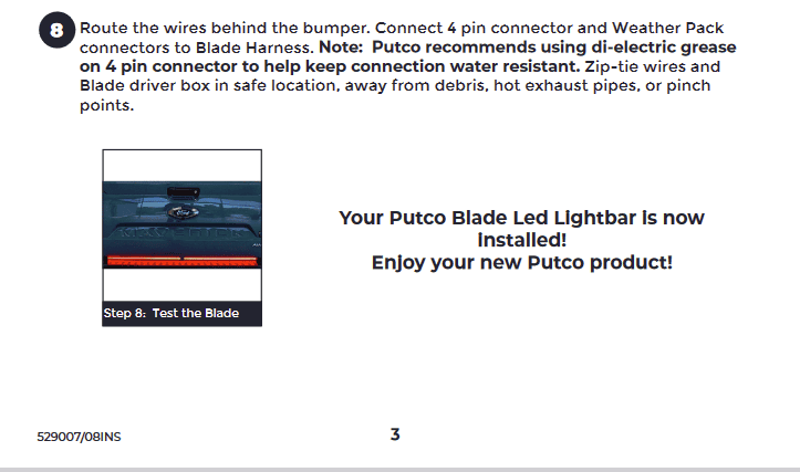

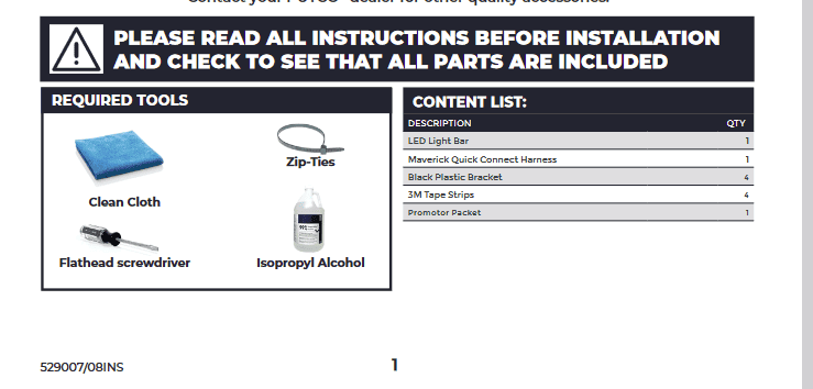

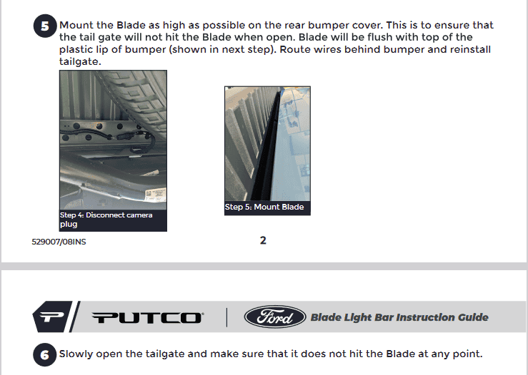

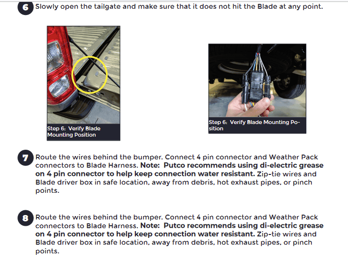

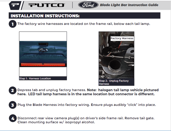

You can only buy through the ford website and I just installed this and the instructions it comes with sucks you have to takeout the taillights to install with the factory wire harness it comes with.
