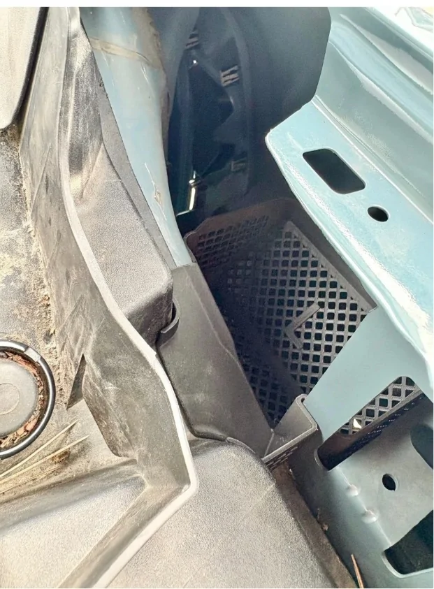

Pop off 3 of the push fasteners holding the front wheel well liner to the fender from the bottom. Pull it away some and debris will drop to the floor. If you turn the wheel for more room you may be able to get a vacuum in there too.

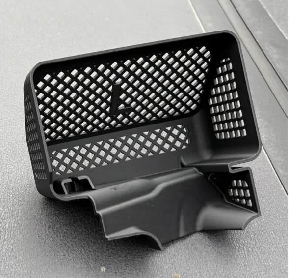

I bought a cheap pair of protectors off Amazon. They seem to work OK. Originally I felt like I might put a little heat gun to them to help flext them into shape because they were a little curved. Now that Fall is here and leaves are around I'm going to open up the wheel guards and confirm they're working. I know for a fact that they collect the leaves under the hood because I can reach there and remove all the leave caught, but still think it's worth it now to look into the wheel area to be sure. Anyway, here's the link for the cheap ones I bought: https://www.amazon.com/dp/B0FDFZLFGL?ref=ppx_yo2ov_dt_b_fed_asin_title
I'd say it's worth it for the price.
