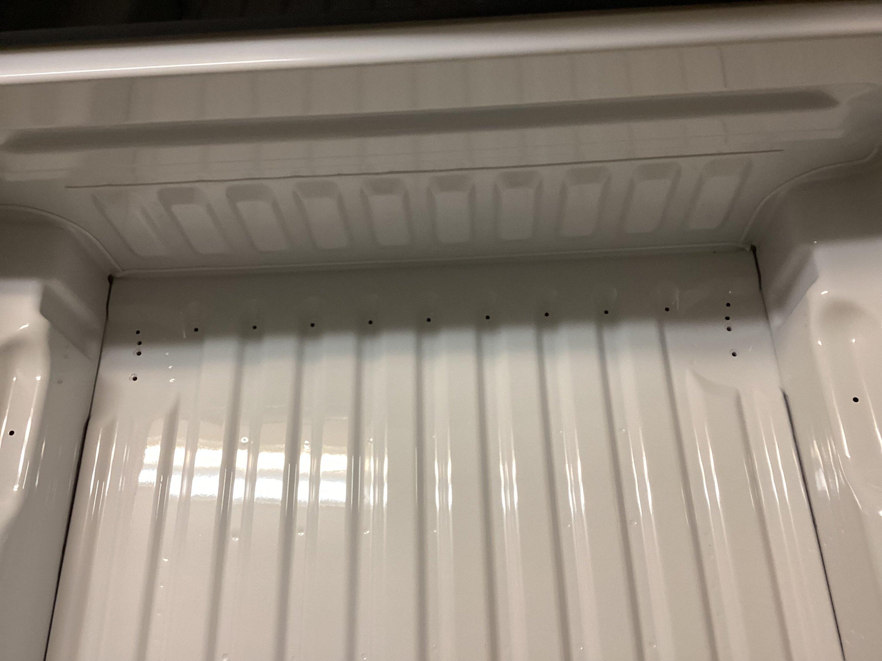

Your bed cover drain tubes should go into these factory holes on each side of the bed, just remove the rubber grommets (pic from a different post on this forum)
Ford Maverick Leak or Condensation in covered truck bed ? drain hole

I mean there are holes, but you bougie boys with spray or drop in bedliners may to be able to see them any more. I for one think a painted bed with scratches is more truck-like.
