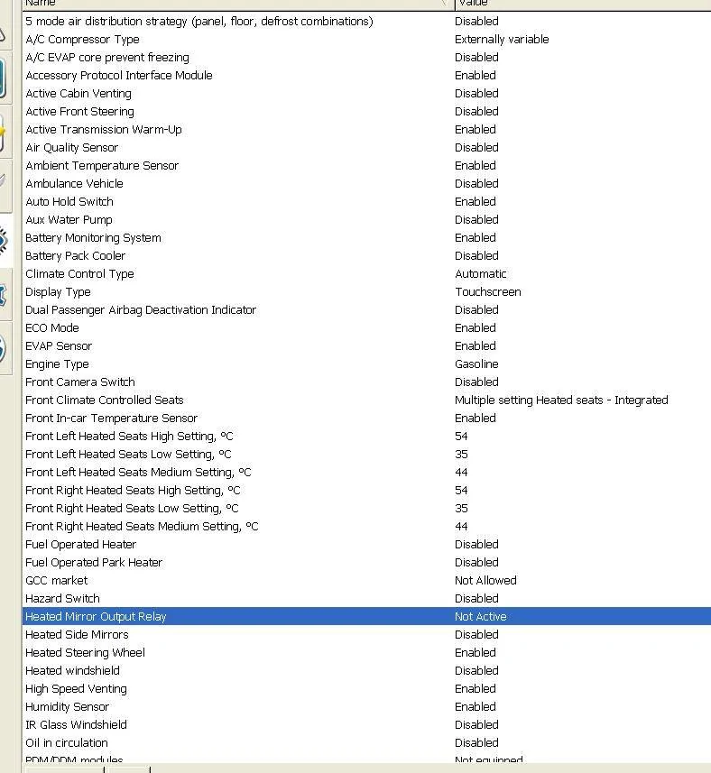

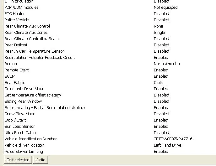

Can someone post a screenshot of their as built for a Lariat HVAC module?
Would like to compare and see why mine had certain settings that didn't correlate to my trucks specs?
Heated Mirror Output Relay: Not Active <- My truck has heated mirrors?
Heated Side Mirrors: Disabled <- My truck has heated mirrors?
PDM/DDM Modules: Not Equipped <- My truck has both PDM and DDM?
Seat Fabric: cloth <- My truck has leather seats?
Sliding Rear Window: disabled <- My truck has a sliding rear window
The software was written for all possible options maybe even for features no mavericks have installed. If you purchased a lux package and everything was installed then the options which were included in your build would be enabled. If you did not have something installed then that option would be disabled in the software
Yes which is odd, because I have a Lariat lux but the options are disabled in my hvac control. I would have assumed they would be enabled from the factory
Who knows. If dealer applied a program update and the 12 volt battery was not fully charged and below 12v then the update may not have completed properly. It was posted that the tech is supposed to put at least 13volts onto jump pins during update. The techs doing update recalls in my drive always put power on my hybrid when running.
